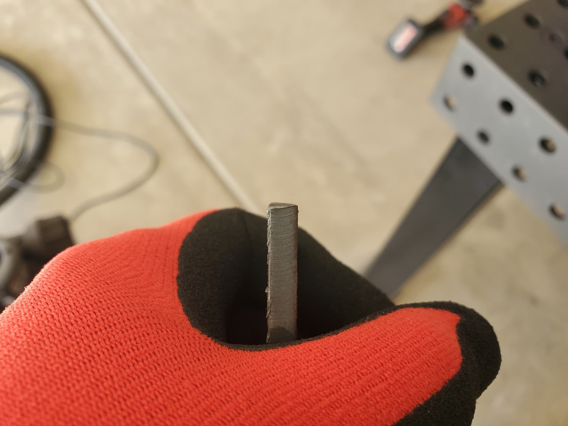

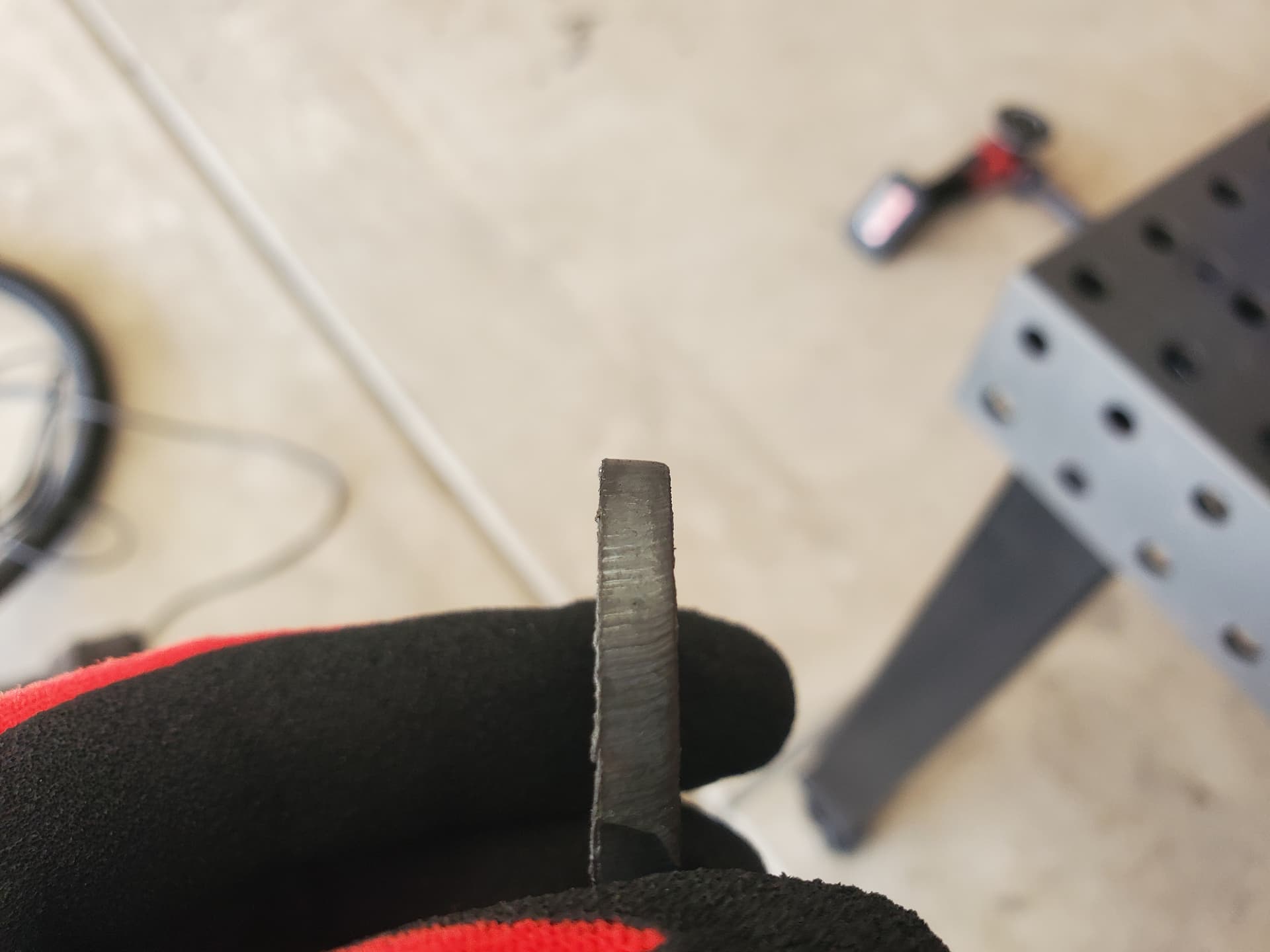

Ok, so something prompted me to fire everything up.
Apparently, a lot of people have this issue (if you google one sided bevel with Hypertherm).
A few theeads pop up on Plasmaspyder and on an 8 year old thread someone suggested replacing the o rings (and lubing them).
I don’t have extra OEM o rings, and I don’t have the proper lubricant, but I used a tiny bit of sil glyde and spun the rings around a bit.
Did a test cut, and suddenly my +8 degrees of bevel on the top side turned to 3 degrees, with the remaining sides measuring at about 2.
So, I’ll have to confirm repeatability this weekend but on some 16 gauge and hope it remains consistent. If so, this whole ordeal was an o ring issue.

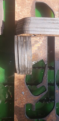

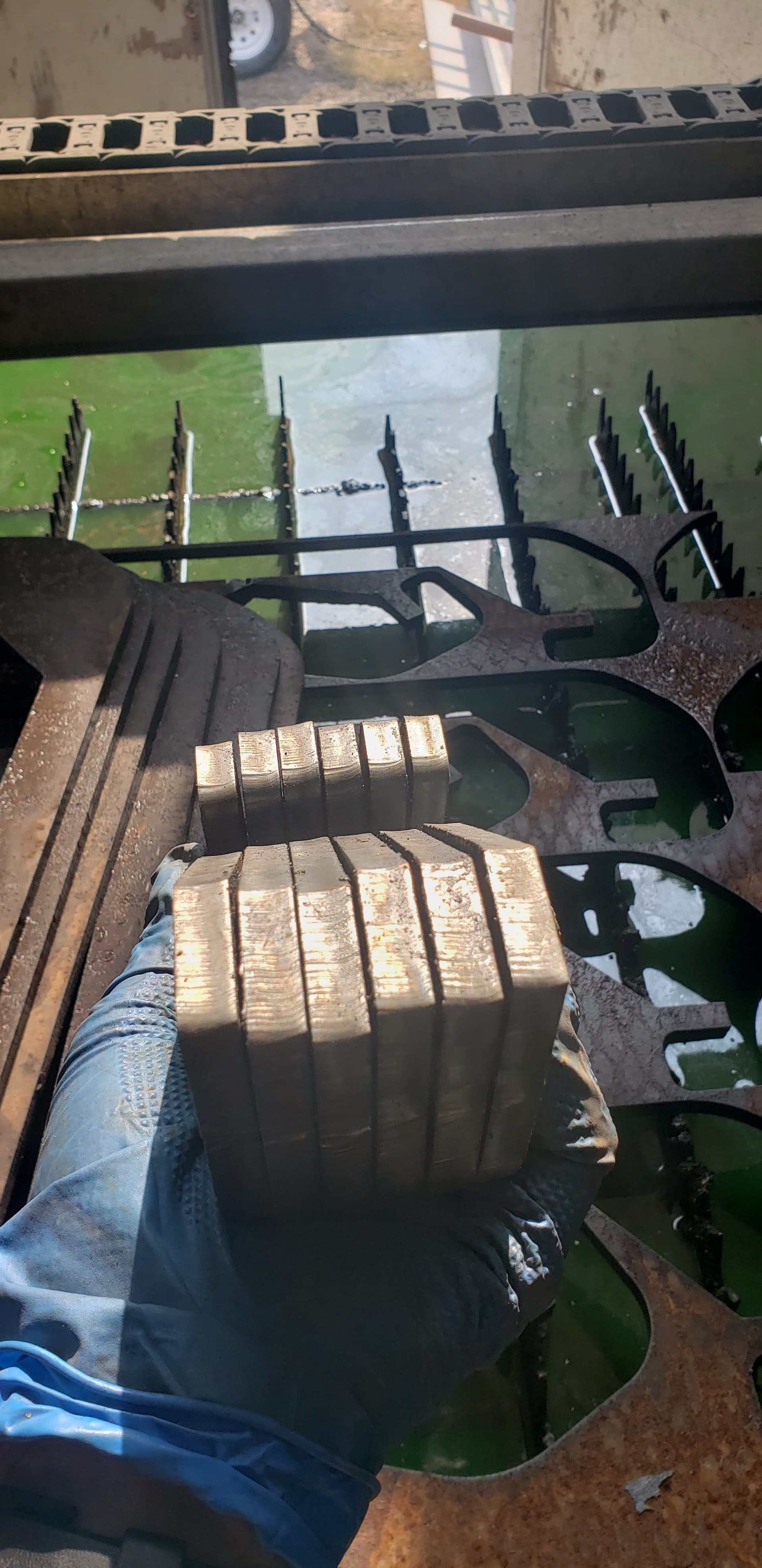

Here is my results from today
Hypertherm G 1650
100A
3/8 Rusty plate
57 IPM
No dross to speak of
Machine torch, aged consumables
