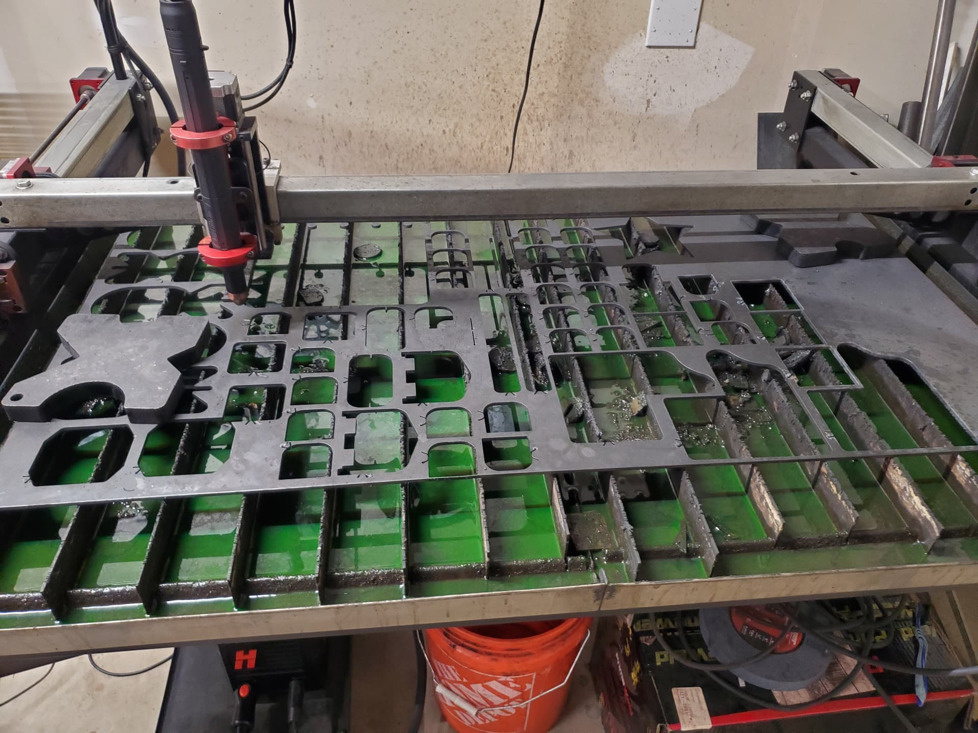

Yes, all cuts regardless of the variable change, have a bevel up top. This automatically points to a table/movement issue. Yet, following the procedure to ensure things are level and square don’t fix the issue and this only began when I removed the CUT60 and put in place the Hypertherm.
Next steps are to see what Langmuir has to suggest, then move onto using the hand torch to see if it makes a difference. If it doesn’t, disassembly will begin.

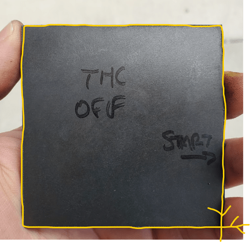

The test is a 3" x 3" square, with no rules implemented, running book speed which is 85ipm, and 0.5 pierce delay at 45 amps.

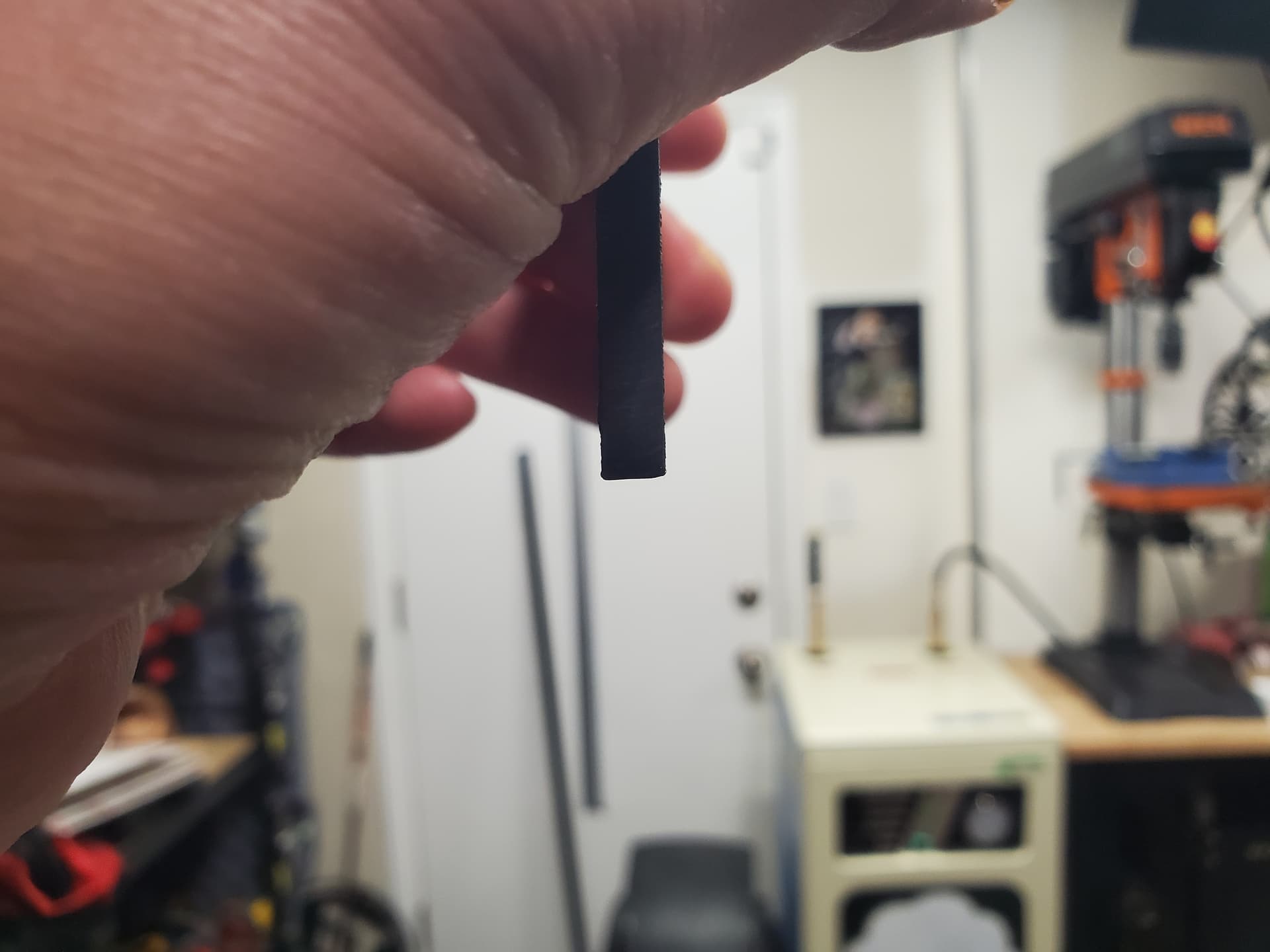

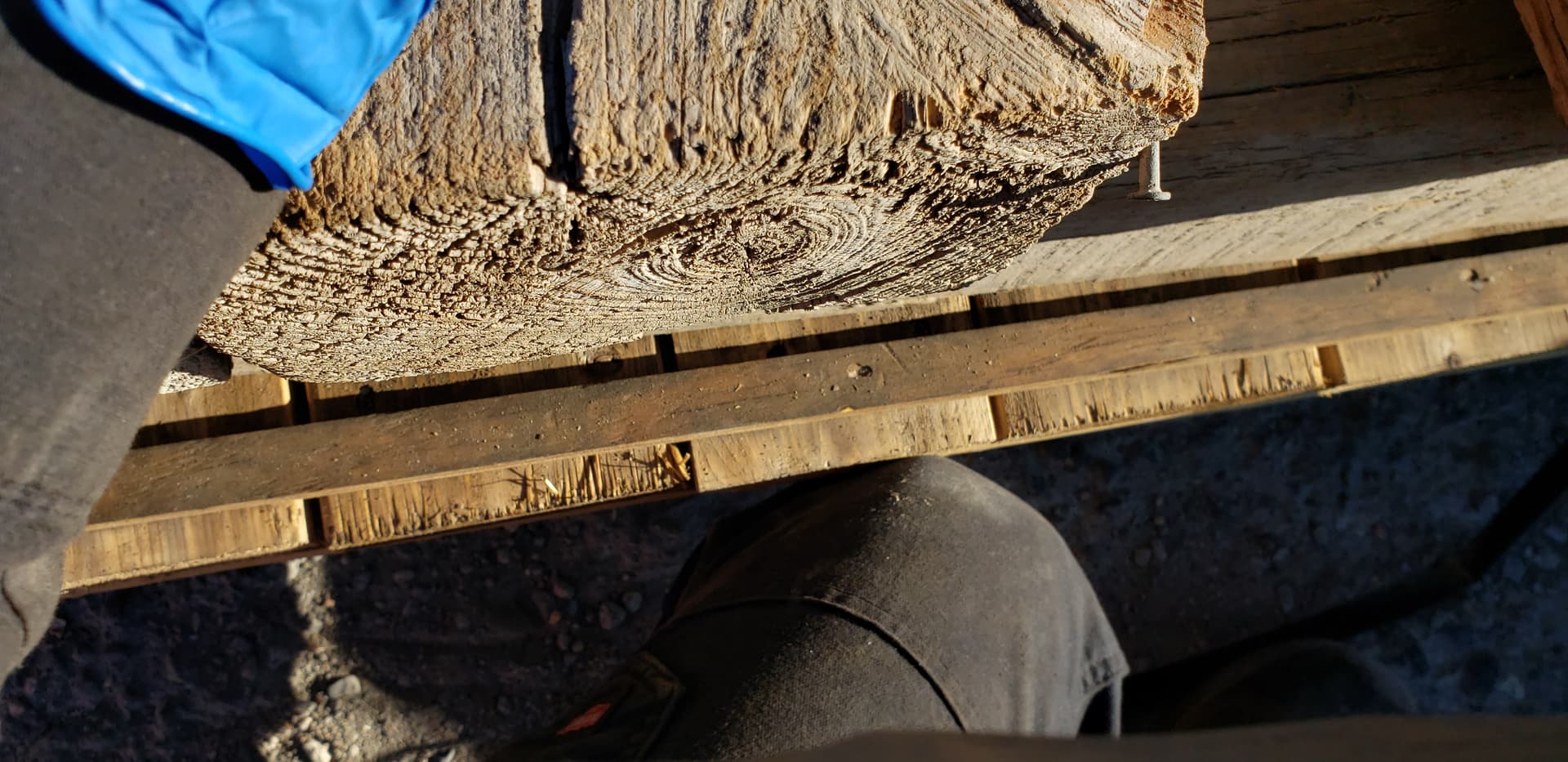

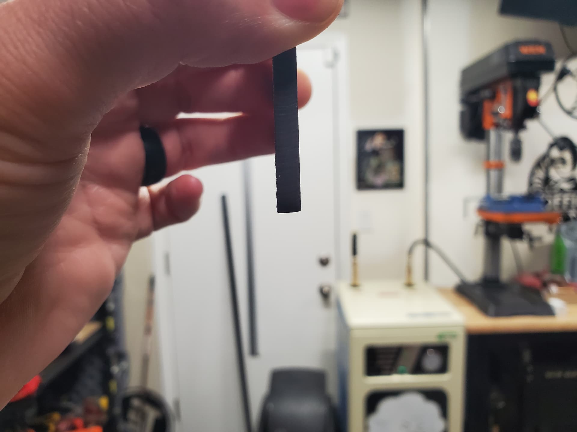

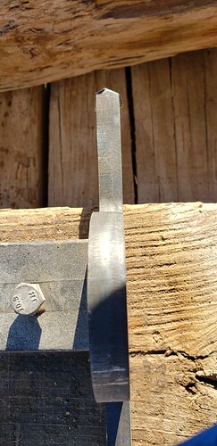

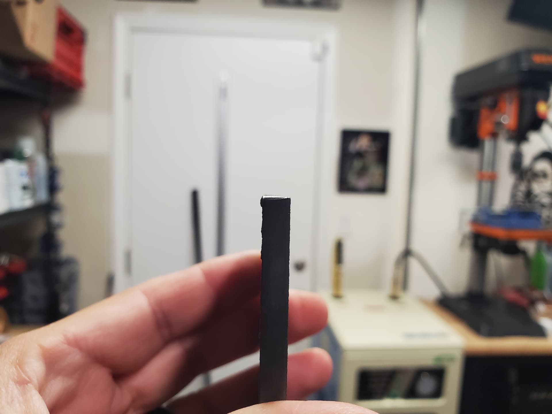

Now the results of the 3" x 3" square are interesting -
Top edge
Bottom edge
Left edge
Right edge
The test piece here is what I would call more than acceptable, and what I would or should expect my cutouts to look like.

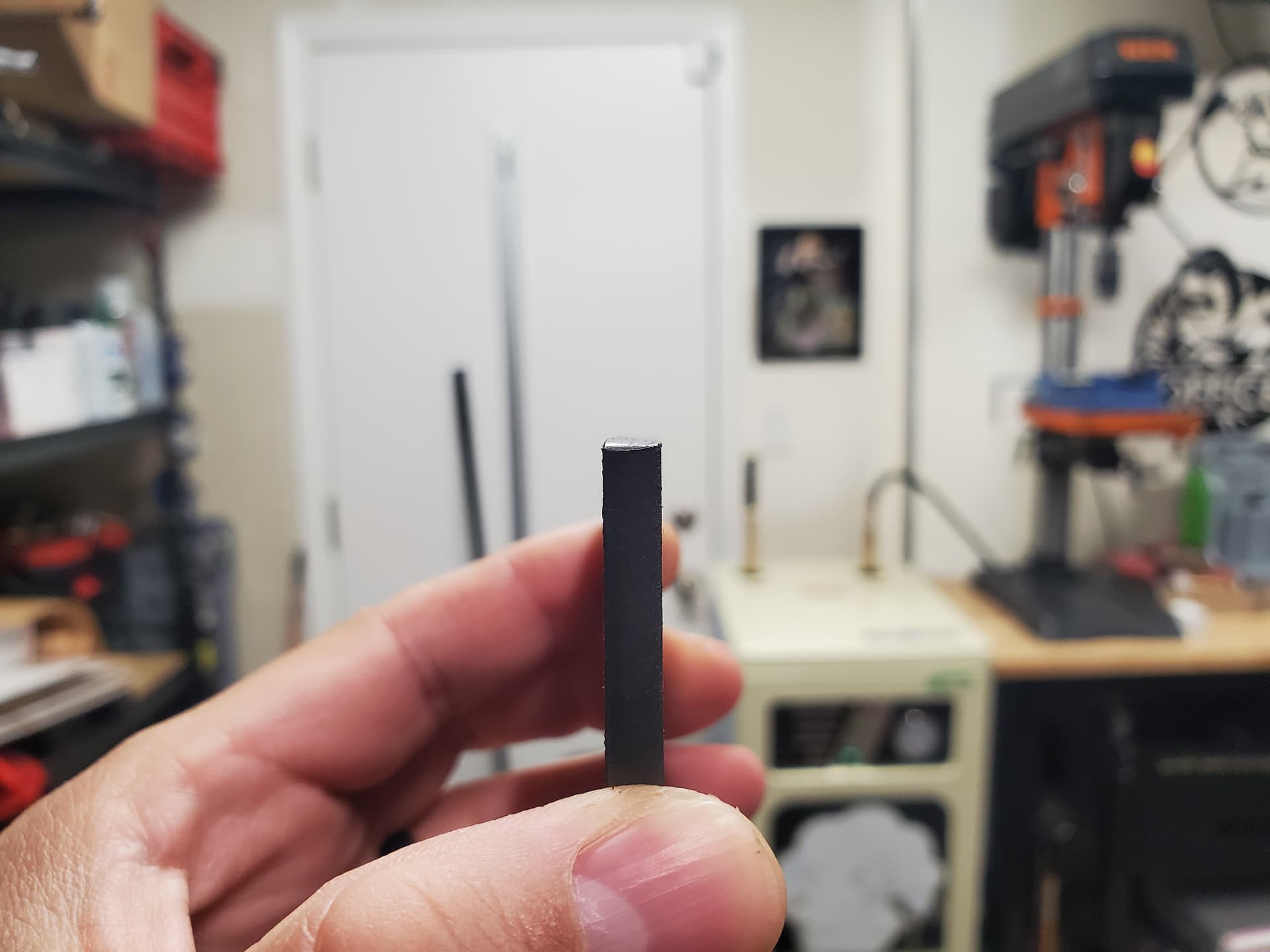

Performing the same test but beginning with the lead in on the left side provided identical results -
Top edge
Bottom edge
Left edge
Right edge

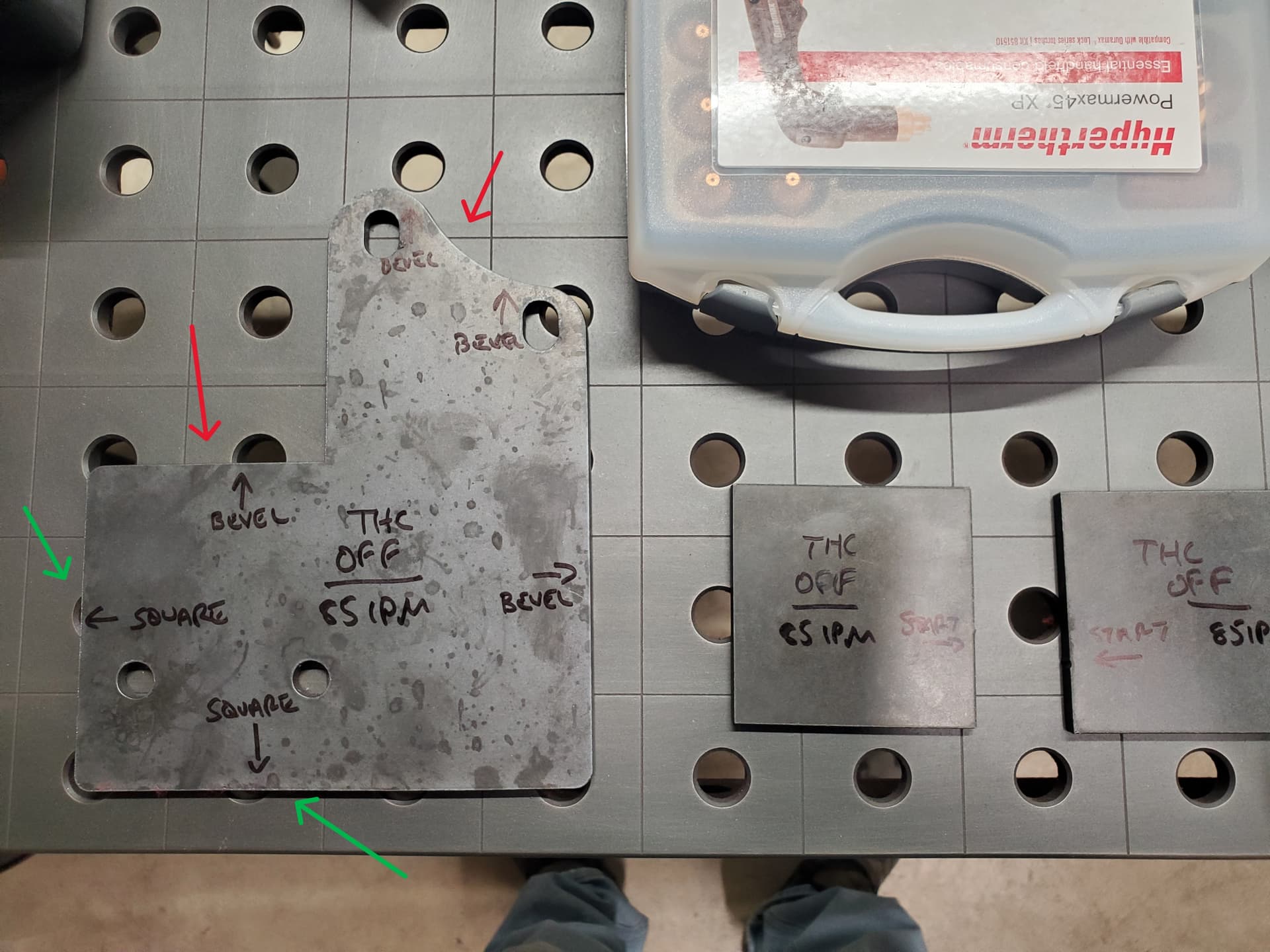

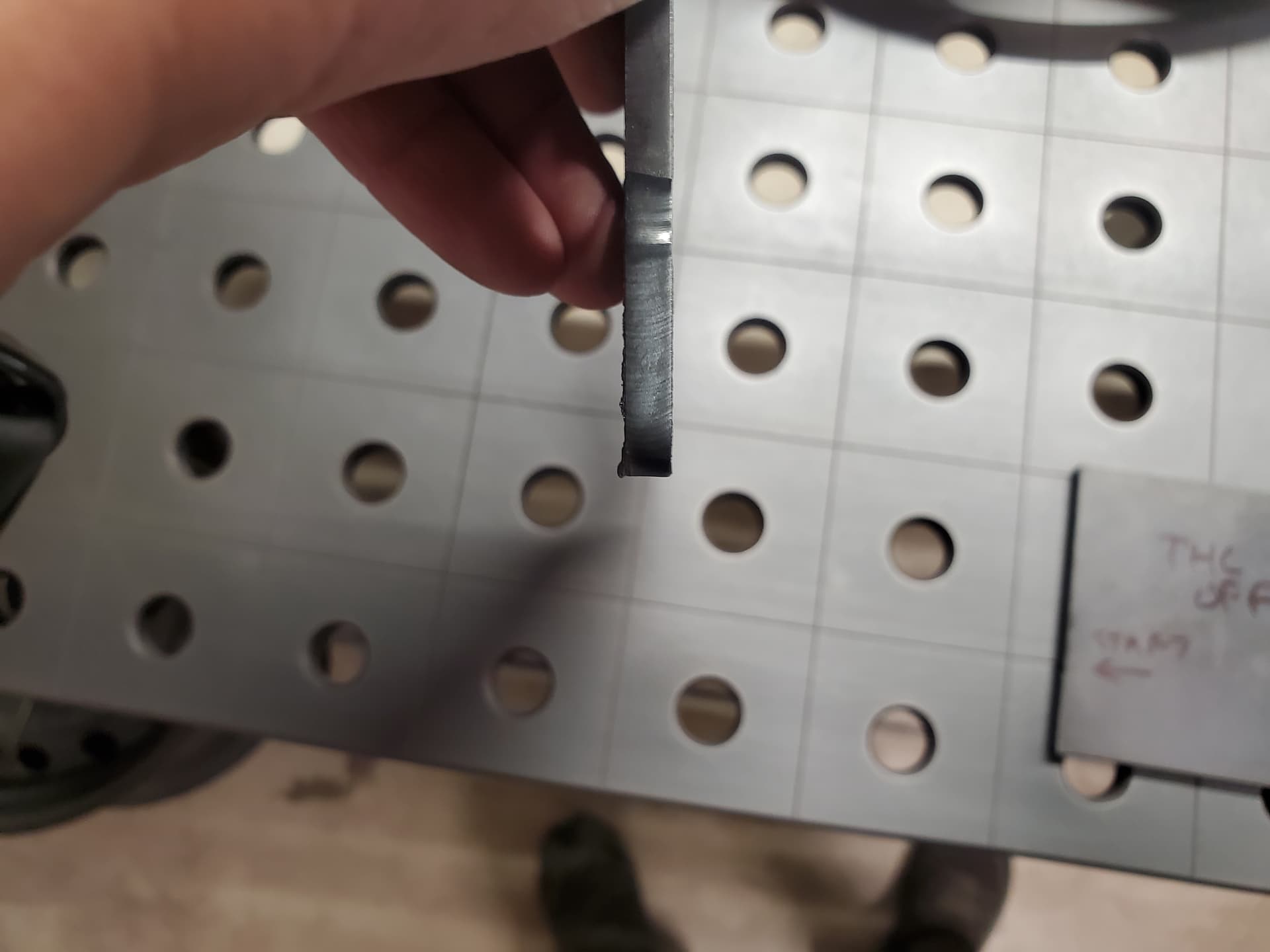

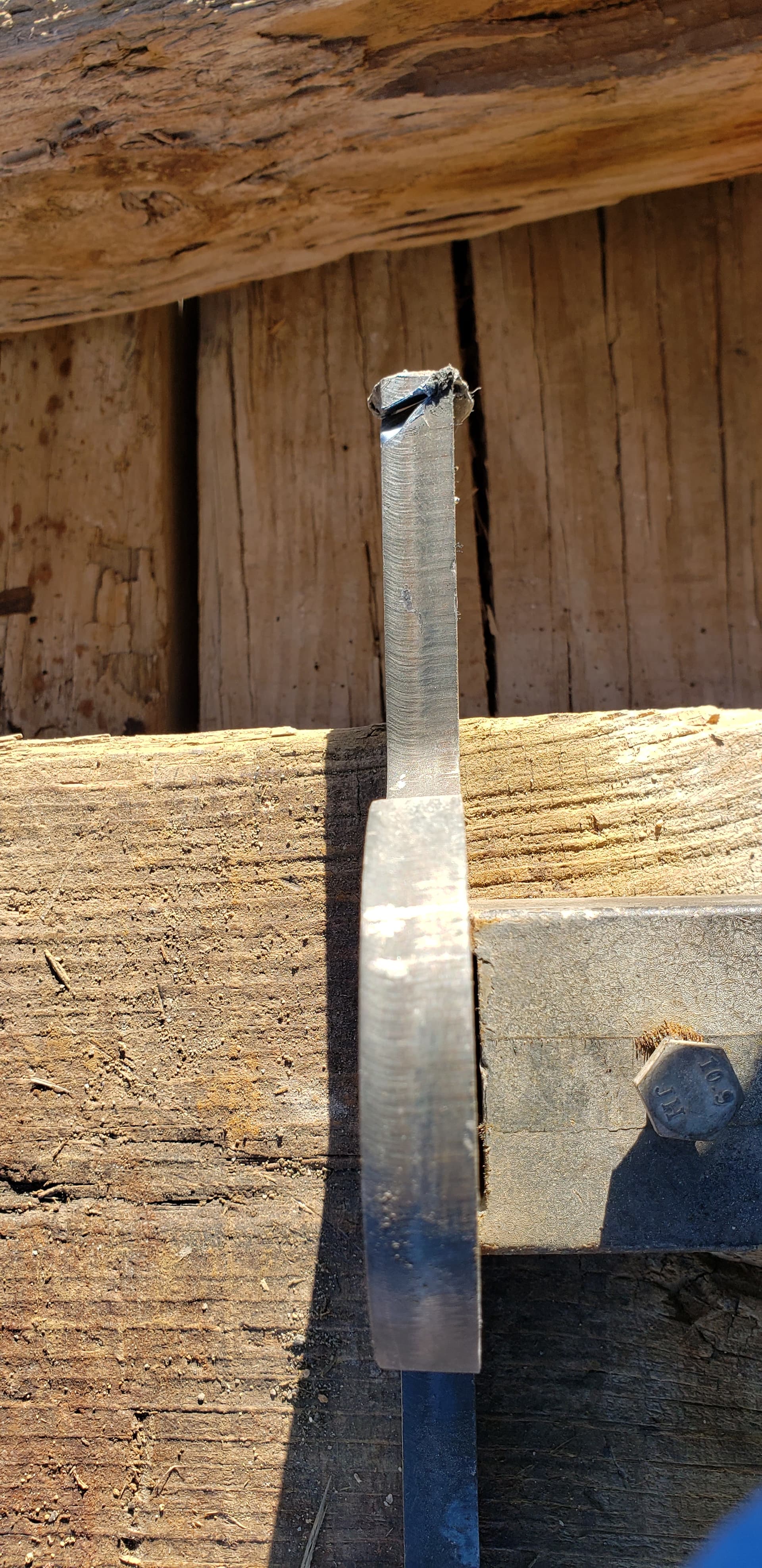

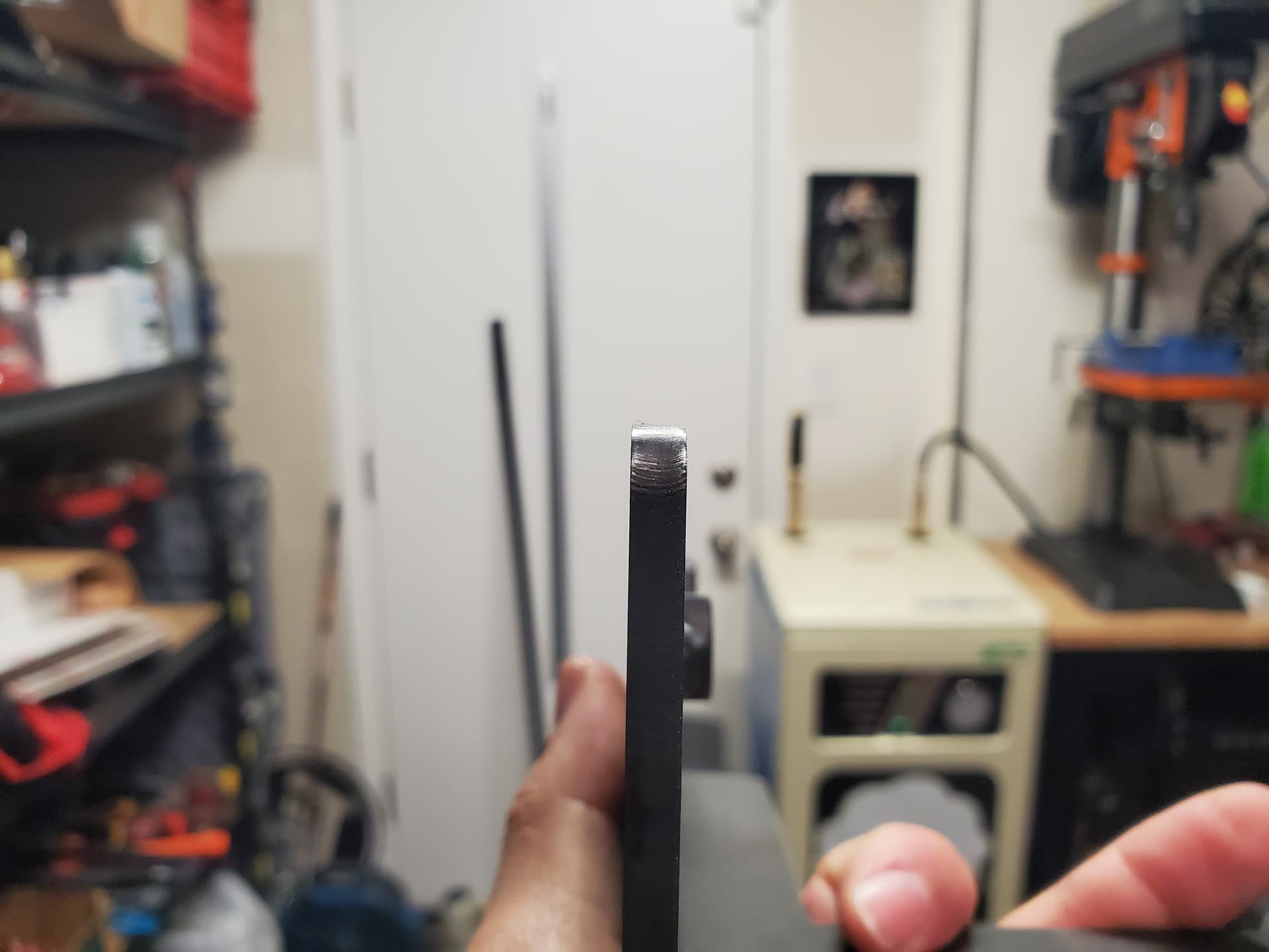

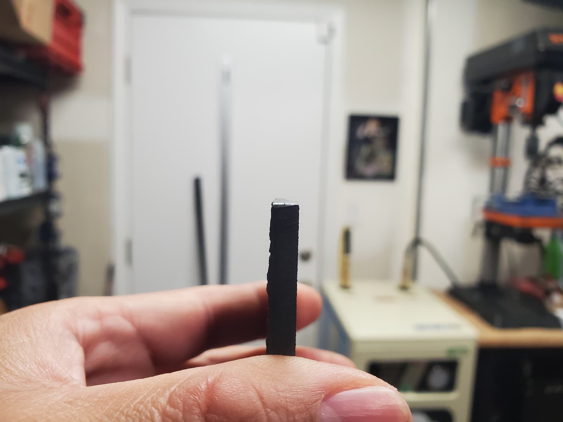

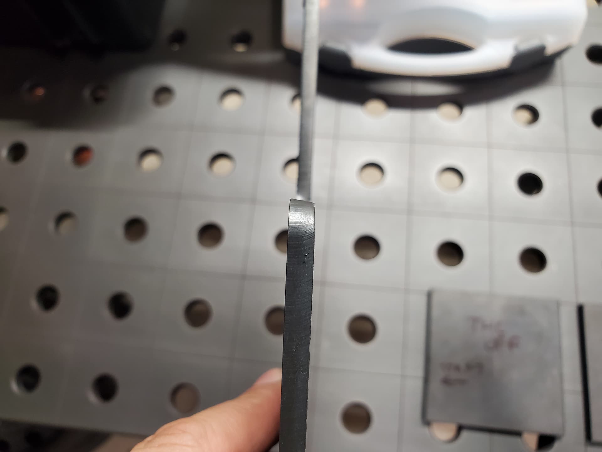

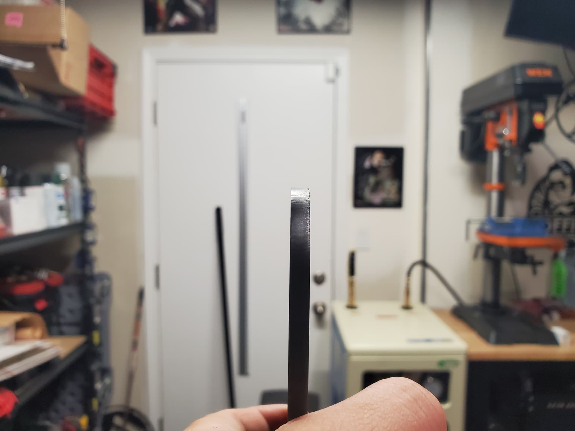

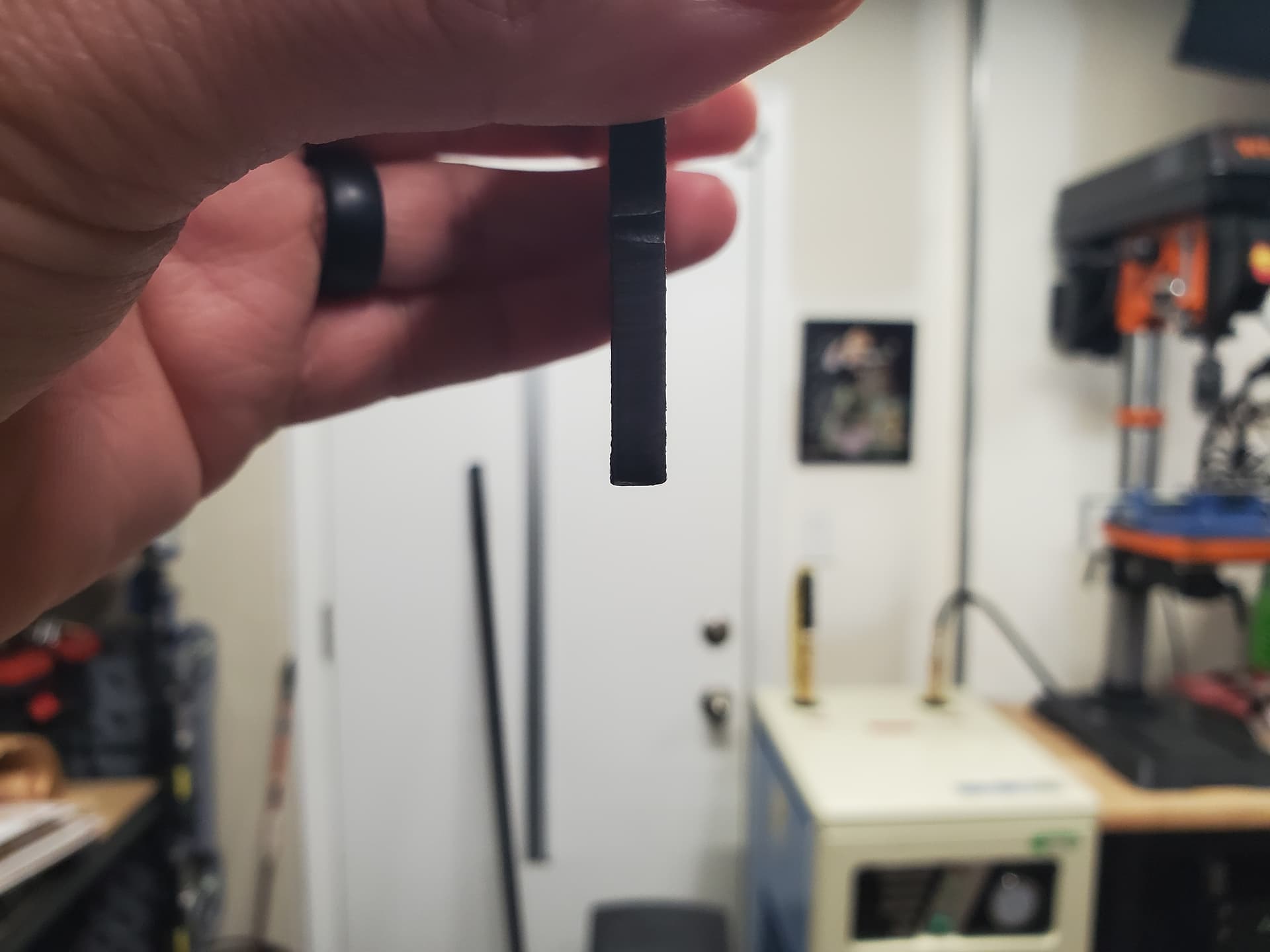

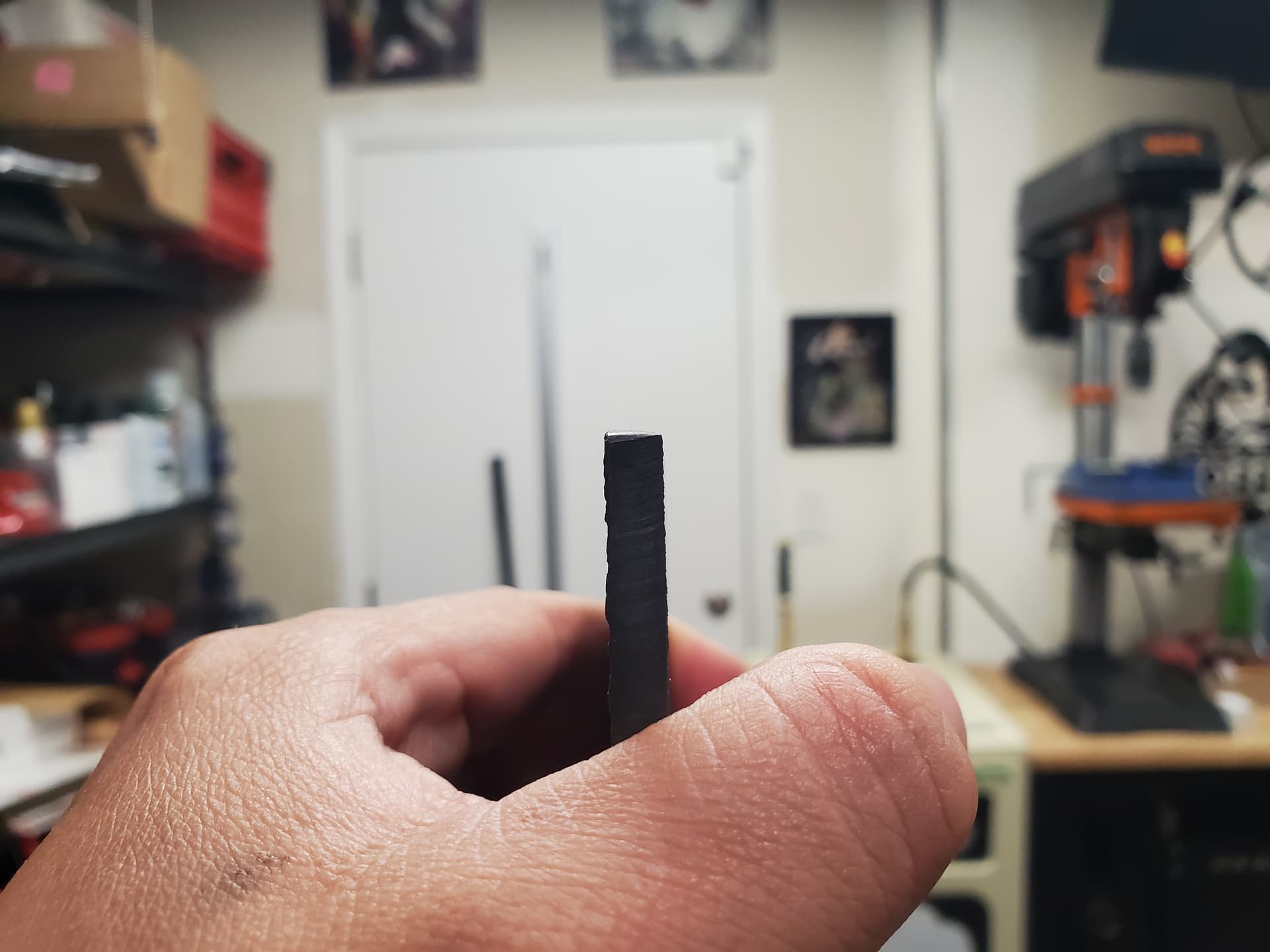

In the same area of my steel sheet, I opted to cut one of my vehicle parts using no THC, with the same 85ipm cut speed and cut height as the above 3" x 3" pieces.
Results were the same as every piece yesterday, day before, and day before that with a bevel up top, and square bottom and oddly enough even, now a beveled right side but square left side
Top edge
Bottom edge
What strikes me as odd is how the top edge, being a 3 1/4" straight edge, can have such beveling while the 3" x 3" square, on the same axis, does not even with the same parameters. And yes, before you ask, the bevel is not just at the radius but extends through the entire length of the top edge.

The edges that are beveled is that edge being cut over a table slat. Might be cause of a bevel?
It’s a shot in the dark.
Brandy new consumable set. Lead in on the LEFT, so the top is the first uninterrupted edge to get cut, same settings.
Put the old set of consumables back in and repeat.
Try cutting one without the shield, Might need the “unshielded” shield.
Not sure how this can occur, the slats run perpendicular to the bevel.
Not to mention the bevel as mentioned, occurs all over the table on all cuts.

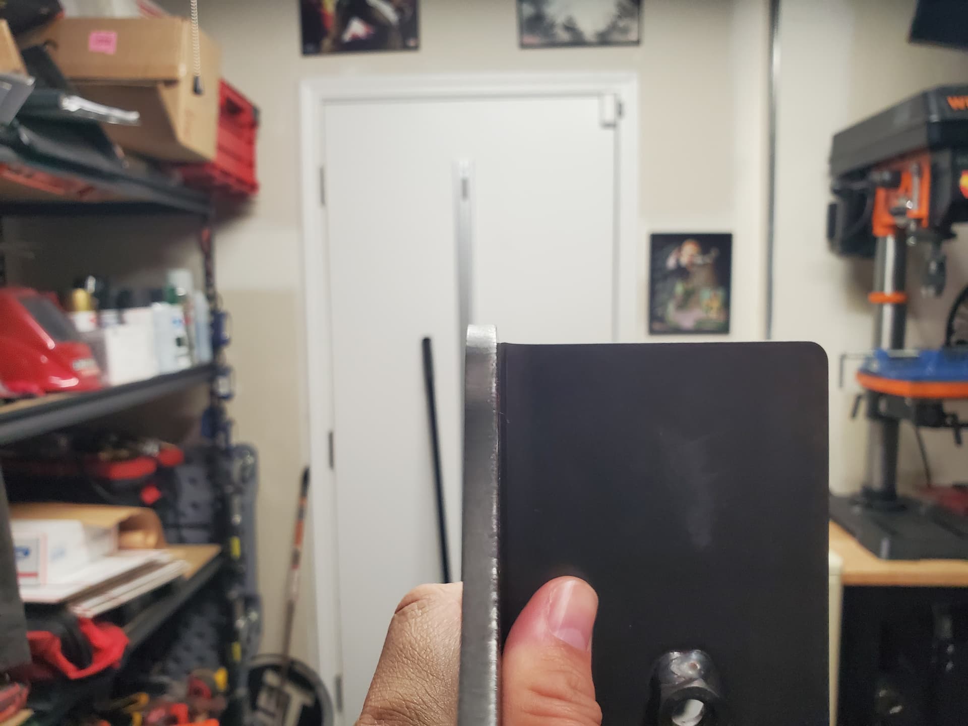

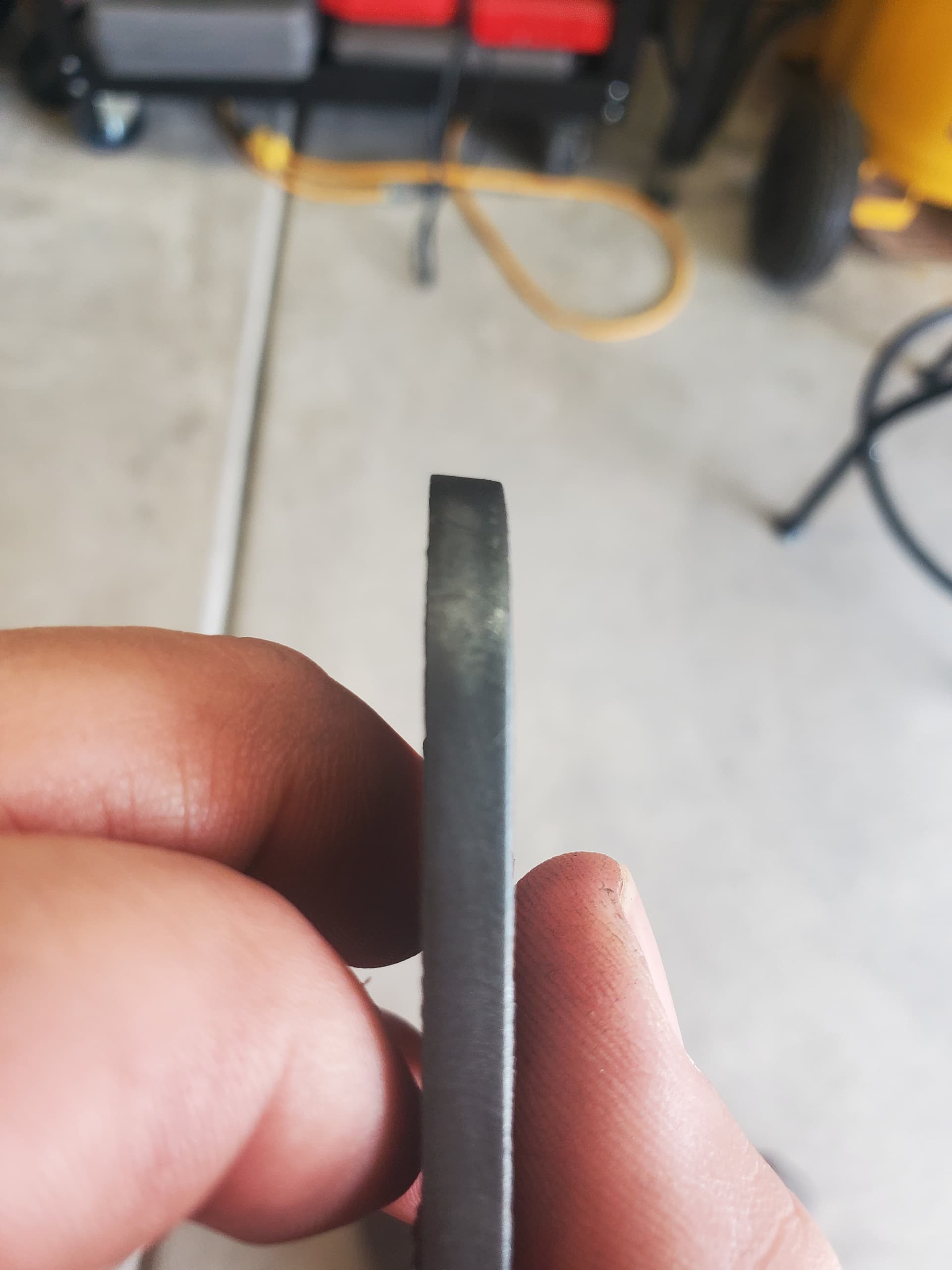

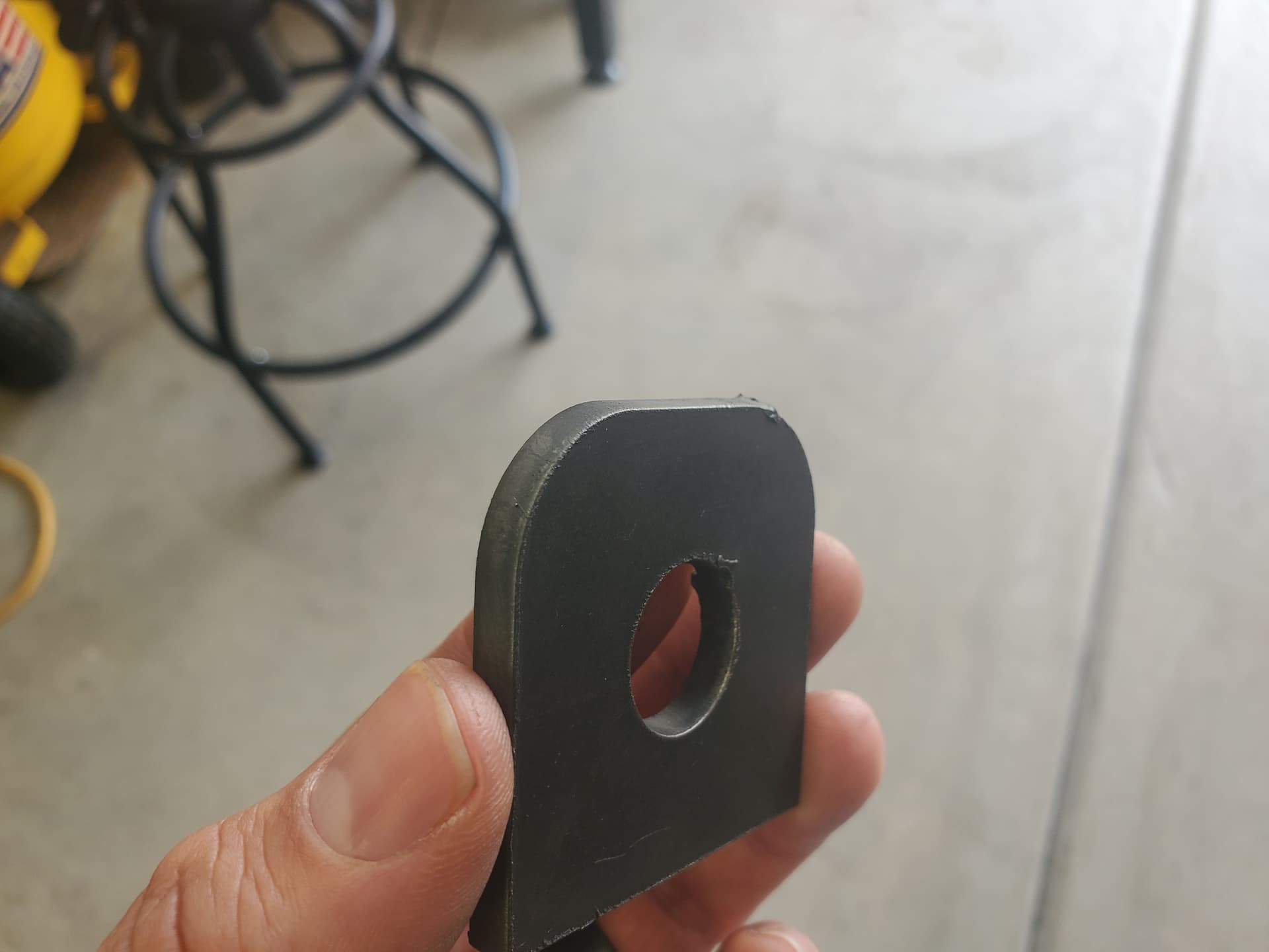

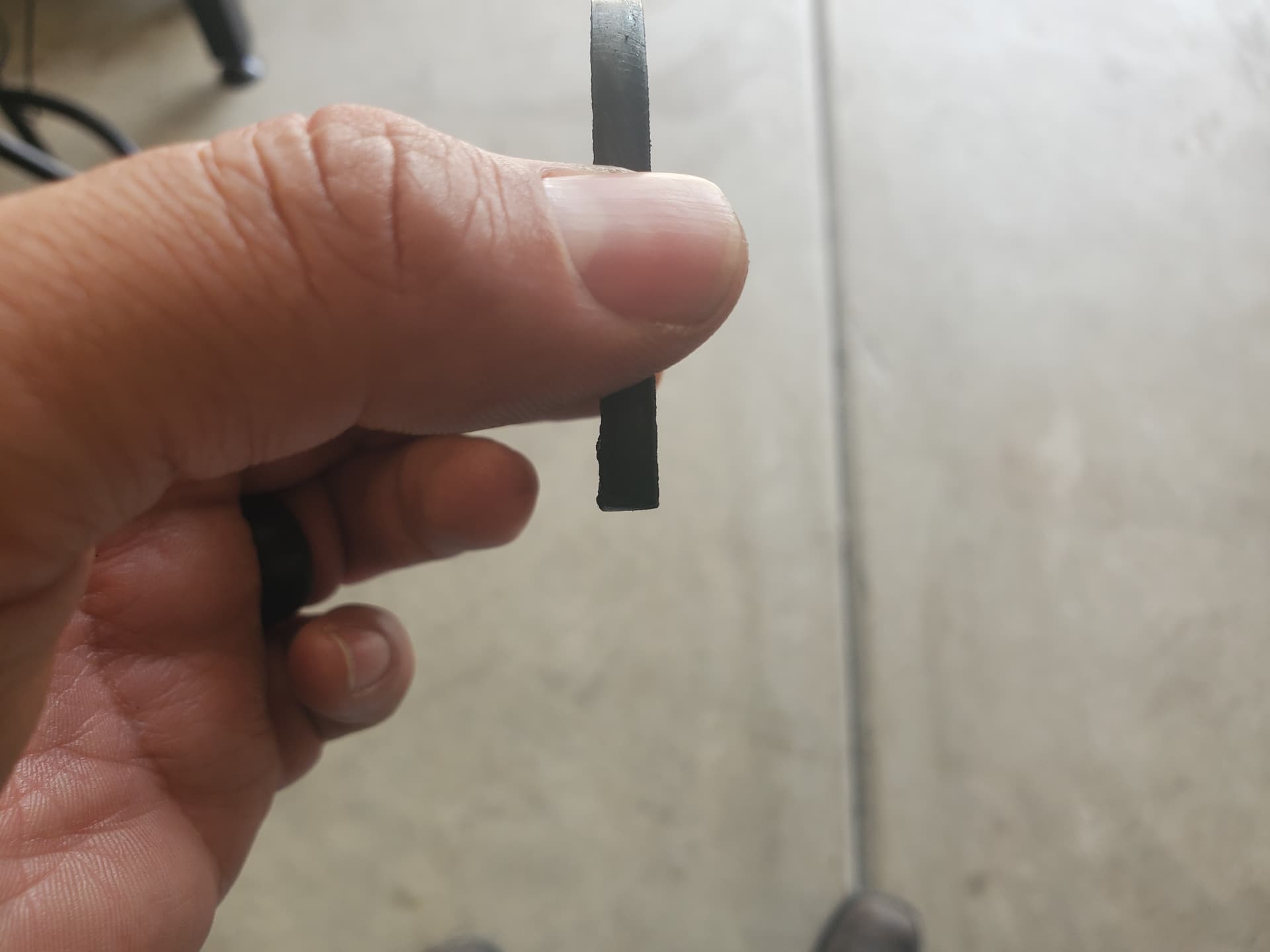

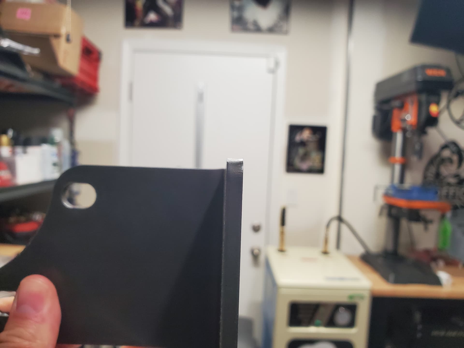

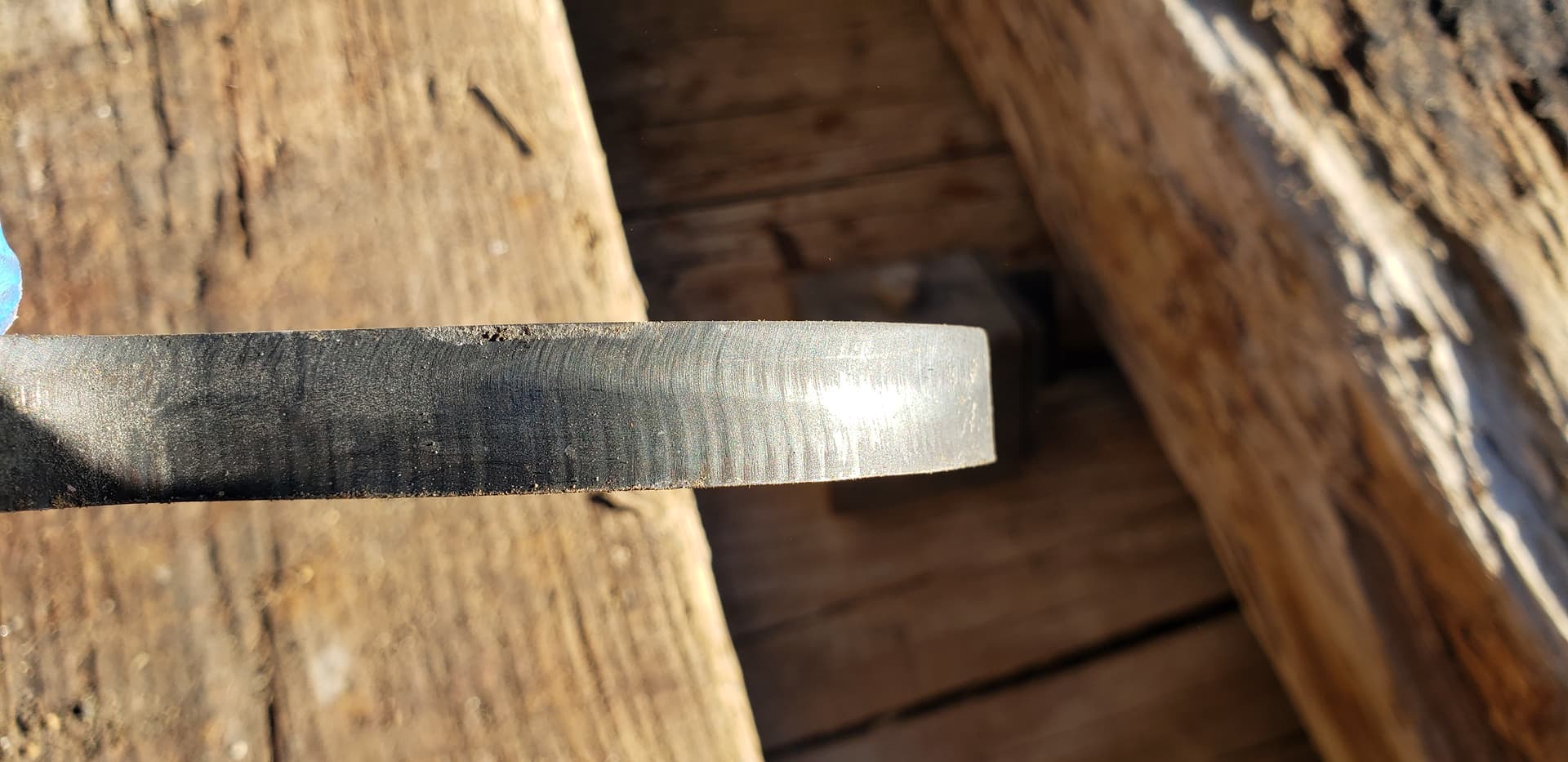

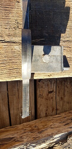

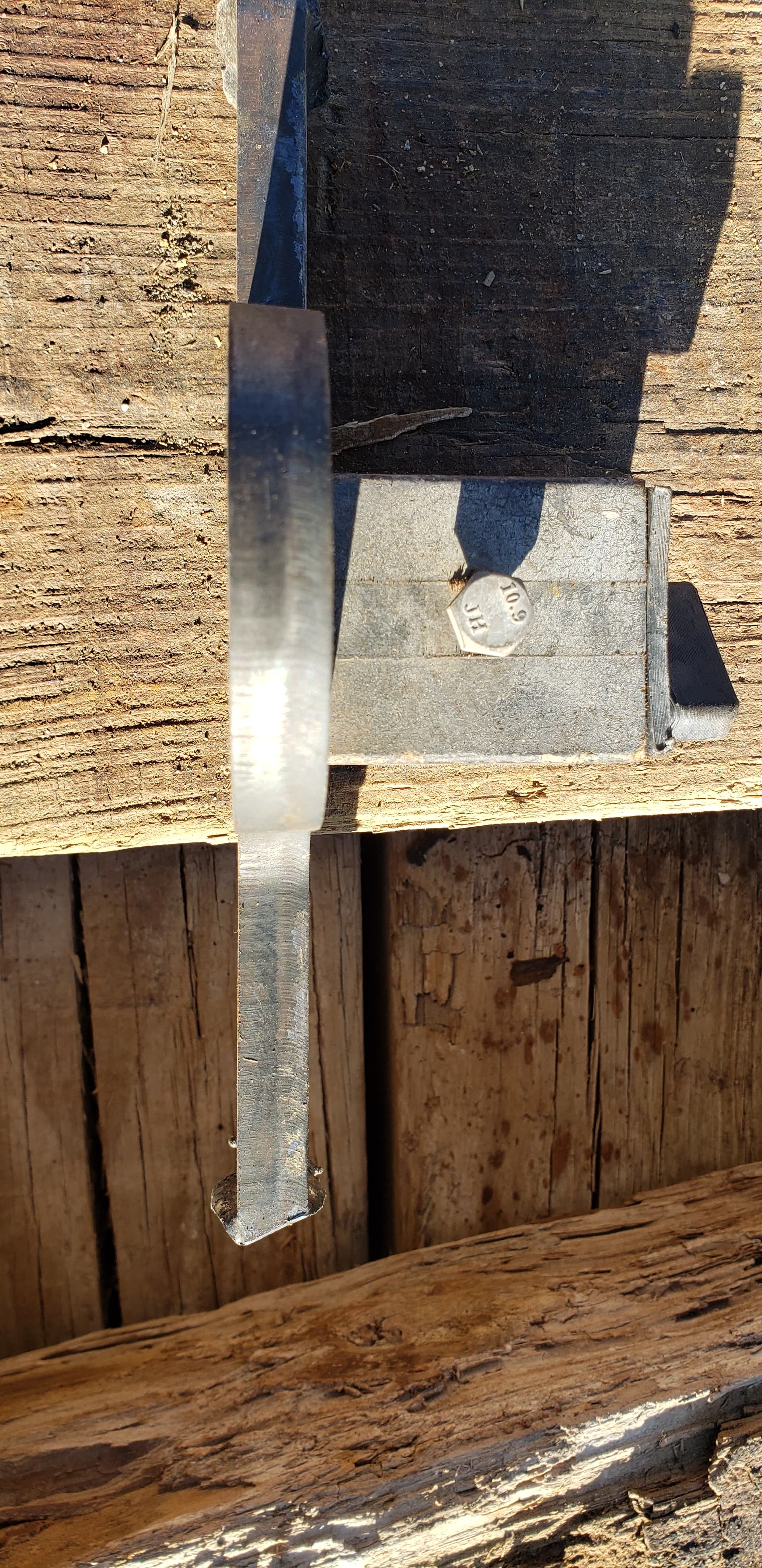

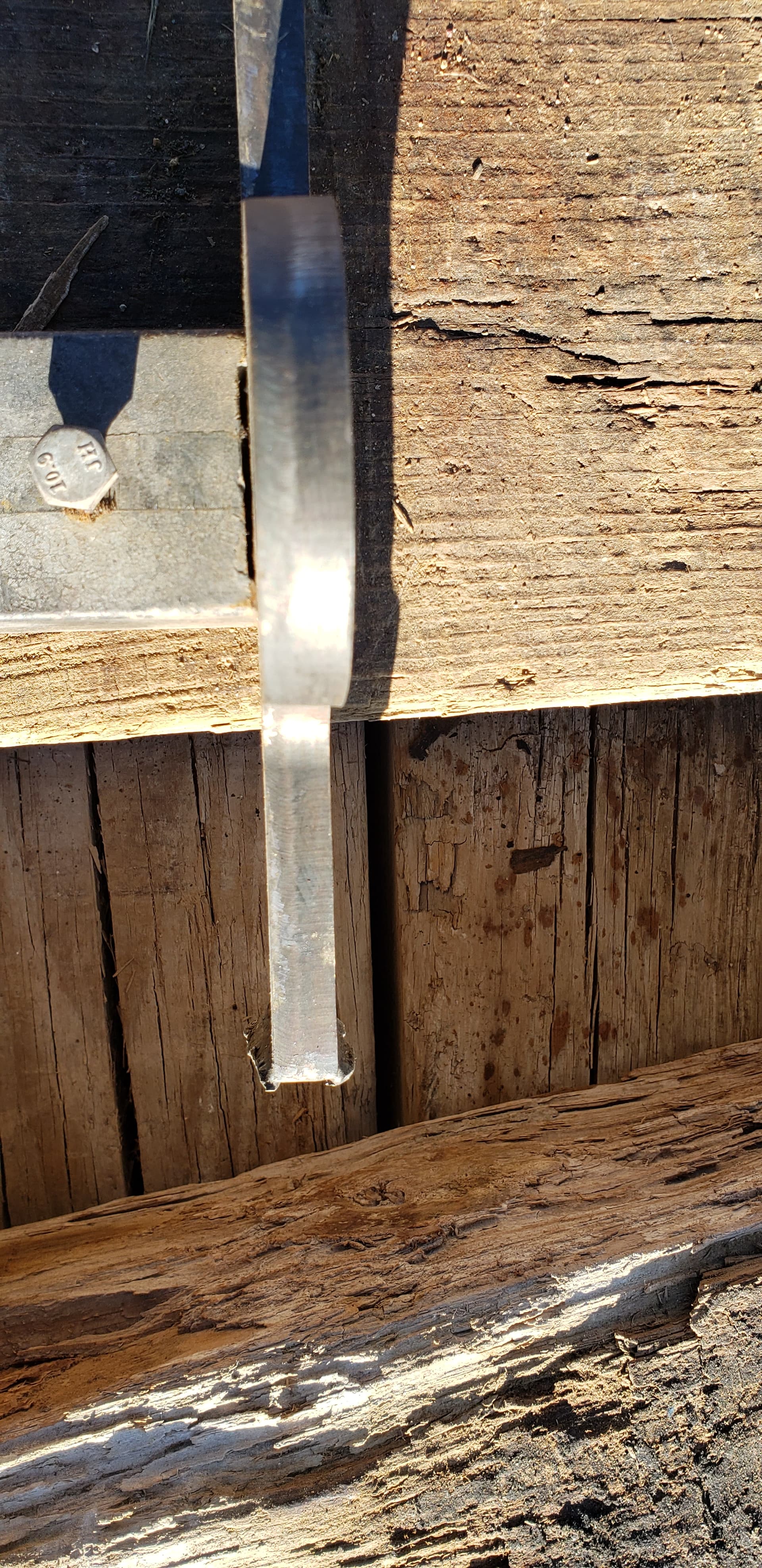

I think we all might just be dealing with a fun plasma cutting table phenomenon. These two brackets came from Caterpillar equipment. I am fairly confident that they’re CNC plasma table is dialed in a hell of a lot better than any of ours.
@Sticks

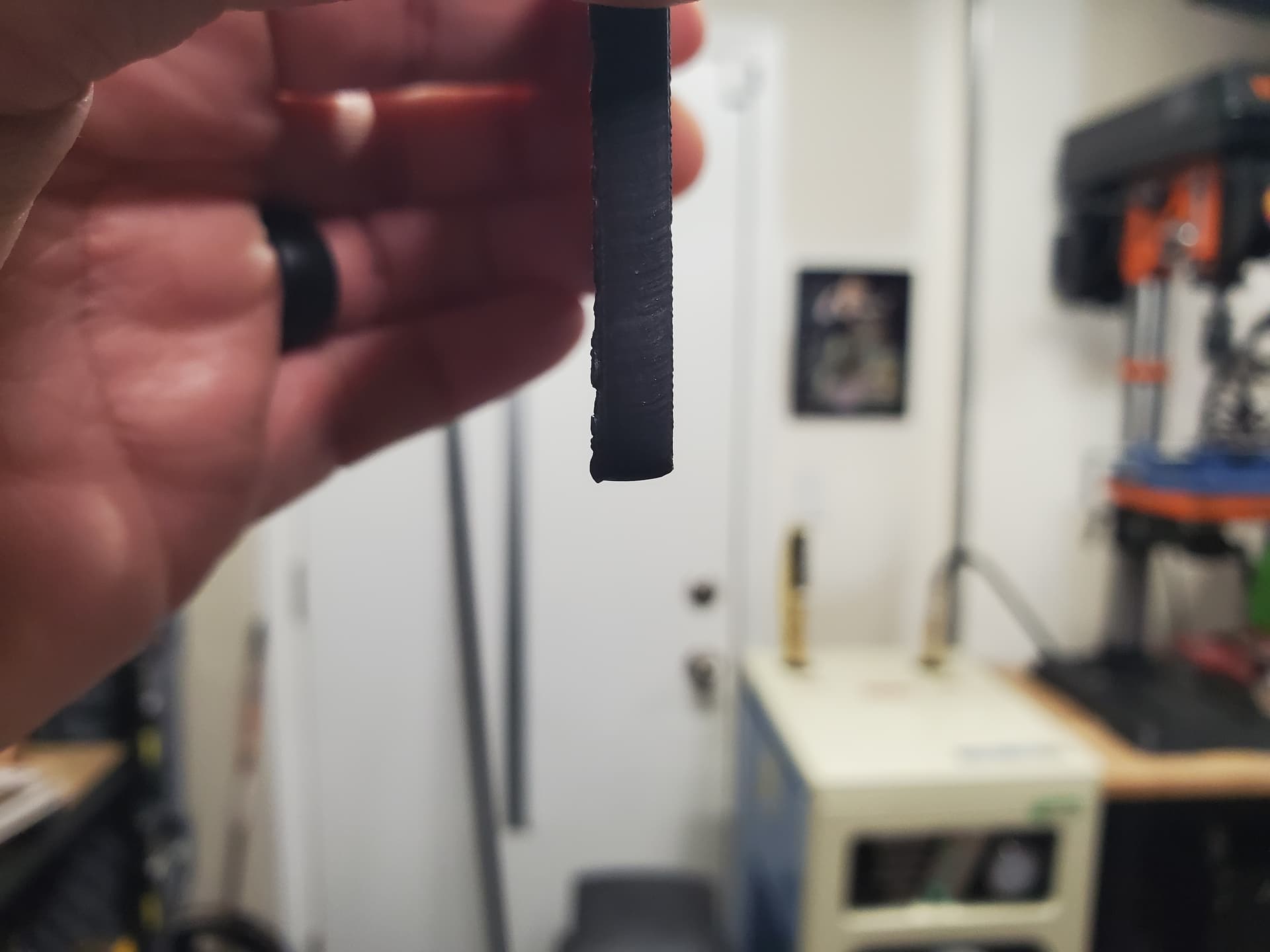

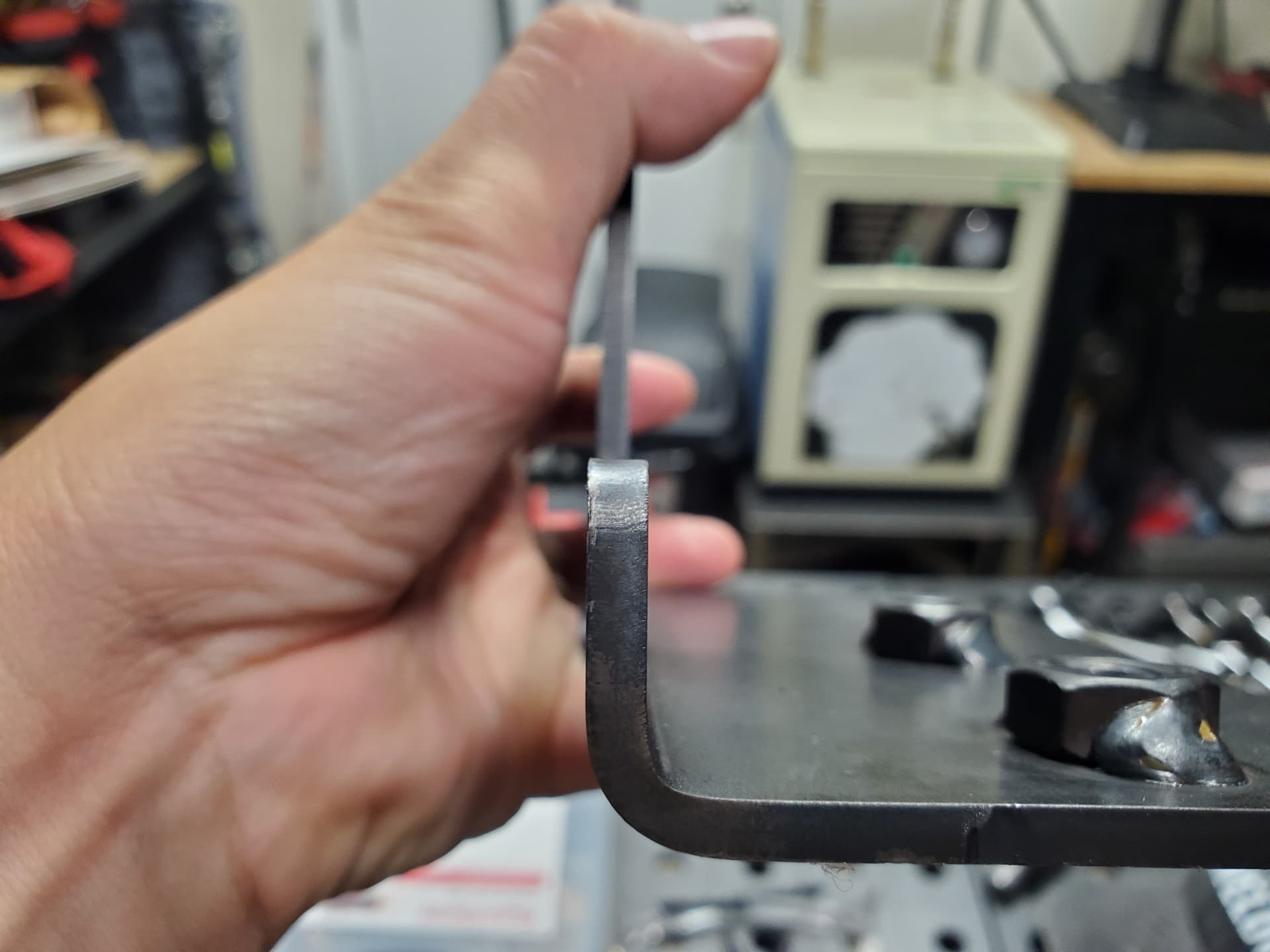

Here’s the exact same design piece, cut in the same orientation, cut on the same table, but from my chinese plasma cutter.
I’m not new and I’m not expecting perfectly square cuts, I think that’s where the misinterpretation is occurring.
As you can see by the above piece, there’s the tiniest bevel present and that is what I expect.
But with the Hypertherm, with every setting adjusted, in different areas of the table, and many items having been gone through for days, it is odd to get bad beveling on one edge regardless of the variable changed.

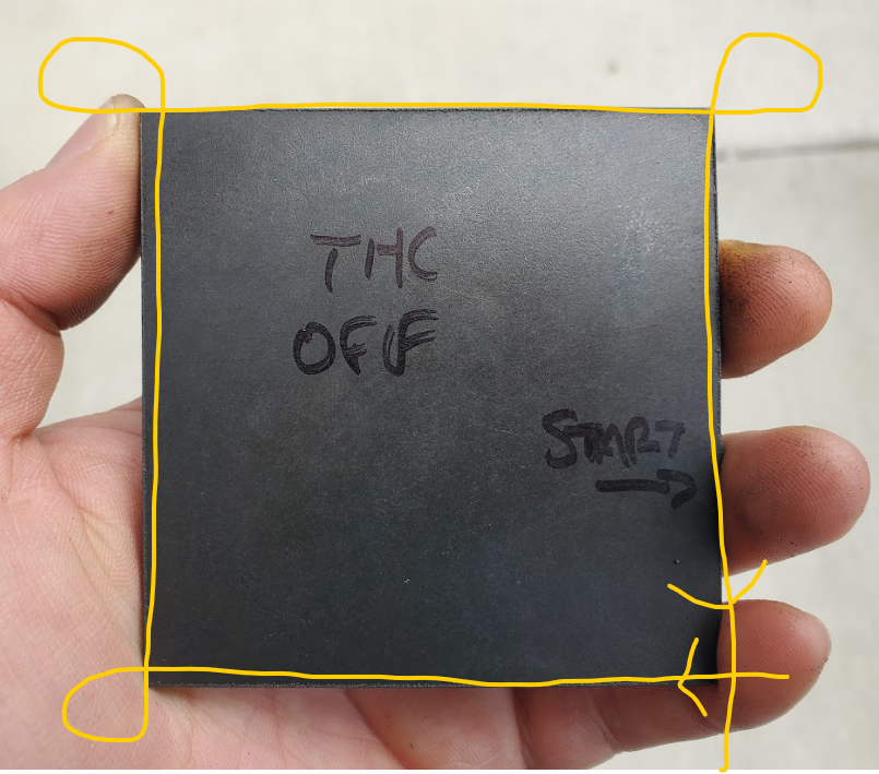

Well, Hypertherm made a suggestion to do this, to perform my cuts like this (marked in yellow, starting on the X axis at the bottom right) -
Or incorporating this cut feature -
Mind you, if you scroll up to where I performed a 3" x 3" cut for Hypertherm, the results themselves were much more acceptable even the way I processed the file which in my mind, debunks the suggestion to cut with the weird cut paths.
So instead, a friend took my test cut file, and actually performed a REVERSE CUT so the outside cut was done counter clockwise.
Resulted in the same bevel up top and nearly flat bottom.
So, the plus side is that, it most likely is the table itself. Something about the X axis movement might not be exact even though there is no binding or change of movement throughout the entire cut envelope of 48" x 33". Or maybe I meant to say Y axis even though the top beveled edge is a torch movement from LEFT to RIGHT. I don’t know. I’m ok with disassembly though.
I just find it odd that a perfect square design, cuts with “acceptable bevel” but anything else doesn’t…even if the design incorporates a square in it.

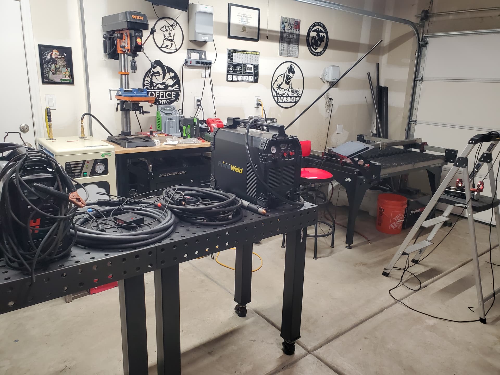

Having done a few test cuts on the CUT60 again (reconnected it), gave me much more square cuts using the same pattern so everything is now on the bench.
It’ll take me some 2, 3, or even 4 weeks just to start disassembly and maybe start putting it back together.
Yes, the CUT60 performed better but I wonder if the Hypertherm just showcases flaws in the table than the PrimeWeld; the theory being that maybe my table’s frame isn’t fully square anymore suddenly.

The pics I posted of the 1/2" brackets cut by my local Caterpillar Equipment fabrication shop in Aurora, there is one edge that has the bevel, where the corresponding edges do not.
