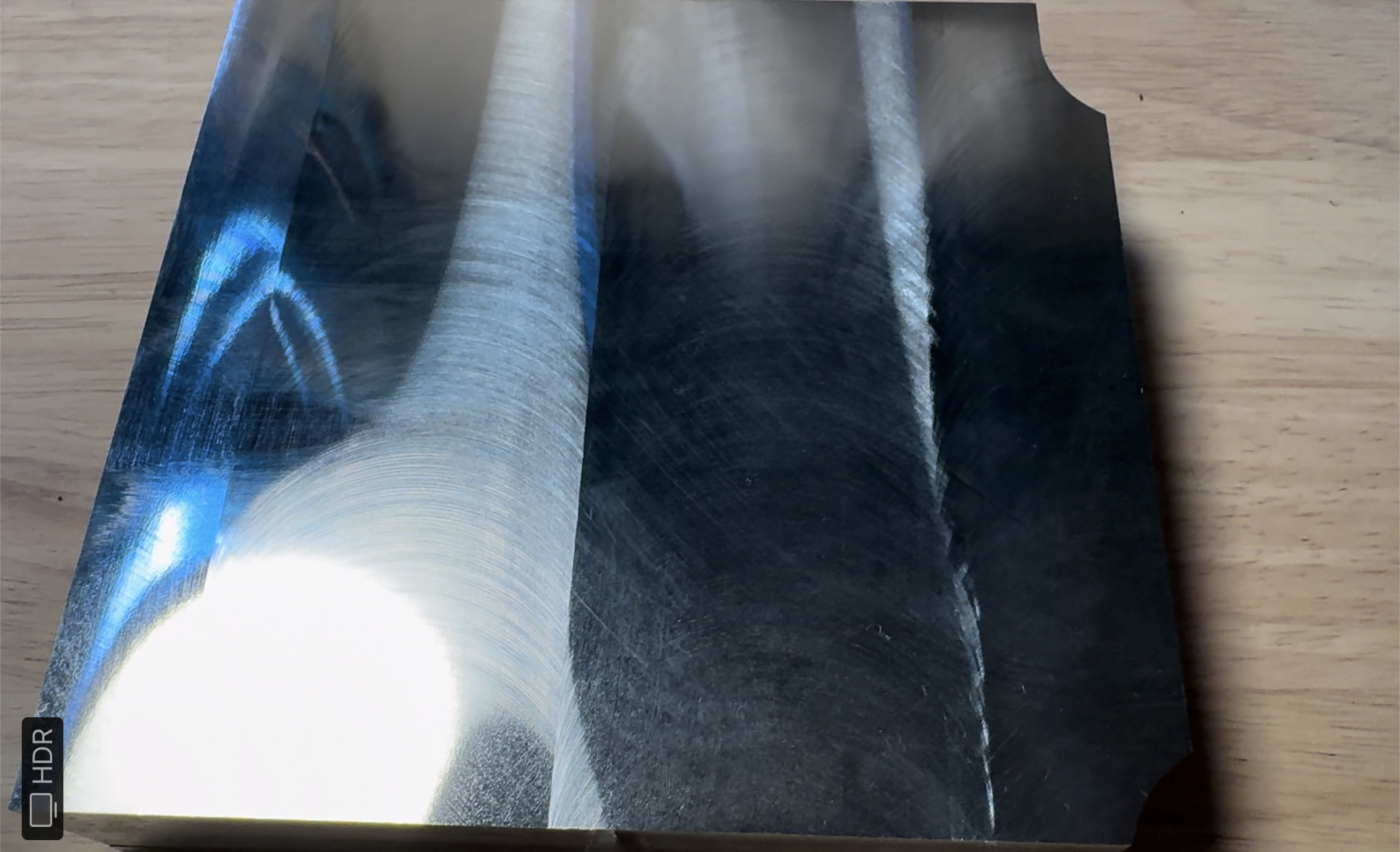

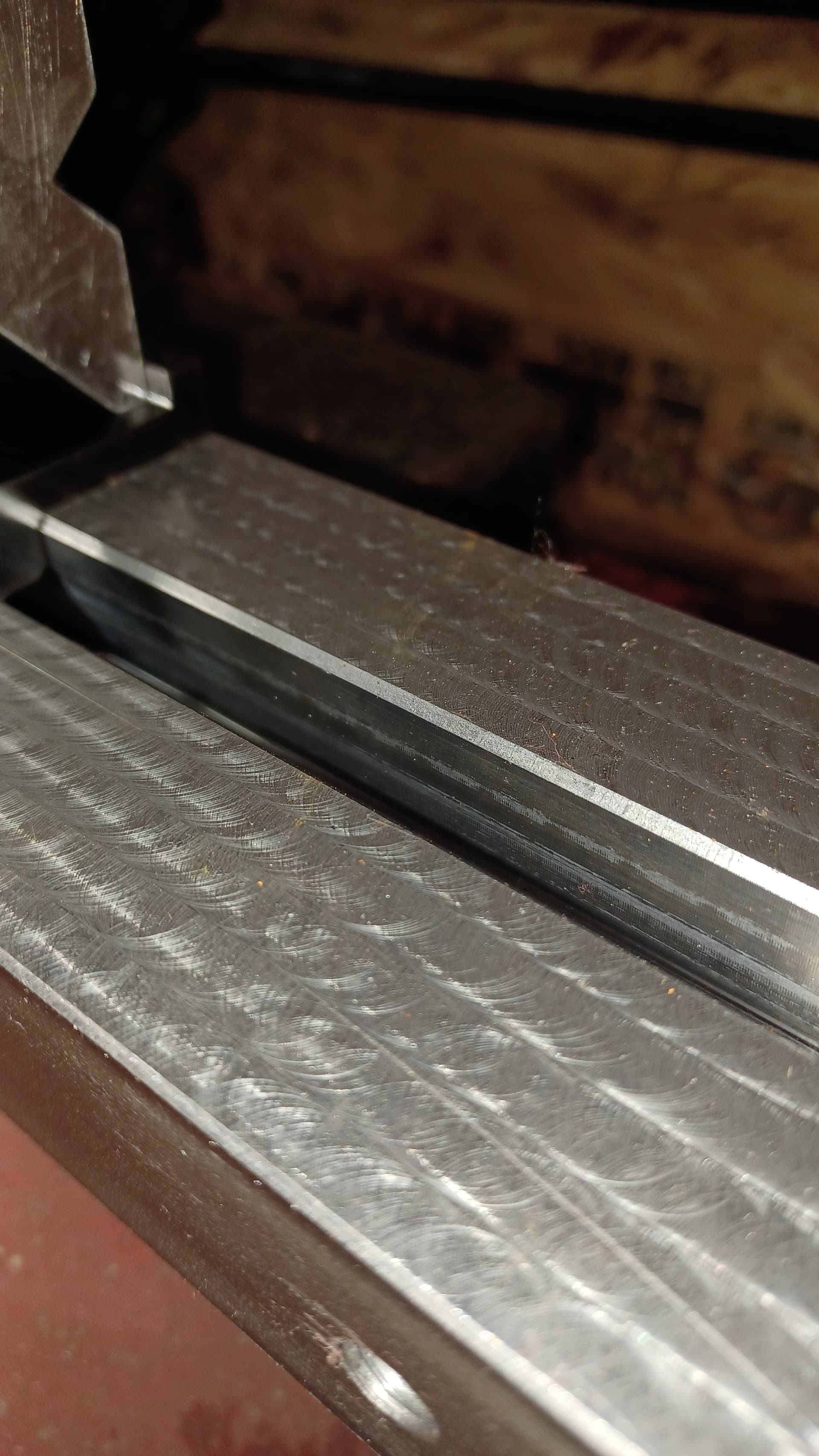

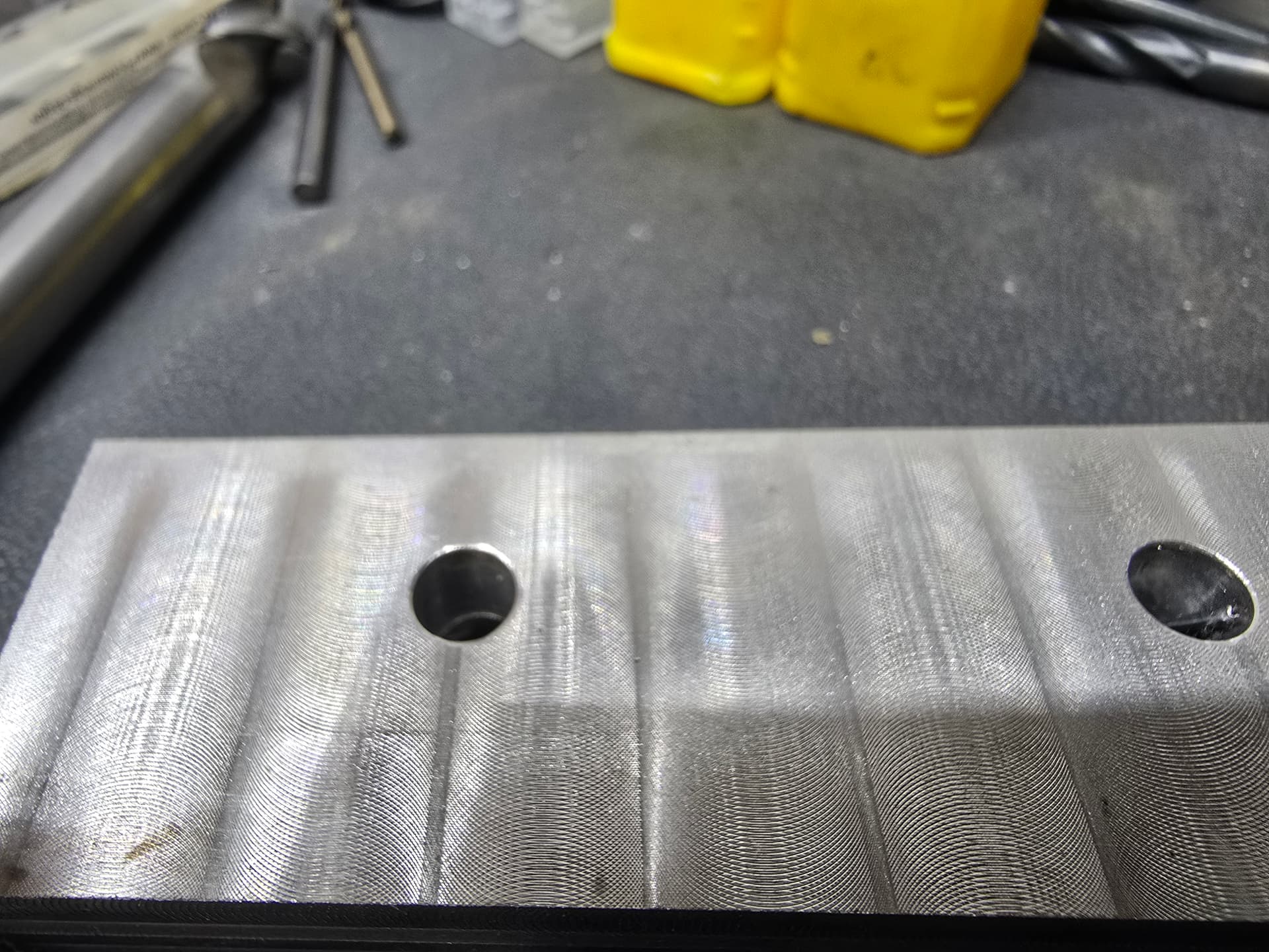

I don’t snap pictures of parts often, but I have a picture of a fly cut surface on a block. Customer wanted a good finish on a mating surface.
T6061 aluminum
Most of the time I don’t have a surface finish requirement for what I’m making so feed lines aren’t a concern. I’ll see if I have something handy to snap a better picture of the finish.

Looks nice! Lets see more of these.
How did he like the surface finish? I take assume the customer wanted a sealing surface? I can see the 2 passes from the fly cutter, doesnt look like a fingernail catcher at all. Have you ever checked it with a straight edge and a flash light and see if light passes under the straight edge?

Better than that I can tell you the flatness on that surface was 0.0002" from corner to corner diagonally. And yes, there was a gasket between that plate and the valve body it mounted to.
I am pretty particular about my mill and took the time to tram it in as close as possible.

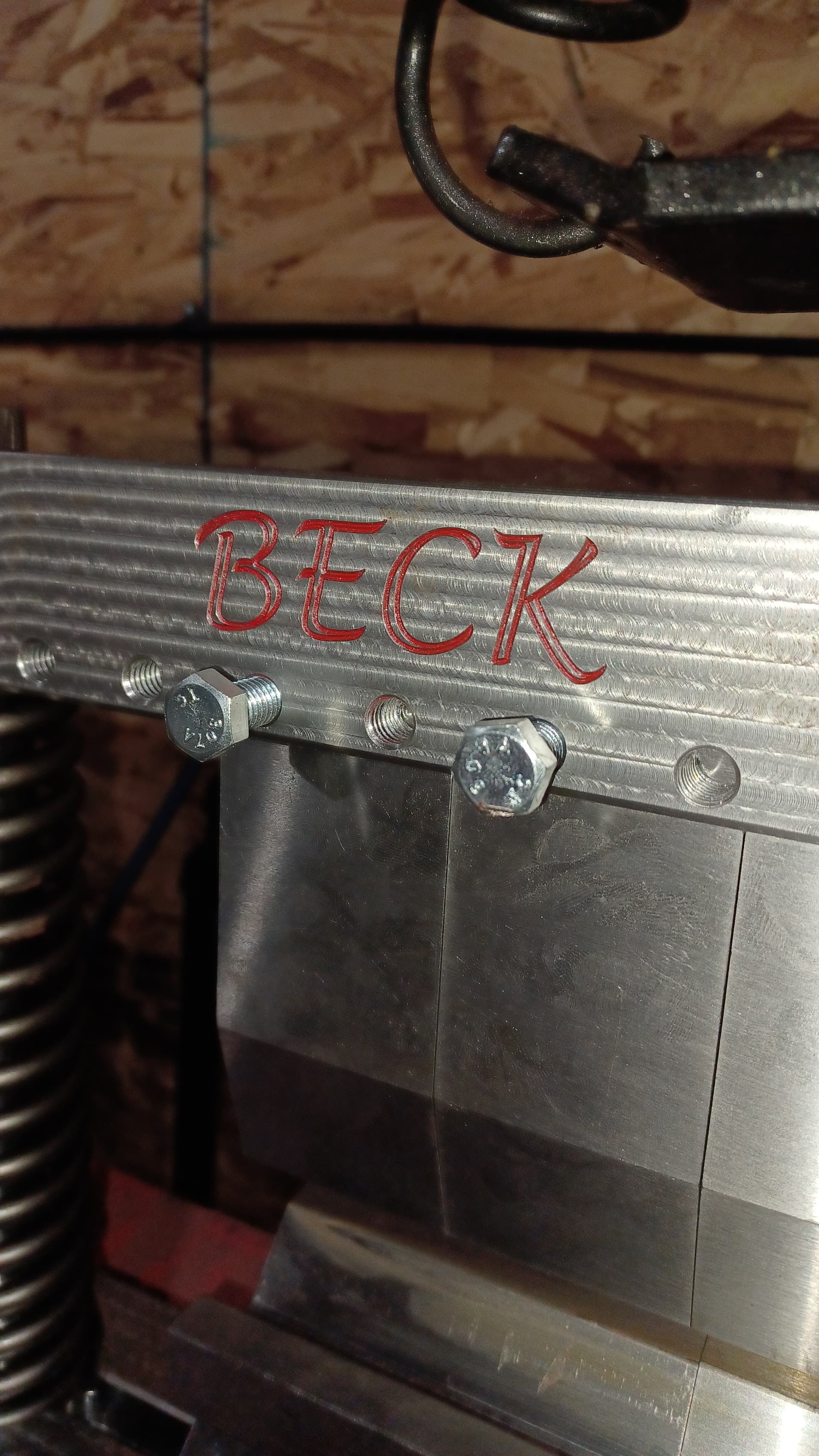

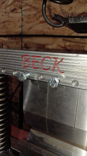

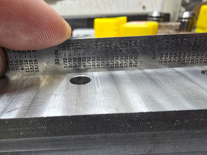

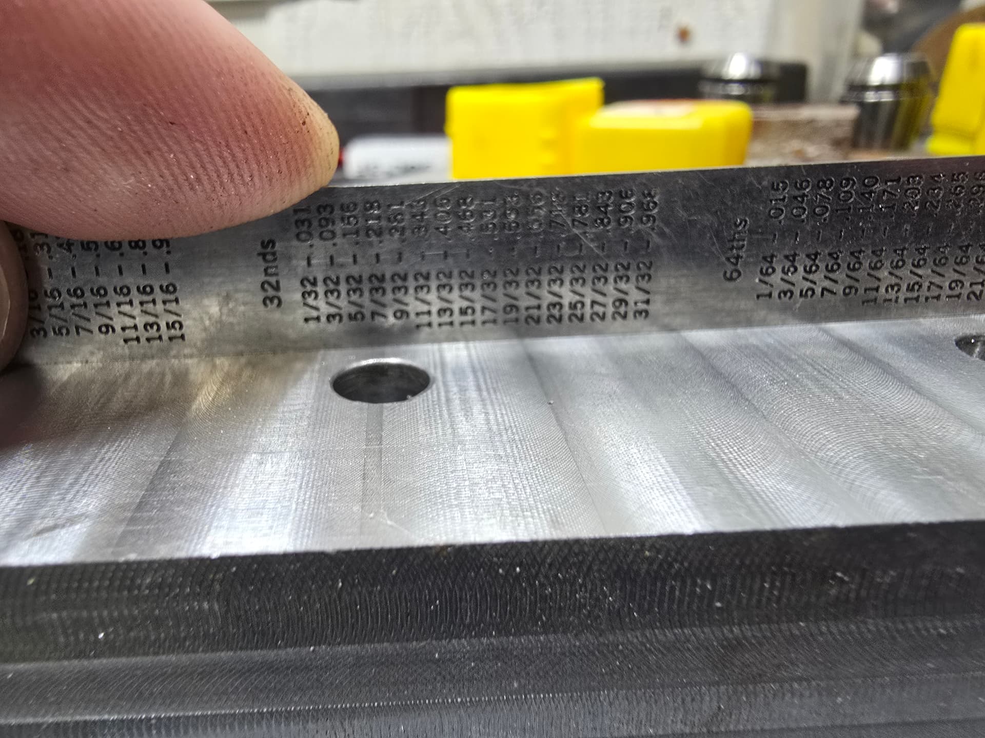

Even on more rough passes it’s still very flat. Here’s a couple of pictures of an aluminum spacer I machined. It was finished at 8,000 rpm and 60ipm feed rate with a 2 flute mill, so not a show stopper, but the parallel between the surfaces was more important.
As you can see, there’s some pretty heavy looking feed lines.
With a 6" scale laying across it is still very flat.
I don’t have any really pretty stuff to show off at the moment, just some tooling laying around from other jobs.

Fantastic!
Thats what I like to see. If you cant already tell I am particular as well. I want to know that this is up to my standards. I dont scoff even at the 2 flute pass. Pictures often make things look WAY worse that they really are. And I dont expect a 2 flute to be the best at finishes.
I too am a 6" scale carrying type of guy. I have them all over the place so I never need to go looking for one.

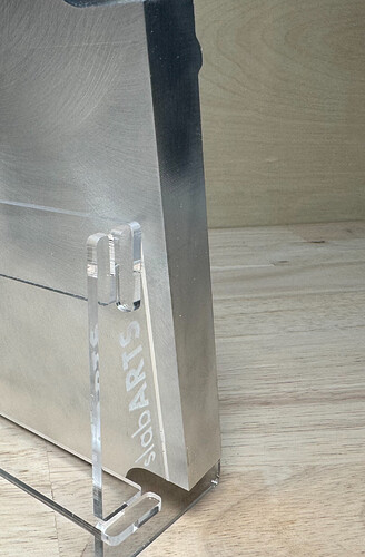

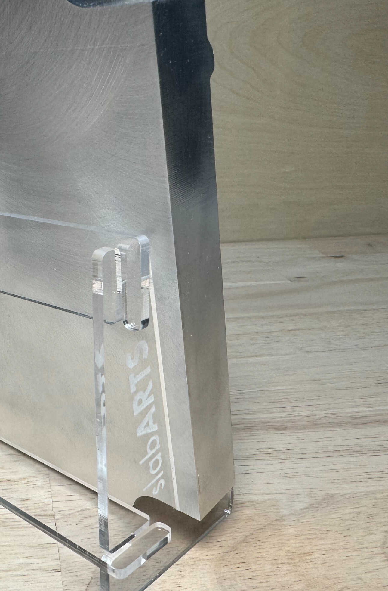

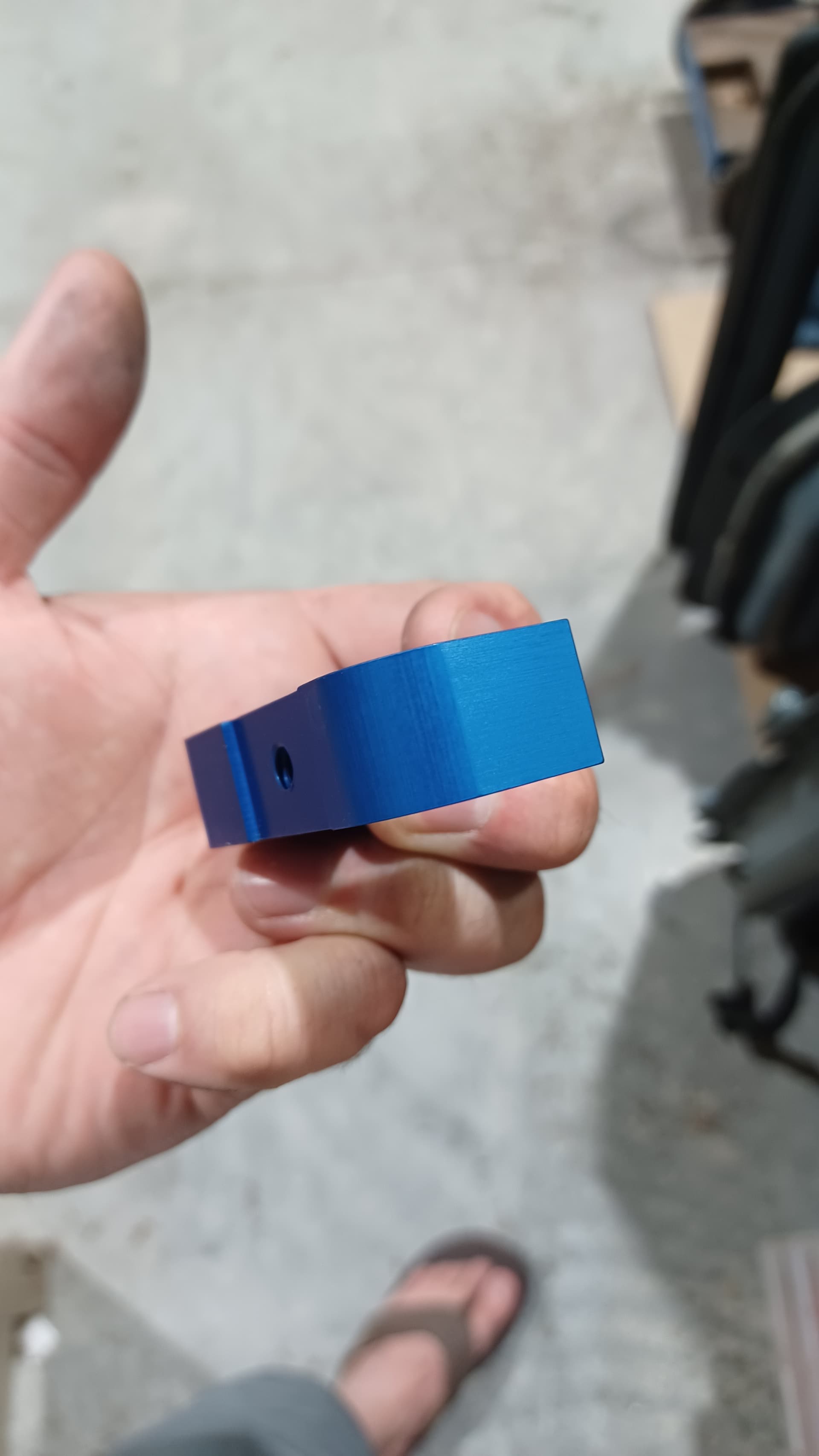

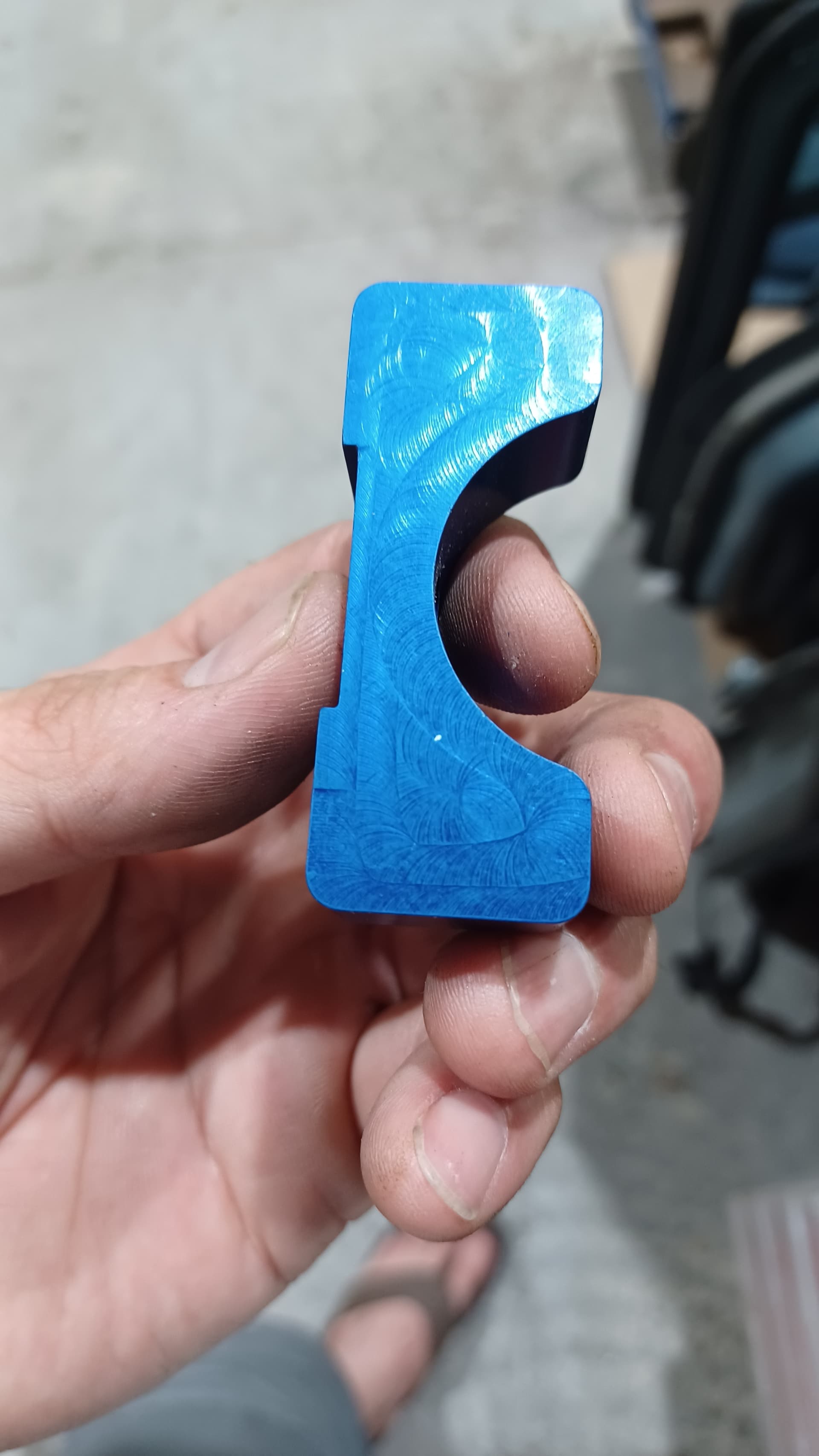

After sand blasting the recess part you can’t see any tool lines at all.
Wall finish on the blue part looks good. The face looks like there is a ridge. If you drag a finger nail across it do you feel it? I know you said you didnt tram yours super tight.
You can feel that just a tiny bit. That was because my Z axis angular contact bearings had a little backlash in them. Those bearings are tiny. I’m on my third set. Having said that I’m running production and pushing it super hard.
I run a .010" finishing pass at full depth (8,000 rpm, 40ipm) with this endmill. 10mm Dia. Carbide End Mill, 3 Flute, Uncoated, 10mm Smooth Shank x 25mm LOC, 1mm Radius, HSAM2
That endmill is a beast. As long as I clamp the parts tight enough and I don’t rip them out of the vise I can run hundreds of these blue parts on 1 endmill. I also can’t push it to hard or it pulls out of the ER-20 collet. I can go 8,000 rpm, .375" DOC with .060" stepover, 100ipm. There is enough power for a much larger stepover but pullout becomes a factor. I also used to run at .75" DOC, with .030" Step over but the chips stack up soooo fast I started going .375" DOC to make them smaller. I don’t want to use my chip breaking endmill because tool change times stack up really fast if you’re running 100+ parts.

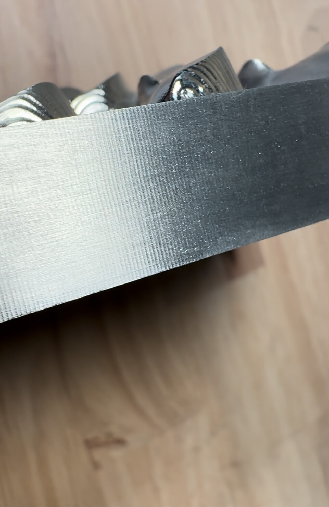

Generally, I’m pretty happy with the surface finish but I’m also not looking for ground level perfection on side walls. I’ve got some near mirror finish side walls with a 1/2 end mill, I’ll try and get a picture if I remember.

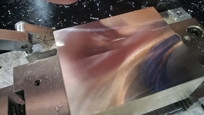

I’ve dialed my machine for a flymill. It was a pain. Lots of shimming. The results were worth it.

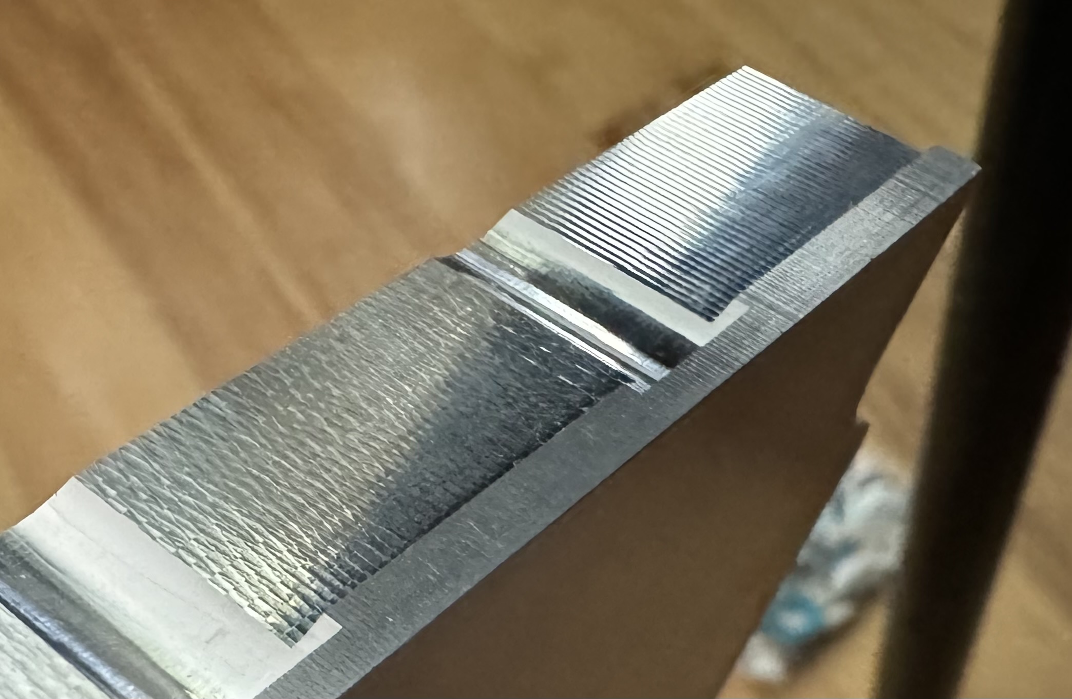

Looks pretty good. I know pics make things look worse. I always drag a fingernail over it & feel for the ridges or if fingernails catches it. If it doesnt catch or make a zip noise going across the surface then its pretty smooth, a thou or less typically.

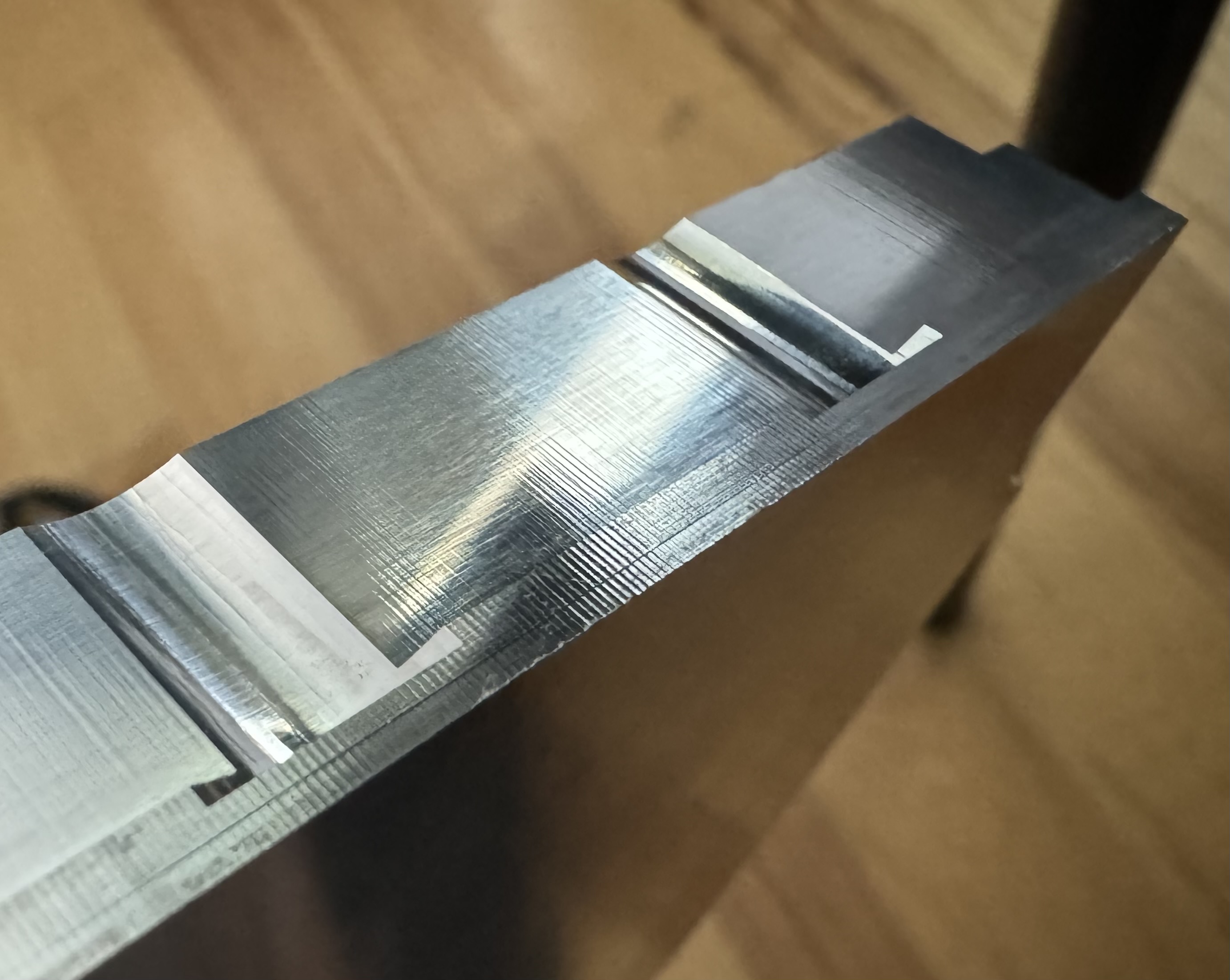

Here’s a photo of the best side-wall surface quality test blank I created (looking at the larger flat). My finger can’t feel anything moving across this surface and my nail doesn’t catch any texture.
Shouldn’t be shocking, but it’s also easy to get mediocre wall surface finishes. They are somewhat visually interesting, which is also my thing.
