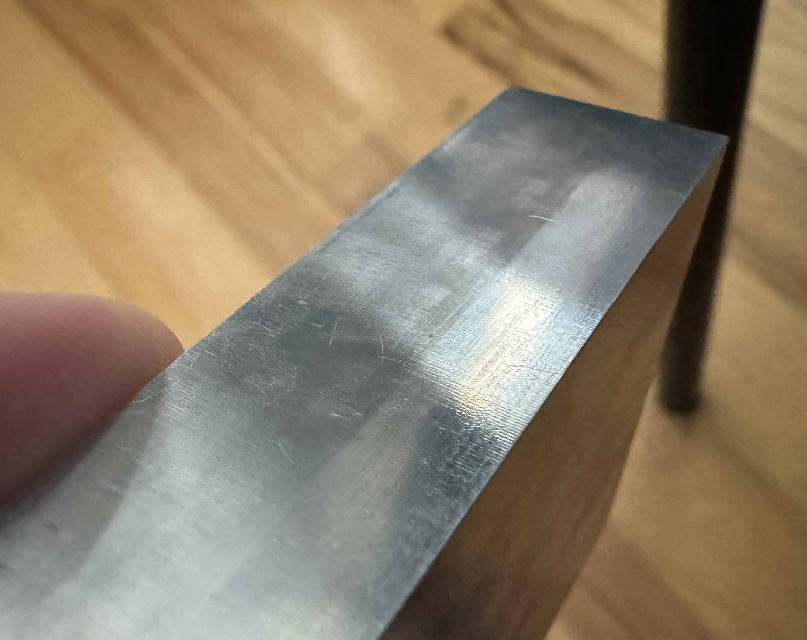

With low feed parameters, you can get a near polished surface (you can see in the picture how normal handling has put a few micro scratches into the part at random angles), but it takes a very long time and the tool is basically burnishing rather than cutting. Not great for the tool and the side wall coloring becomes uneven and takes on a “worn” look rather than “freshly machined”
What end mill are you using?
This was all done with a 2 flute Lakeshore Carbide 1/2” ZrN coated end mill into 6061 aluminum, flood coolant.
How many flutes?
edited above, sorry about that.
Have you tried a 3 or 4 flute?
I haven’t, up till this point, I’ve prioritized chip evacuation and on the bigger aluminum tools, the MR1’s rotational capacity and horsepower are well matched to a 2 flute. On the smaller tools (1/8" and smaller), I’ve considered moving to a 3 or 4 flute since the 8000RPM limits the surface speed of the tool long before the machine hits any kind of power limit.
My understanding is that I won’t see a difference in surface finish between a 2, 3, and 4 flute alone. It’s all about chip size and chip evacuation. The flute count just allows you to effectively increase the surface speed (at the same RPM) at the sacrifice of chip evacuation.

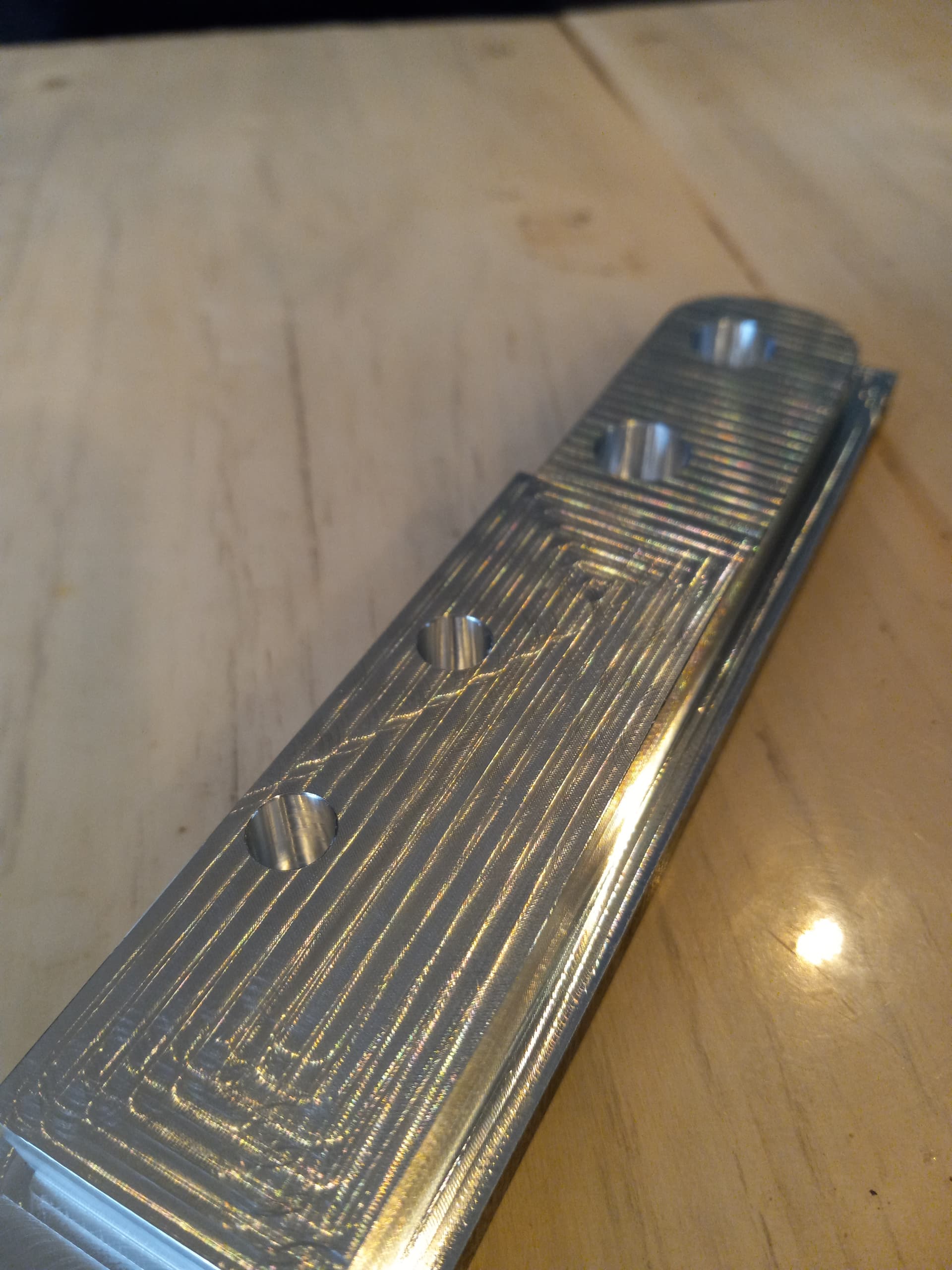

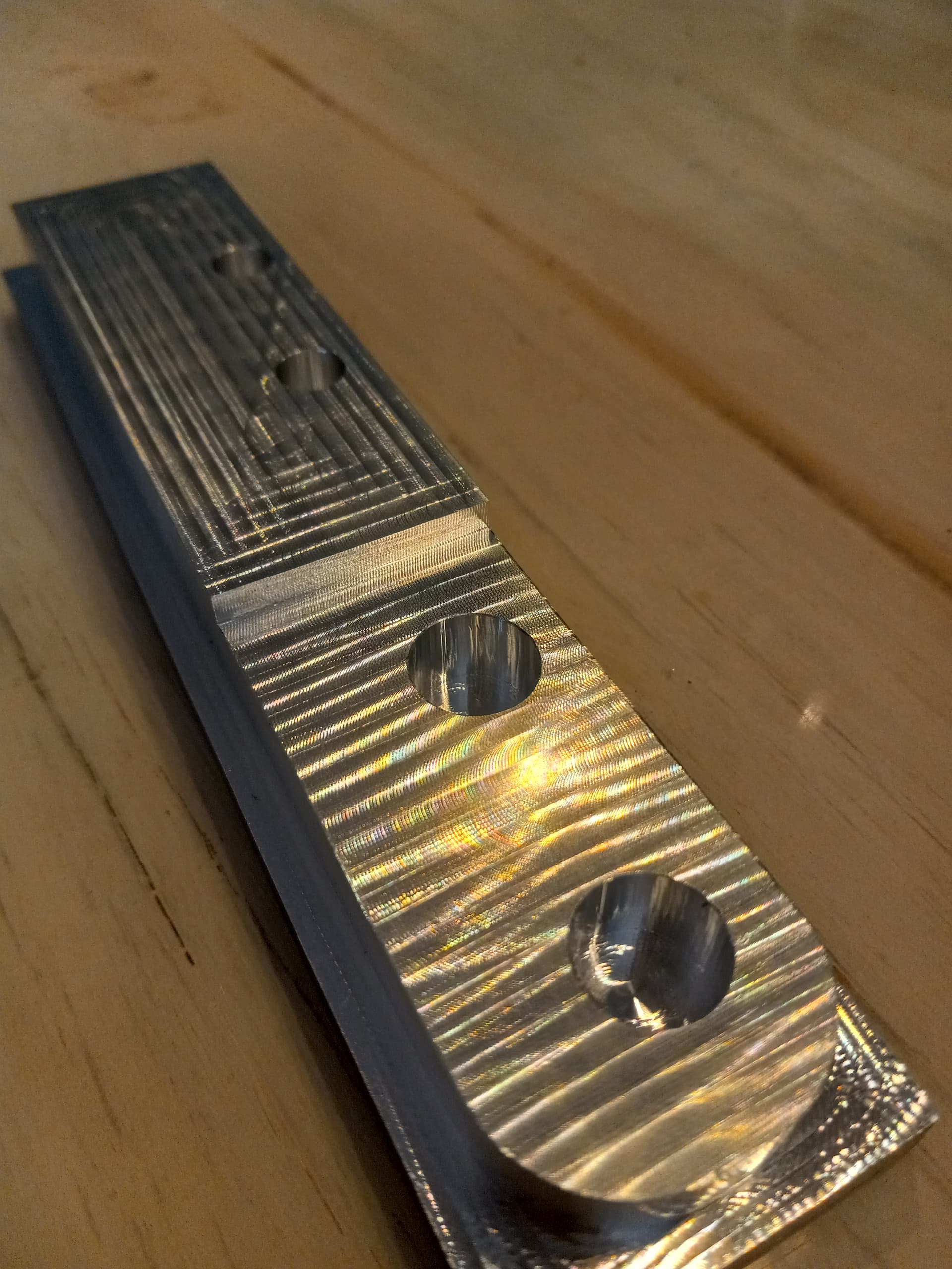

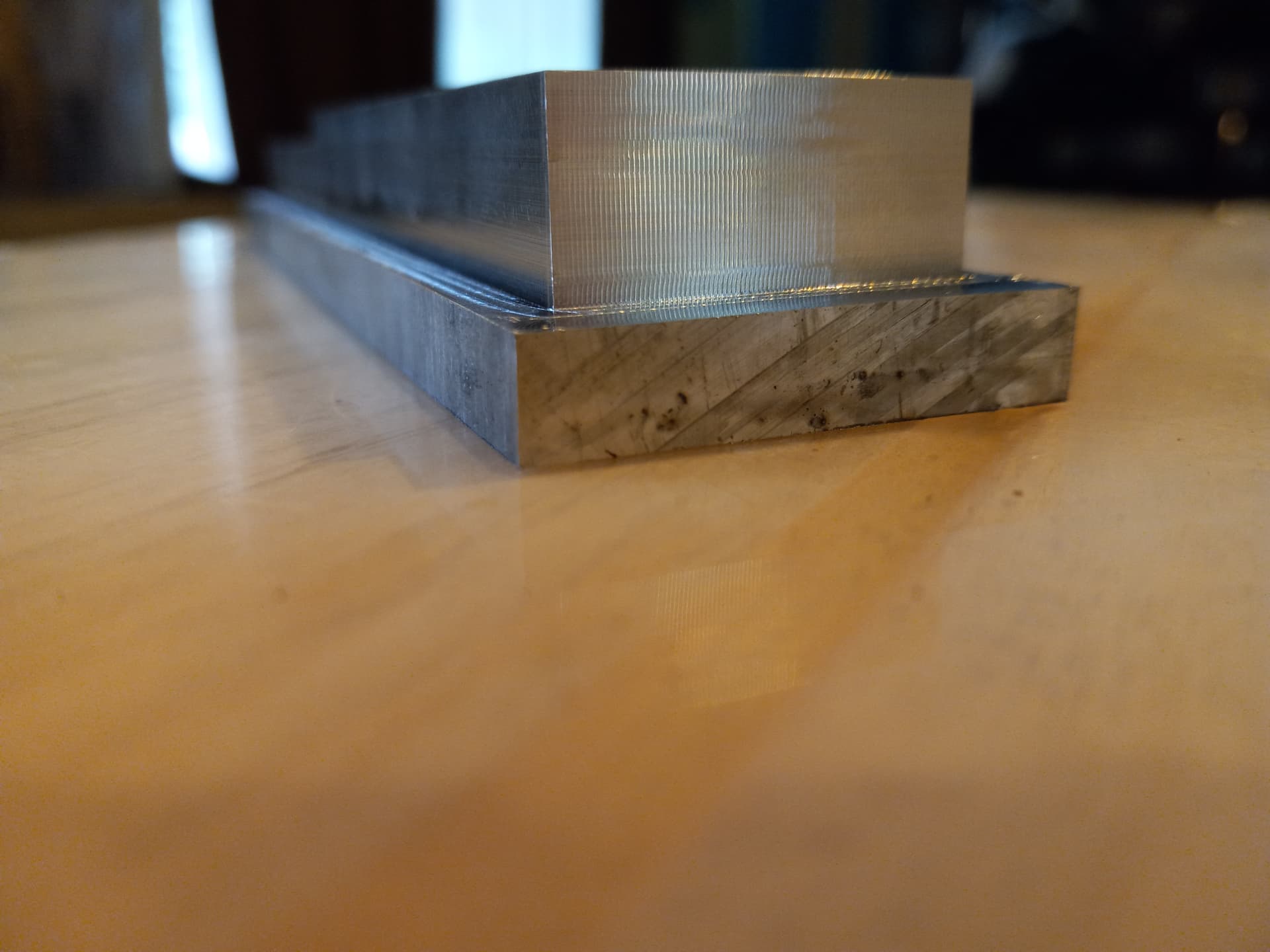

I dont’ have any pictures, but the high speed tool paths leave a great finish both radially and axially.
Id like to see those high speed finishes
Was able to nab a couple pictures.
