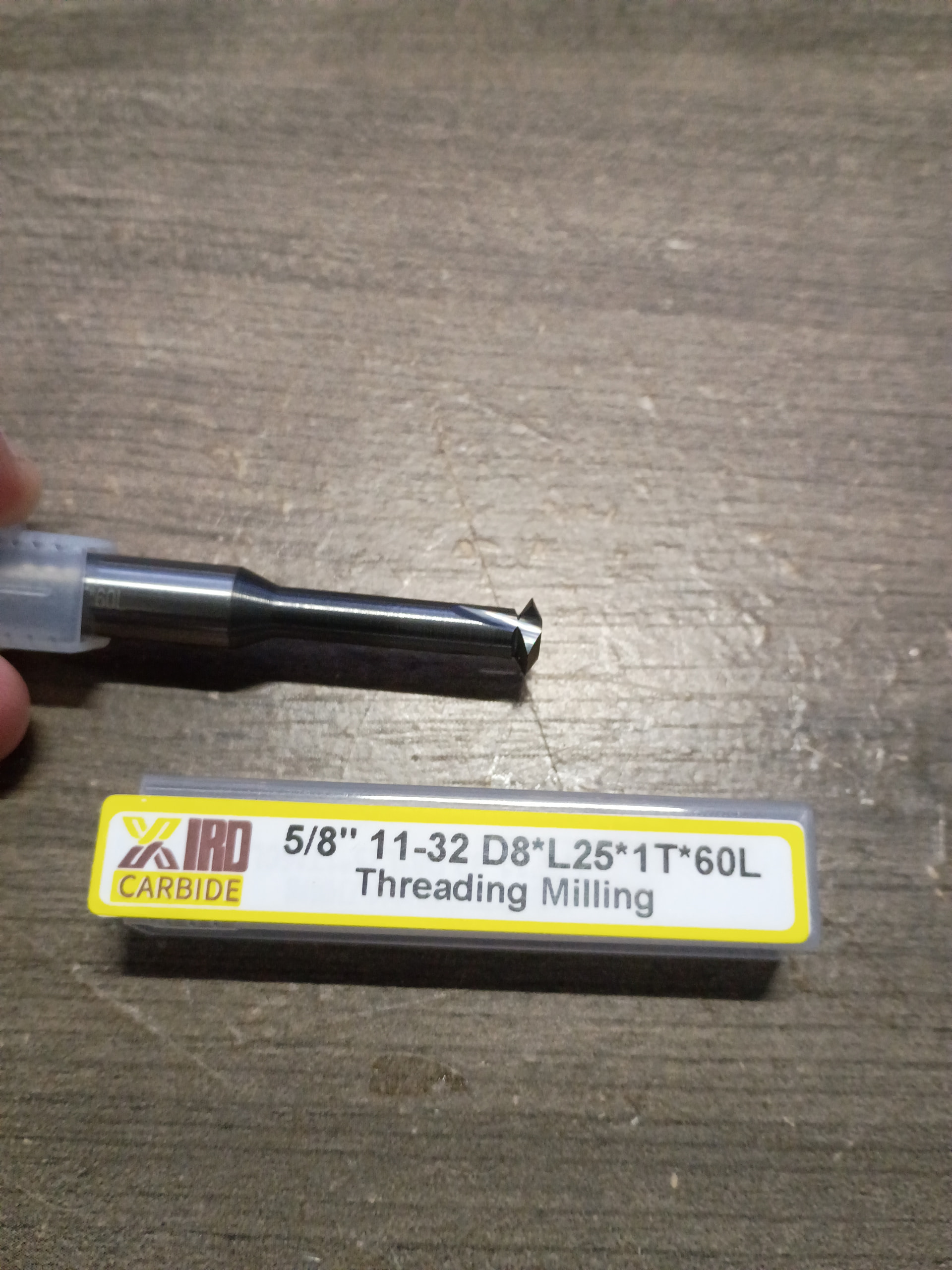

That thread mill is obviously made with metric dimensions. 8mm shaft 60 mm long. Imperial thread with metric dimension. This is what I would use.

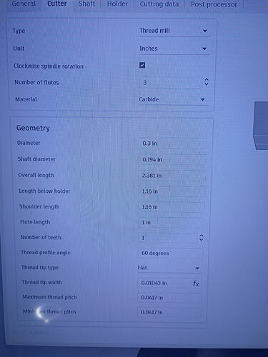

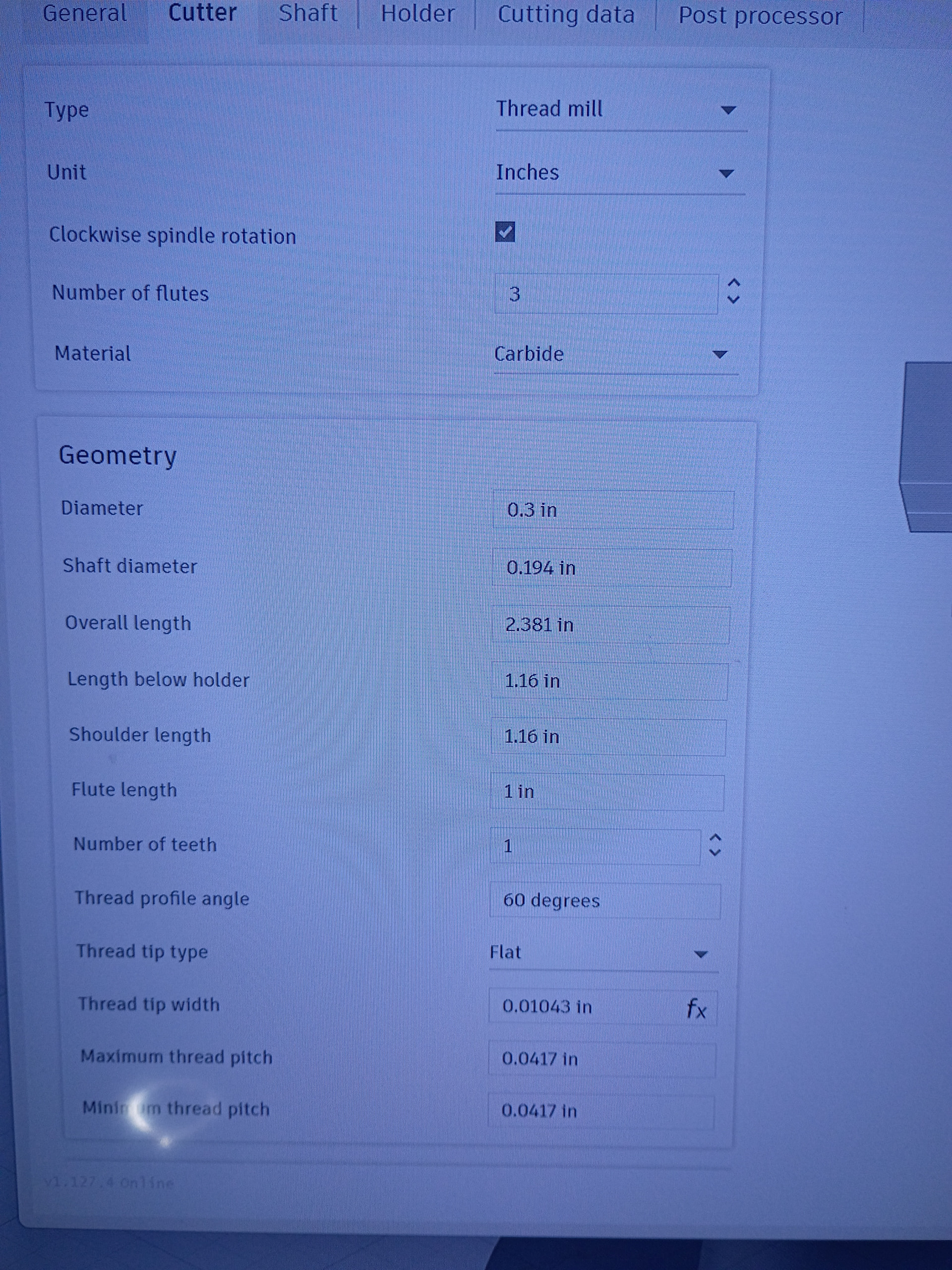

Another big issue is these tools dont have any legible info on them. The tool i have says 5/8 11-32. Ok great it does 5/8 threads from 11 to 33 tpi. But then theres a d8 l25 1t 60l that has no meaning. Theres no guides for it, whats the angle for the cutter? Whats the crest size? Whats the thread tip width? You need all this info for the tool library and it seems no tools have this info. Its all coded mumbo jumbo.

Thread pitch is always 1 divided by the number of threads per inch for imperial units. 1/4-20 is 1 divided by 20 or .05, 5/8-24 would be 1 divided by 24 or .041667. That’s the number Fusion wants input. I suspect that since your tool has metric dimensions D8 means the tool cutting diameter is 8mm or .315 inches, L is cutting depth 25.1mm or .9882 and T is over all length 60 mm or 2.362. Check these measurements with your calipers and input them in your tool library .
Thanks for explaining that, when a thread mill has a range of TPI, like this one going from 11 to 32 do i but .0909 and .0312 in the max and min thread pitch in the tool library cutter tab? And then on the actual threading operation i put .0416 on the thread pitch box and that will determine what thread gets cut with that tool?

Yes , enter .0909 for max and .312 for min in the tool library. Entering .0416 in the thread pitch box will determine what thread per inch gets cut.
Don’t forget input the pitch diameter offset in the geometry tab. You can use the NYCNC excel spreadsheet to calculate it. The offset is dependent on your CAD model. If you drew the model with 5/8 (.0625) holes the offset will be different that if you drew the model with 19/32 (.594) holes ( this is the hole size for a 5/8-24 tap). To get the crest size you will need a magnifying glass to observe the very edge of the point of the cutter to measure the flat on the end. It may look like the cutter comes to a sharp point to the naked eye but it has a flat on the end somewhere between .003 and .001. You need this information to correctly calculate the offset.

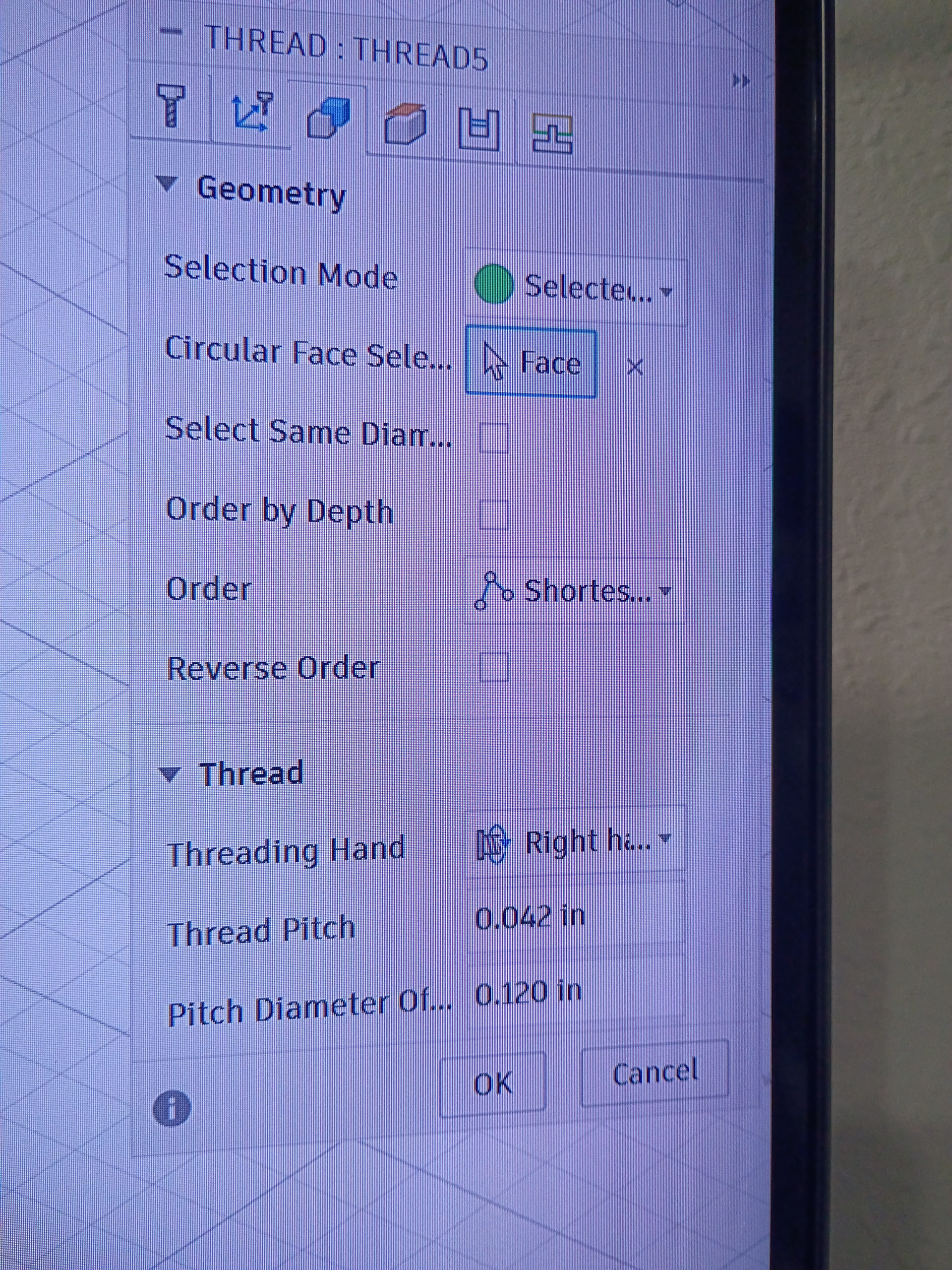

Awesome thank you, 1 last question. Pitch diameter offset is what i need to dial in correct? Should i take major diameter and subtract pitch diameter for .0271 and punch that in first or should i start shallower and work my way up.

The pitch diameter offset can be dialed in , if you start with a crest size of .003 the offset for a .625 modeled hole is .005. As the crest gets smaller the offset get larger. What size is the hole in your CAD drawing?

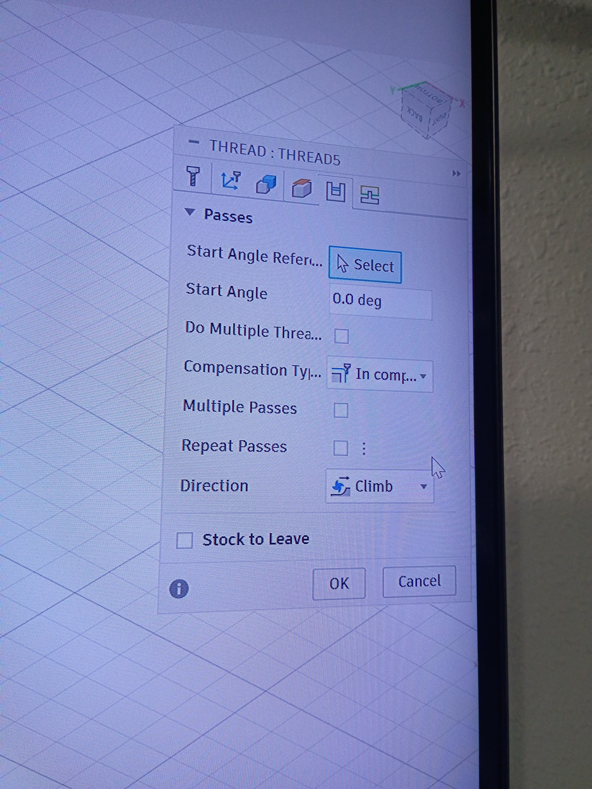

Don’t try to cut the thread in one pass. That creates too much tool pressure. Use multiple passes 3 to 4 with a .010 step over. Yes this will take longer than a single pass but will keep the tool from breaking.
The hole is .625 but i think now that you mention it i screwed that up, it should be thr minor diameter of .575 correct?

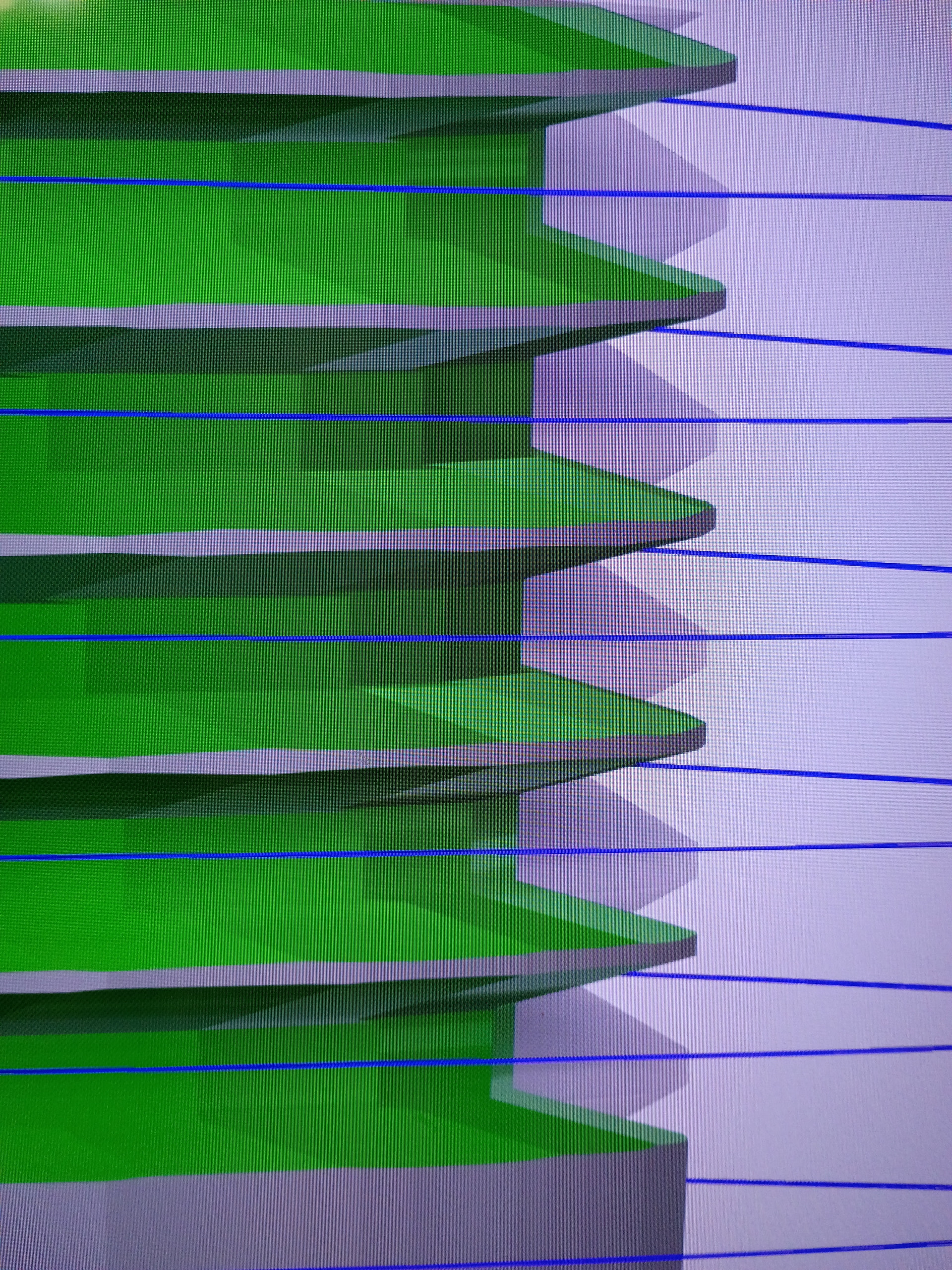

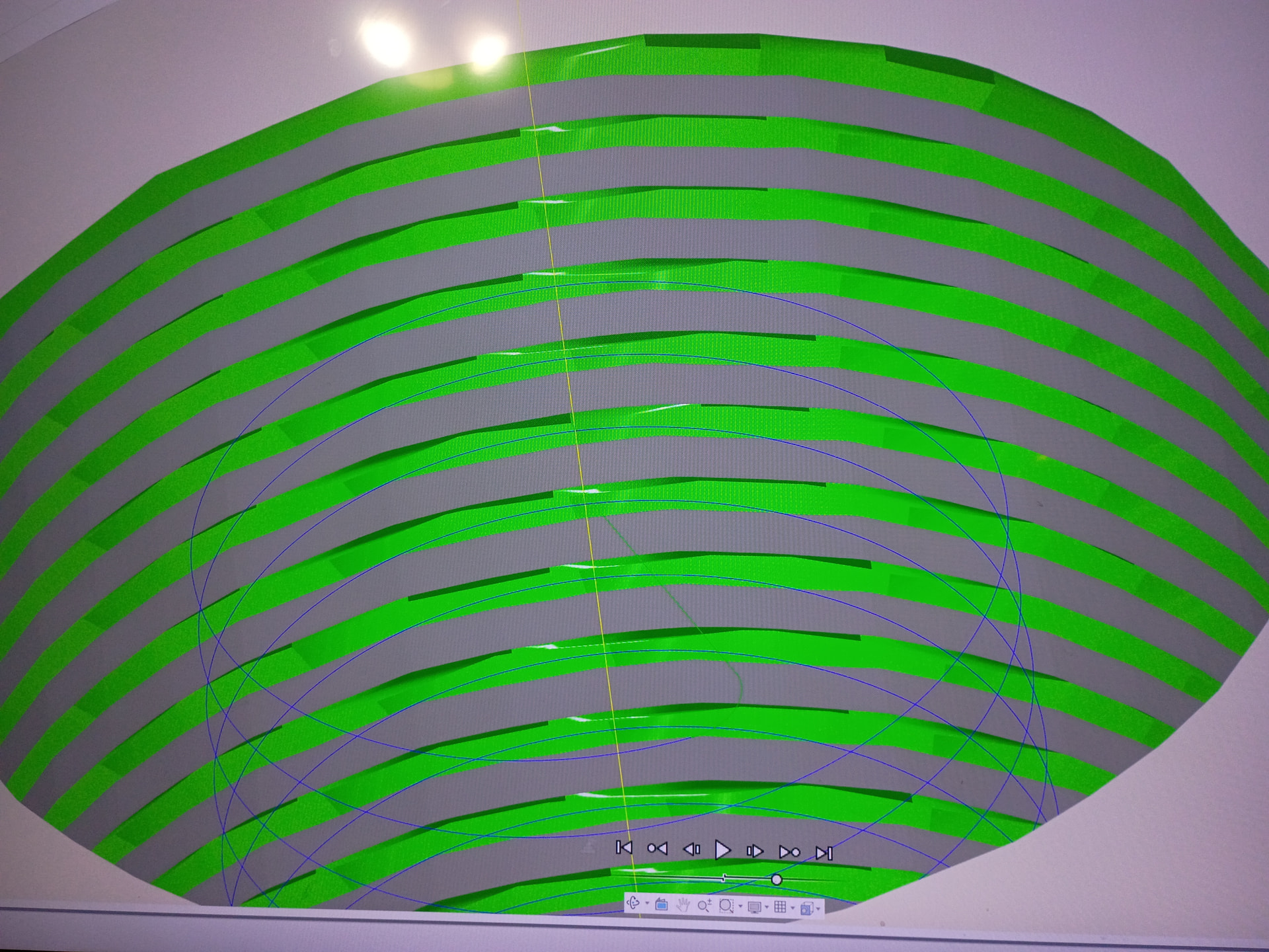

I redid the op for multiple passes at a .027 pitch offset, the first 2 passes dont cut anything with a revised hole diameter of .575 the last 2 do all the work.

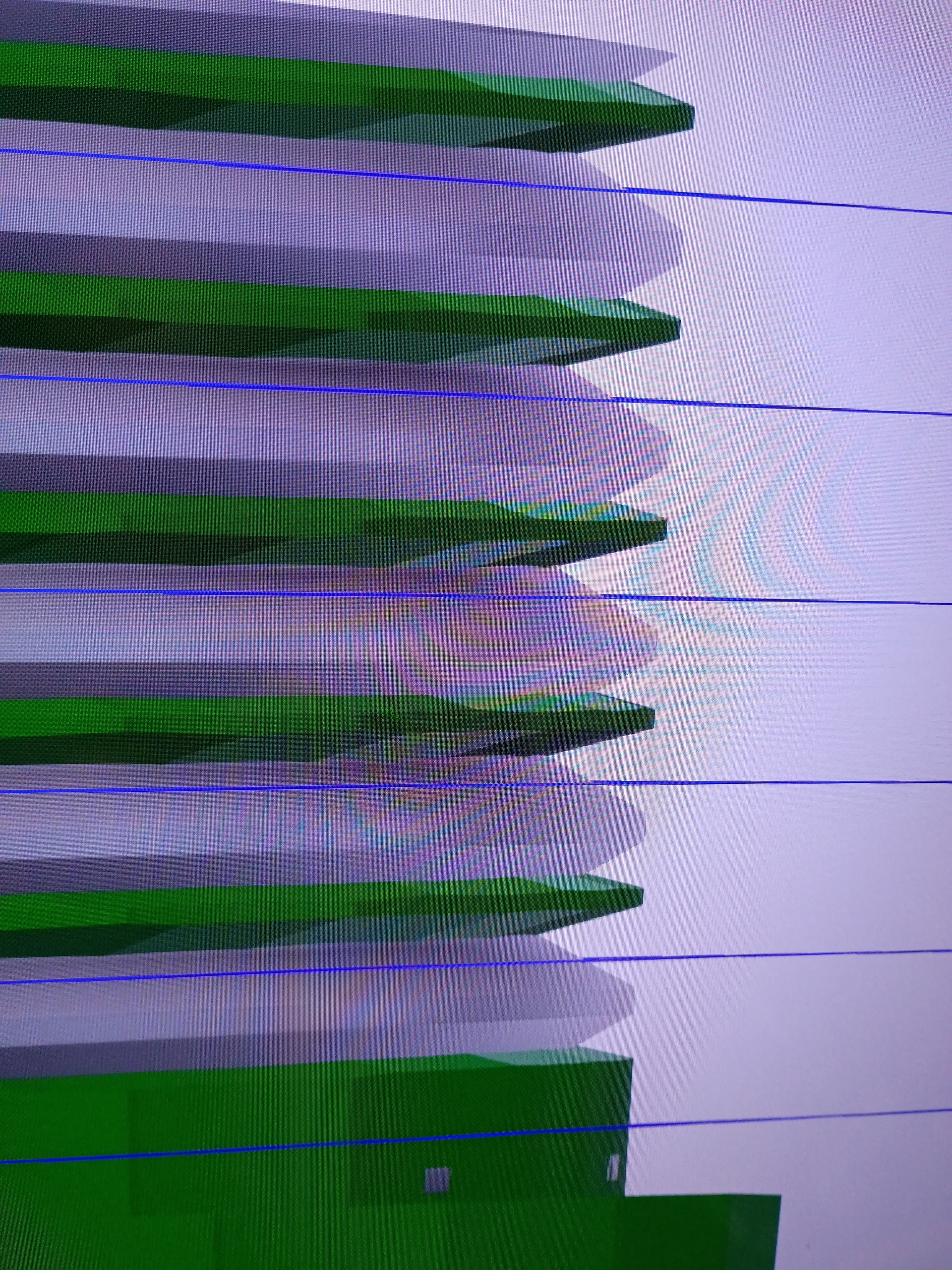

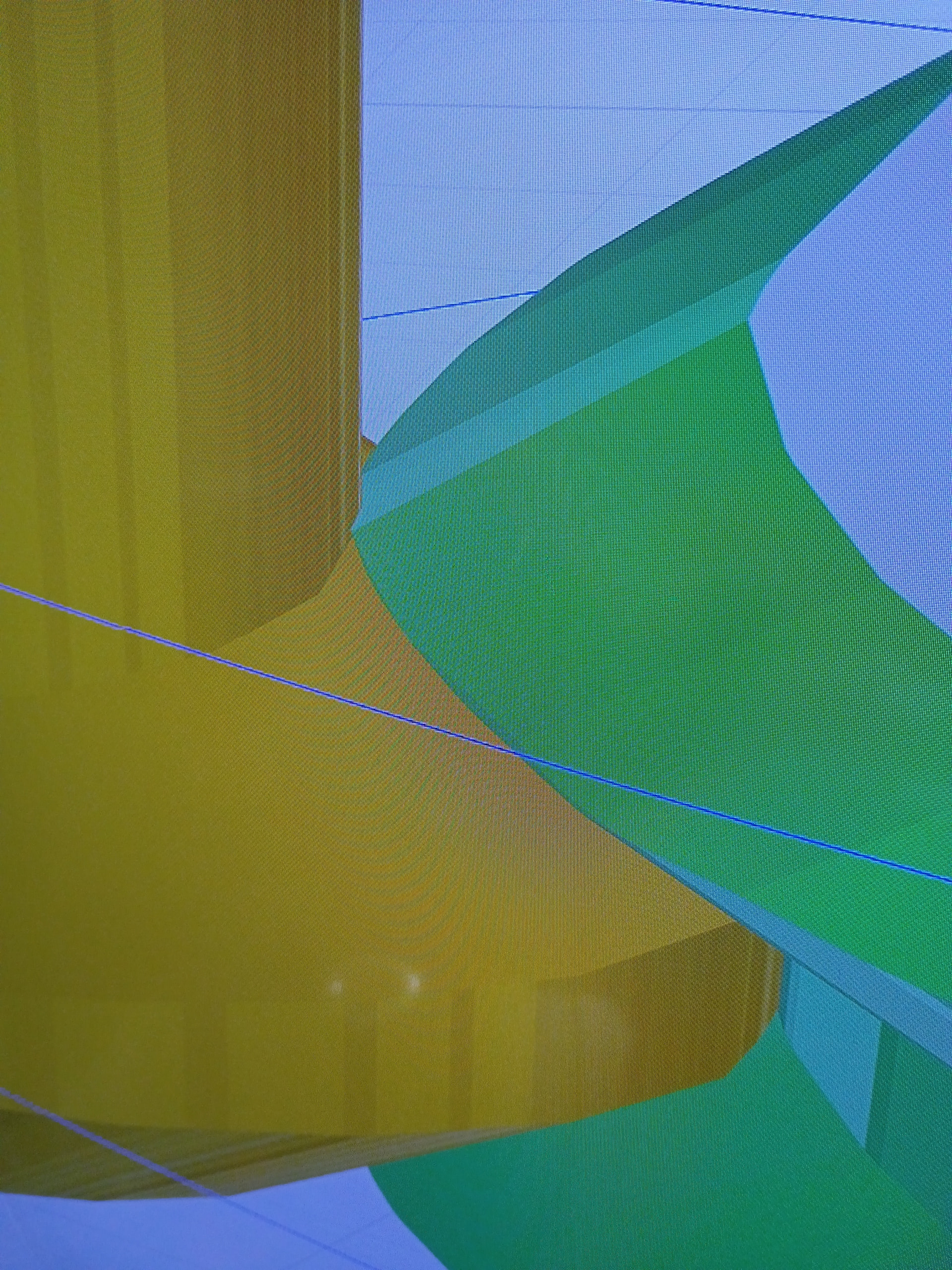

So im trying to use formed threads from the design by selecting the groove crest and running the op and im just getting this ghost layer. Its like the TPI is off but im using .042 for the pitch. With a .024 pitch diameter. Assigning the thread function to the groove crest should make it follow the threading like a normal mill OP but it isnt. Also it doesnt appear that the thread grows more offset as the thread is formed down the shaft.

I believe the start angle was off. For some reason the op didnt follow the design thread it started wherever it wanted. I was able to rotate the start angle 225 degrees and line up the threads.
