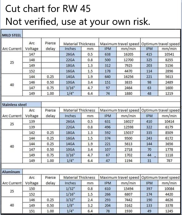

Hey guys I’m finally getting around to cutting stainless steel 304 on my Razorweld. I do want to get everything right on my first cuts. What would be good cut settings that you would recommend to me? Thank You!

Here is a chart that I have seen a few times referred to but I do not have your cutter so I can’t confirm or deny that it is helpful.
Tin says you’ve got to keep it cool so fill the bed up with water and have a bucket to splash on while cutting. If you have fine cut consumables (not listed on this chart) but certainly worth trying.
I do have the RW 45 but I have never cut stainless. I have cut 16 ga hot roll and it would have 45 anmps and maybe 160ipm. I am not aware of any fine cut consumables for the RW

Here are a few things I do when cutting stainless.
-Peel the plastic film from material.
-cut height .02" pierce height .08"
-short as possible pierce delay
-cut as fast as possible while maintaining geometry
(start with 35 amps at 200ipm,I have a powermax 85 so I am taking a guess here)
-Pour water on sheet during cut if geometry is complex and could build up heat.
-(with the Powermax I use Finecuts unshielded)
This is my rough approach when cutting stainless with my power max you will need tweak these for the Razerweld.

Now BigDaddy gets excellent results with F5 gas vs compressed air. What settings do you use @Bigdaddy2166 ?
Never cut 18 ga Stainless steel. The Everlast cut chart is dead nuts on, though. I don’t know about the razorweld. The F5 gas just keeps the edges from oxidizing. Almost all my Stainless steel is 10 ga and above.
Hello Sir, I recently cut a bunch of 10ga. stainless using compressed air and results were impressive. Of course a little clean up is required especially due to the sugaring edges on the back side, but nothing unbearable as SS cuts are not requested often. I also use the Razor cut 45 on the Crossfire XR. I will share my settings when I get home this afternoon.
Sorry for the delay, just back in town. My settings for 10ga stainless are:
Regular nozzle
Feed Rate: 100 ipm
Pierce Delay: 1.2 s
Pierce Height: 0.15
Plunge Rate: 50 ipm
Cut Height: 0.0625
AMPS: 40 Razor Cut 45
