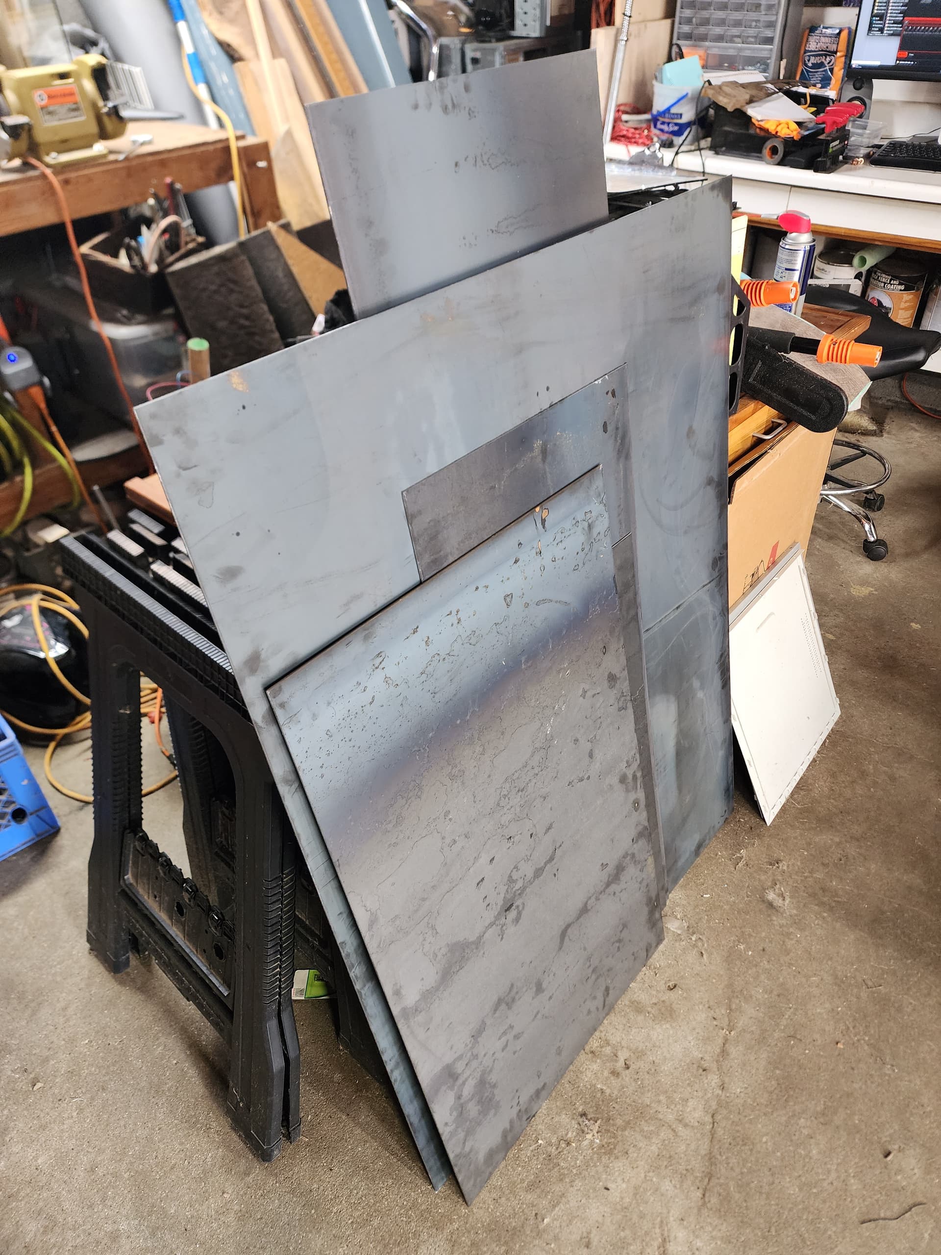

After getting off work this morning I went to my metal supplier and picked up 193 pounds of drops.
One man’s drops is another man’s treasure! At $1.05 a pound, I wasn’t complaining. I got seven sheets ranging from 16 gauge up to 1/8th inch. Most of it is 1/8th and that’s really thicker than I was shooting for. I’m still new to all of this and didn’t have my calipers with me. Still a decent haul. It won’t go to waste, I was just wanting more 16 and 14 gauge, live and learn.

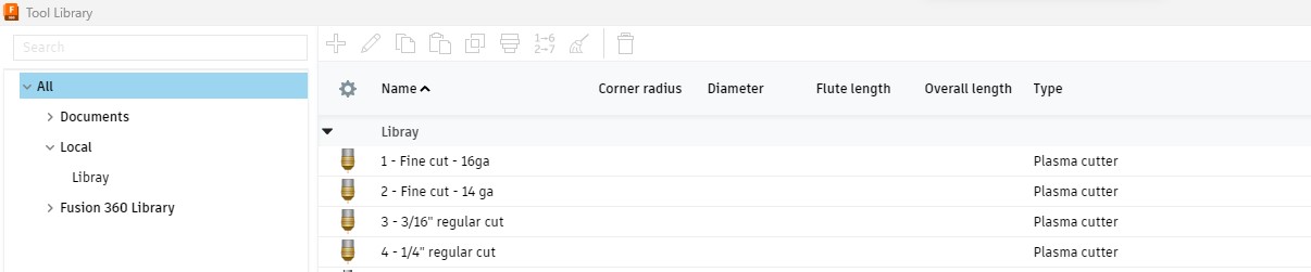

So I have hypertherm 45xp and run fine cut tip at 150ipm & 40 amps. Not sure but your IPM seem really slow for 16ga. and 45amps. You should check chart for steel and setup new tool so when you cut 16ga again its all correct and not guessing or changing it.

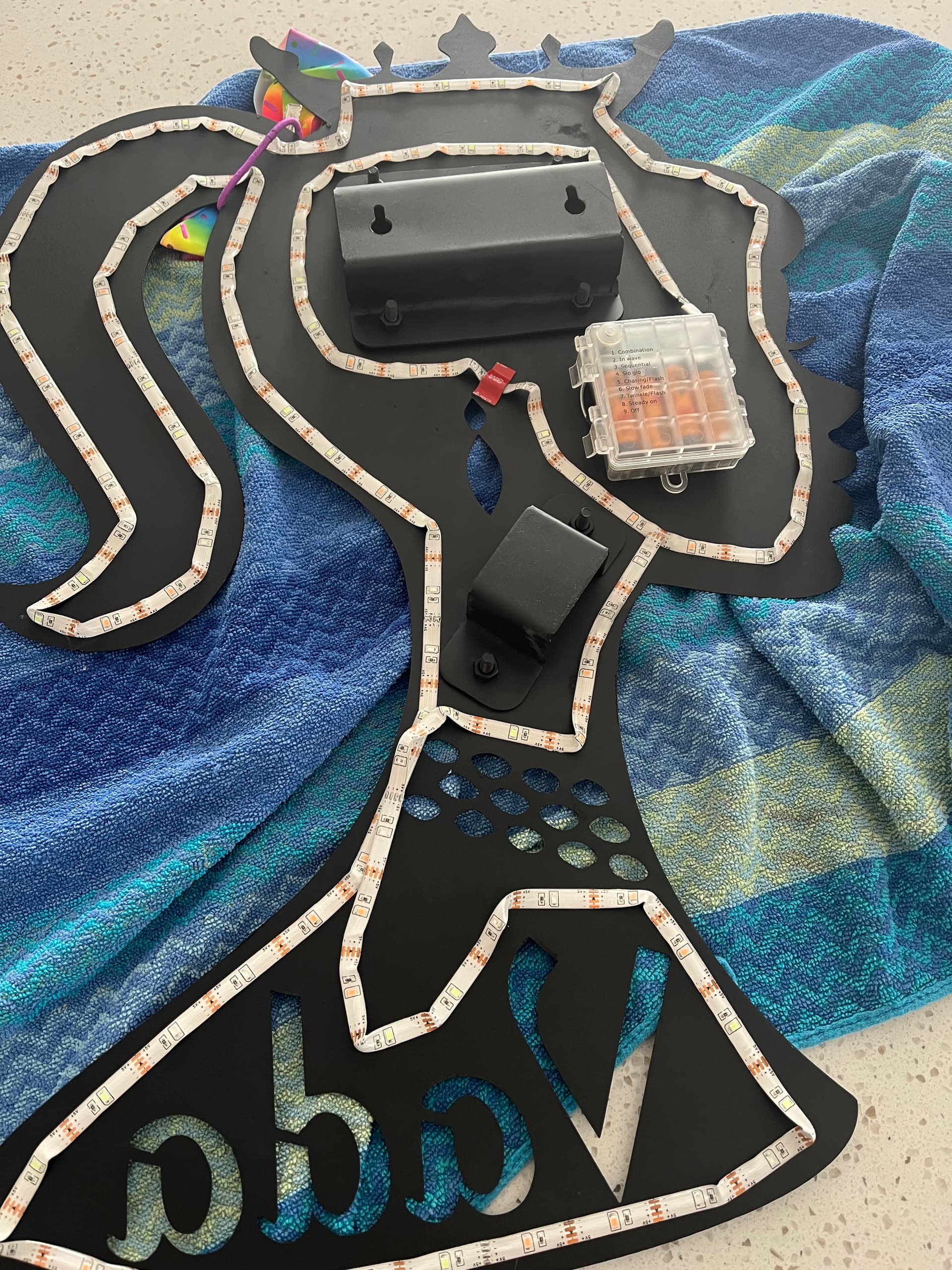

Yes, it’s a big wall sign because I added lights and wanted it to work for night light even. I set it for 2hrs and it automatically shuts off.
Back of my daughters looks like this…
I got pretty good about making my own hanging brackets but if you don’t have a bender and vise/3lb hammer it might be tough. If you didn’t want to cut them and use something else you can just not select them in setup.

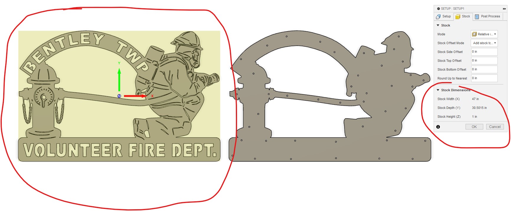

sign currently working on for local fire dept at them moment…
If you select “Stock” tab it will tell you size prior to cutting if you haven’t looked this this tab before.

Yeah, I had originally set it up for 1/8" but switched it out for the 16 gauge and forgot to redo my speeds. Of course it might have been slow even for the 1/8". I have a feeling that might be at least partly to blame for my dross problem as well.
