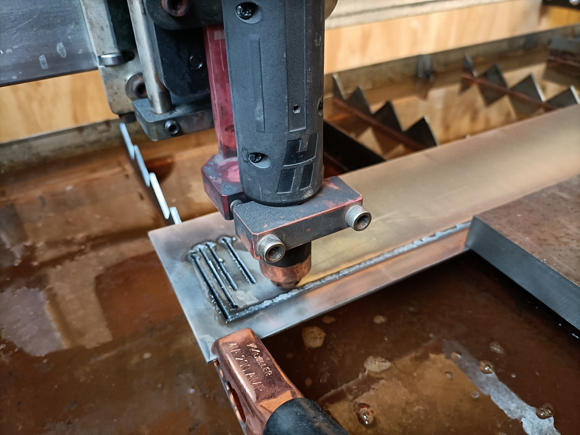

here it is.
the firecontrol sreen
plasma table and torch filmed
and here you can find the gcode file:
simple test 3mm.tap (3.3 KB)
and again an absurd program speed???
I managed to get the speed right (by deleting and re-installing firecontrol). But the cut failed after all
same piece as above, just smaller

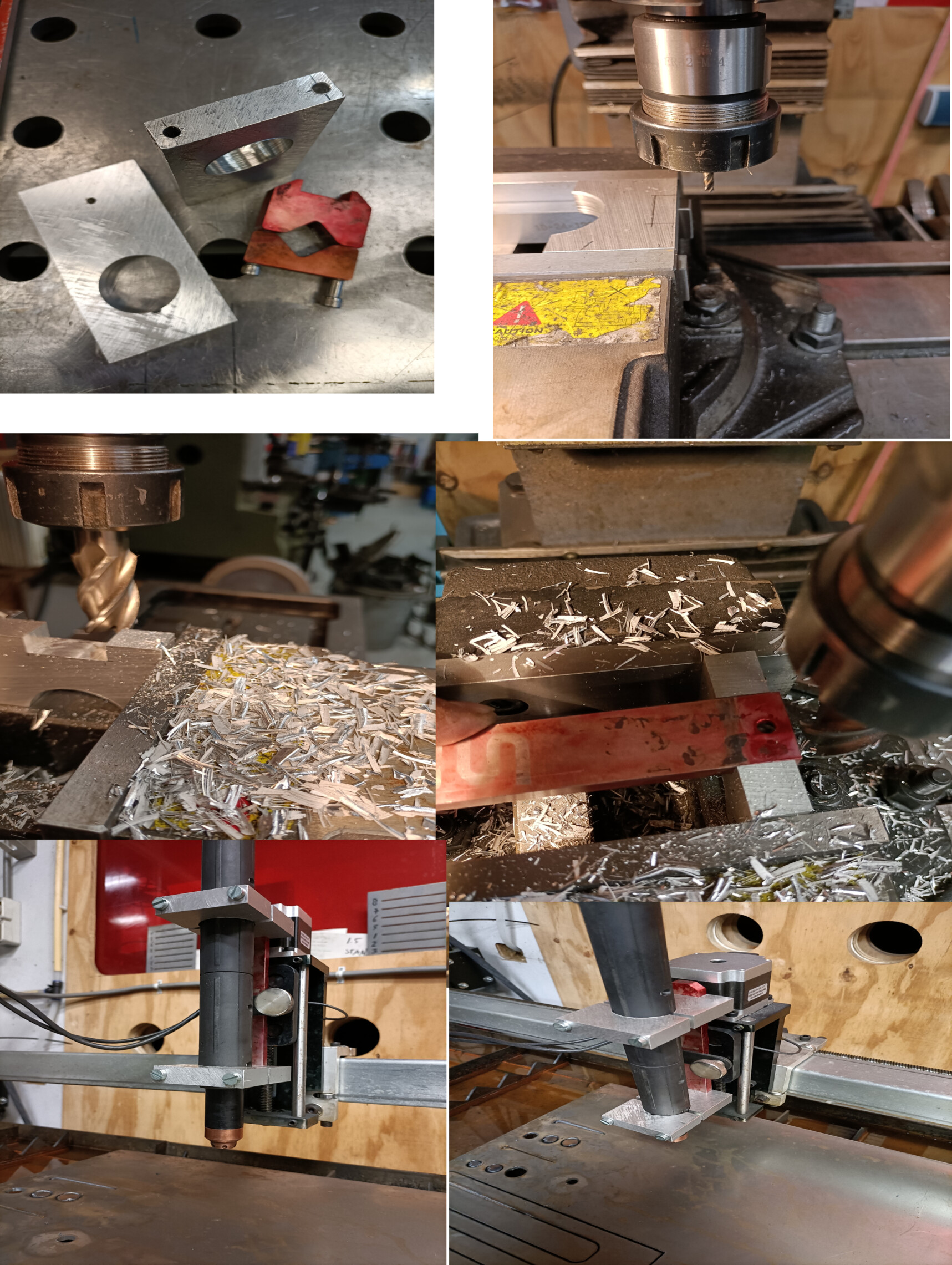

Maybe clamp the torch on the body instead of by the nozzle area?
as Bill_A mentioned, you should be clamping on the body of the torch and not the nozzle. you should really be using a machine torch holder which will clamp down on the body in 2 positions.
clamping too tight on the nozzle end will give you problems.

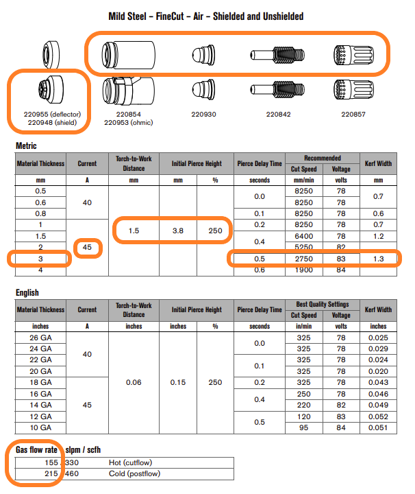

What consumable pack are you using? (As circled below, other?)
What is the condition of your consumables? Picture.
These parameters in your cut chart is what your aiming for if your using (3mm mild steel?)
It did seem your voltage was very close to the mark.
Is your air system keeping up during the cut ? maybe film a pressure gauge near the plasma.
How do you manage moisture in your air system?
Here is a link to the full service manual.
Watch the cut chart it is slightly different from the operations manual
The clip from above is from the operations manual.
Have you passed a THC test?
What kind of outlets is your plasma connected too?
Check your that your work lead connect is tight
LF 45xp work port
For your next test run can you complete a straight line cut using the functions in firecontrol without THC.
Thanks for the replies so far. I wasn’t able to do more test cuts yet. But I found the time to upgrade the mounting. The original mounting was to small and as I live in the Netherlands, buying the machinetorch mounting from Langmuir would cost me a week.
So first things first:
I will look in to the rest as soon as possible
Those look excellent.
thanks. The torch holder works well.
