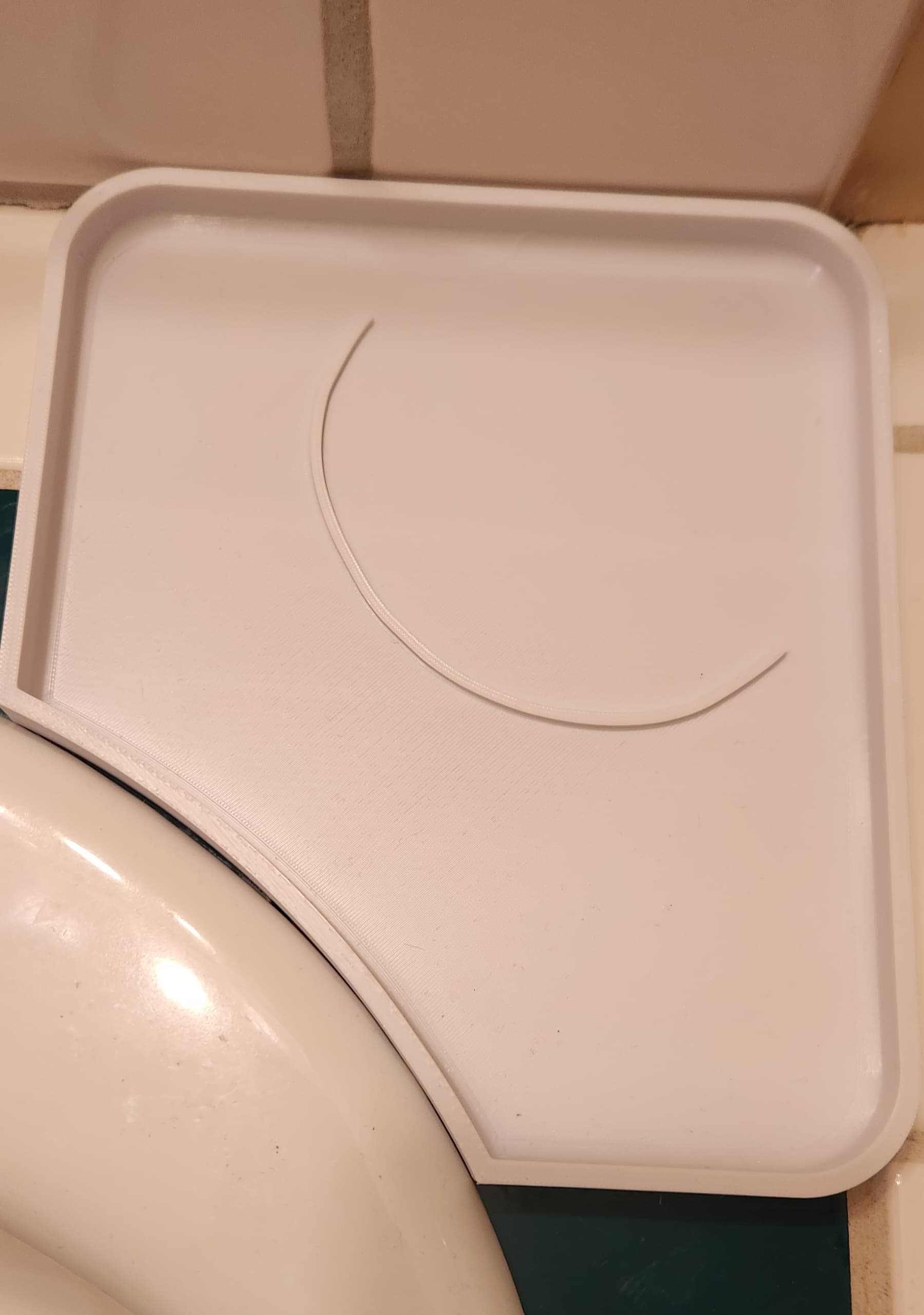

I can’t be too terribly annoyed with the product since I used this tracing device and then drew the curve on a piece of paper along with the size of the tray that I expected:
The results were perfect:
