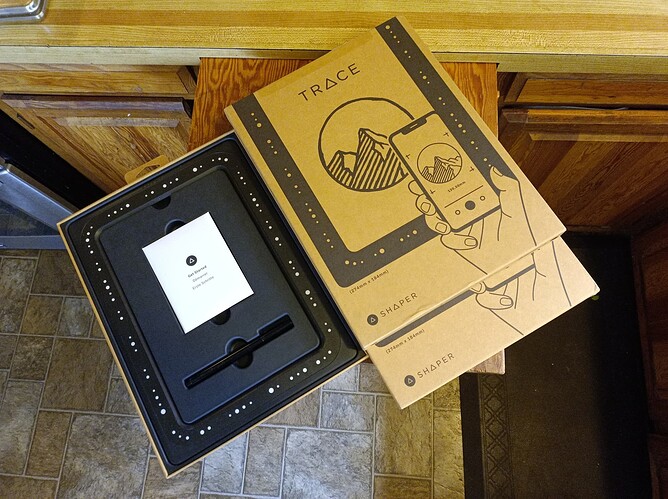

My two Trace kits came in today.
Going to have to try this tonight.
The storage case/box is not too bad.
