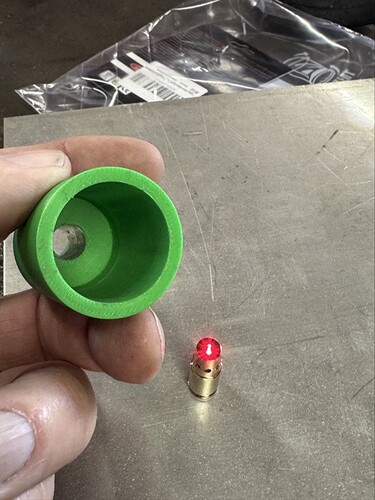

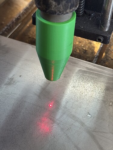

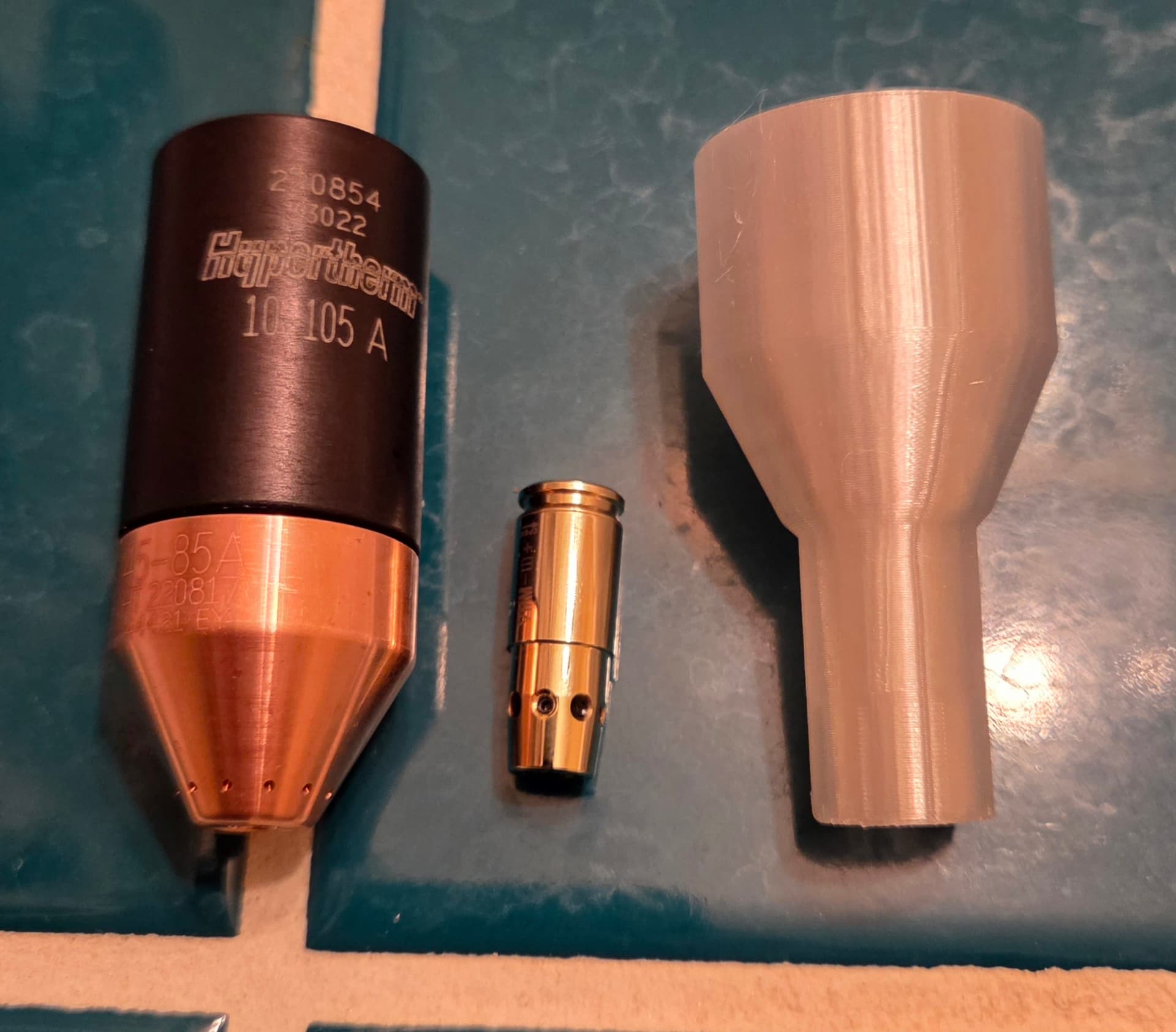

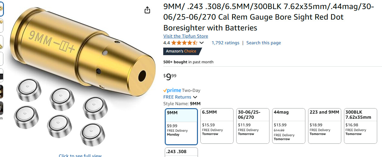

Here is a simple 3D printed adapter that lets me use a 9mm bore sight laser ($9.99 from Amazon) on my UPM105. It just slips over the end.

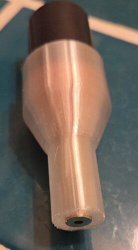

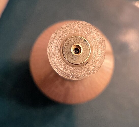

I just made one for the non-SYNC Hypertherm Machine Torch. Thanks for the idea.
LaserTorch Nozzle v2.step (20.4 KB)
https://a.co/d/2H1aPmW
Edit: Forum doesn’t allow stl files so here is the stl with .pdf (delete the ‘.pdf’)
LaserTorch Nozzle v2.stl.pdf (114.4 KB)
Best put a “Remove Before Flight” flag on the nozzle and keyboard or monitor. Ask me how I know what happens when you fire the torch with a cap over the nozzle.

I added the stl file at the bottom of the other post. Turns out the forum does not like stl files so I added ‘.pdf’. Hopefully it will pass thru. I had included the STEP file earlier in that post. Let me know if you didn’t get it.
I can share the one for the UPM 105 if that’s useful.
Yes please,
