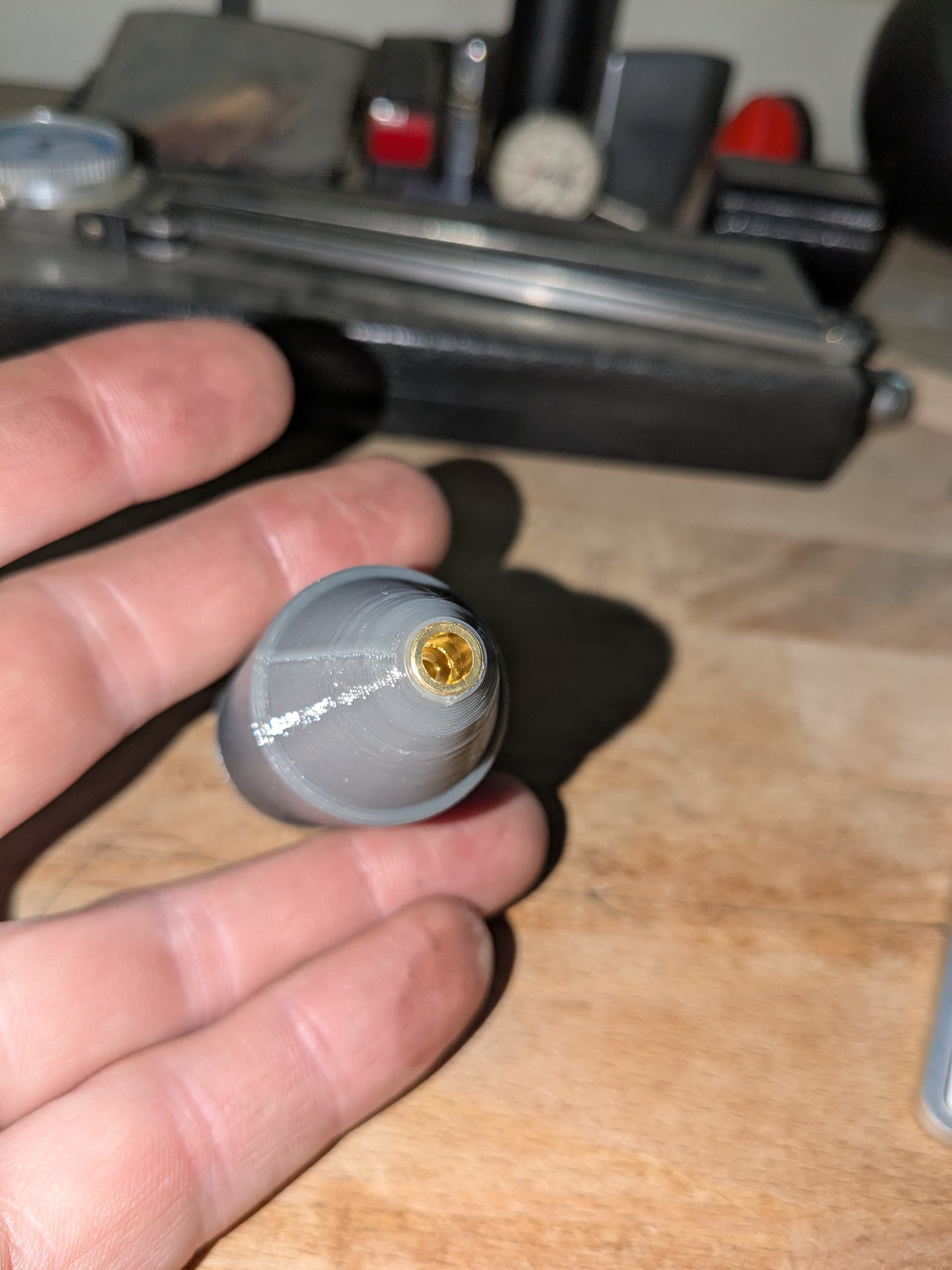

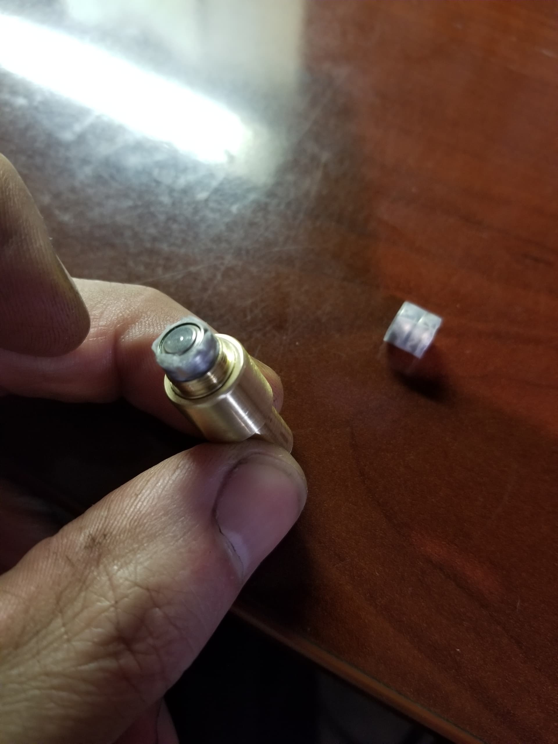

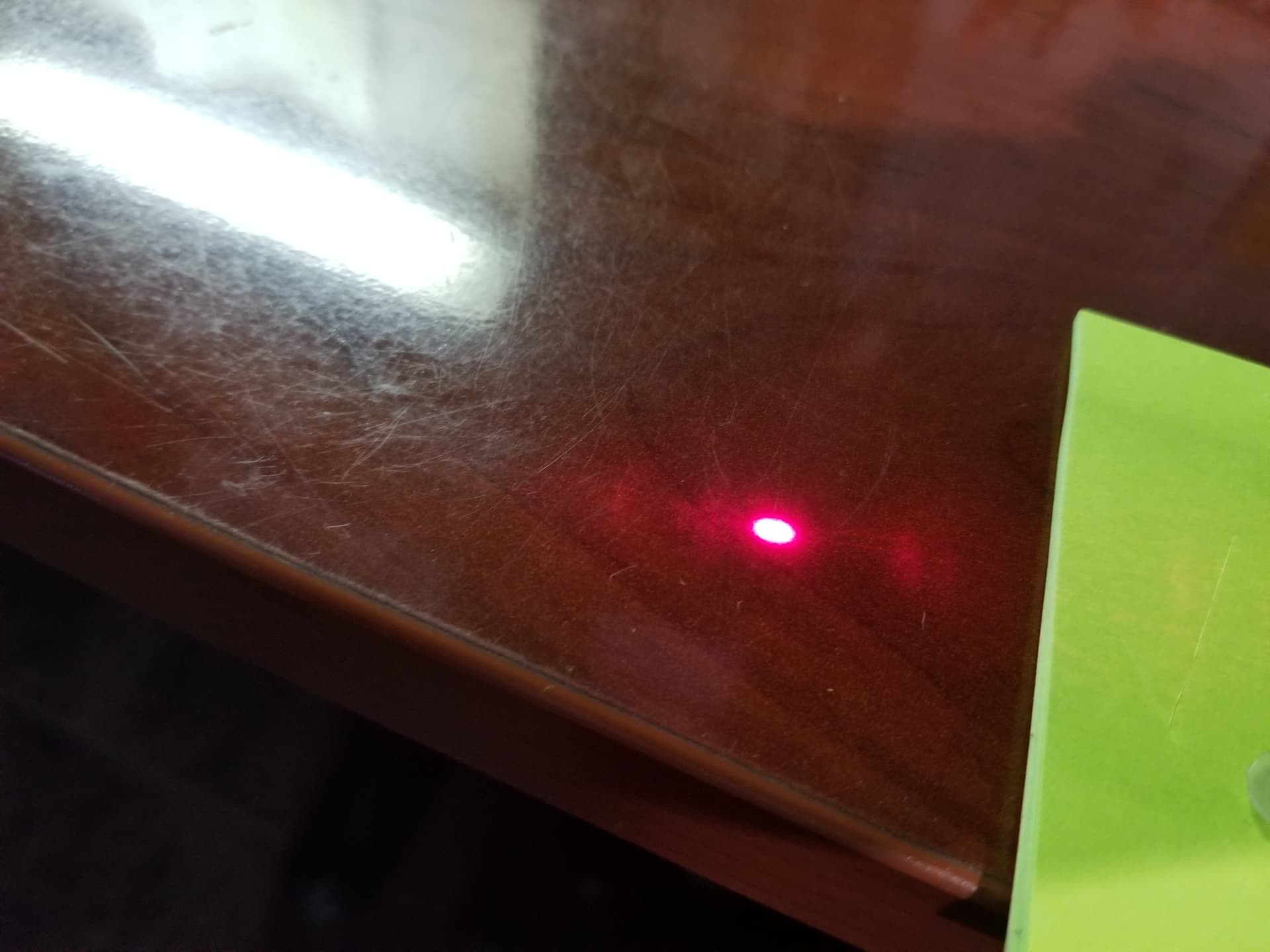

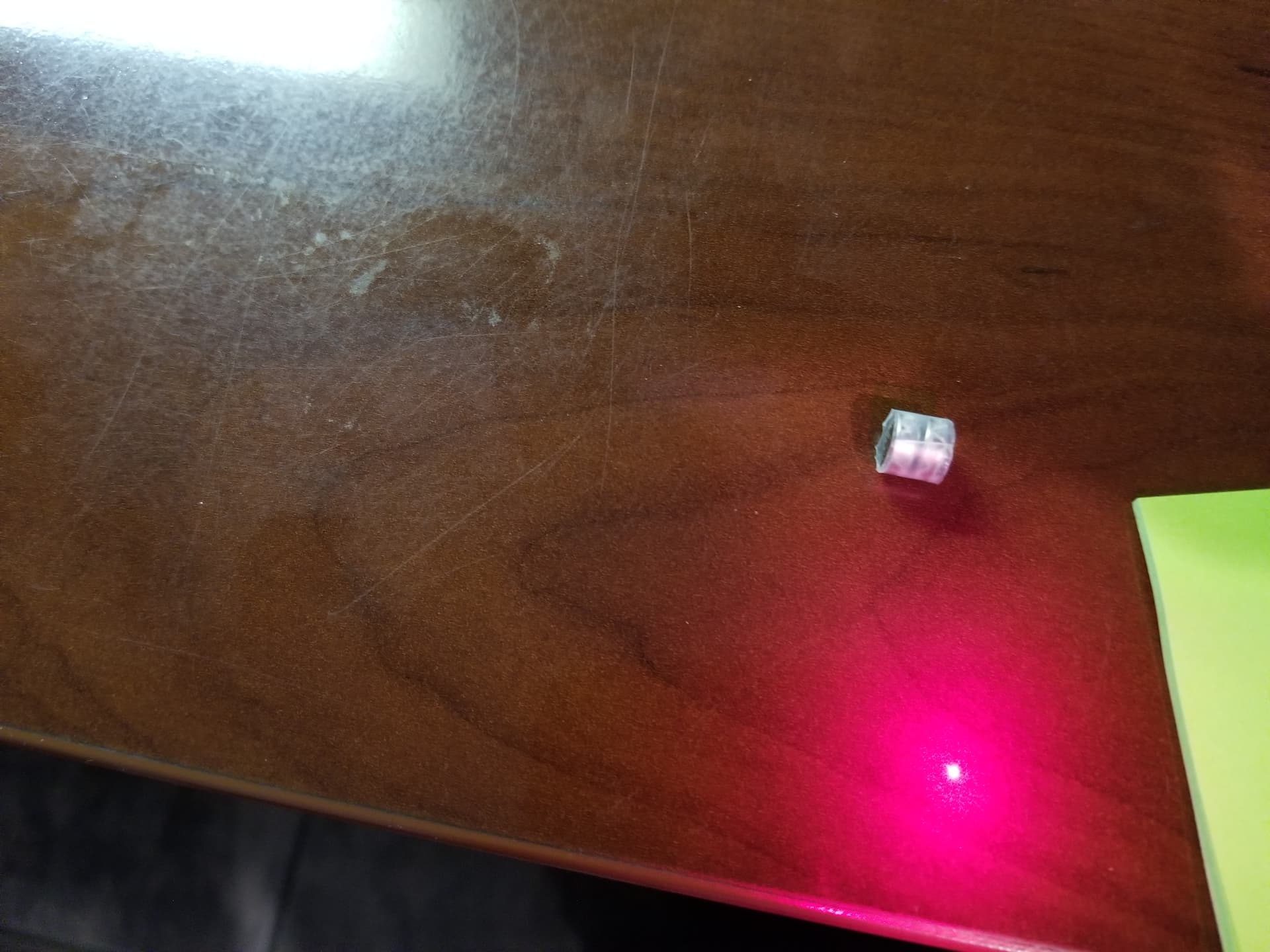

The lasers i got are more of a fat slot than a circle, I added a piece of tape on the end and poked a hole with a pin to make it “pin point”.
Also added tape around the 2 batteries and now a slight turn turns it on or off.

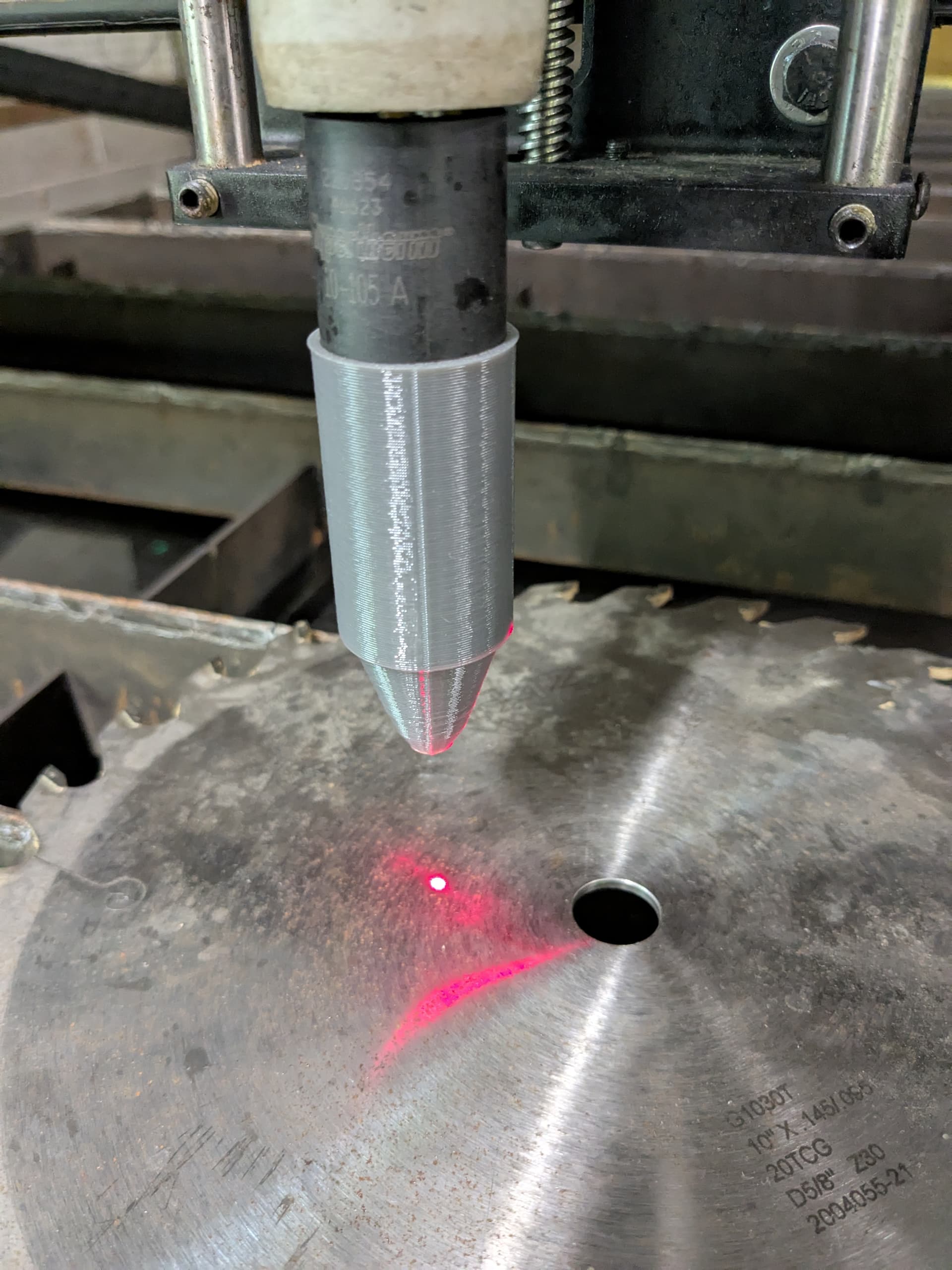

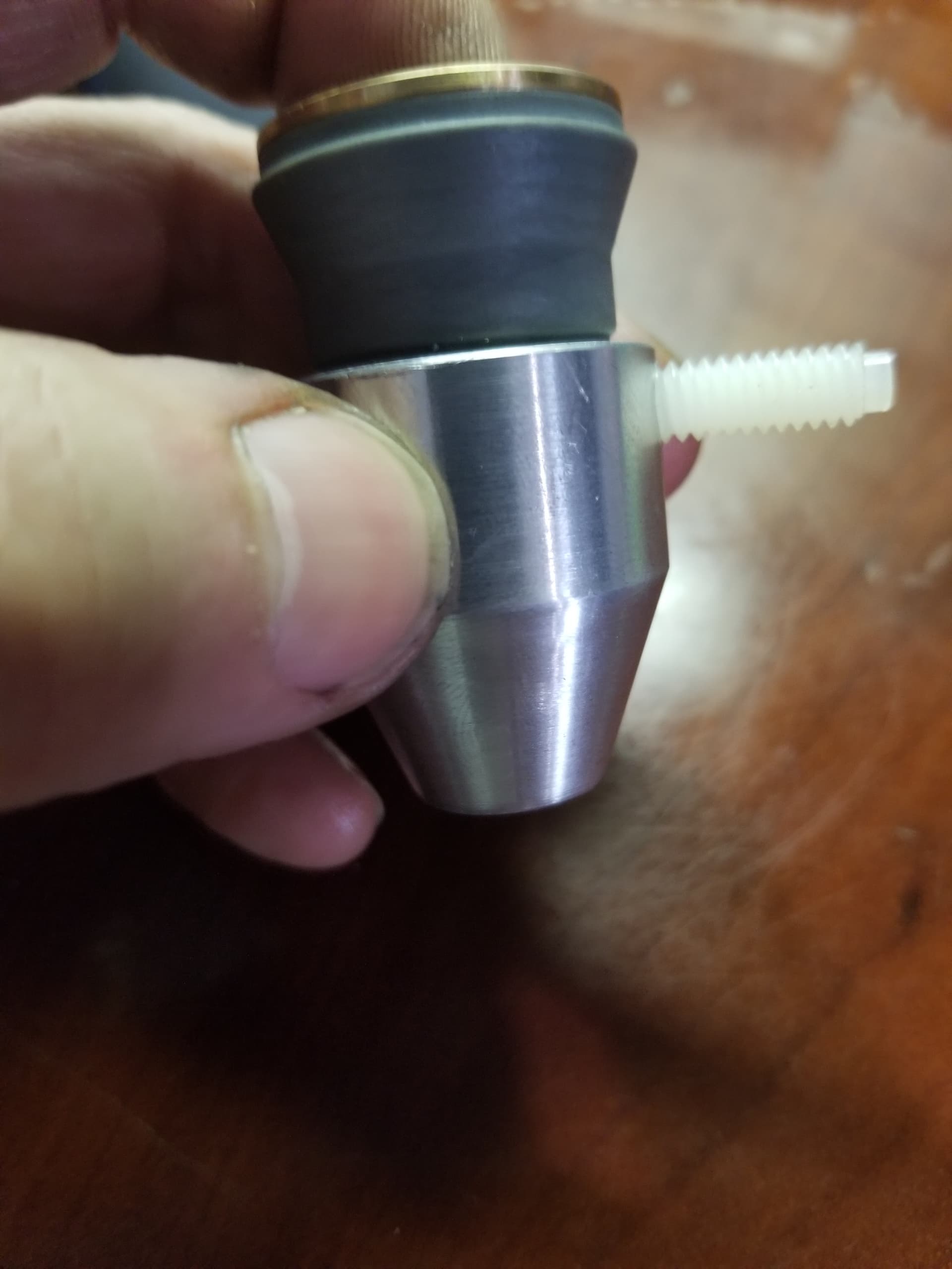

Does it go over the whole nozzle/shield or do you have to remove everything to put it on?
so do you have to remove the laser to turn it on and off?
It slips over the nozzle, you have to pull the cartridge out to turn it on and off.

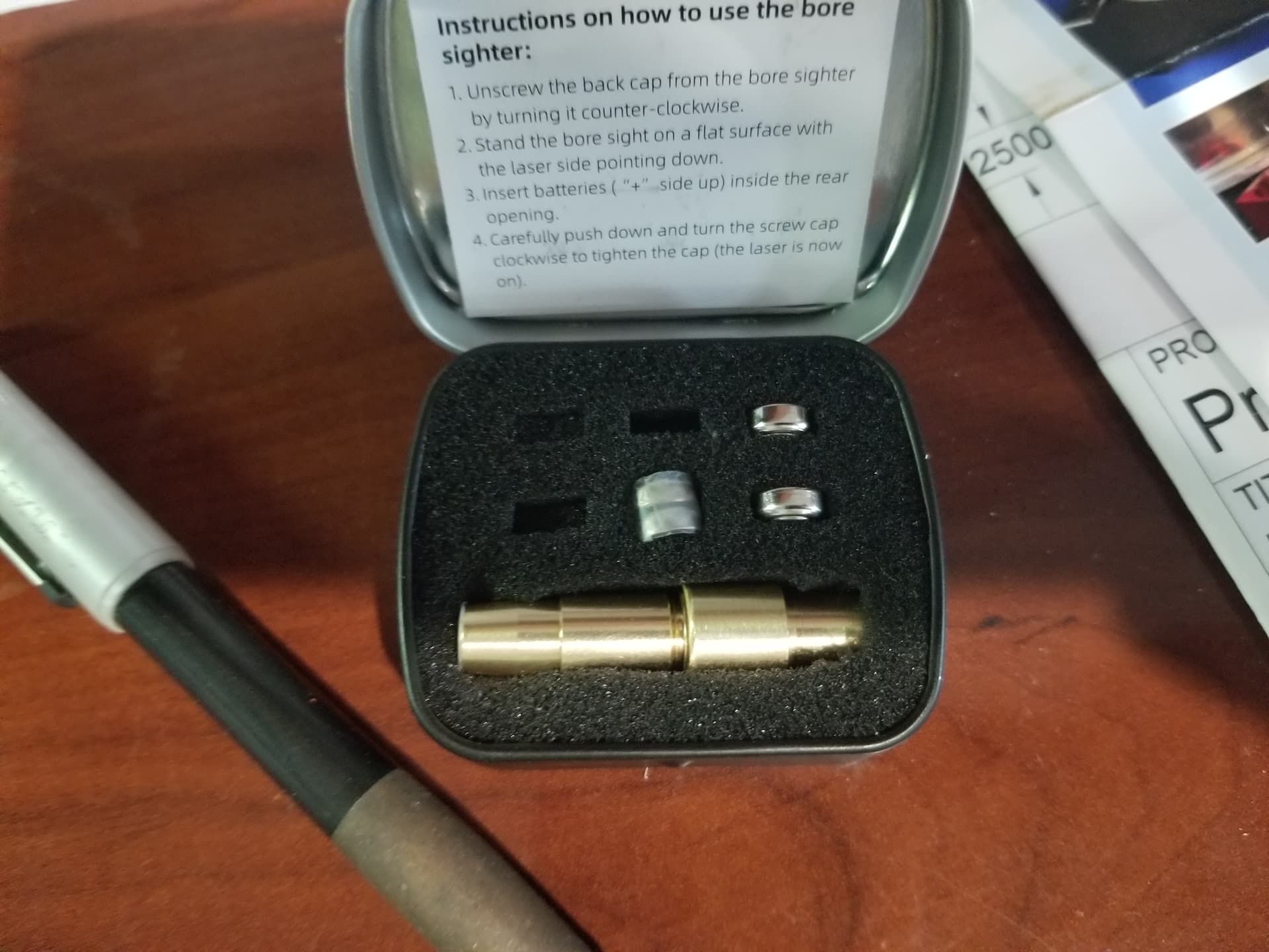

Dude! I love the laser idea for lining up parts and such. I dont really ever need it but I like gadgets so I went down the bore laser road.
Complete credit and kudos to the OP for this idea and taking the time to post it.

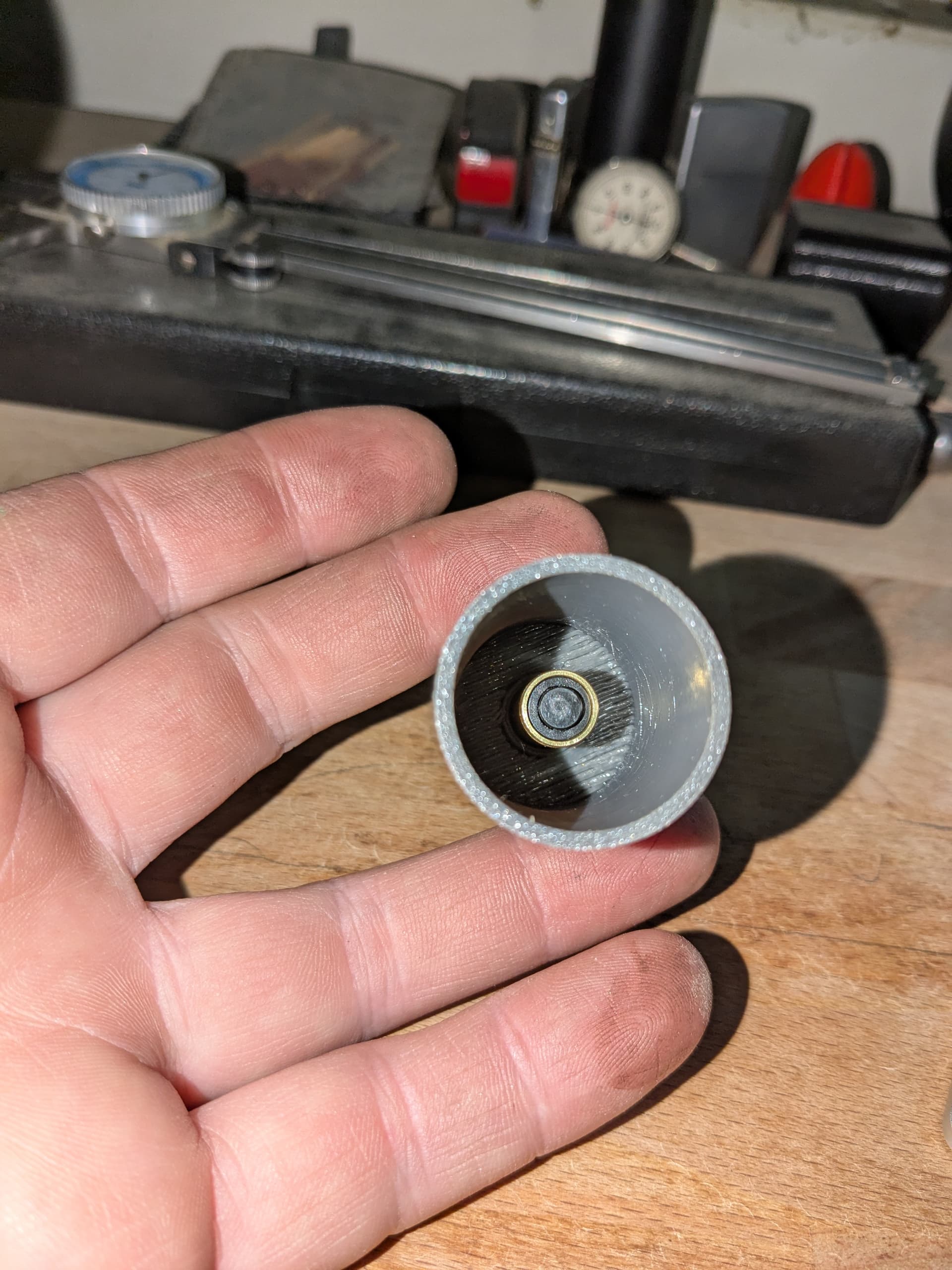

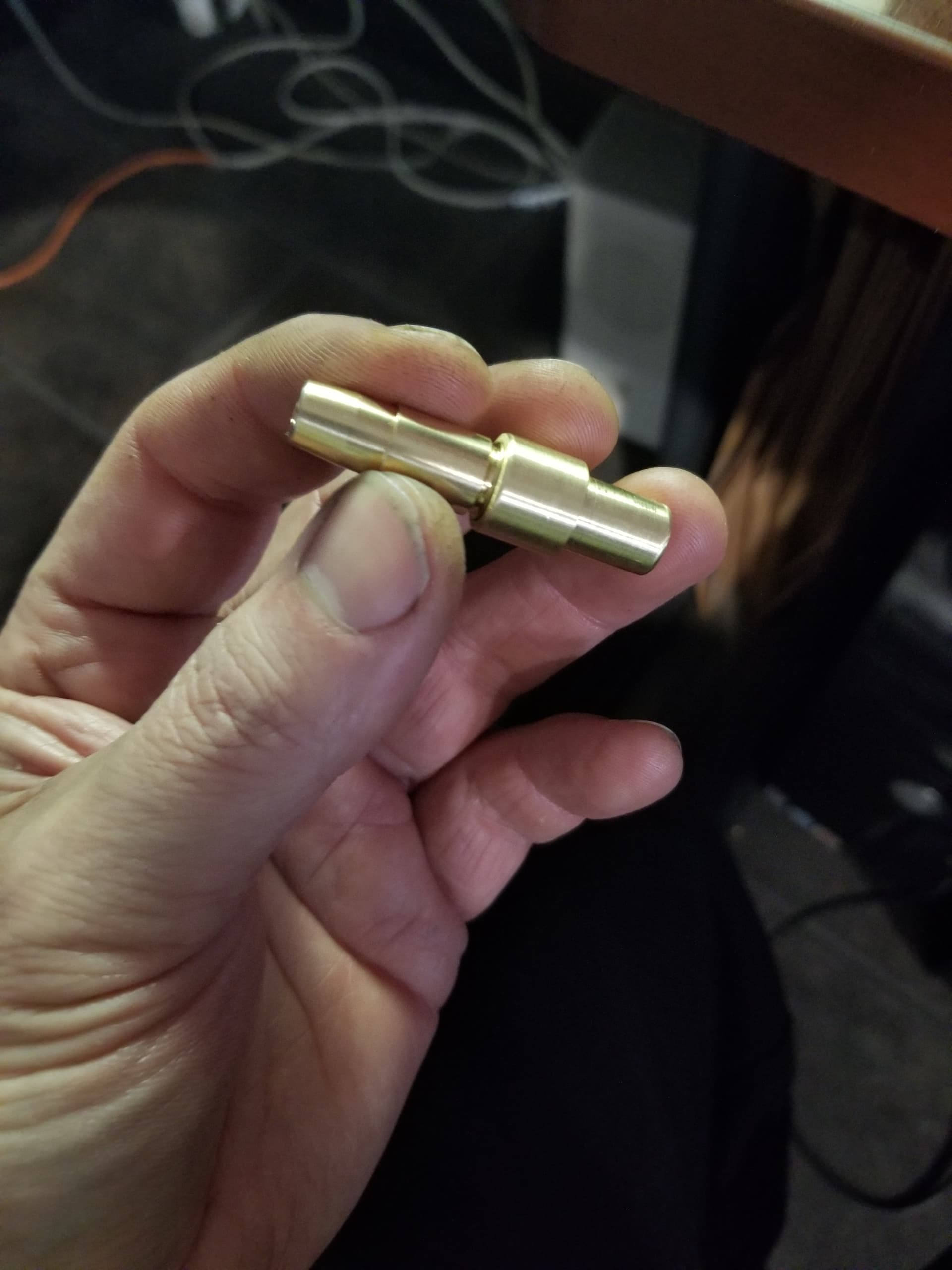

I didnt like the idea of unscrewing the end of the bore laser and wanted a switch and have to dig the laser out of the adapter wasnt appealing to me.
So I redrew the adapter and ordered the .223 bore laser as its larger and easier to handle, if needed. I realized after that being larger wasnt necessary but I just stuck with my choice.

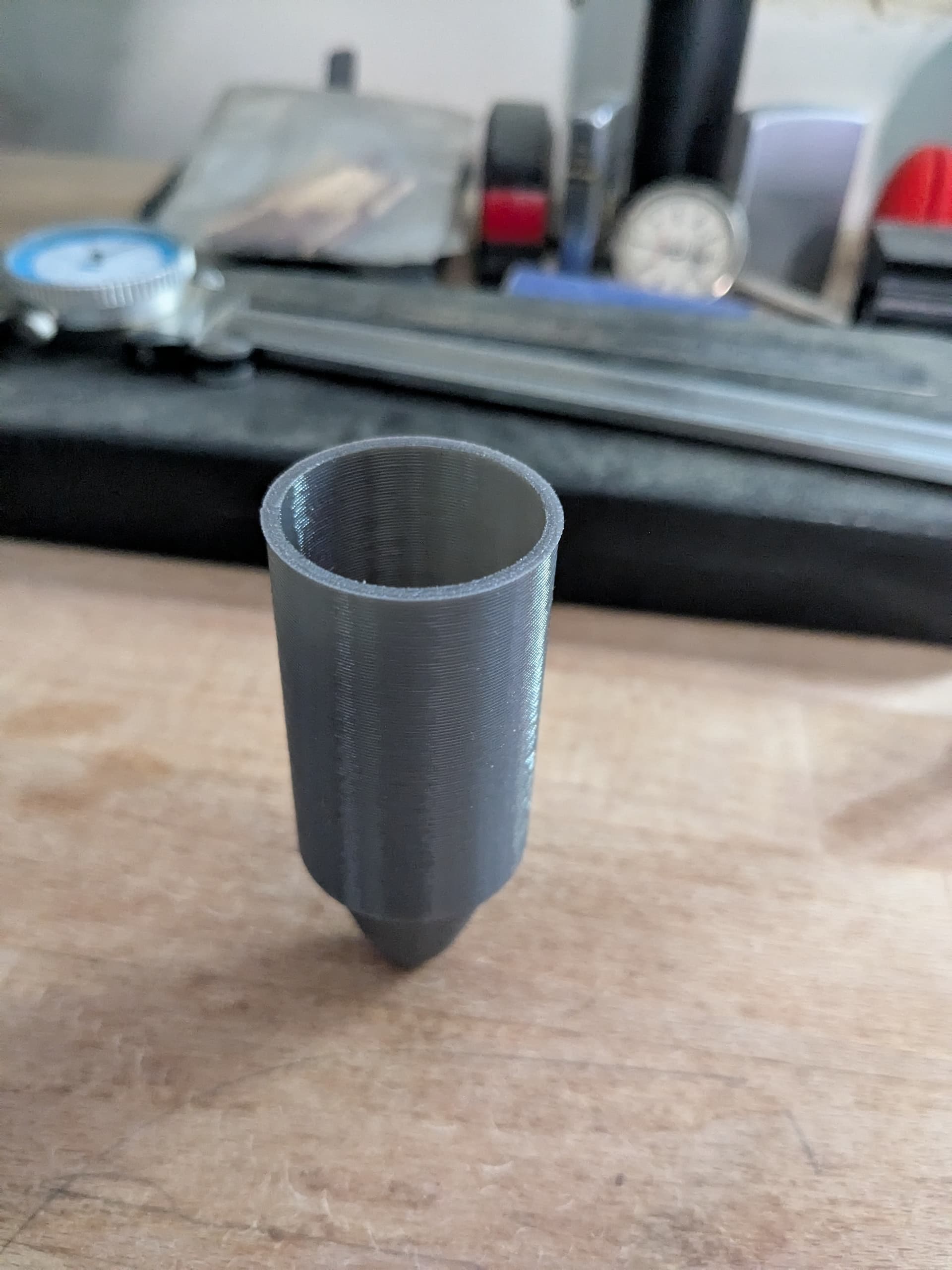

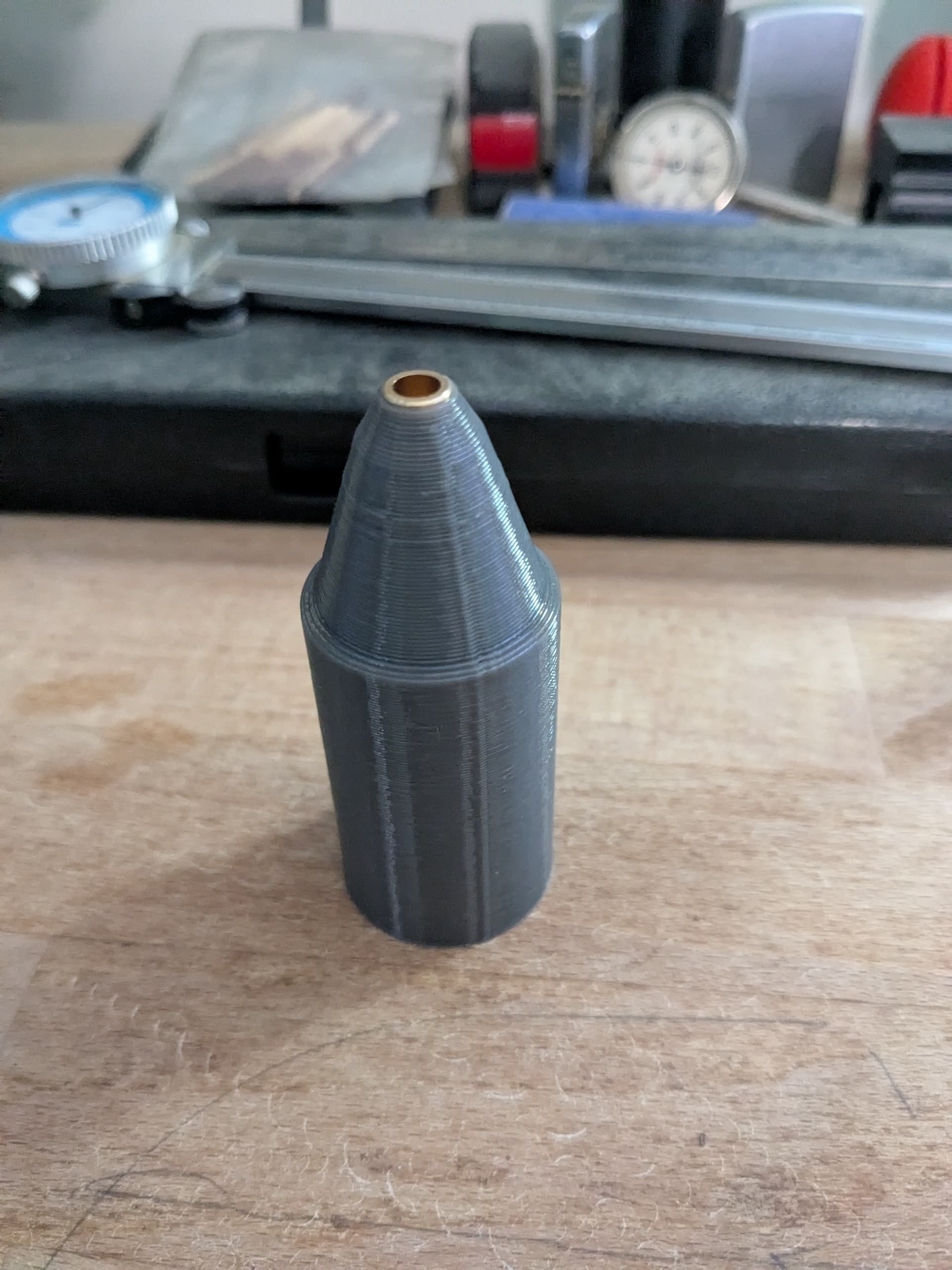

After printing one, I realized that more length was needed for stability on slipping the adapter over the torch nozzle. BTW I have an older Powermax45 with a Duramax torch (non sync) and the torch tip body is exactly 1" in Diameter.
The dimensions I normally add for shrinkage on most of my 3d printed parts is 0.01 and they come out to a good friction fit. Oh and I use regular old PETG as filament for this.
The laser can be left in the adapter, slipped on and off at will without doing too much work and the laser can be turned on and off with your finger on the push of a button.
One cool by product of the whole thing is when you slip it over the torch nozzle you can actually turn on and off the laser by clicking the switch on the end of the nozzle… at least mine does… :smiley:

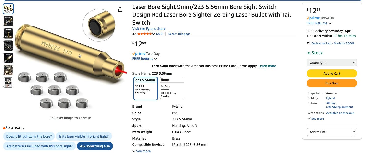

And the laser I bought is here: Amazon.com
They offer a 9mm and while making it shorter in overall length, might be harder to handle in or out of the adapter.

Wish I would have seen this earlier, turning on off would be easy with that one.
Thanks for the link. Just ordered a 9mm with a switch to replace the one that I used without the switch.
I have not thoroughly fleshed out all of the options with the on/off of the one I bought but it will turn ‘ON’ without the cap if the battery touches the side. The cap just ensures that the contact to the complete the circuit.
I had figured that something as simple as a piece of foam on the back of this laser “Boresighter” (or a piece of aluminum foil) will cause adequate contact when the assembly is slid onto the end of the torch and makes contact with the torch shield.

Up until the other day, I had not used the one I made even since the date of my post. I had been using the keyboard to move my machine around and that was ok, but I still had to look at x and y to make sure I was zeroing where I needed to be.
I went back to using my touch screen and not using the keyboard but I found myself walking back and forth from table to pc to make sure i was in the right spot, not thinking about my laser pointer. Honestly I didnt think I was going to even use it at all, but then…after going back to the touch screen I needed to locate myself on a piece of steel across the table and I thought wait a minute.
I put my laser piece on, jogged over to my start point AND also adjusted my piece to square by jogging the laser down the edge of my material, it was square. Set my zero, jogged back to me to remove the laser pointer and back to zero and never left the pc once… Whammo!
