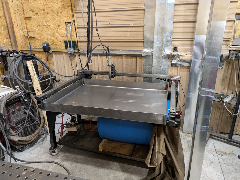

I’ve only got my water tank & the water pump on mine. I used 1/4-20 rivet-nuts to anchor the angle iron around the sides and some random plywood for the table. I had to upgrade the tank to a 55 gallon drum to accommodate the single piece 4" deep table I was in the process of adding in this pic. The skirt is some nomex fabric to keep sparks out, but I’ve found it to be largely unnecessary.
