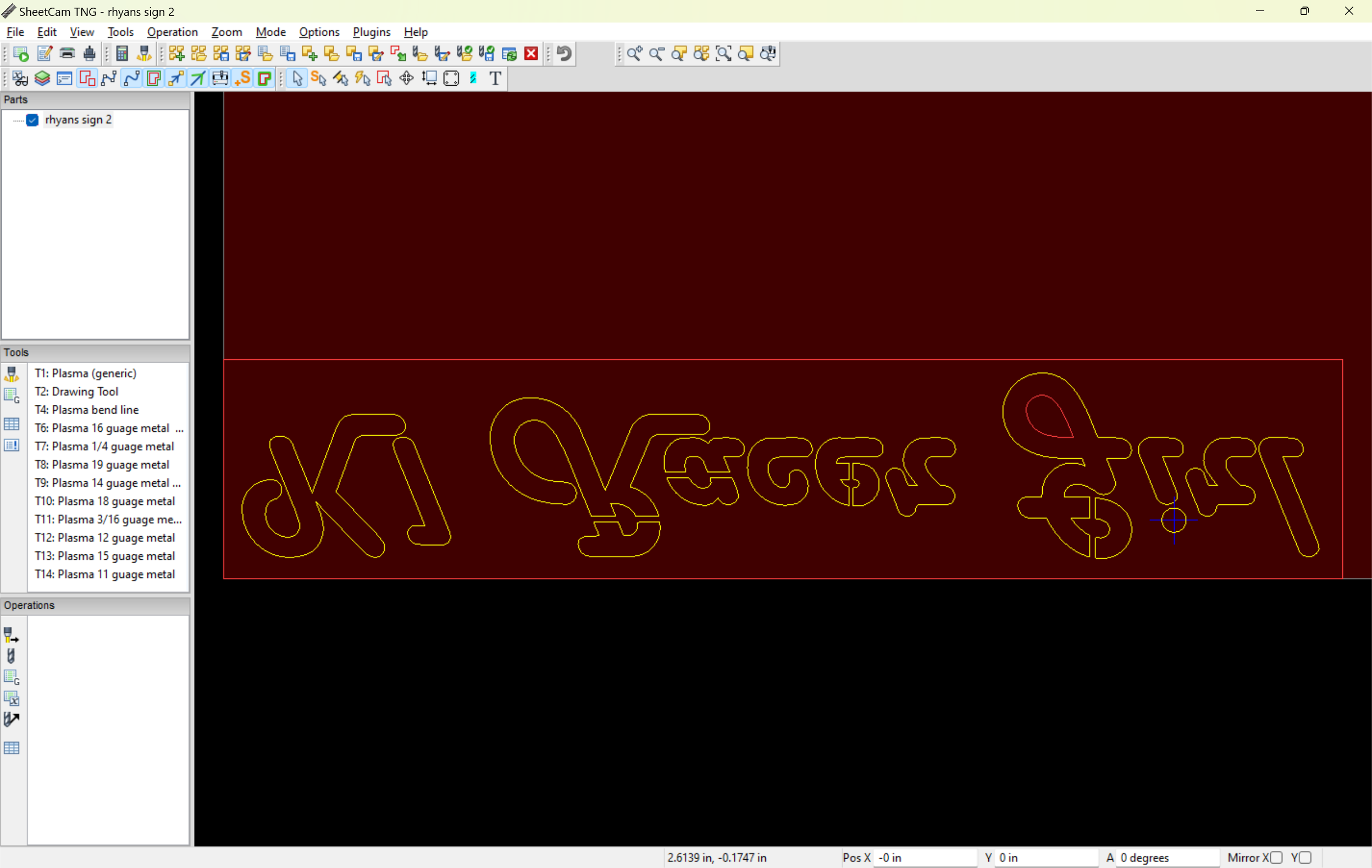

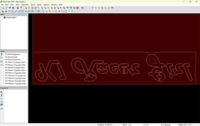

Sheetcam drawing from fusion upside down?
Did drawing in fusion right side up. When put into sheetcam went upside down and backwords ? Confused ?
When you create a DXF unlike an SVG origin is calculated as part of the file.
So when creating your DXF pay mind to where origin is cuz it’s going to affect how it loads.
Check out this old topic where I discuss it with another member having the same problem.
Short term fix for this drawing would be to click on the litlle “mirror Y” box in the bottom right of the screen.
Thanks Tin and friends you have always been great help !!!
