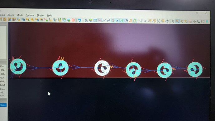

It would be nice to see the tool paths to see if Sheetcam is recognizing your holes correctly and starting at the center.
I’ve had issues with files that I created in Inkscape, where it didn’t show them as holes with a center point. In those cases, it just treated them as en ellipse and used a regular lead in.

I do notice that the lead in does NOT, in fact, begin in the center of the holes. But, sheetcam shows a crosshair in the middle of the ‘hole’.

The holes look fine, as long as they have that cross hair in them.
Aha, this looks better.
I guess it would make sense that there simply isn’t enough room in a .15" or .2" holes to fit a .15" lead in from the center. :no_mouth:

The following picture shows a handful of holes all cut with the exact same settings. 14ga steel, fine cut consumable on 32-35A, air is clean and dry at 75-80PSI. Cut settings are 65IPM, .07" arc lead in/out, begin at center, no overcut. The 1st and 3rd hole are beautiful, at least well enough that I can drill them out to my exact dimensions easily. The ONLY difference is that the start point varies in sheetcam.
Top hole in the first picture is far left hole in 2nd and 3rd.
Charging my laptop now but I’m about to try a full cut file with the small holes all with identical starting points to the first clean hole shown. Beyond this, what am I possibly missing?
