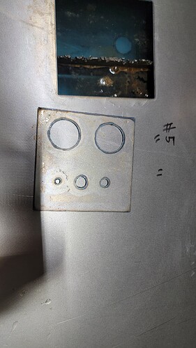

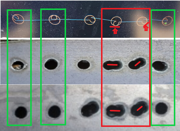

I don’t know if I have these lined up in the correct order that they cut but when you look at it this way, the consistently terrible holes occur when the lead-in is starting in a unique position relative to the other four holes. This is suggesting some forces on the torch cable or direction of the gantry that accentuates some excessive movement. Try to re-CAM the sample with the holes being started all in a similar clock position around the circle. With the orientation it presently sits in my diagram the two worst holes start at 6 o’clock and 4 o’clock. 10,11 and 12 o’clock seem to be the best starting locations.

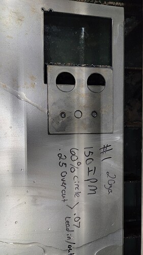

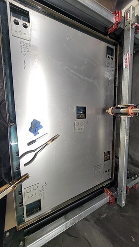

Did some testing today. Before jumping in to that, I cleaned the crap out of the whole table. Scraped the water table, wiped down all the surfaces, cleaned and lubed bearings.

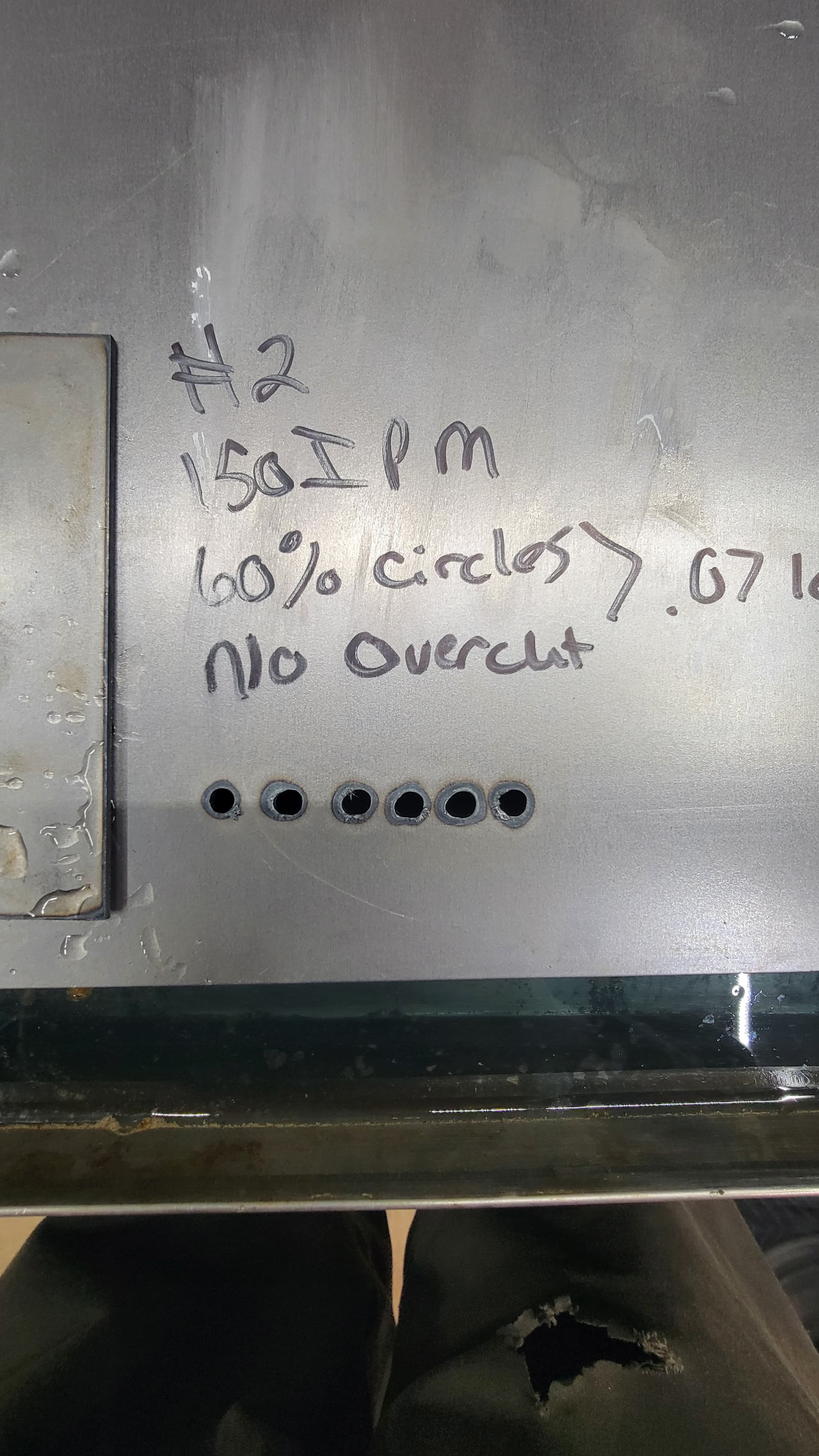

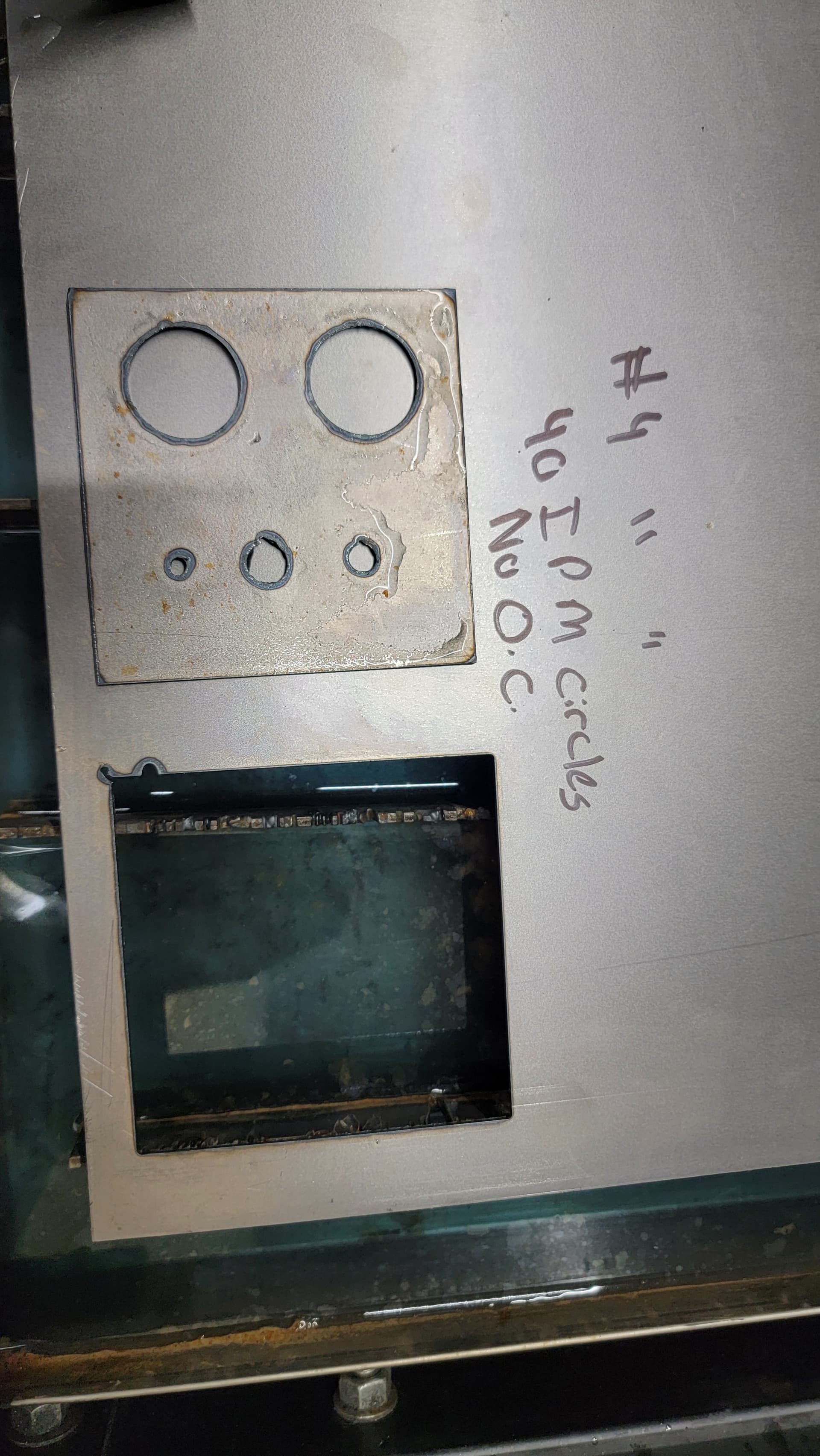

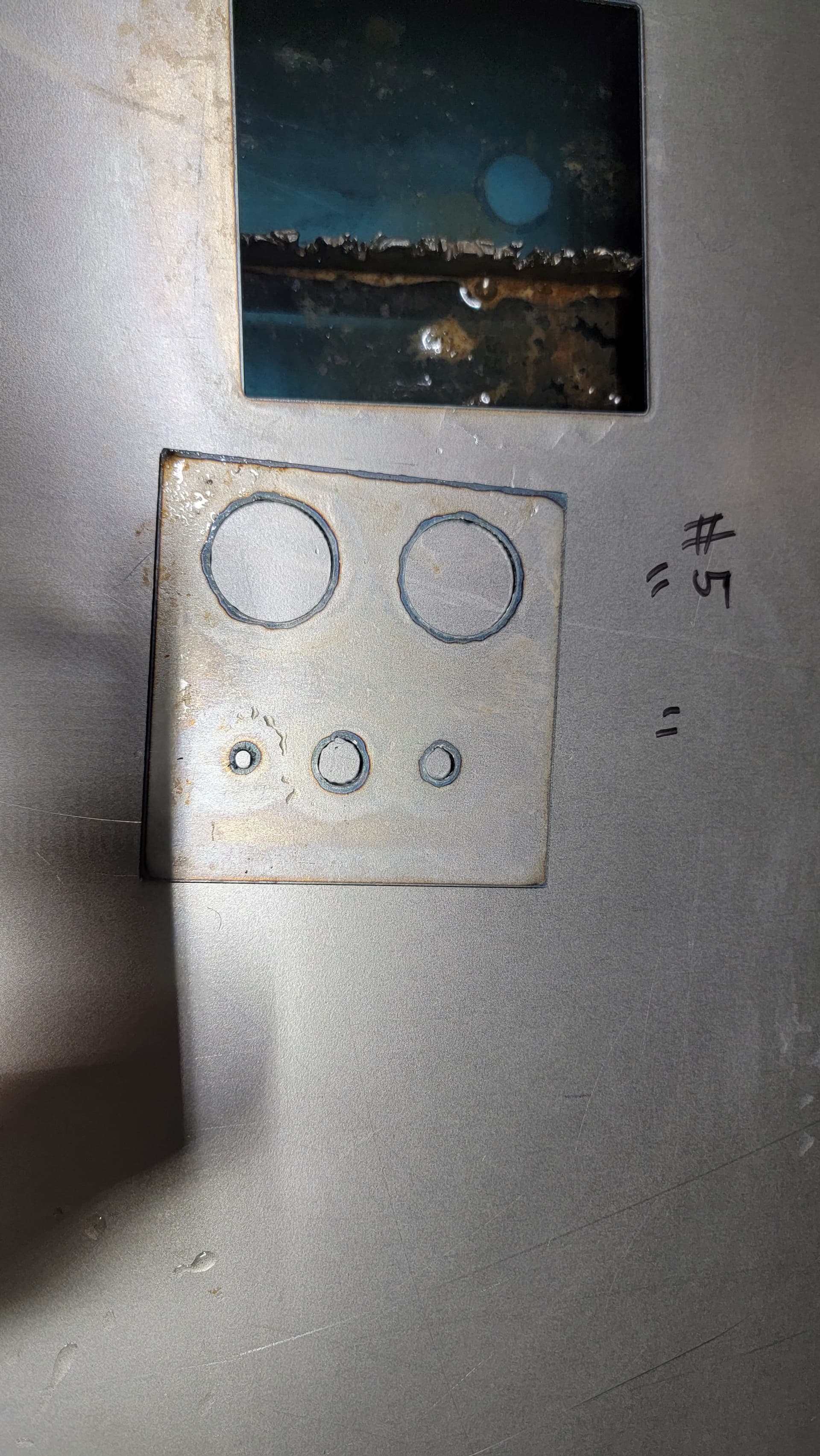

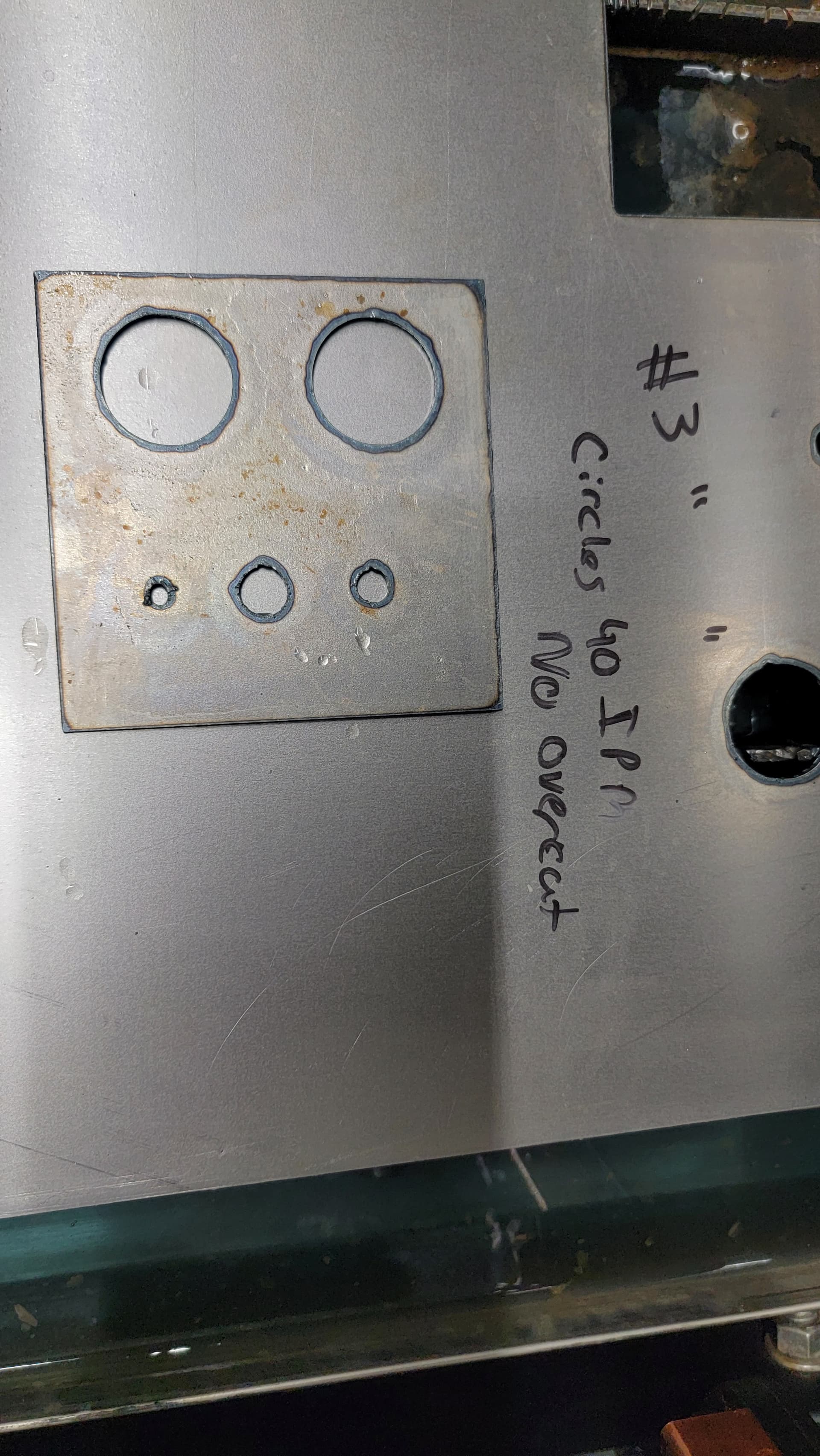

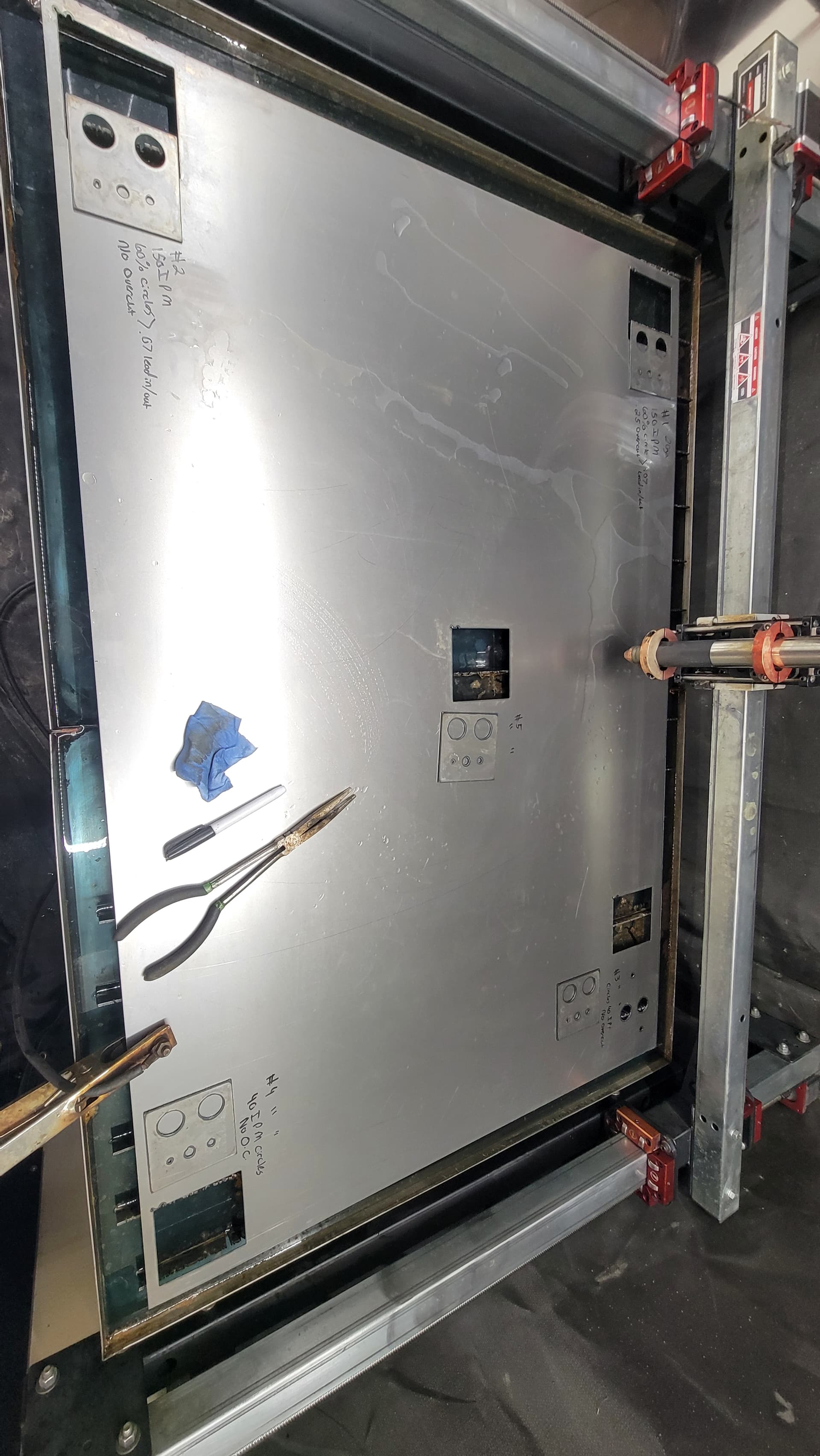

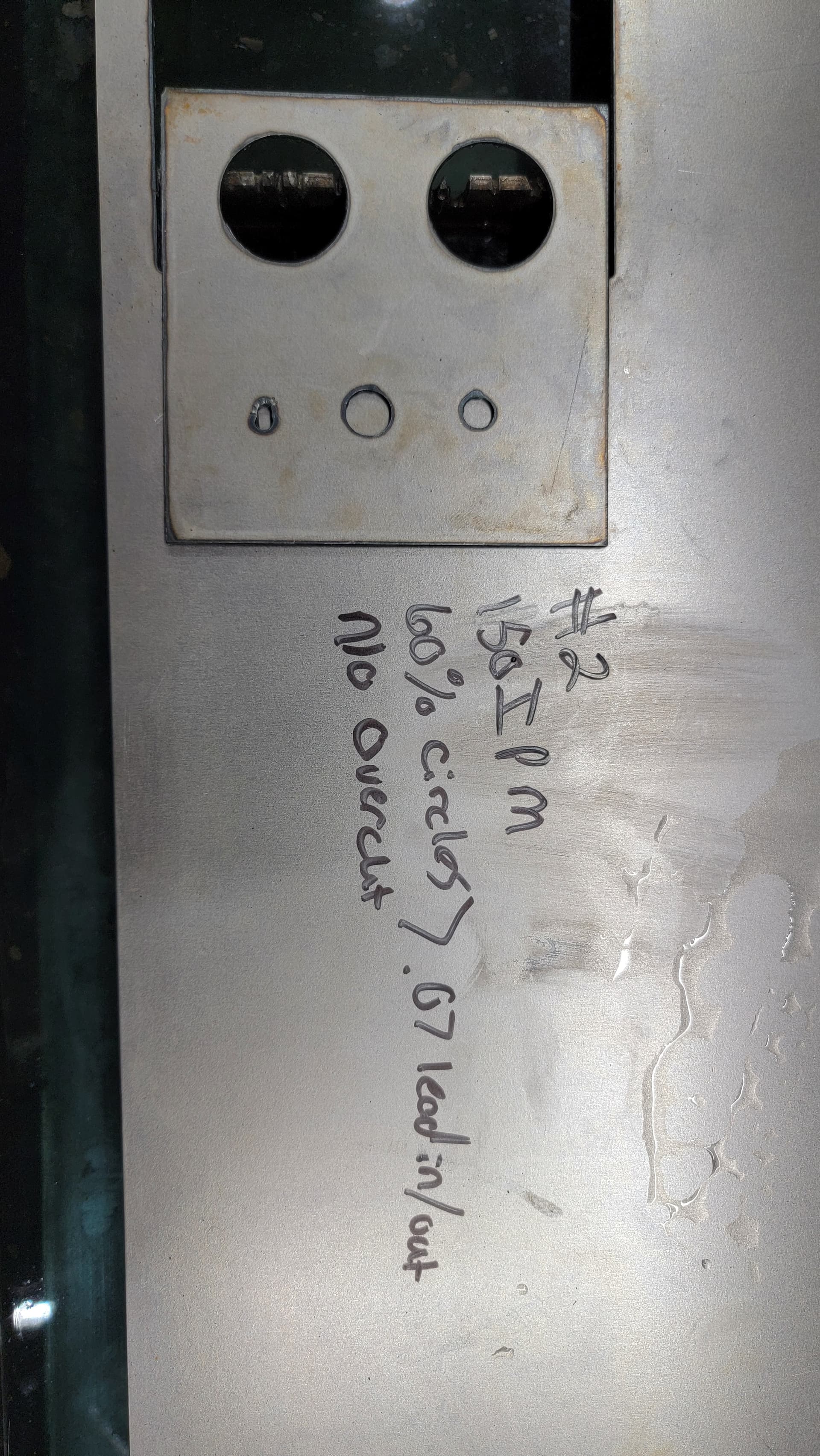

Here’s what we got on a piece of 20ga steel. Test #1 was top left of sheet, #2 was bottom left, #3 was top right, #4 bottom right, #5 center.
All cuts done at 27A, 75-80 PSI of clean dry air (replaced dessicant beads in pre filter, table filter still all blue) new standard consumables.
Cut #1, 150 IPM for square, 60% reduction for circles, .25" overcut, .07 lead in/out on circles
Cut #2, 150 IPM on square, 60% reduction on circles, .07 lead in/out, no overcut

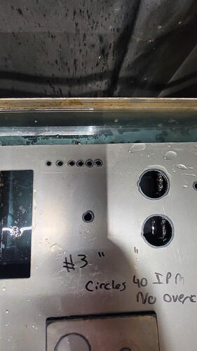

Cut #3, All else the same, 40 IPM on circles, no overcut
Cut #4, All else the same, 40 IPM, no overcut

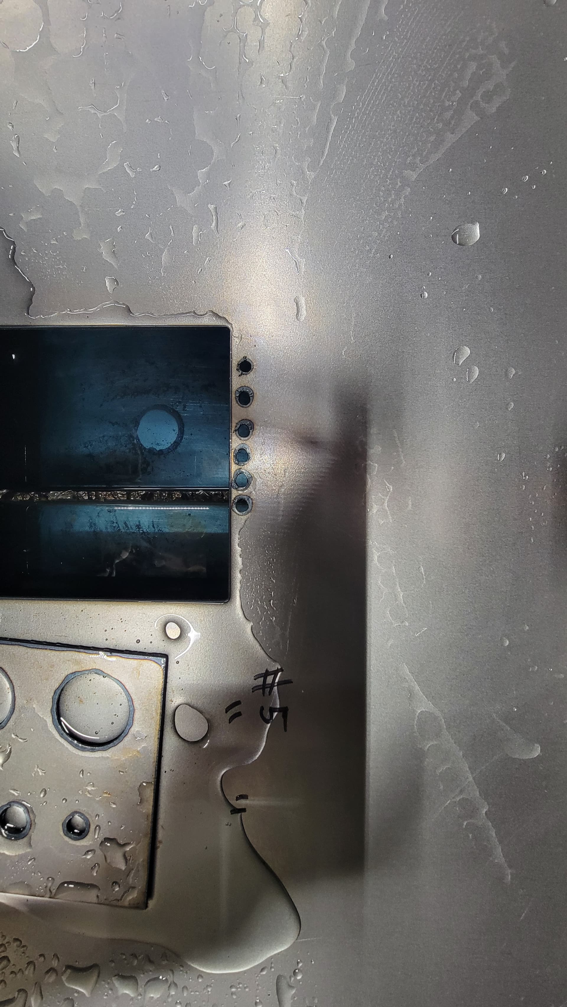

Cut 5, Identical to cut #4

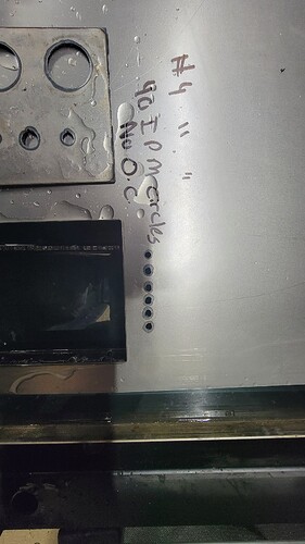

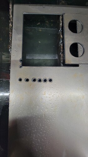

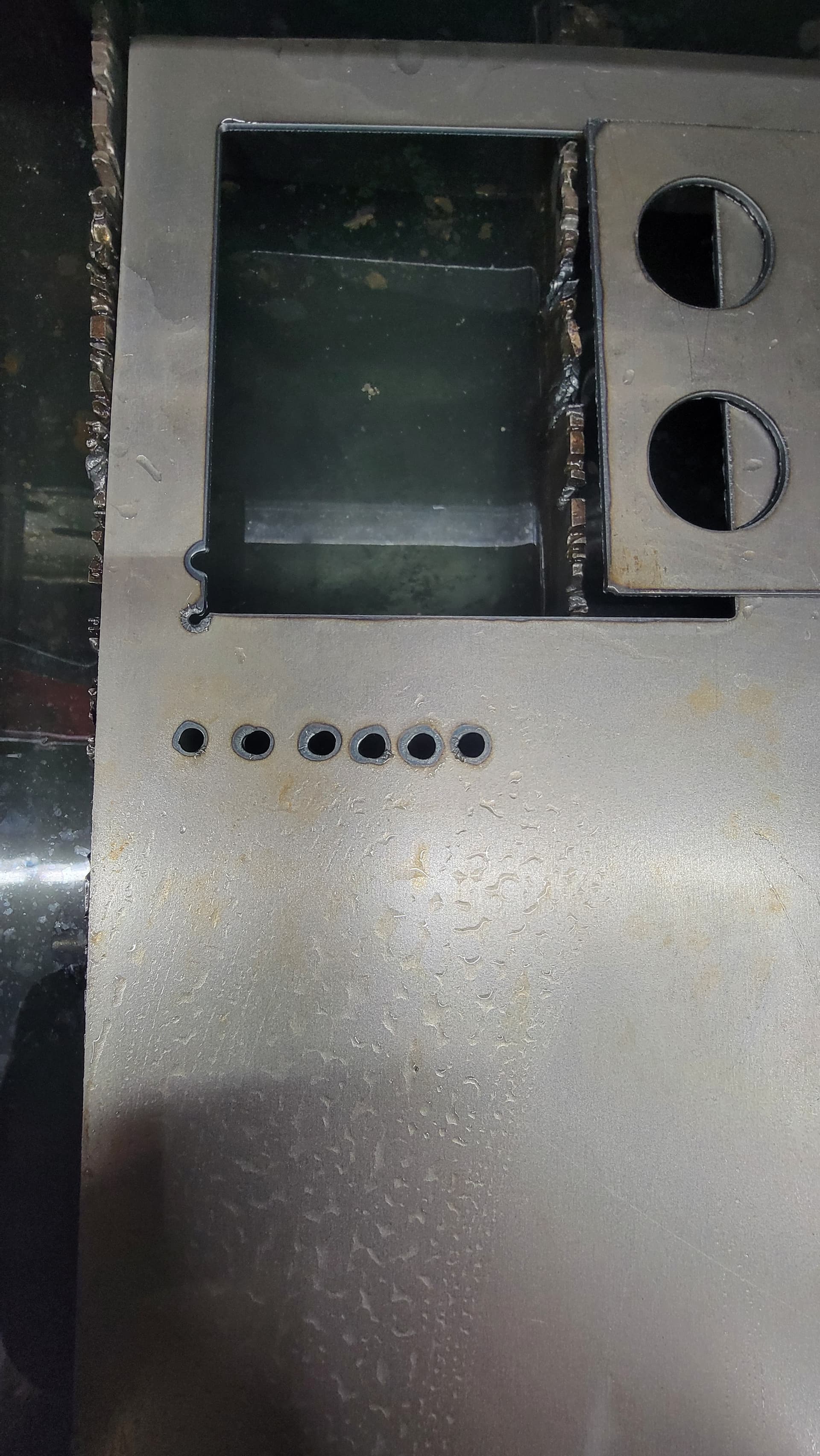

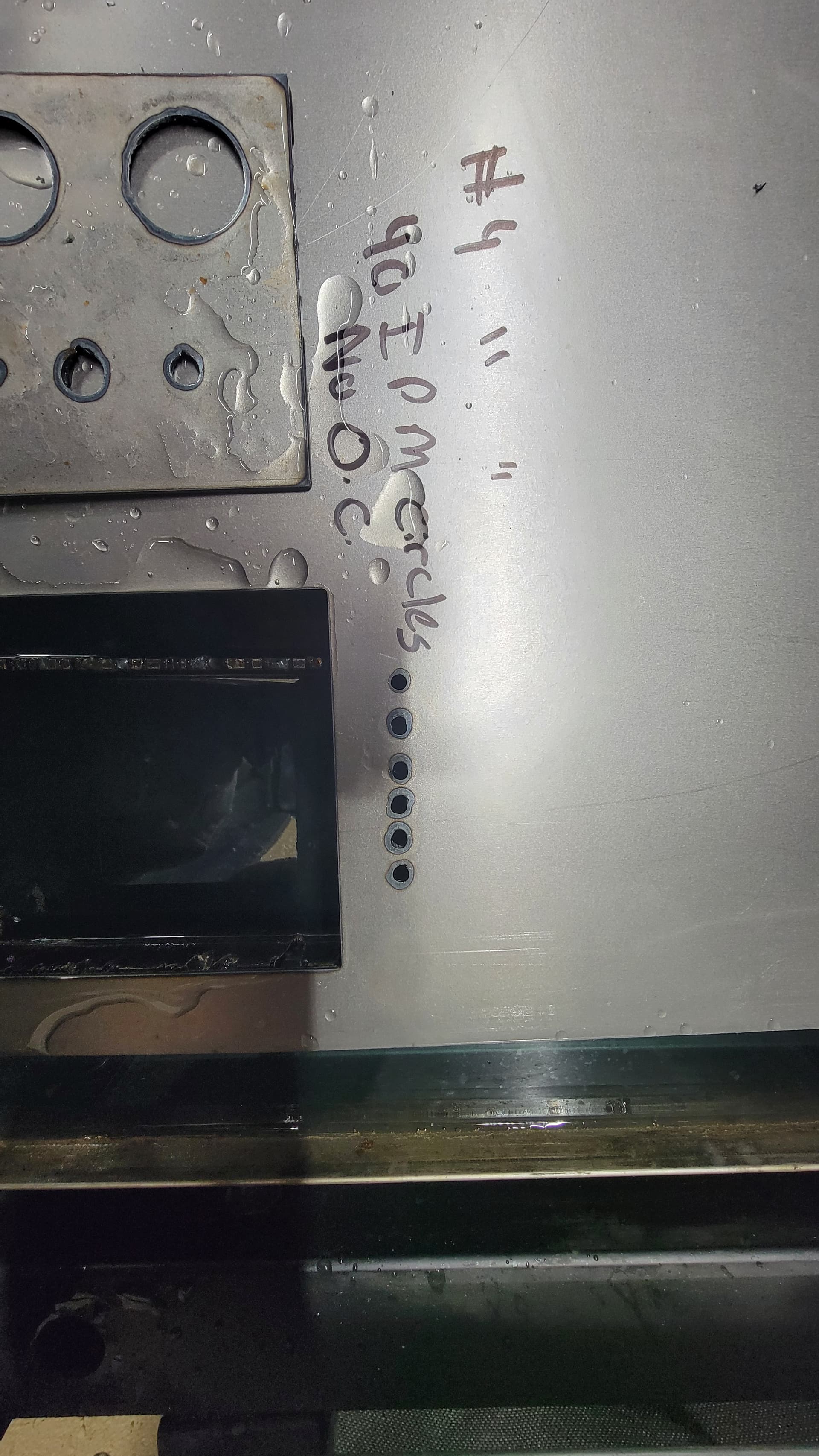

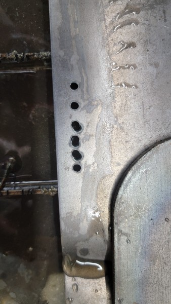

After doing these tests, I did some small circle tests in the same 5 locations. These are the results. All circles had the starting point in the same place. All cuts were the same collection of settings.
1st circle: 100IPM, no overcut, .07 lead in/out
2nd circle: 100 IPM, no overcut, no lead in/out
3rd circle: 80IPM, no lead in/out
4th circle: 60IPM, .07 lead in, no lead out
5th circle: 40IPM, .07 lead in, no lead out
6th circle: 40IPM, no lead in, .07 lead out

Cut #2
Cut #3

It would seem the table likes faster circles, even small ones. I watched the torch during all cuts, can confirm the X and Y seem to move smoothly with no jerkiness visible to my eye. Still, a good bit of inconsistency.

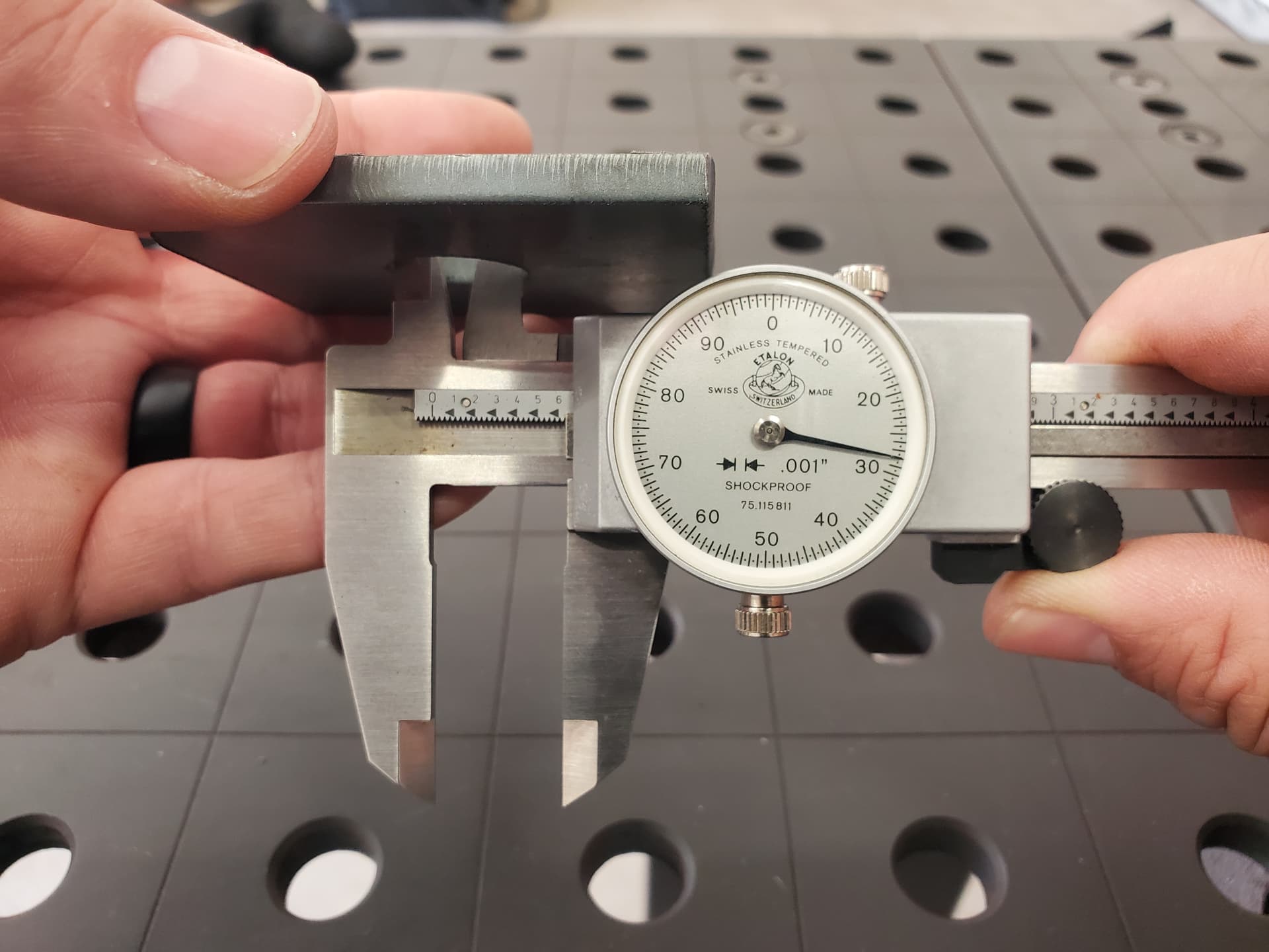

For example, I run about 48ipm to achieve a 0.625" hole within .003" on 3/16". As for the remainder of the cut, it’s all done at 70ipm.
If I run the same 70ipm for the hole, I would get something closer to 0.610" or so with a bit of tapering.

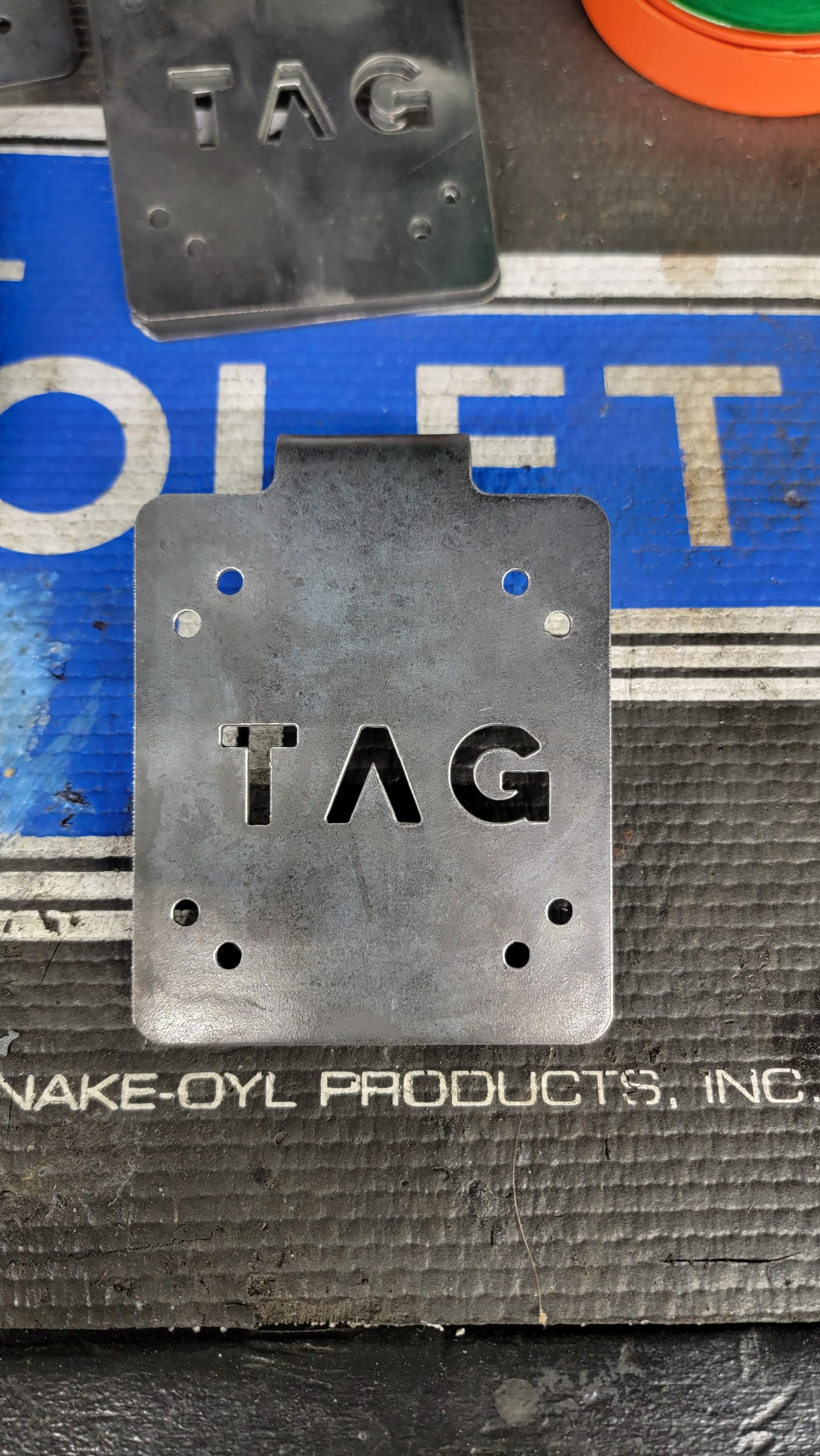

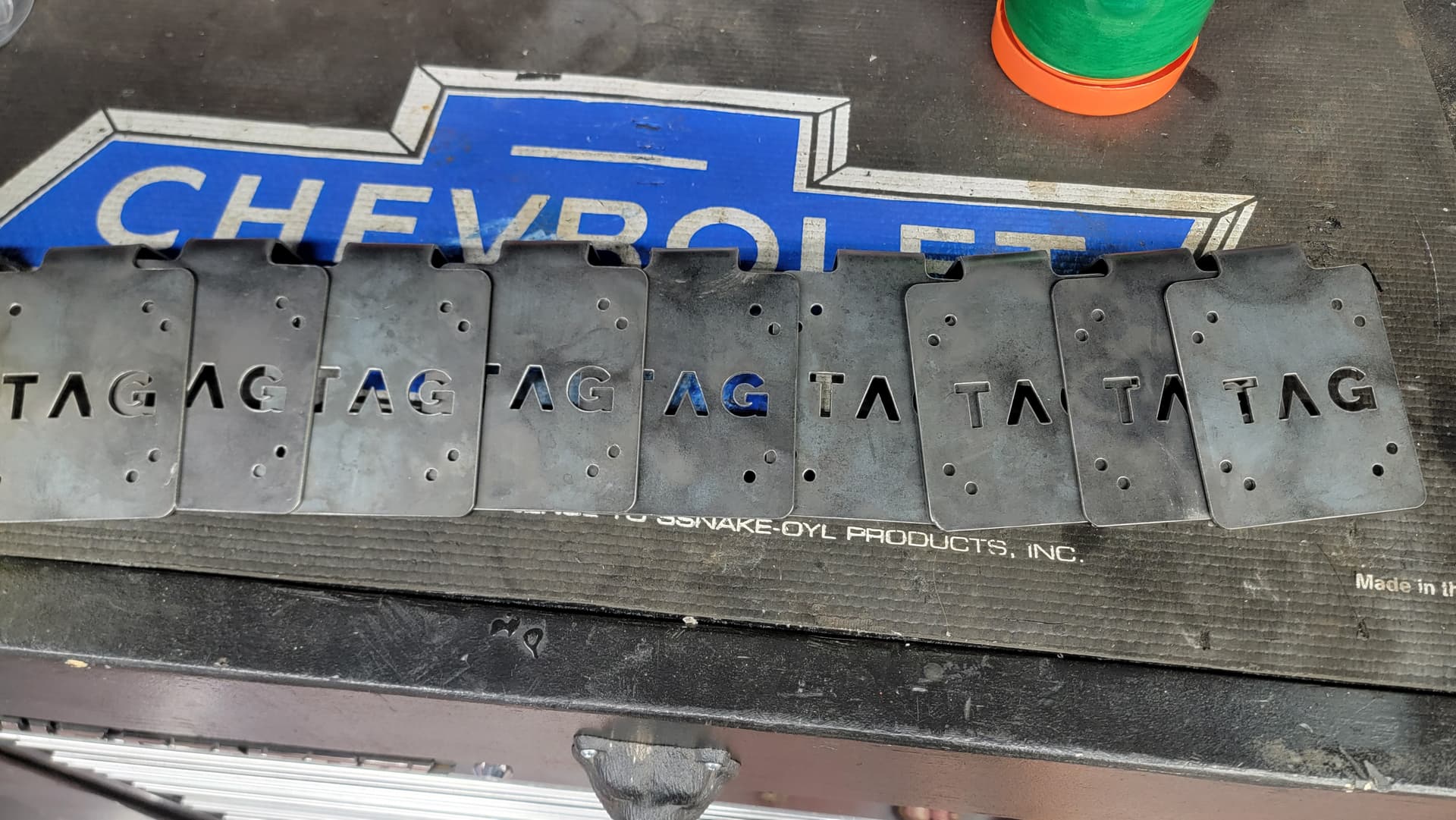

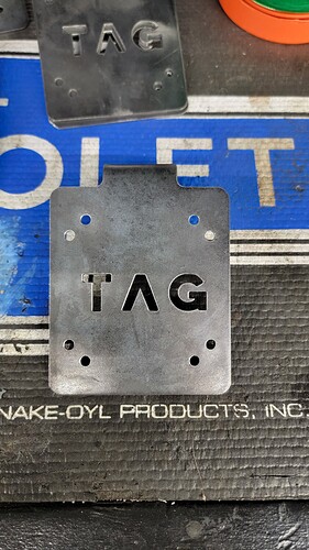

I ended up cutting out 10 pcs of a bracket I’ll be listing on my site. If it was a visible hole I don’t know if I’d run it, but it’s a mounting hole and IMO, plenty round enough for its purpose. This is on 12ga steel. 40A, 90IPM (including holes) 4.5mm holes, .07" lead in/out.

Yes, I would be satisfied with those brackets.
