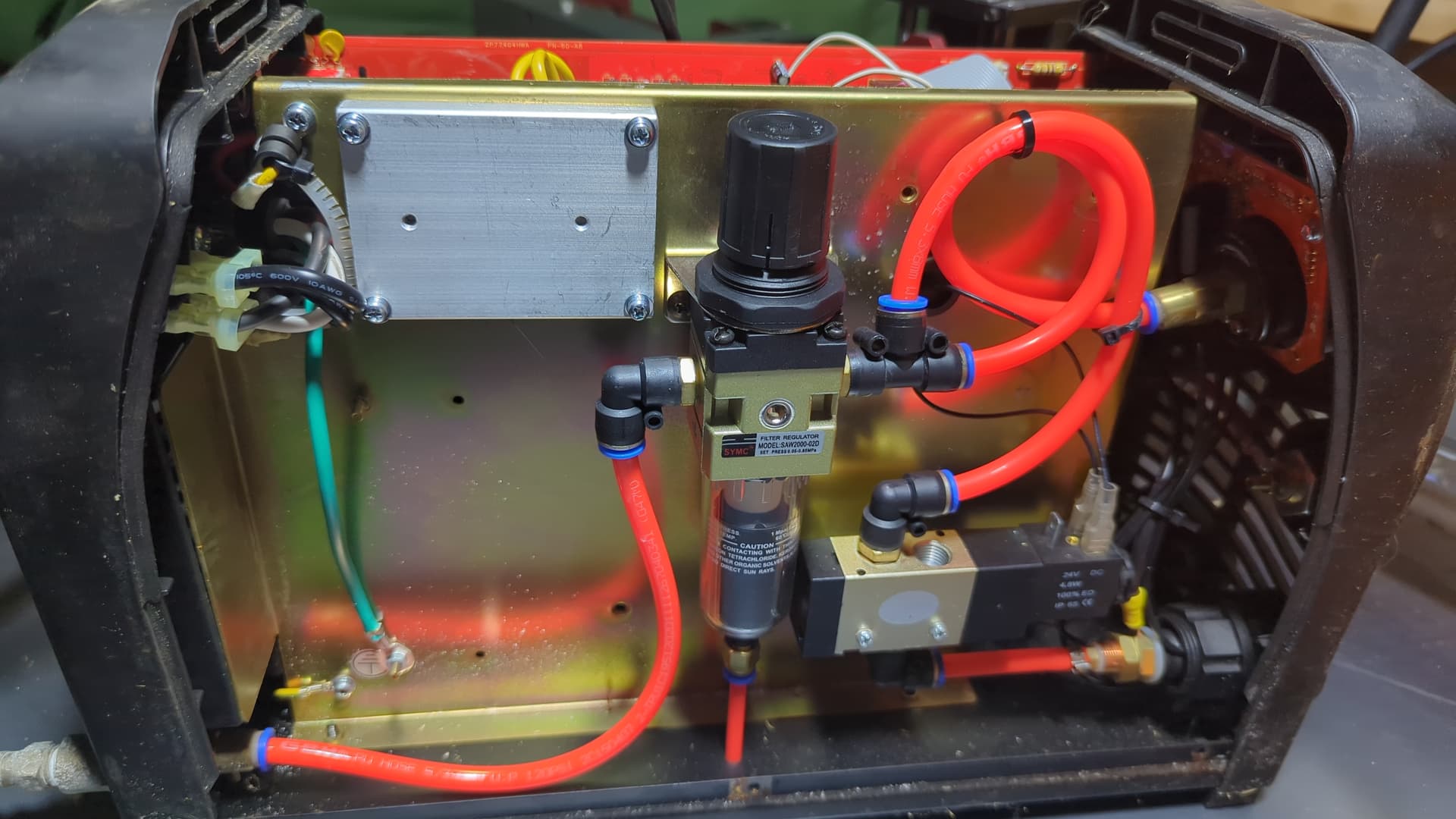

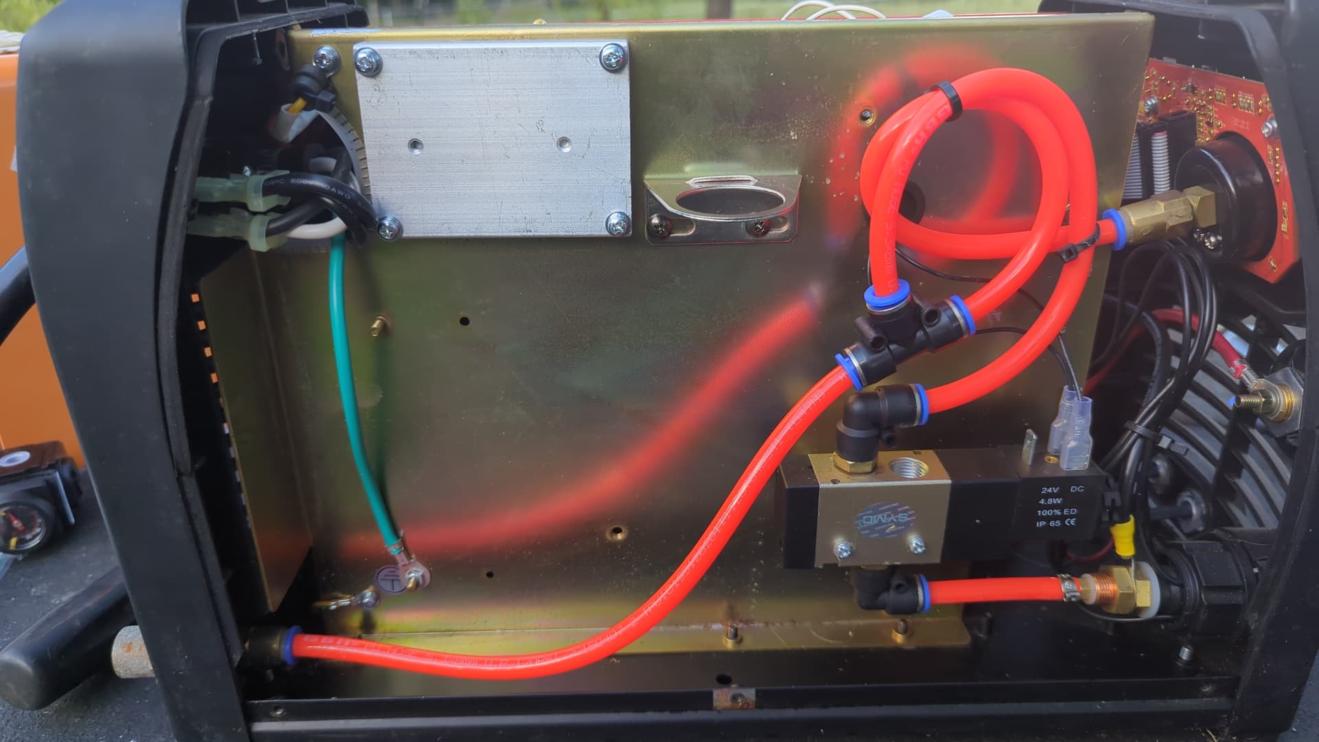

Okay I have found a couple old post where you talk about replacing these parts. Im out running around looking.
What is the plastic tee?
I should have taken my machine apart before I left buy did not. Home is 30 minutes away.
Also do you recommend 1/4" or 3/8" regulator?
All my other components are 3/8"
Thanks
T is 5/16"/8mm
What ever size regulator you want to use
Thanks appreciate the quick reply
On the front of you Razorweld there is an air switch that will help Replicate when the torch is cutting. Most likely you will have to Open the Case, 10 screws- 6 side, 4 top and end of handle, and set your Regulator to 85 -90 psi.
At that point the air switch comes in handy.
Hope this helps - Jim

But I also ordered the 5/16" pneumatic Tee and a 1/4" ARO Ingersoll Rand regulator. After George’s post I did some more search through the forums and this definitely seems to be a reoccurring problem. Most of then have George repeating himself over and over. Thanks George for your patience with those of us slow learners.
You need to work on getting clean/ dry air as well. In pics can see a lot of moisture signs on consumables. Your consumables will last longer the cleaner/dry air supply to plasma torch is.
People also don’t appreciate that this isn’t just a regulator.
It’s a regulator and filter.
I wonder how many people ever change or clean the filter?
What do you mean by “generator” for your air? Is that another term for compressor? Which specific compressor are you running? What is your filtration/drying setup, specifically (the logic path from compressor to your plasma)?
You mention your air is “dry” but I didn’t see you mention any drying components (desiccant, refrig air dryer, etc) between the “generator” and the plasma.
I would HIGHLY recommend having a big desiccant volume and then a motor guard (M-60) immediately following, right before your plasma.

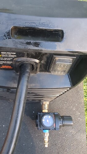

After many hours investigation I think I have 2 problems, bad regulator and water issue.
Bought a new regulator and mounted it to the outside as recommended so now I can adjust on the fly.
I have picked up a motorguard filter kit and derale 15300 aftercooler. Pretty sure I’m going to run the after cooler after the tank. Air compressors have been made with bottom drains forever. I’m not concerned with draining the tank. I empty my tank after every use. I still need a couple fittings to get the motorguard and after cooler installed.

5/16 Pneumatic Tee (40 piece kit ($18)
1/4 double male nipple ($3)
New regulator (ARO 1/4NPT ($45).
