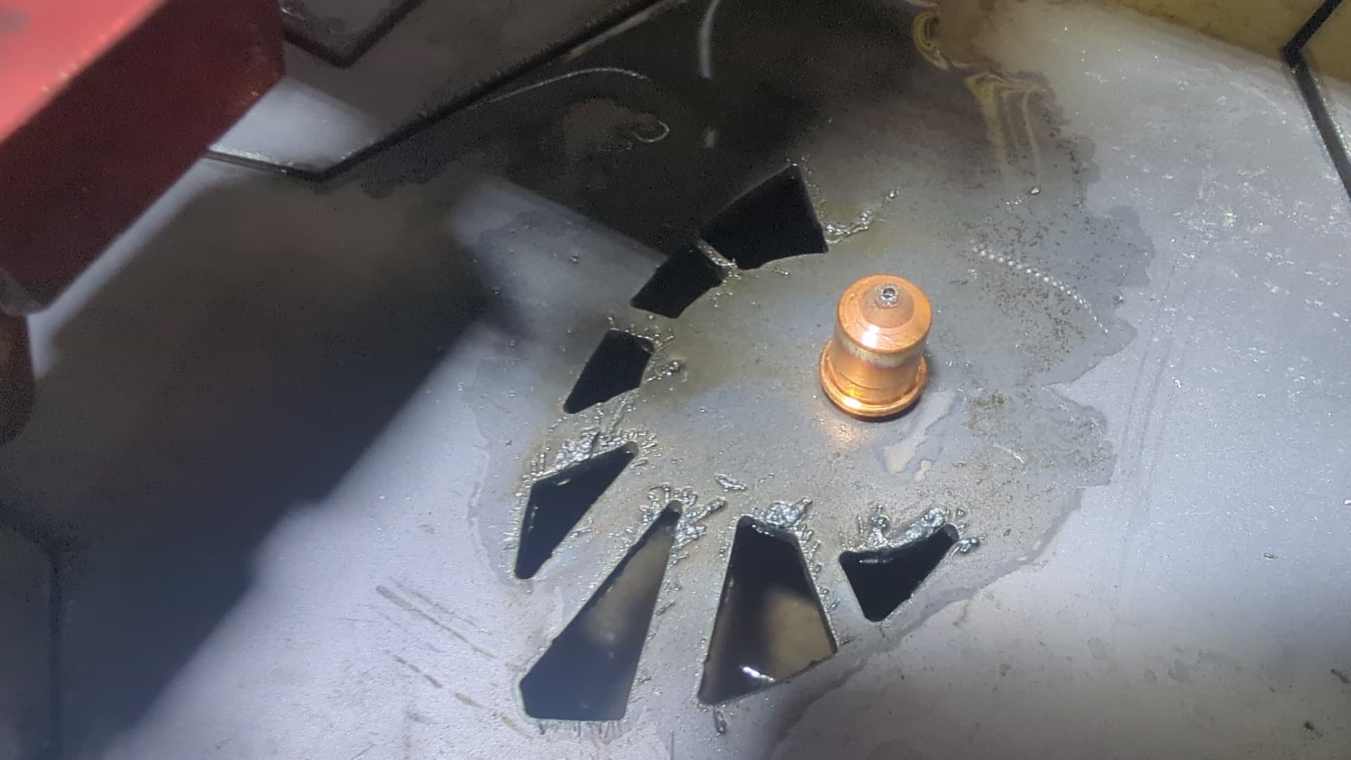

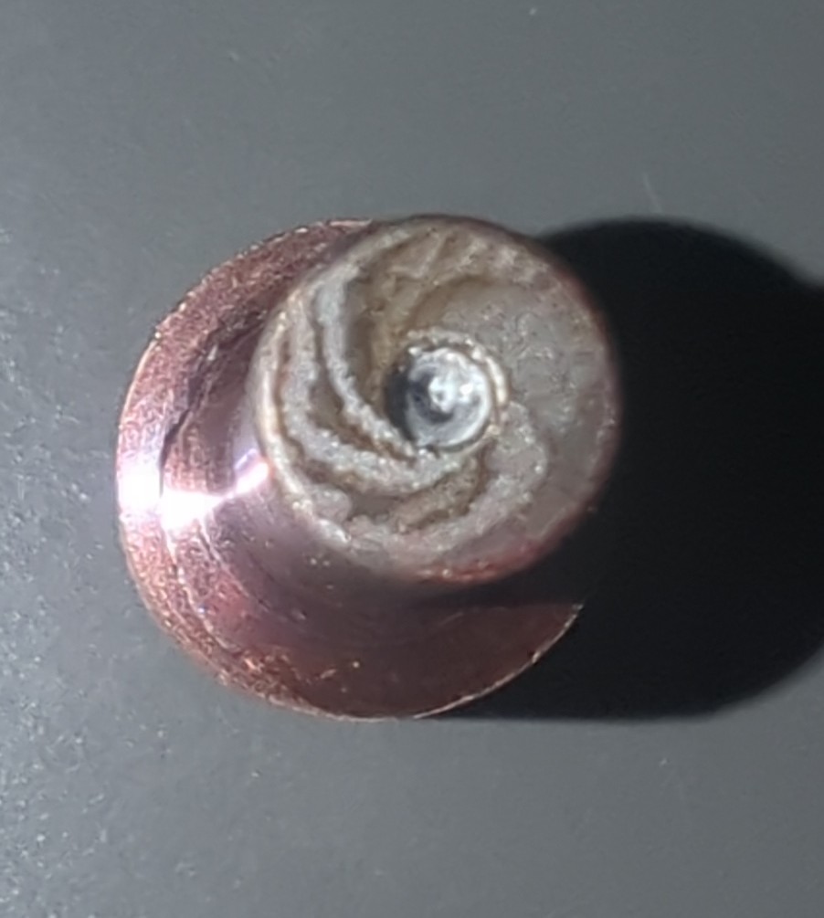

Never had spatter on the top. I swapped consumables and the spatter was very slight and has progressively gotten worst. Its definitely worst when traveling to the left. The pictures attached are from approx 200-230 pierces on that set of consumables.

The picture with the nozzle is only for size reference. That’s a used nozzle. It just those small holes cleanly. But other things are terrible
The nozzle is worn out. It also looks to be cutting higher than .06 . It also appears that the work clamp is having connection issues. On the material being cut?
I would change the electrode and the tip. Ensure the work clamp is on the metal and that it has a good connection on BOTH ends.

Nozzle looks worn, and you may be cutting too high as shown by the top dross.
Any funny noises when the torch fires is most likely the electrode is bad, even if its new or looks new. Replace it and see if the noise goes away.

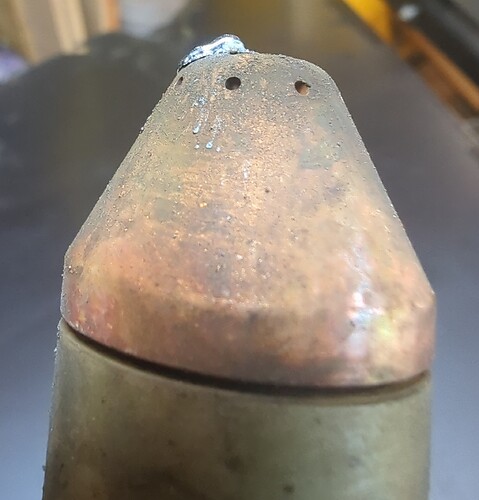

As bigdaddy stated. works till it does not. Finally got back to working on the table issues. This is the first time I have had any build up on the shield. That build up was on the back side and did not see it until I pulled the torch out to replace the consumables. These consumables have 318 pierces and 21m13sec arc time.
I’m going to replace the shield when I replace the consumables this time.
Just clean the shield and use some anti splatter on it to keep the slag off.
