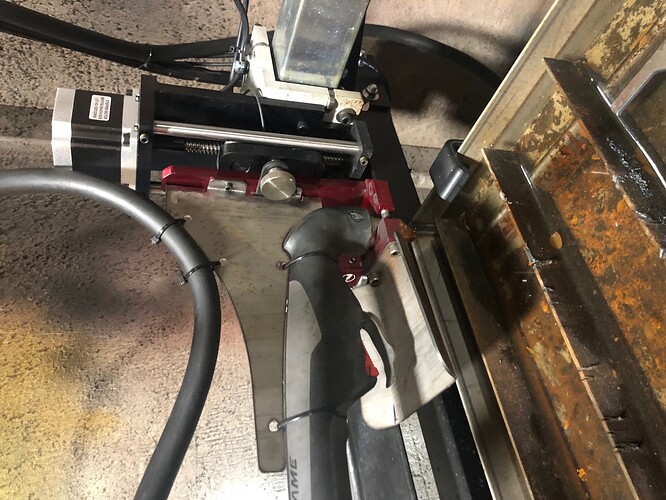

Does anybody have a DXF file for the fireshare X45 hand torch top holder ? ( NOT ) a cut ready one …
Why not just upgrade to a machine torch.
FUNDS !!! And the price !!!

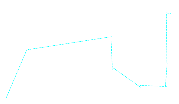

I very very quickly did a trace of the image of his DXF posted in FireShare and came up with this before having to leave for work… If a guy spent a little more time refining and scaling, I expect it could be made to work… Of course, contacting the original poster in FireShare may be a little quicker… ![]()
Quick Trace.dxf (80.8 KB)

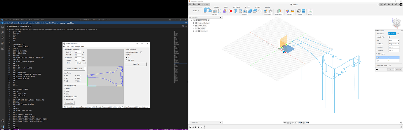

NC to plot is also an option
here is the og fireshare
https://www.langmuirsystems.com/fireshare/razorweld-j45h-holder
These are NC to DXF plotting programs
I had use NCPlot v2.34 before my trail expired.
https://www.ncplot.com/ncplotv2/download.htm
This is time I downloaded and tried G-code ripper with some clean up in fusion.
kerf would still need to be allowed for.
https://www.scorchworks.com/Gcoderipper/gcoderipper.html#download
Files below
Torch holder NC to DXF code ripper 1 v1.f3d (800.5 KB)
Razorweld J45H torch holder new G code ripper and f360 projected.dxf (17.5 KB)
