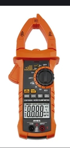

Compressors are huge draws when starting, you could always put a AMP clamp on and check it. 60 amp service is not much.

Amp clamp? Never heard of that I will look it up between my baking/cooking today.
Thanks
Everyone enjoy the Family and Food.
Hahahaha… geesh I read the post as an AMP clamp would help with the power surge. Yes Amp clamp. I have one of those from my Mechanic days.
Just incase someone is learning this is an amp clamp

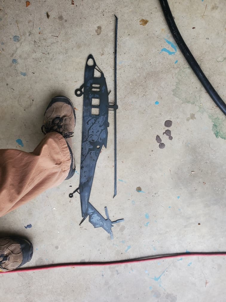

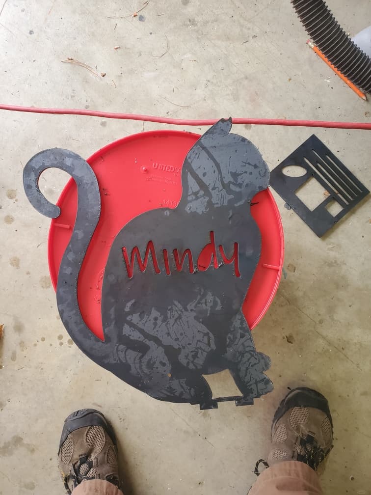

Cut a 4’ bear no issues.
Still having a few issues on more detailed pieces but I know have the little $400 magic box working and need to redo the programs with the THC turned on.
The air compressor is definitely the reason for some of the lost arc but main times the compressor is running or does not turn on. Unfortunately I dont have enough eyes to watch all the guages bit I figuring it out and start from line has worked Great.
So far everything has been save able
Thanks for everyones help
