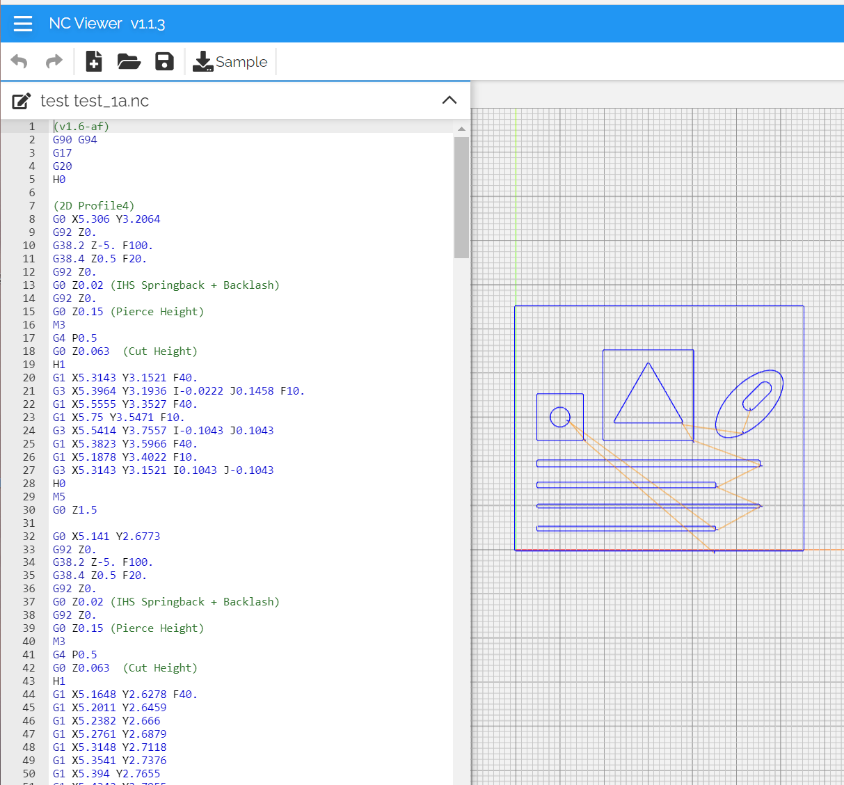

One more tid bit. Generally stops on code line 21, 22, or 23. I dont really know how to read the code so Im not sure if there is any actually significants to that or not.

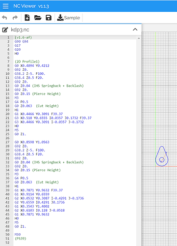

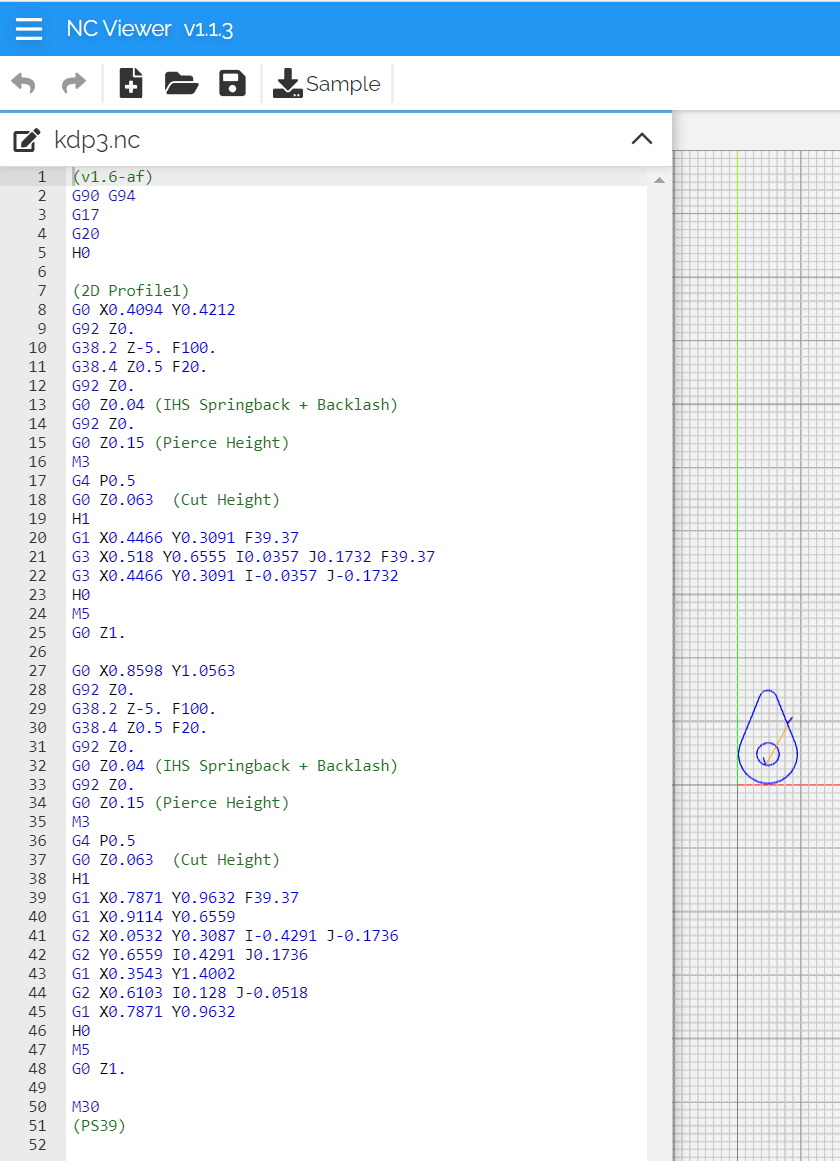

If you can open the code with notepad and copy and paste some of it here, that will help to see if it’s a code problem.
LINE 21 G4 P(pierce delay in seconds)
LINE 22 G0 Z(moving towards cut height)
LINE 23 H1 (turning on the THC)
Like the others are saying, a short Pierce delay may likely be the source of your trouble. I find myself accidentally writing in .05 seconds from time to time instead of 0.5 seconds

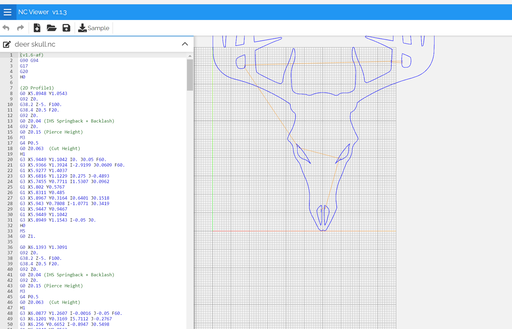

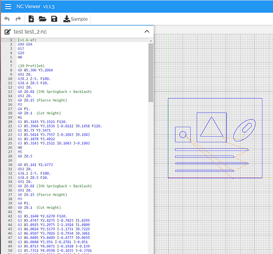

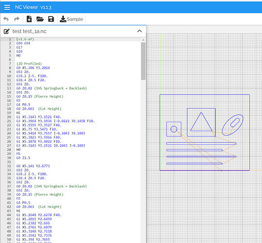

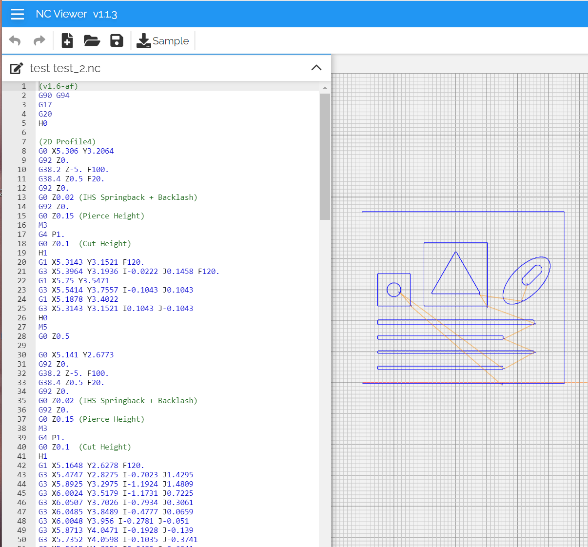

This is my gcode created by F360. The program would do a dry run completely. When I ran it live it would go to point one and either (1) Pierce and stop or (2) Pierce and move 0.5" then stop.
This is my gcode created by F360. The program would do a dry run completely. When I ran it live it would go to point one pierce then stop.
This file was downloaded from the langmuir fileshare. This file would only pierce.
last but not least this file was downloaded from the file share and would only pierce
