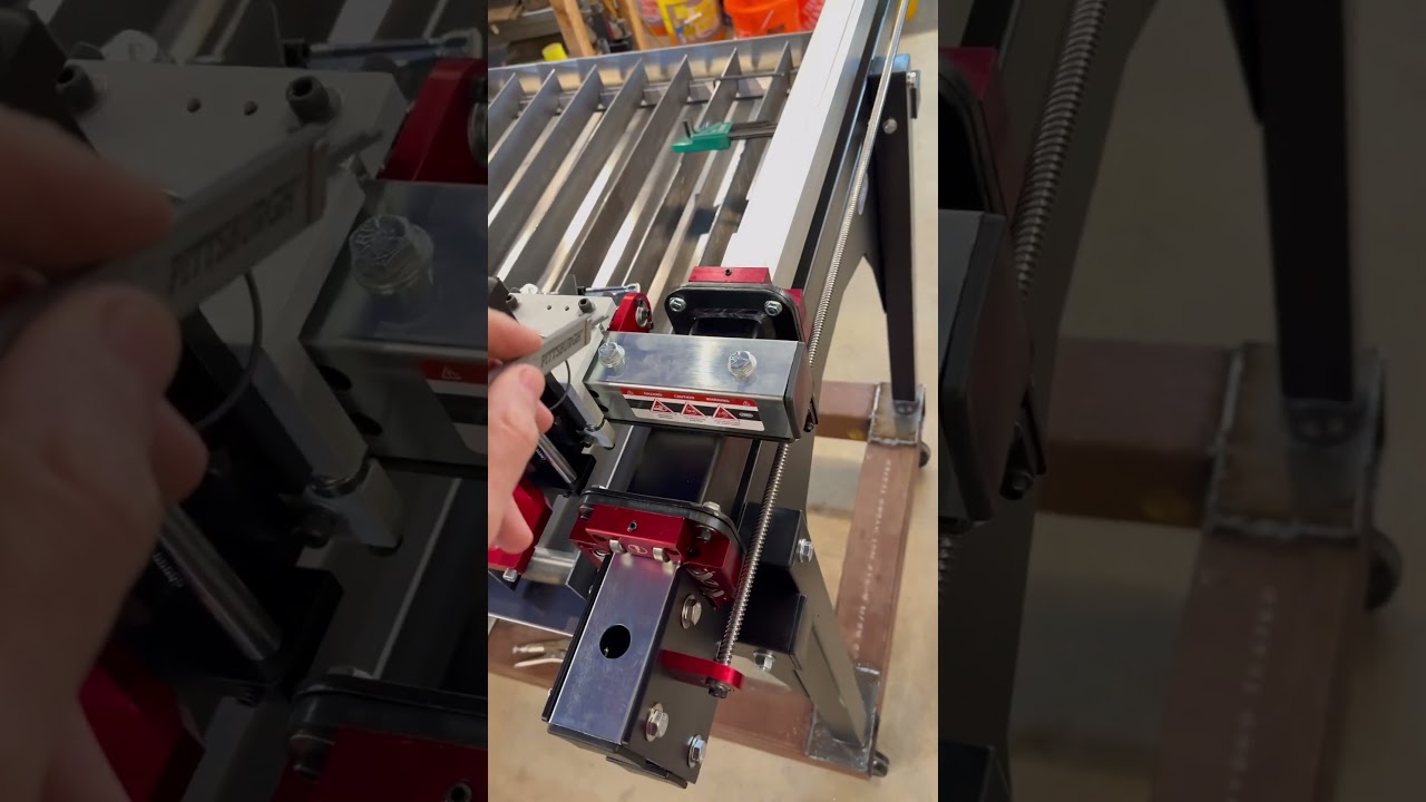

So, I’m getting refusal to move at the ends of the x-axis, mostly on the left, but also on the right. We went through the process of getting the x-axis gantry installed per the instructions, but you can see in these pictures, it bows our as the gantry gets to either end. Do I need to redo the gantry alignment?
The X and Y bearing mounts for the lead screws are different lengths. Make sure you didn’t install a Y mount on the X axis.
Ya, we did that at first, figured it out the day we assembled (because it really bowed out) and fixed it. now it just looks like the lead screw is 1/8"+ too far out.
I would loosen the two bolts holding the x-axis lead nut, and the two cap screws holding the x-axis lead nut mounting tab, move the x-axis as far positive as you can, and go through the tightening steps again as described in step 15 section a7 of the assembly manual.
If that doesn’t help, I’d probably reach out to Langmuir and see what they say.

Just based on the way the lead screw is bowing away from the gantry there is a misalignment somewhere, and since it is binding at both ends the most likely culprit is either the motor/bearing mounts (not likely based on the direction the lead screw is bowing, also @boughtnotbuilt says he has already corrected this), or the lead nut. Based on the pics it appears the lead nut is too far from the gantry and pushing the lead screw away, which causes binding as the carriage gets closer to the ends. The coupler shouldn’t cause this problem, although the binding could cause the coupler to slip as the leadscrew becomes bound up at each end.

So, moving the gantry to one end, loosening the screws that hold the lead nut bracket to the gantry and it moved into place. Also swapped out the coupler with the after market one recommended elsewhere on this site.
This taught me you can’t really set the X-axis gantry up centered, the lead screw is just to flexible.
