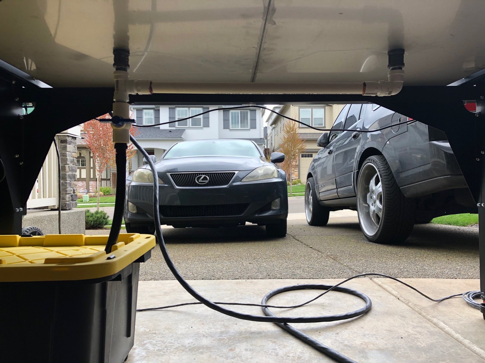

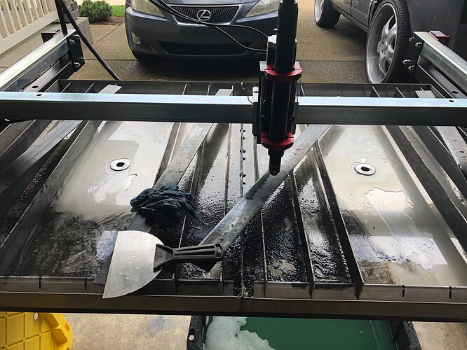

Added 3/4" drains to my table. It’s just a drain, no fill. I figured it’s easy enough to just pour it back in. After I drain it whatevers left over I just wet vac it along with all the sludge that’s in there. The wet vac works out pretty good.
