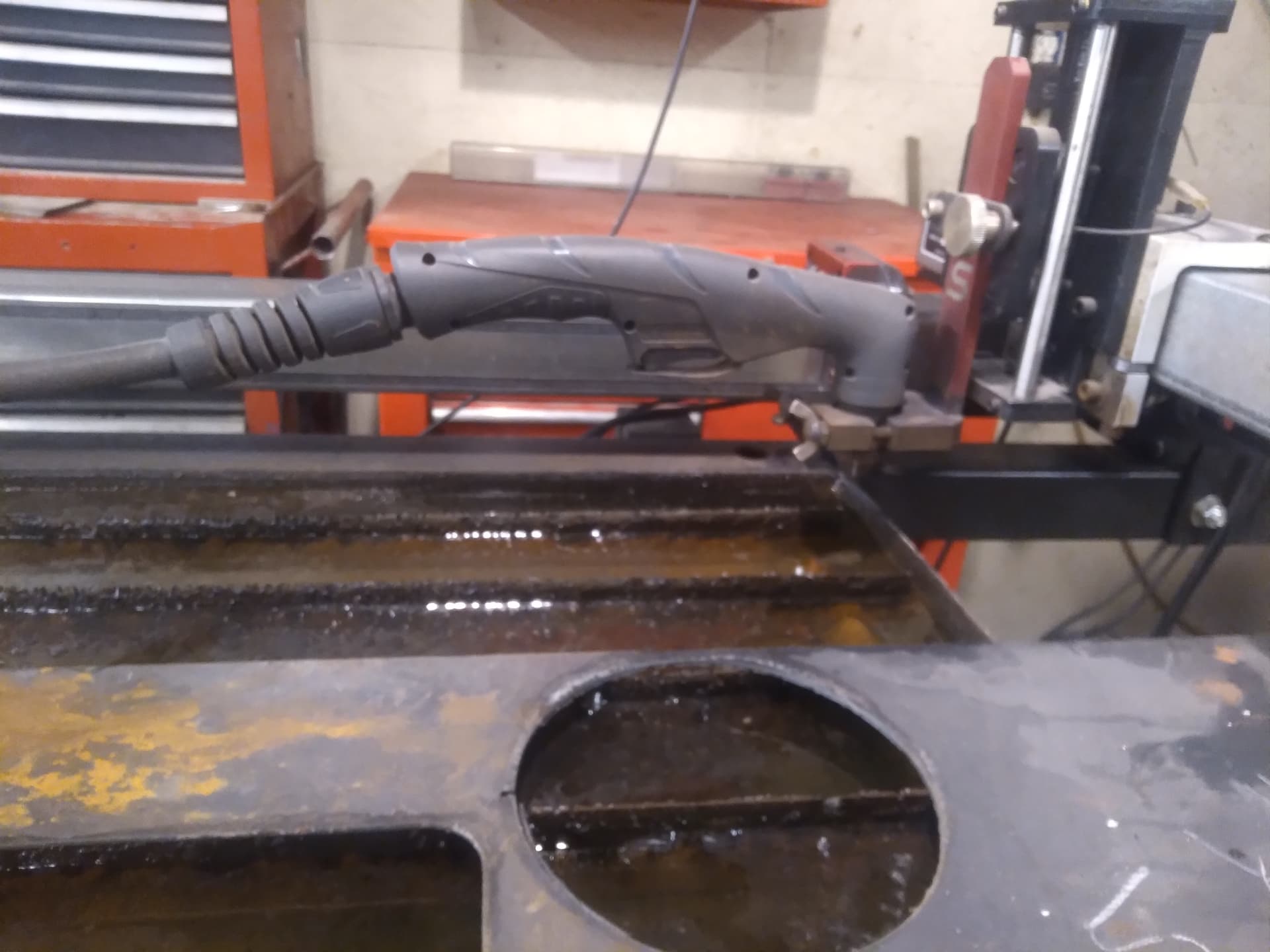

Ok. Wondering if anyone has any charts for cutting speeds and amperages with the razor cut 45 with machine torch broken down by gauge.
Honestly just figured out that the knob on the front of the machine is useless when using the THC and have to program my amperage in with fusion 360 when generating the code.
Was wondering why I was getting some massive dross when cutting the 18 gauge steel, and saw it was programmed at 70 in/min at 45 amps.
Started speeding it up and cutting the amps back but also will be moving to a 20 ga and would prefer to not have to do the trial and error.
So far I only have. 18ga, 20ga and 7ga in my garage. If anyone has any input on the feed rates and amperage for these I’m all ears. Prefer clean cuts not just speed.
Just so you know, the amperage setting in Fusion has no way of changing your cut amperage or the THC settings. Amperage can only be adjusted at the machine face, and THC target voltages (if you’re not using Smart Voltage) must be entered by hand in Fire Control.

We also run a RW45 and Fusion, so I’ll take a stab at your questions.
  1. For the 18ga, what settings (Pierce Height, Pierce Delay, Cut Speed) did you have entered in Fusion? In our case, we run 18ga at 40-45A, .15" Pierce height, .06" Cut Height, .5s Pierce Delay, 200 IPM Cut Speed. (With standard consumables.) I’ll also leave THC in Smart Voltage, as I haven’t had any issues with it yet.
  2. What amperage to set? I prefer to match my consumables. Until recently, I cut everything from 18ga to 1/2" at 45 A. Cut speed and Height are the variables. The only way to adjust amperage for a RW45 is the dial on the front.
  3. THC will adjust the height of the torch to match a predetermined value. With Smart Voltage enabled, THC will sample the 1st 1/4" of cut, then adjust torch height up/down to achieve the target. The key to remember here is Smart Voltage samples the beginning of the cut, after the pierce. If your pierce delay is too long, it will throw THC out of whack, and as such, your cut height.

Correct. I’ve found 40-45A to be a good setting. Pierce and Cut heights I try to keep the same (.15" / .06"). I have speeds pre-programmed into my tools in Fusion (one for each material thickness), so the only thing I need to change when I post is the pierce delay. (Thicker material = more delay.)
I will also say that Feed Optimization has greatly improved my cuts in small areas. I’ll set it to ~60% of the cut speed. (Note - THC will temporarily turn off when the speed drops.)

To make things simple right now, just keep your amperage at the max setting then you only have the speed to adjust. You will start playing with the amperage when you see that you might be blowing out some of the detail with too hot of a stream.
To give you some other things to consider as you start to explore cause and effect:
  1. The cut height is very important for the quality of the cut. Lots of dross on the top indicates you are moving too fast or the torch is too high. Conversely, Lots of dross on the bottom side indicates too slow or torch is too low. You will also see a bevel to the cut if the torch is too high (sloping away from the top) and if too low (sloping under the plate).
  2. Realize if you are moving too fast on small radius, there will be a bevel to the cut as well. That is why it is advised to use “Feed Optimization” to slow down the torch on these details. You will get more bottom side dross but correct for the bevel cut and get a more complete removal of material for the hole.
  3. If you are going for artistic designs, the bevel might not matter and in the interest of minimal to no dross, focus on the speed that minimizes the dross.
  4. And don’t forget to check your consumables regularly. You may be making all sorts of corrections with speed, amperage, and cut height and then realize that the nozzle or electrode were beginning to fail. I would say the nozzle is the most often overlooked item. If you see that orifice expanding and/or no longer a perfect hole then it is no longer focusing the energy of the plasma torch. Your cuts will be affected. Early on, if I swapped out my electrode and nozzle and saw that it made no difference, I set them aside as still having life. Use those saved consumables when you are going to make utility cuts such as brackets for the barn or something with lots of piercings that is more for function than looks.
