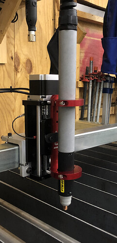

I have used the fine cut consumables mostly. I don’t count pierces or anything like I see some people doing. That being said I’m not changing consumables hardly at all and my wife was making tons of Christmas ornaments with tons of pierces each. I do inspect them ever few weeks to make sure I’m not getting too worn. I think i’m getting excellent life from my consumables even if I’m not changing them as frequent as I should, I’d still be happy with their lifespan. The regular consumables cut very well also, better even in many regards, but I’ve used them very limited until this point.
From what I understand with speaking with Hypertherm is the Duramax torch allows my 45 to use any of the XP consumables and basically allows it to function as an XP at the torch end. I spoke with hypertherm at length before buying the Duramax torch and am very happy with the money I spent.
Thanks for the reply. I have tried the PM30 consumables in my 45 and liked the smaller kerf but the lifespan was really short. I think I will try the Duramax machine torch and if I really think I need the XP machine I can just buy one without a torch or with a hand torch.
I’ve never used the 30amp consumables but was told the consumables in general in the duromax will have a longer life.

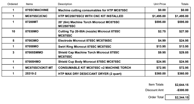

I ordered ^ over christmas including their machine torch specs align with the 45xp in fact some of the consumables swap over ie if I want a finer cut i can run a powermax 30 tip. The reason I wanted the 45xp was for the fine cut but this seems to be able to match that.
I followed IG on someone with the same setup on their crossfire the cuts look pretty good. Jeff over at HTP has also been very helpful and responsive in answering questions. I own their 221 Invert tig and its been awesome since I bought it 7 years ago. Did some research and people all seem to be happy with their plasma.
Ignore the 300 discount as that was a Christmas promo but even so attached is what my OTD price was with everything. (I also orderd some tig stuff so even less if you subtract that)

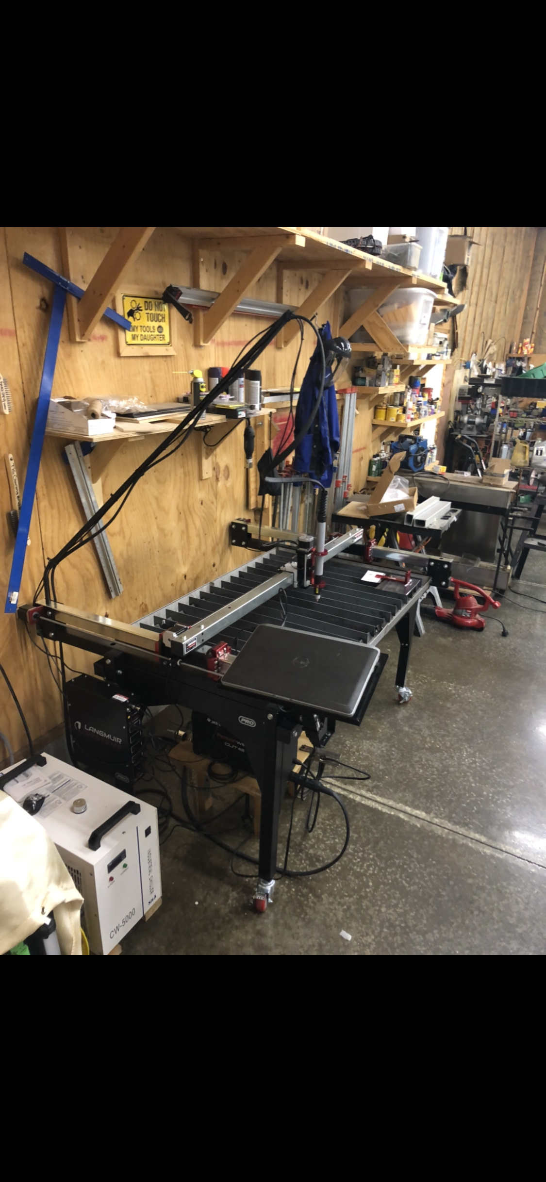

Now to be fair since I waiting on the pro to arrive I have not fired up the torch, I only have the machine torch at the moment.
Oh another upside is the air requirements are lower. My compressor is only 6.3cfm@90psi which the 45xp would mean I need to upgrade. The microcut is 3.5cfm@70psi
Looks like a nice unit… but dang it’s close in price to a 45xp… what factors other than the cfm requirements and the cost savings tipped you towards this one.
Mainly that its 100% duty cycle at 45A vs 50% on the 45xp.
Also if you switch to manual cutting it’ll go up to 55A. Though I don’t see myself needing this… nor why its able to do that on manual mode.
Didn’t notice the duty cycle. Nice. My guess would be it goes up to 55 amp on a hand torch because they assume it won’t be doing production work on a cnc tabe with a hand torch. Although seems like they could have just adjusted the duty cycle… nice find
