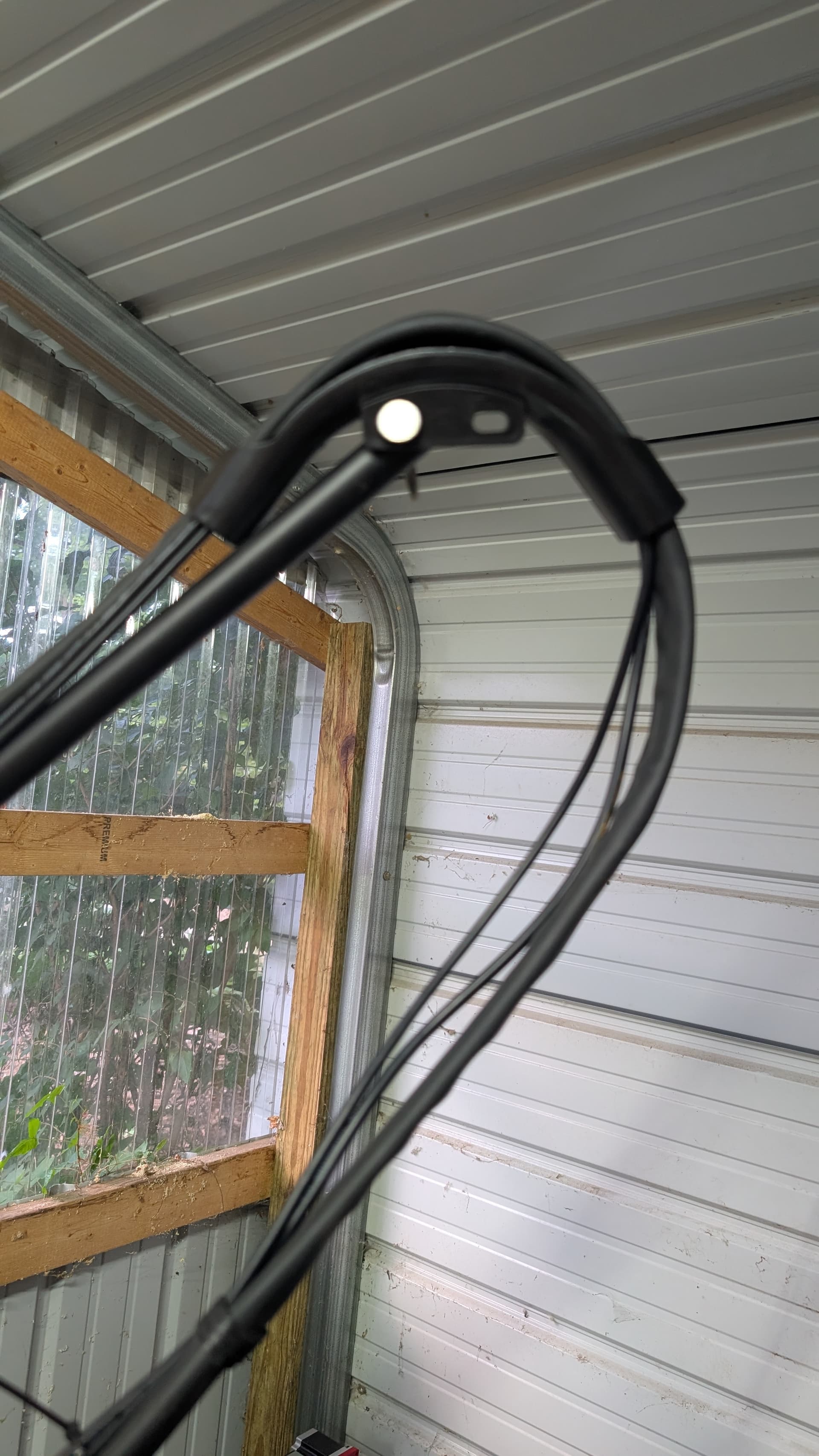

At the top of my arm I used a 3/4" PEX 90 deg support bracket to ease the sharpness of the bend. The white circle you see is the head of a bolt I used to attach it to the arm. Only a few dollars from anyplace that sells plumbing stuff.

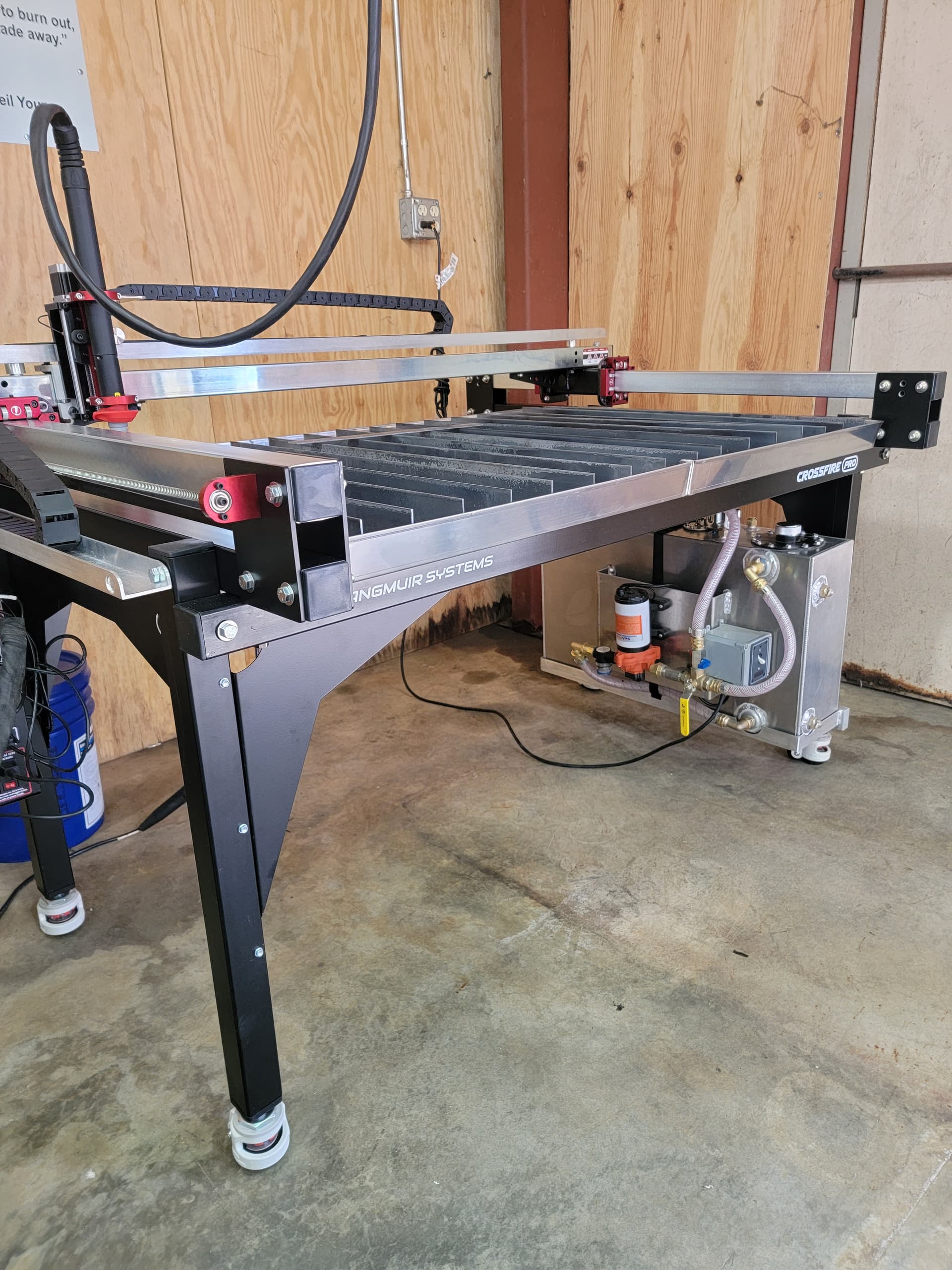

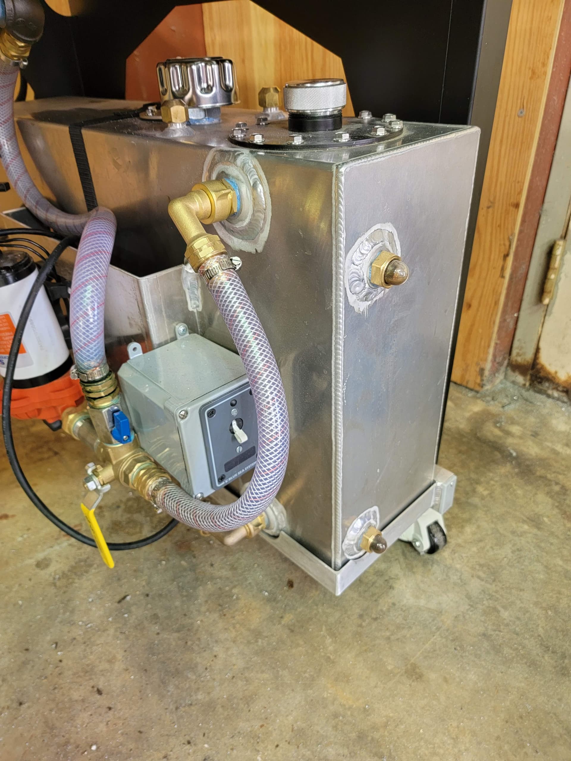

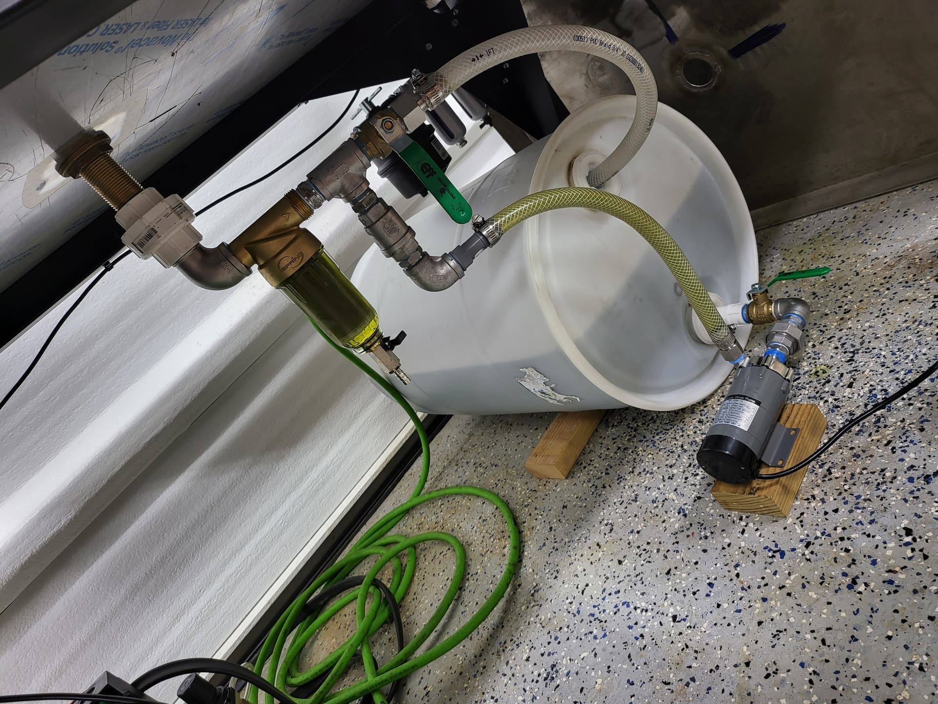

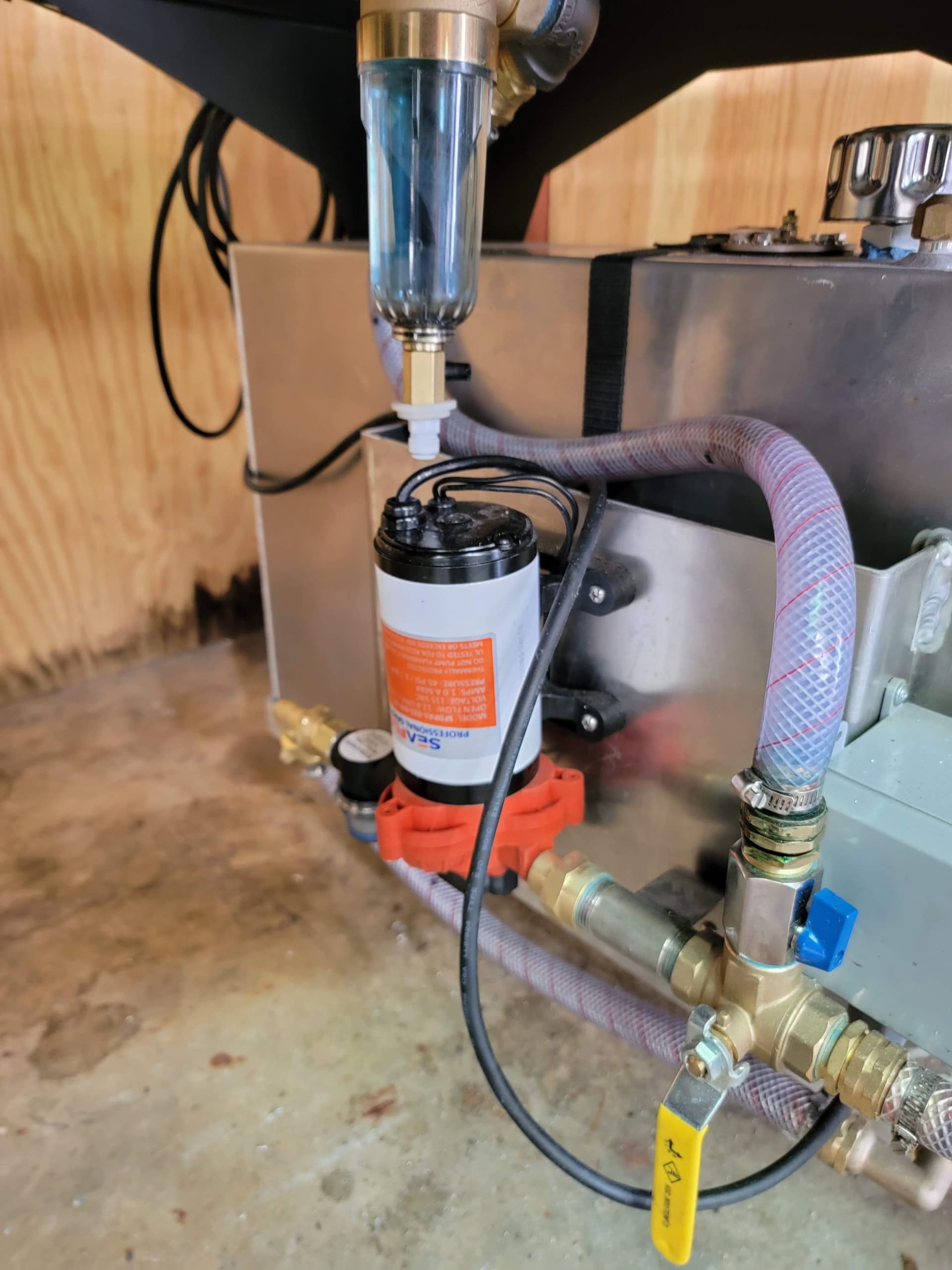

Yes, I drain after every use of the table. There’s a filter ( Amazon.com ) right after the table drain, and then a T, one side has a ball valve that goes to a 35 gal plastic drum, the other has a check valve coming from said pump extracting from said plastic drum.
I have since added a 2ndary 10" “generic” water filter housing with a 20 um filter cartridge before the drum (on the table drain side) to help remove any finer bits and clarify the coolant that much more.
