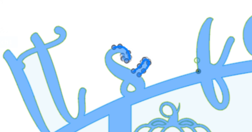

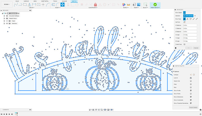

OMFG, the dots.....THE DOTS
I’ve gotta walk away for a while, they are KILLING me. The text it is going to destroy me.

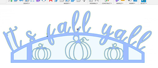

Thought I’d save file and upload into inscape, cannot. Unless I pay for it, at least that’s what I see. Where do I go from here? I’d upload the complete file but I cannot find it to do so it is hidden in Fusion somewhere!!! I tried to export but it won’t let me attach. Oh lord I feel frantic inside…I’m going to step away and put an axle back together.
(Guess this is me pleading for help)

My guess this file was made with some sort of converter at one point?
On the left hand side find sketches right click on sketches and it’ll give you the ability to save as DXF.
You should be able to export a f3d file from the top bar

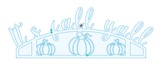

Being there’s a green line around it it looks like you inserted an SVG.
The green line signifies that it’s a locked drawing.
In the top bar under constraints there’s an icon that looks like a red padlock use this icon to unlock the drawing and turn it from green to blue

The pumpkins were SVGs the text I downloaded from 1001texts.
edit…unlocked…

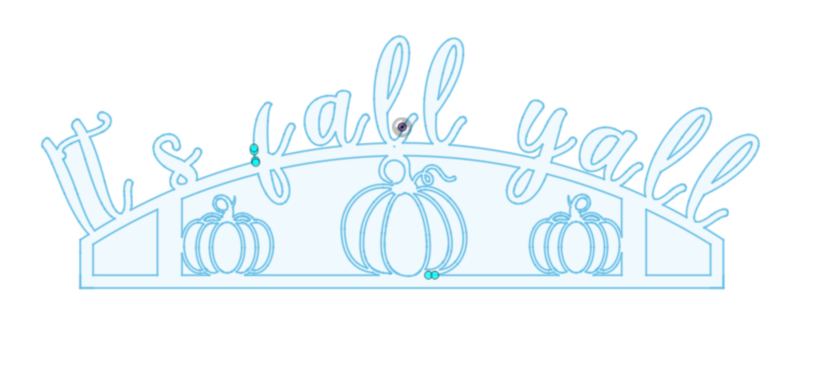

@TinWhisperer So I extruded the image the created a new sketch and projected to the new plane. Is that a long way around?
Going to start looking at it now .ended up out in the shop for a couple hours.
extruding and projecting can clean up a image some and delete constraints in the new DXF exported
great first step

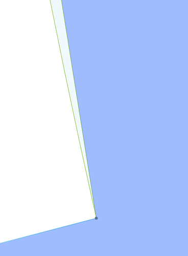

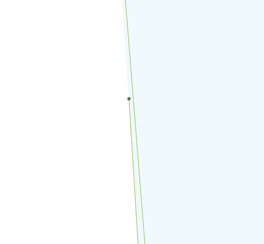

Just some overlapping lines and not connected lines.
This one is good.

I find it crazy how much you gotta zoom in to see the broken lines. Also when I do my computer starts getting a little crazy. Probably outdated, laptop is maybe 6 years old.
It’s a pretty dirty SVG lots of poly lines.
Even my desktop grunted a little bit lifting that file.

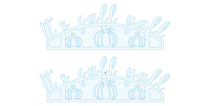

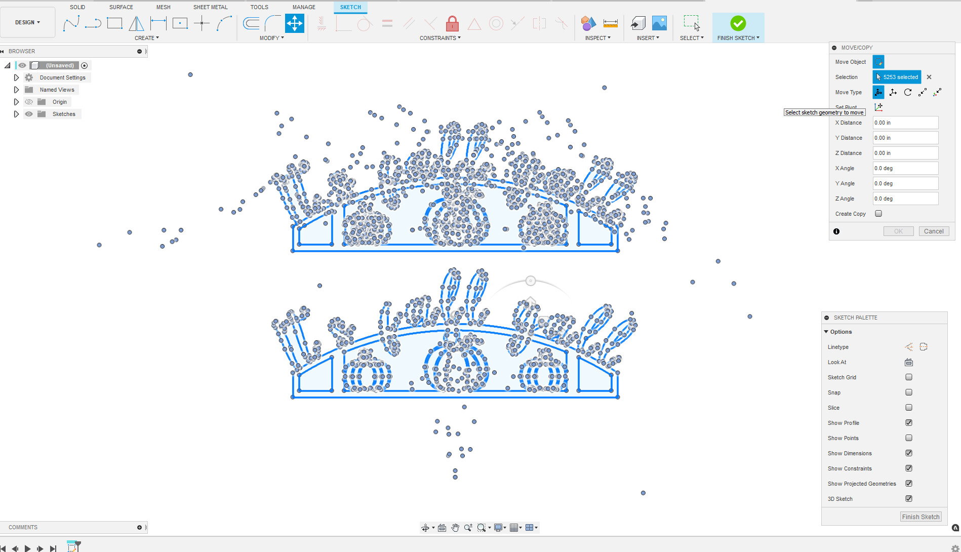

I ran the dxf file through Vcarve Pro, reduced the number of nodes, joined all open vectors, looks better now.
It’s Fall Yall.dxf (138.7 KB)

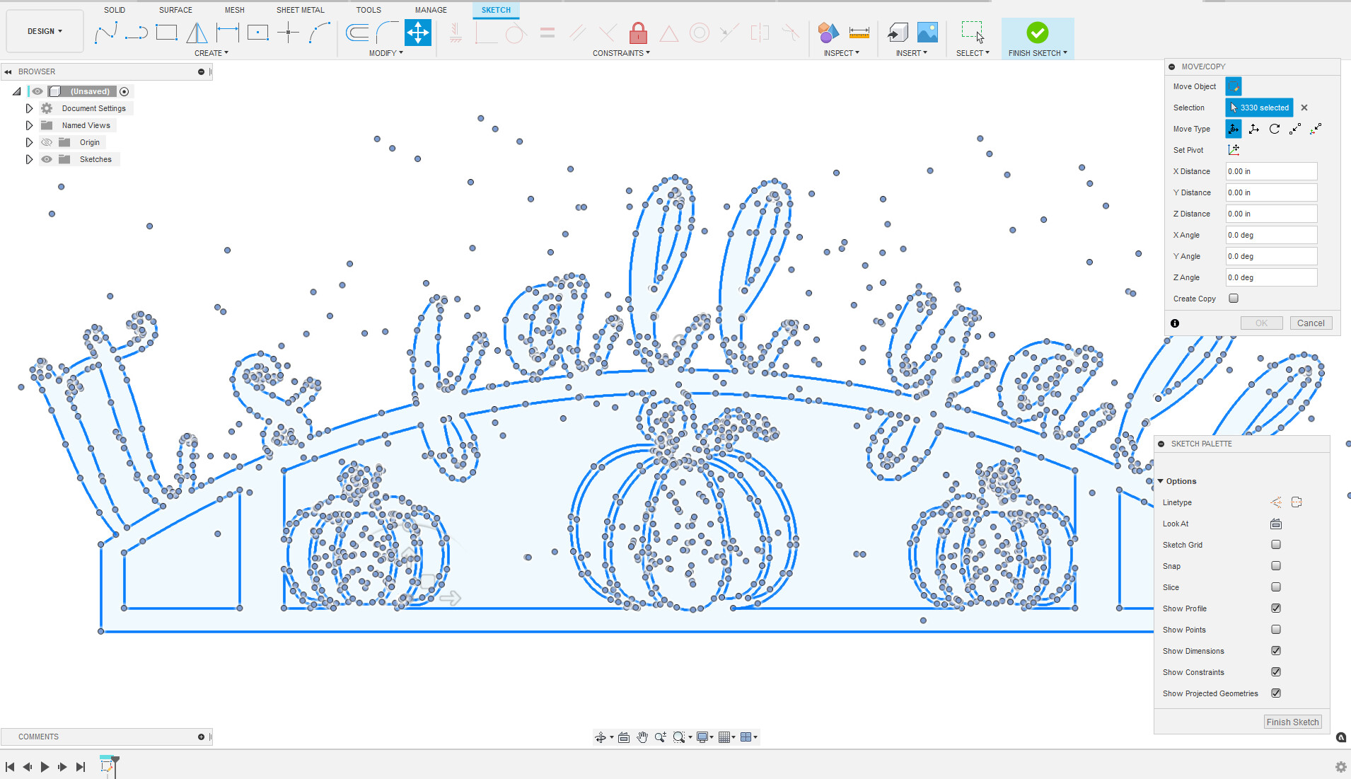

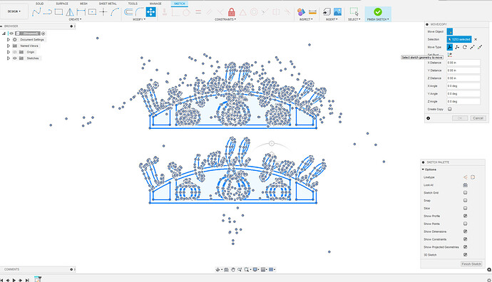

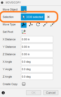

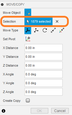

Comparing the files
@Highpockets Version
138.7 KB 3330 pieces of geometry definitely lighter running in f360

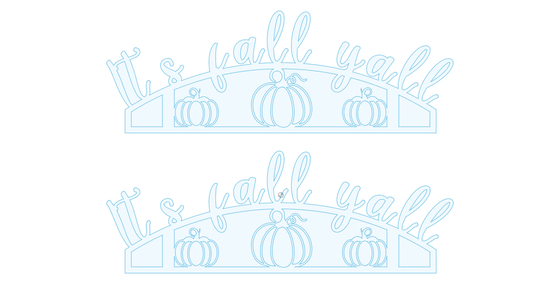

fall yall  follow up 2
@TinWhisperer Version
331.6 KB 1879 pieces of geometry definitely more resource heavy in fusion360
fall yall  follow up tin 2
So odd. Fusion has a few tools for node reduction and smoothing then I haven’t really played with yet.
So much i still have to learn about vectorizing.
I love seeing the different ways of doing this
Top Version is @Highpockets
Bottom Version is @TinWhisperer
Between the two… Does that actually translate to any different cut quality? Or is it a time perspective?
