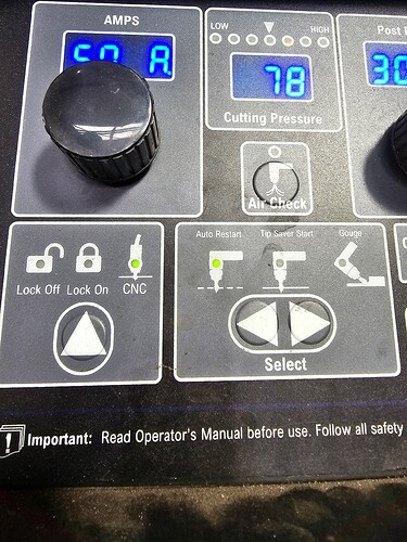

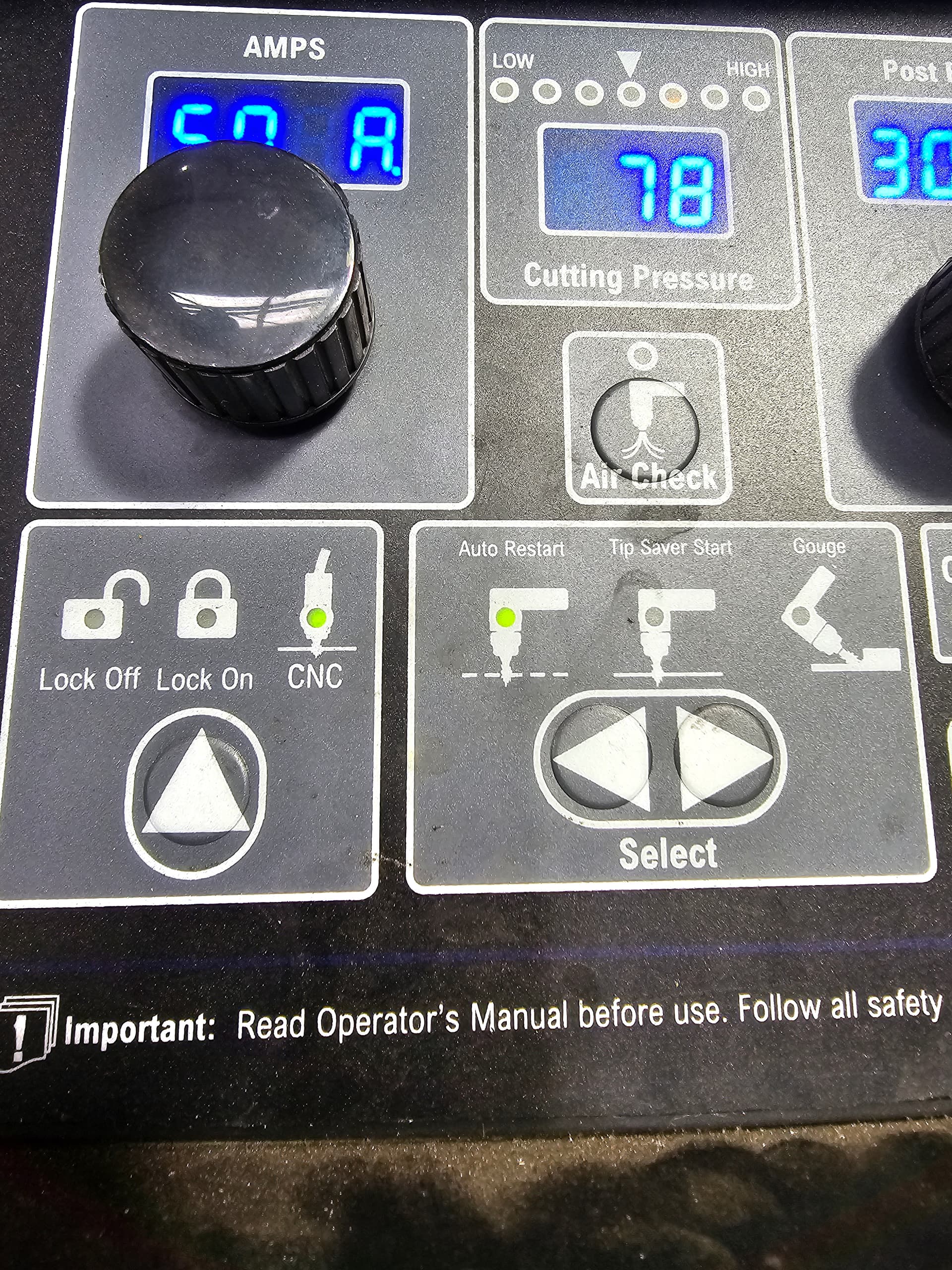

Is the Everlast set to CNC on the front? And is it set to tip saver? The picture here is set to auto restart. You need to be on tip saver.
l
ok…interesting thing to note…when i use firecontrol…for the machiine torch…voltage never goes up stops at 4.4v…for the hand torch…goes up fast
yes cnc and tip saver
