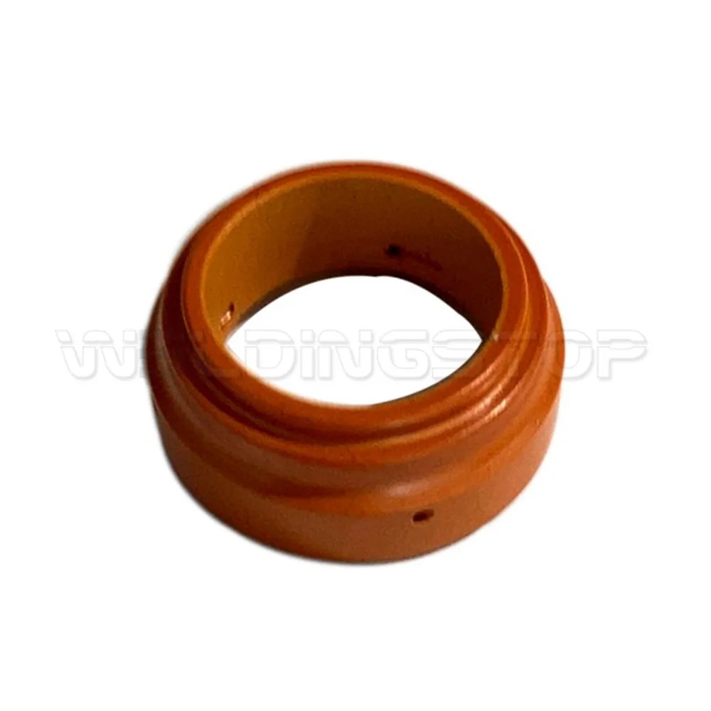

Make sure that the consumables are installed correctly. The plastic swirl ring inside is installed with the notch down into the tip. Could you send us pictures of the consumables and your torch mounted on the machine.

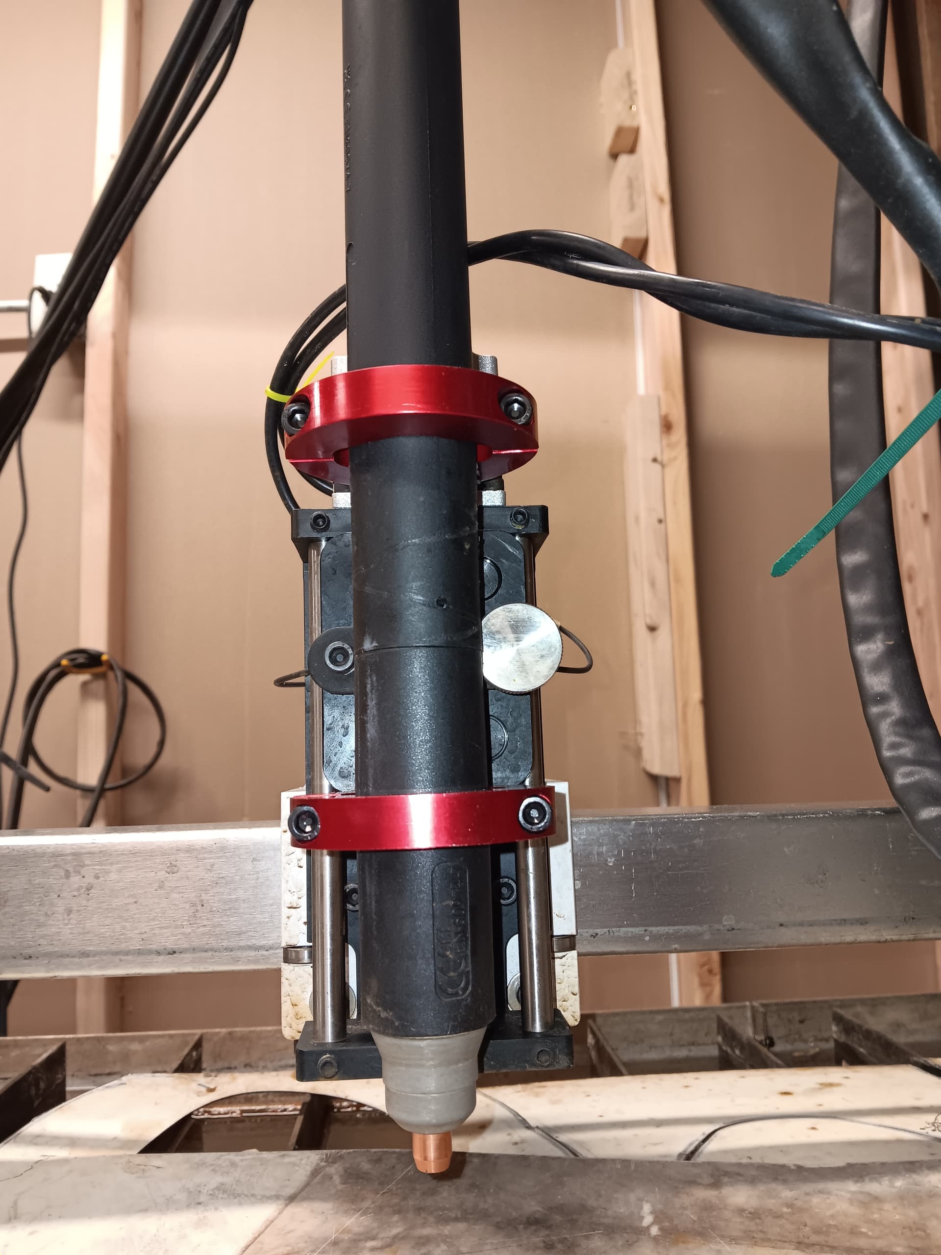

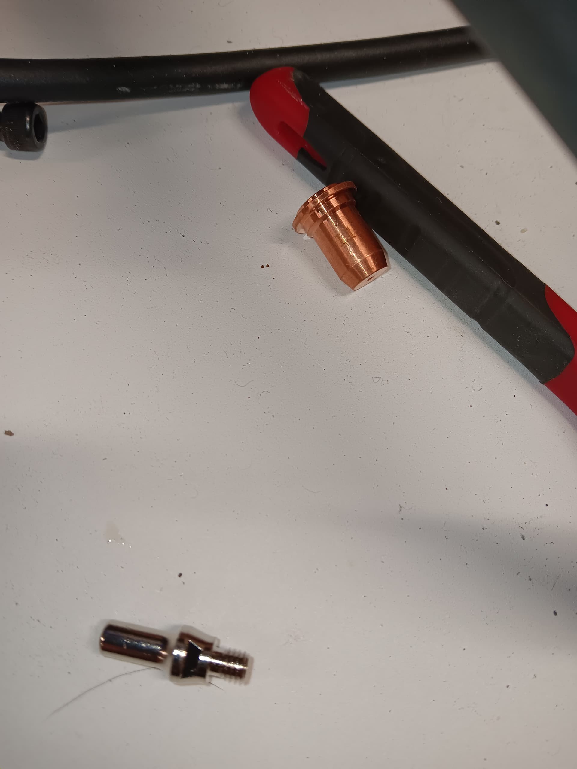

Send us pictures of the parts and torch mounted on the machine. We are going to run out of threads soon. Pictures of the consumables

Loosen the bottom mounting clamp. It is squeezing the torch mechanism. And you are totally positive that the electrode is free inside the torch. Just like the video I sent you. Take the consumables out of the hand torch and install them in the machine torch.

Just hand tight. Change the consumables from the hand torch, including the swirl ring.

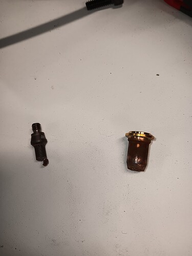

We are going to run out of replies soon. Those old consumables are the worst I have ever seen. I believe that the pilot arc mechanism is trashed or stuck. Or you have something assembled incorrectly.
when i was screwing the outer piece on…i noticed it stopped being able to depress…so i ledt it looser…i also turned the ??? over…
swirl ring
