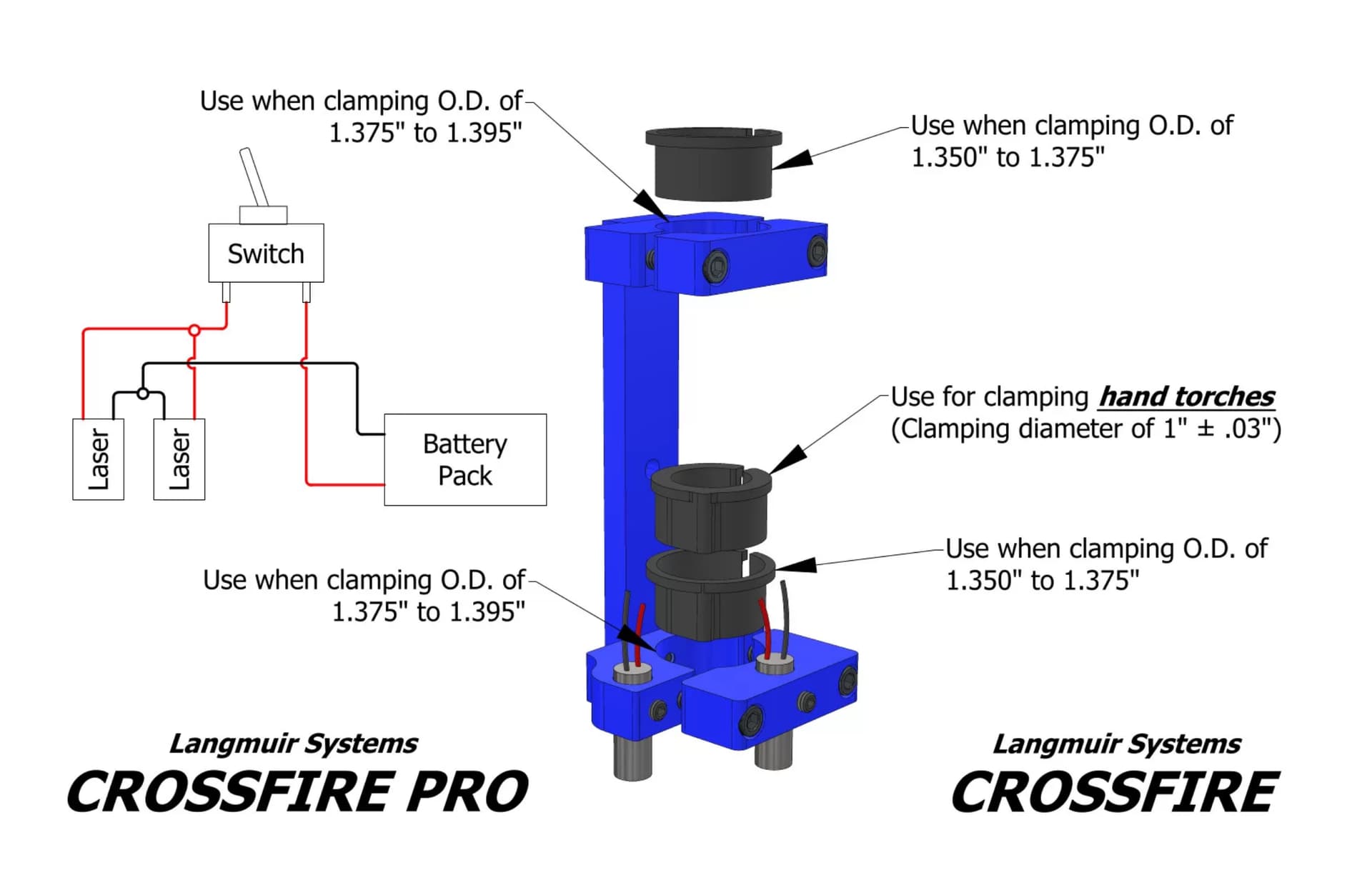

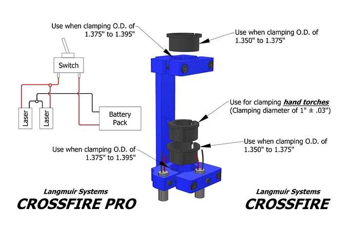

Beck’s Armory also sells a nice version of the torch mount with some laser crosshair mounts
The Beck Tools (aka Beck’s Armory) mount works with all major machine torches and also has an adapter that allows you to run your hand torch if you haven’t upgraded to a machine torch yet. On top of this it gives you laser alignment as mentioned above. :slight_smile:
Also because the Beck Tools holder is not a V-block clamp design (but supports all the way around) it will not damage the sensitive part of your torch.
If you have any other questions let me know. I’m it’s designer.

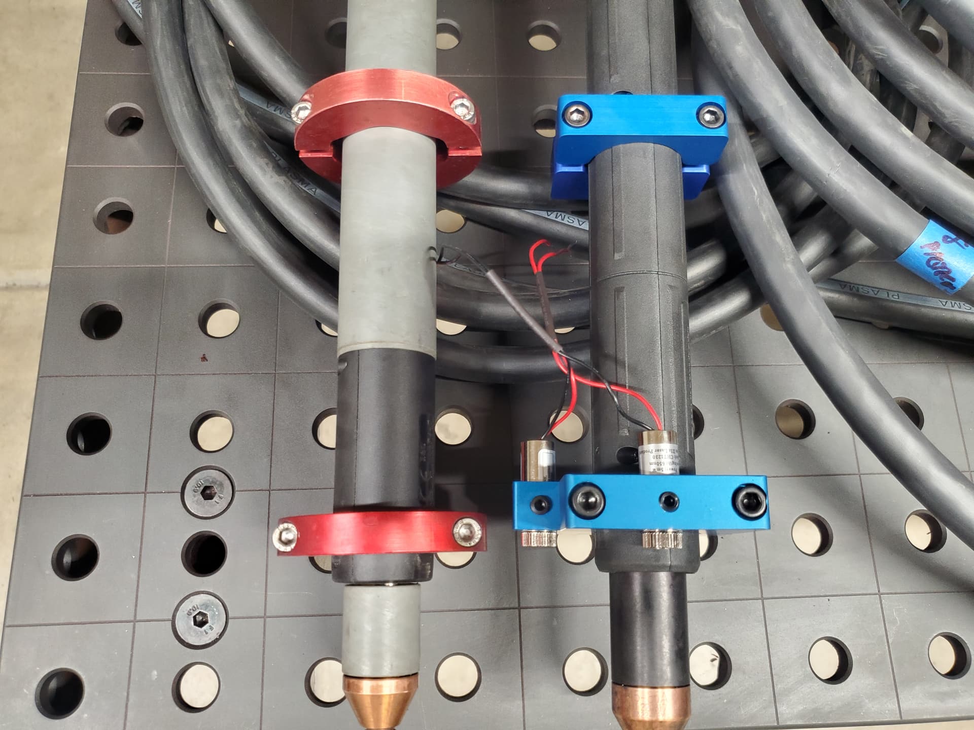

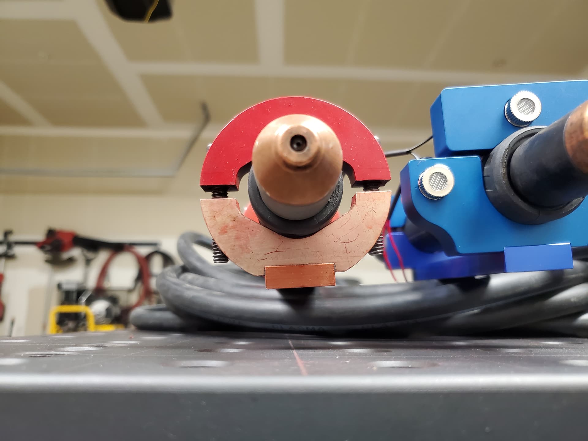

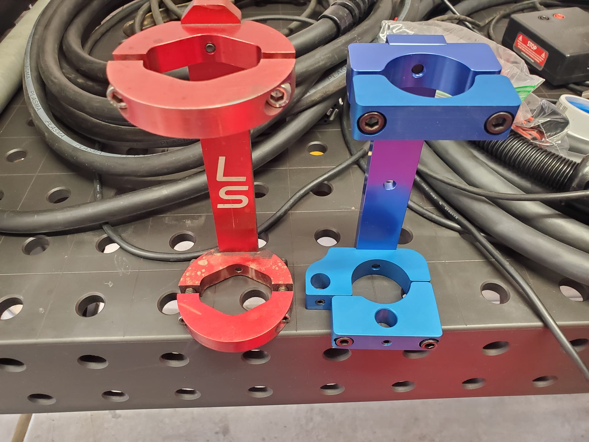

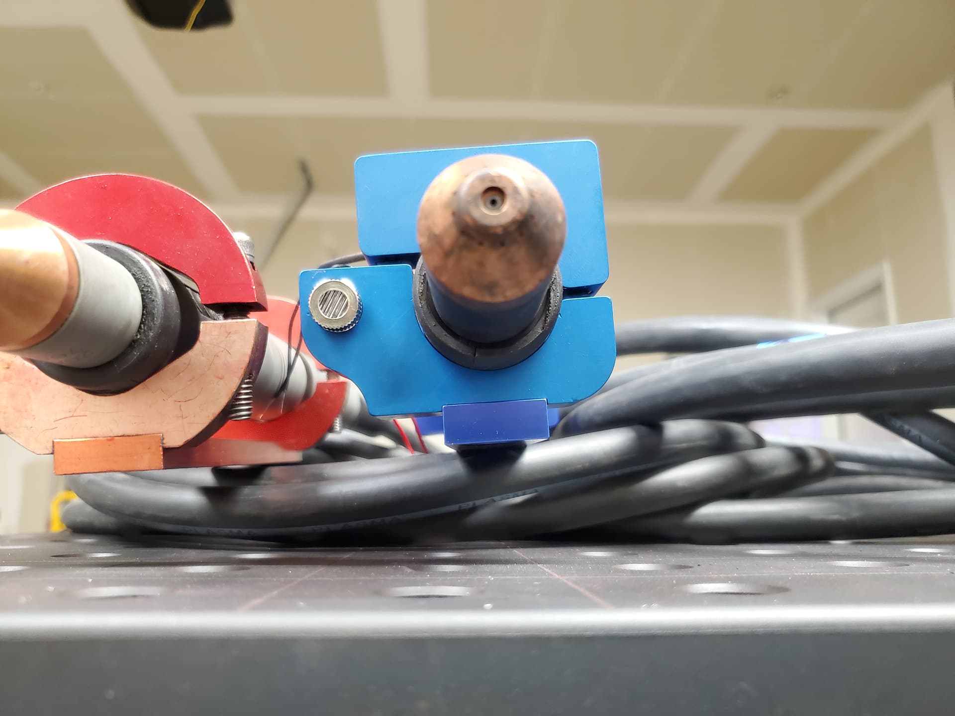

Beck’s torch mount was the clear winner for me.
It fits snugly around the entire torch body versus applying “pressure” in specific areas while clamped. And because of this, Beck’s torch requires significantly less “torque” to clamp down the torch itself.
