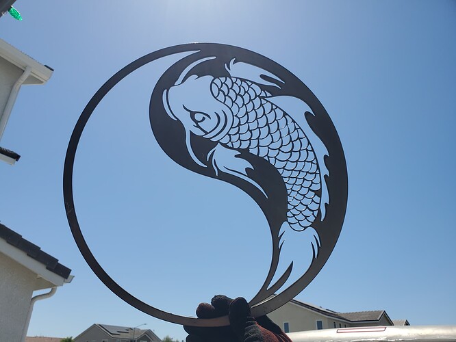

I’m not familiar with the Razorweld machine but I still manage some “detail” with my large 65 amp nozzles
I’m a parts guy, I don’t care for signs cause I don’t like them and I’m not good at them but details are easy to do
