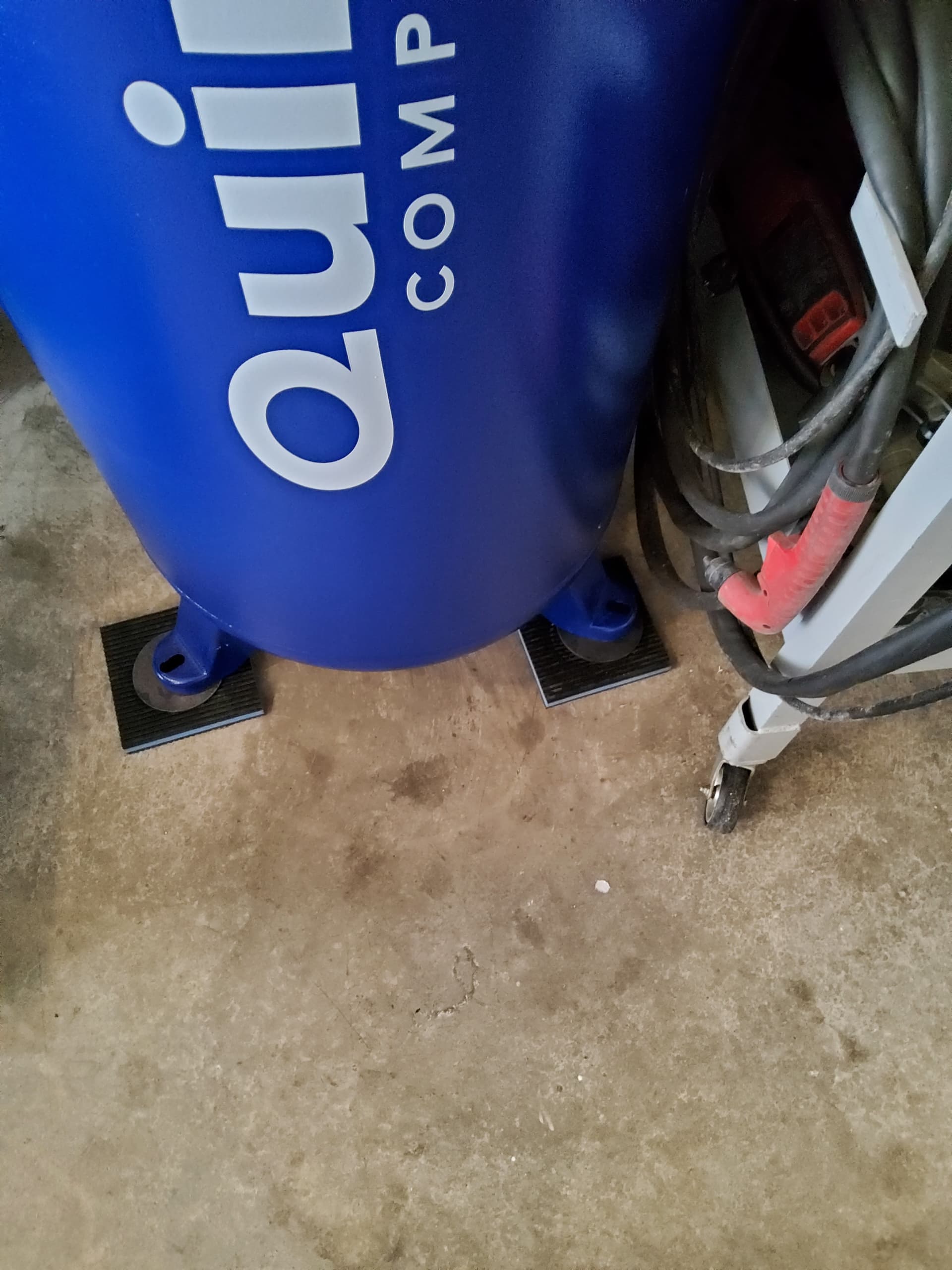

@Phillipw Thanks for the tips! Ironically my compressor feet shims are little 4" circles with a 3/4 hole in the middle. I have some scrap 12ga that I plan on trying to burn them out of. But yeah, aside from that I planned on little squares, stars and circles just to test out the table and see what adjustments I might need to make from the results. I was thinking that it might be a good idea to have test cut file handy to do these cuts on any new metals just prior to any project that I might be working on in an effort to get the money cuts right prior to cutting into the production material. :+1:

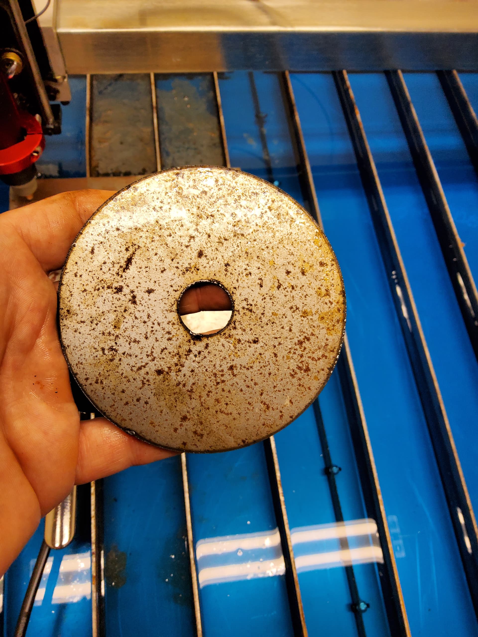

Welp, here we go! The rubber just met the road and I’m STOKED!!

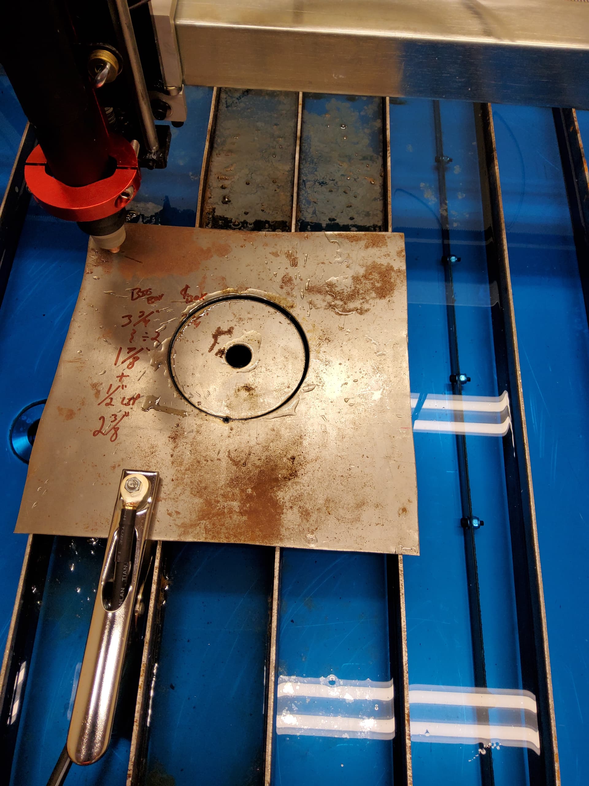

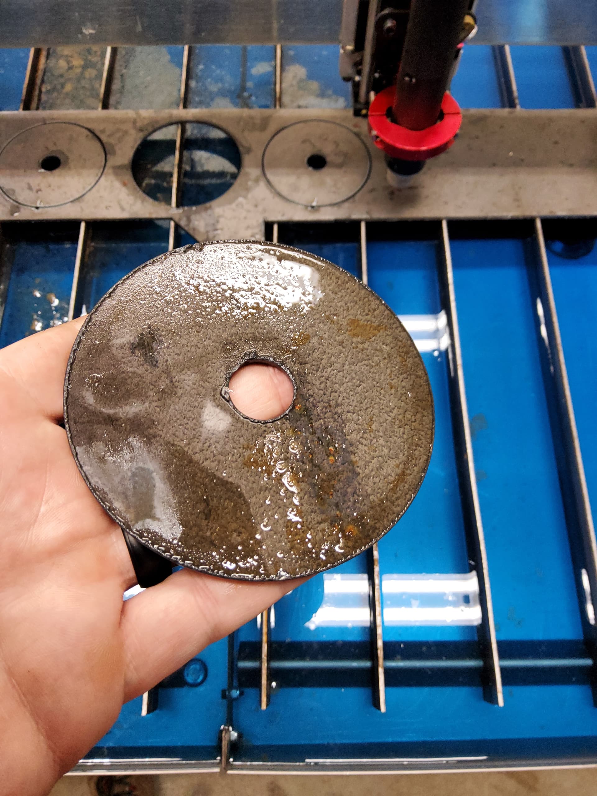

I had a piece of 16/18ga laying around, yeah lets do that first! The cut speed I presume was a little slow, as I had it set for 11Ga at 40A, 86ipm.
Not bad for a test piece I suppose. On to the actual cuts.
12ga Mild Steel. The machine only came with 1.1 tips, so doing the best I can with what I have for now. I swore that I wouldn’t invest another dollar until it is up and running about $1k ago. I’ll be hitting up @mechanic416 ebay store front here soon.

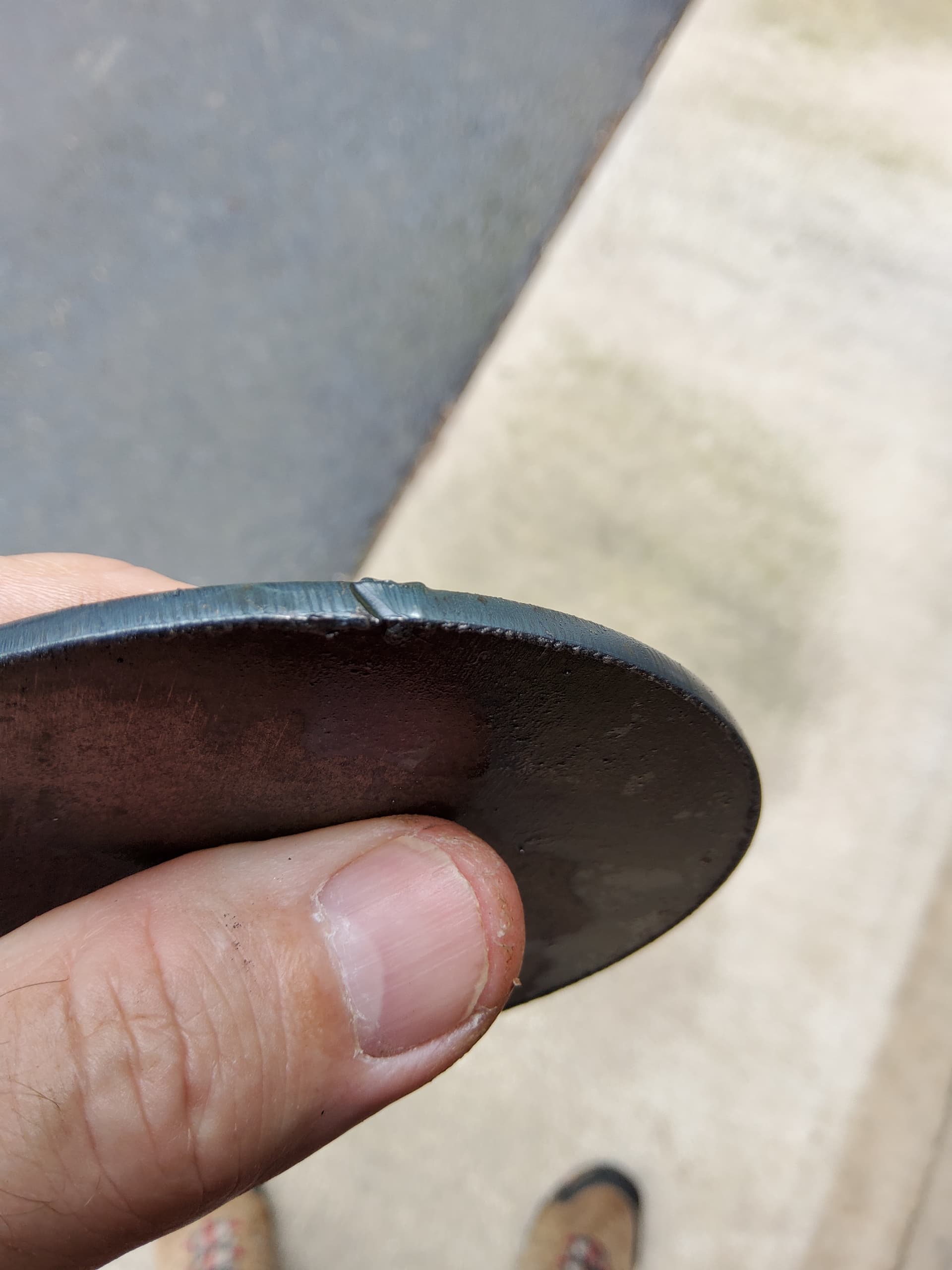

Lead in… Need to soften perhaps?

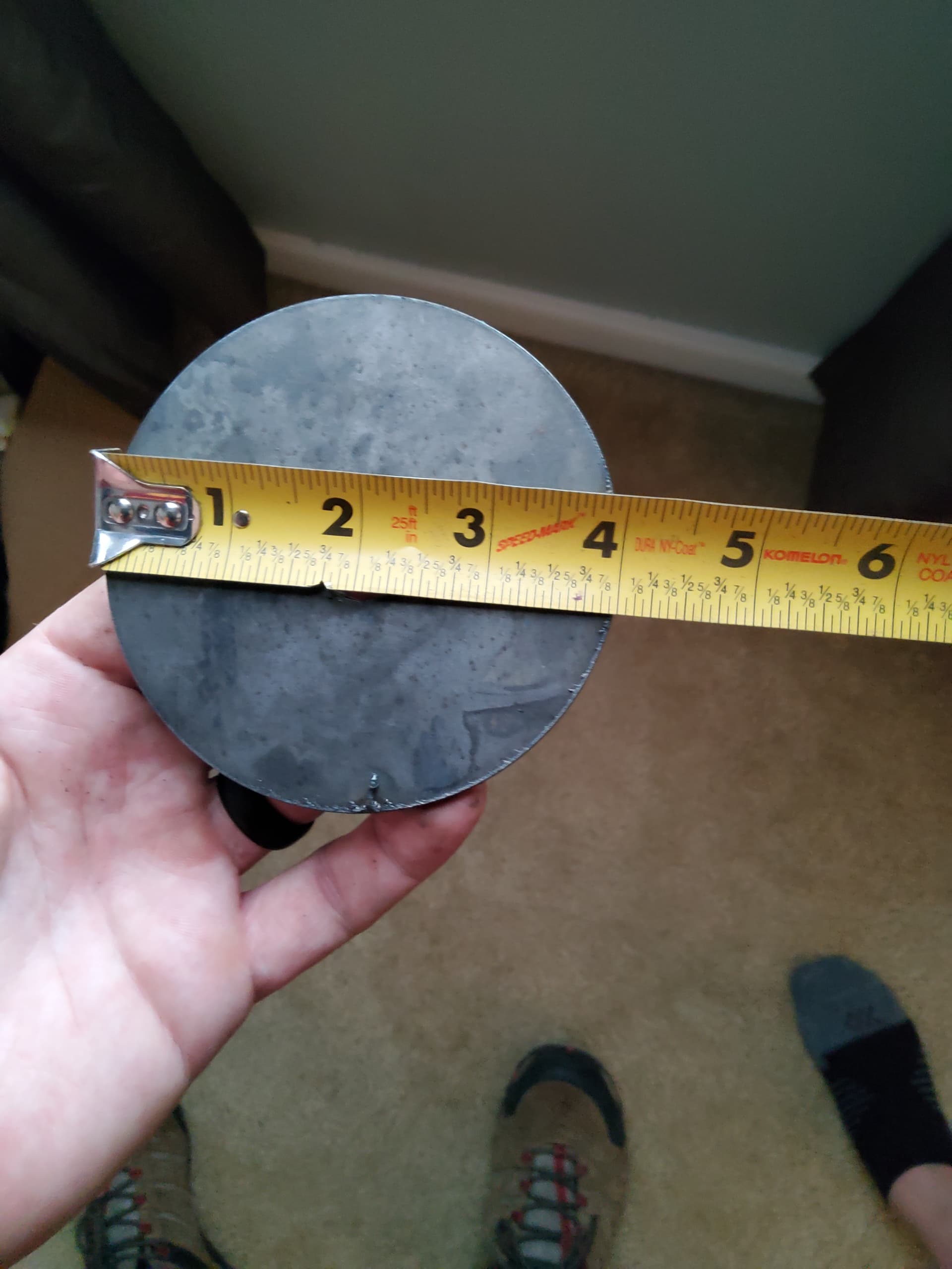

Cam angle is a little off, as I had to go awaken sleeping beauty to act as my third hand, and had to make it quick at that; short and curly is that she’s dead balls on at 4". Happy Dance! :tada:
Popped the shims under my compressor feet and my guestimate served to be close enough. No more gangsta lean anyway. Just need to borrow a hammer drill to to drop some anchors in there and call it done. :+1:

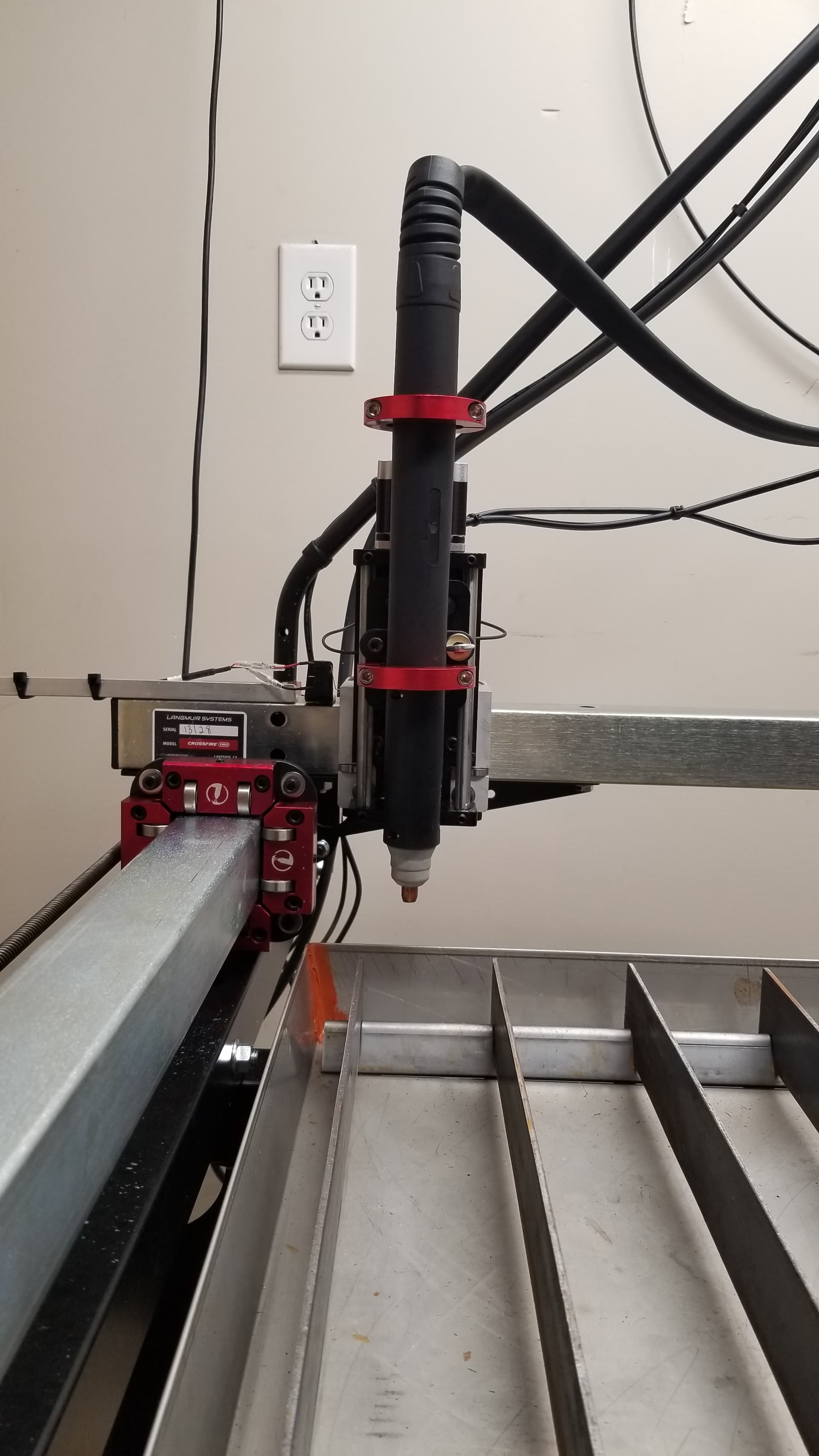

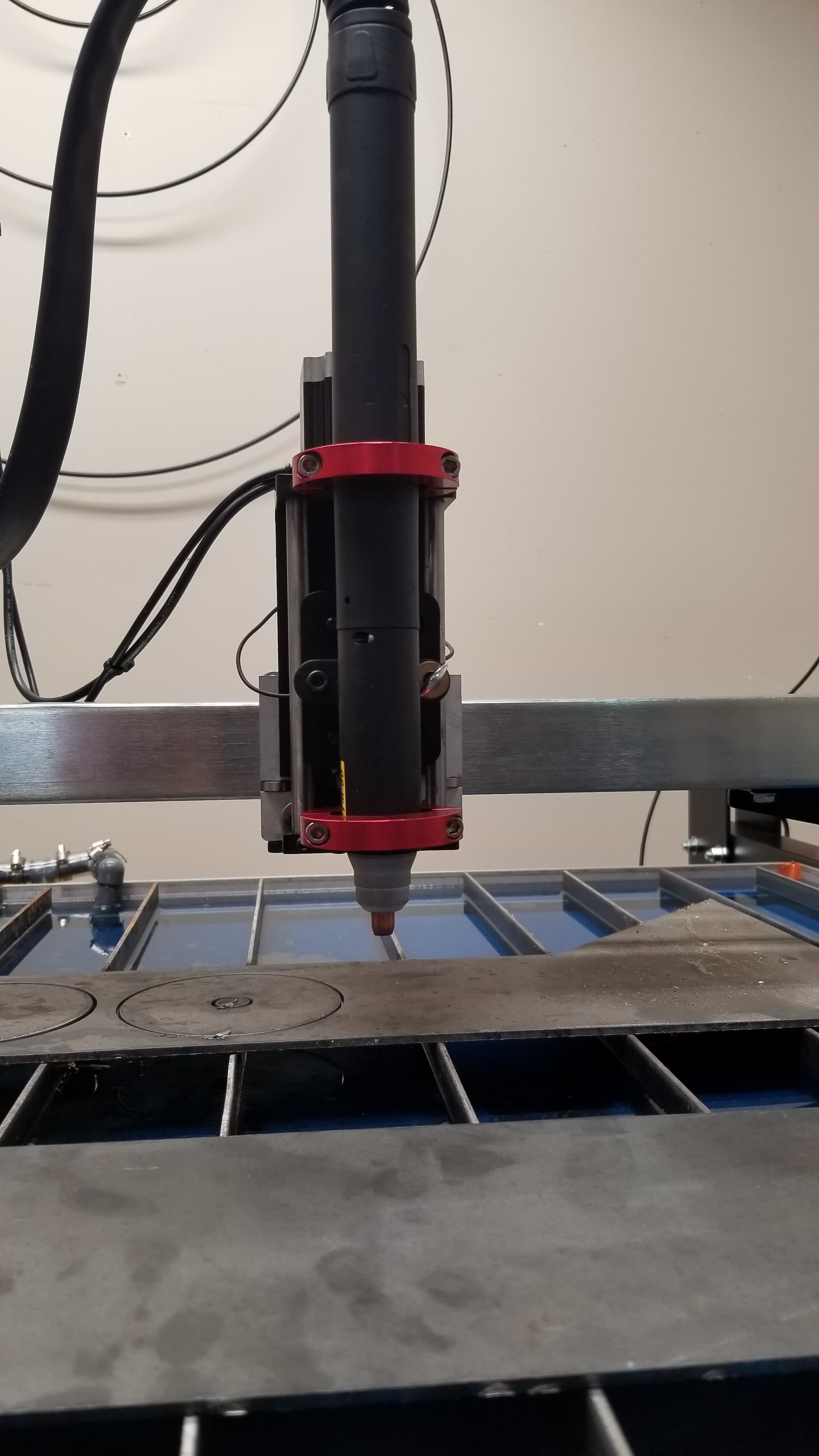

Well I am glad your up and running. Just to let you know you have your torch mounted wrong, the lower clamp should be on the barrel not the torch head.
@mechanic416 Oh, thank you for that. Like this?
Yes that’s wrong.
Uaieee… I see. Thank you. Will adjust accordingly. :hugs:
You had to post the RTFM bit didn’t you? :joy: I’ll have to go back and see if Everlast ever defined this, but none the less, THANK YOU! :open_hands:

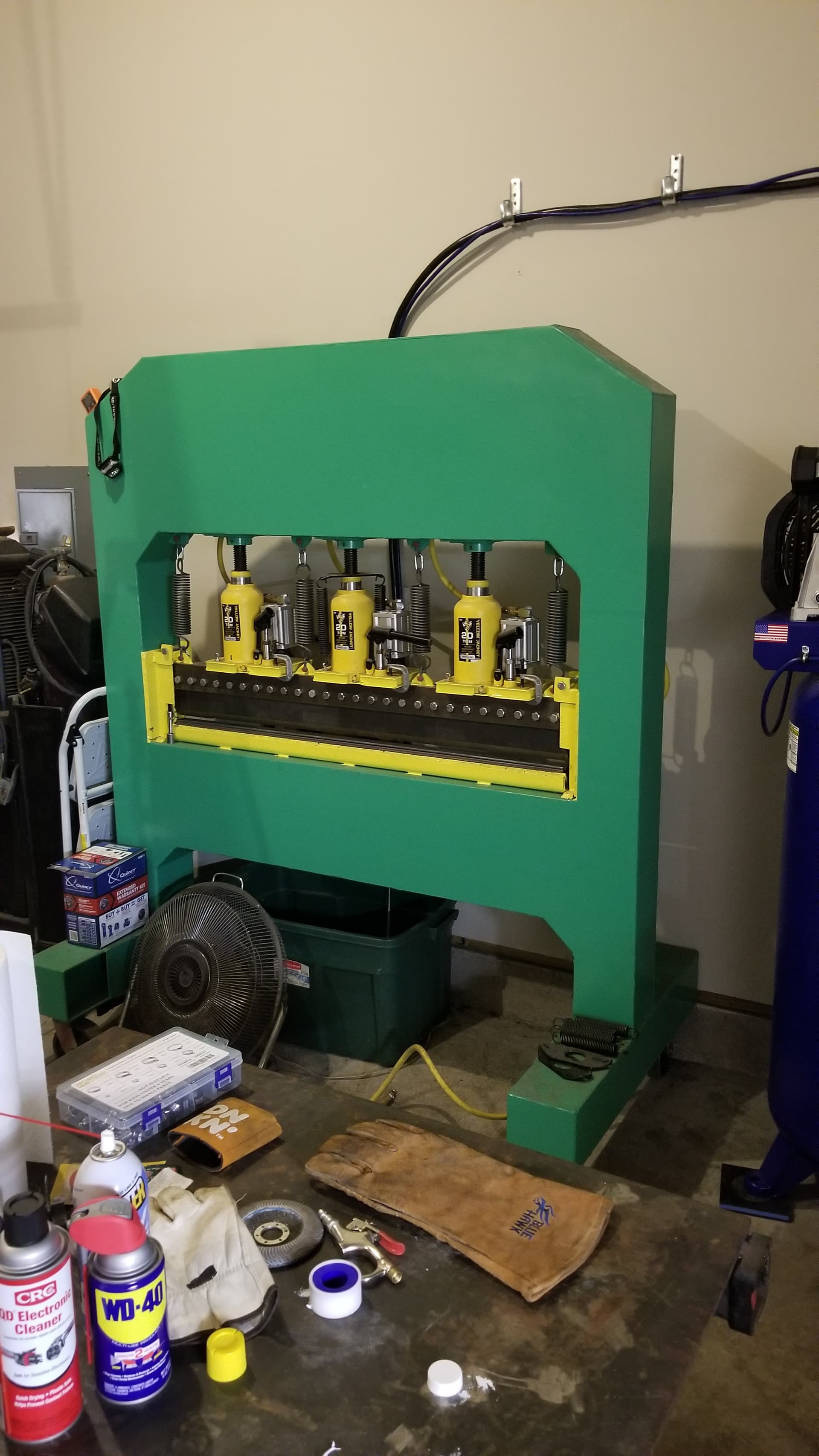

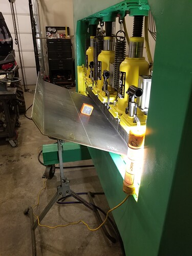

lets see some pictures of that press brake
I noticed that brake as well. @Domo has some serious equipment!
Torch mounted properly now. Thanks again @mechanic416
The brake is just a SWAG Offroad 48". I built a frame around with wide flange beams and plated it up. Three beams tall above, double beamed below (people have issues with these things bowing the frames I guess). :joy: Certainly a bit of an art to use. It has three 20T pneumatic jacks tied to a foot pedal. Valves before each jack to adjust/compensate for variance. Kinda slow, sometimes have to finish with a manual stroke on one jack or another, but with patience it can get a few things done. I have yet to get the special dies, as I have only done a few projects with it. I think that may change now that I have a plasma table to push jobs to it.

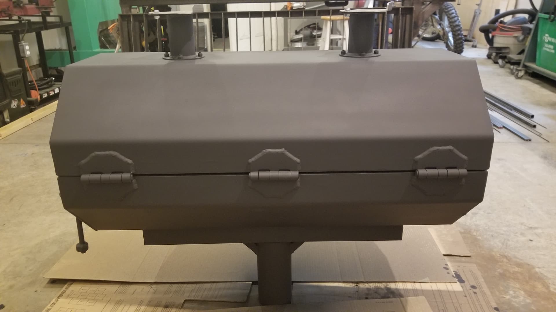

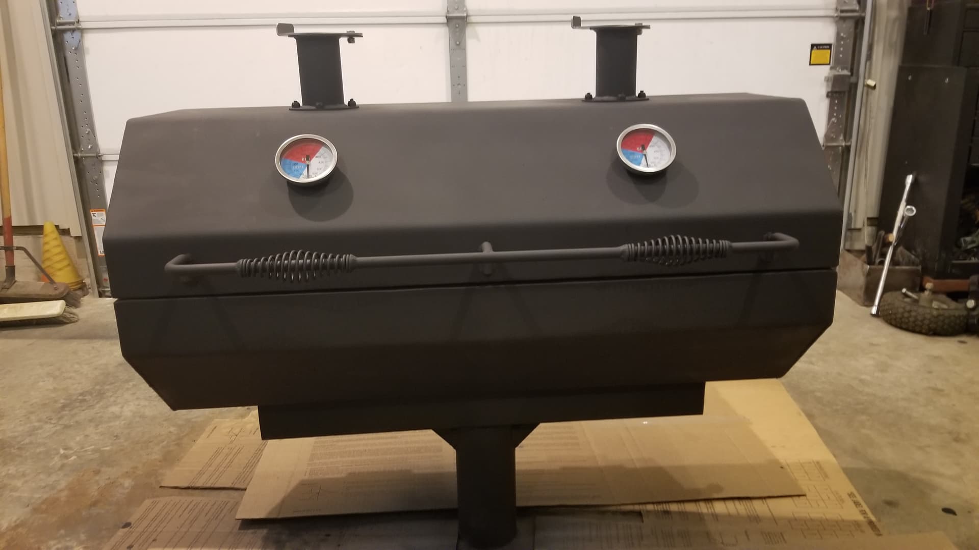

Here are a few pics of the brake and of a big boy grill that I made for somebody a couple years back.
I can’t find pics of the grates off hand, but their made of 1/2" round stock like a park model.
