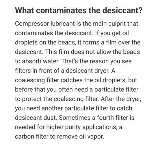

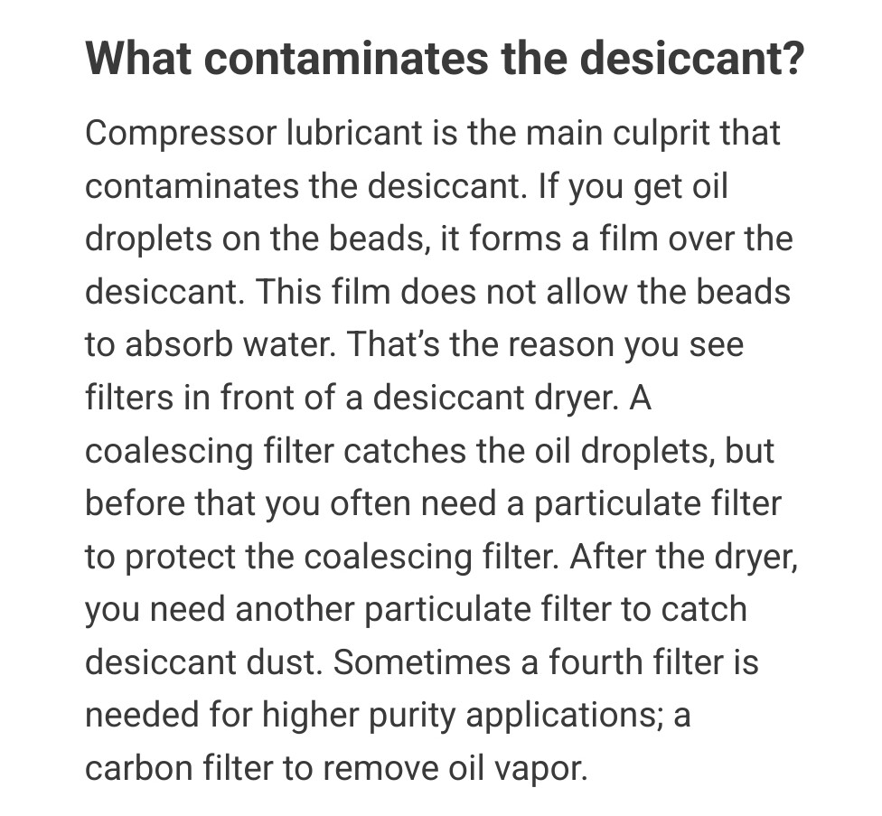

You should have a coalescing filter somewhere prior to the desiccant filter.
I have a coalescing filter in front of my desiccant filter. I see they say you need a filter after the desiccant but they don’t show it in that picture you had.
A lot of these filters they are talking about are for oil, your compressor age and quality have a lot to do with this. If your dealing with a cheap box store compressor or a very old neglected one or both you will have way more oil in lines then if you have a good quality pump.
They sure listed a lot of filters, probably erroring on the side of caution!
This post is not intended to sway anybody that trap before desiccant is best approach. Just info on how the filter suppliers set these combo pairs up.
