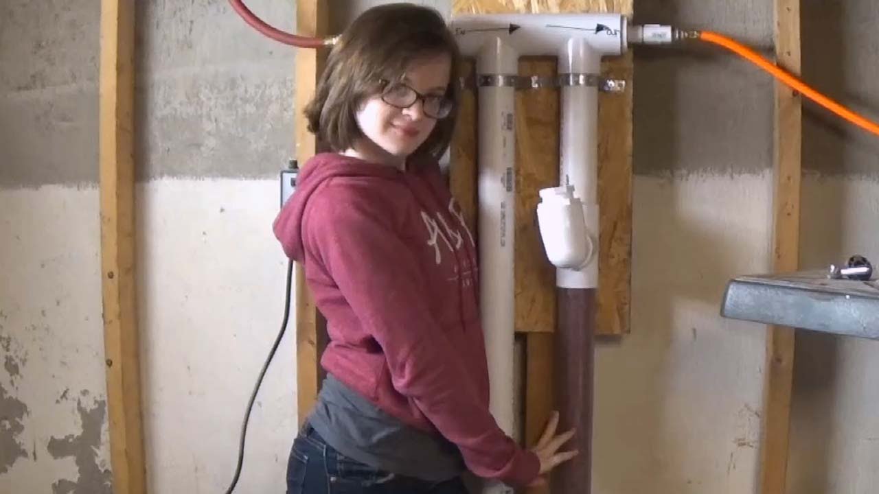

  1. any decent dessicant filter build tutorials put there that shine compared to the others? I found this one made from PVC that this 15yr old girl ironicalky built and it looks like a really decent setup tbh, and CHEAP. The others that I have found have been re-purposing Pentek style water filters… Not totally keen on this one, but curious if there is an end-all-be-all homebrew dessicant setup out there that I have yet to stumble across?

That’s my concern about the dessicant. These plastic parts/components are rated for water psi, not air psi. I would have a regulator setting pressure prior to entering though.
As silly as it might seem, this 15yr old (and I presume her dad) have a neat dessicant setup (assuming safe).
My biggest hangup with the OTC systems is cost for such small filters, which is why I’m considering a go at it.

Don’t do it unless you’re going to encase it or bury it. PVC is probably one of the worst materials you could use for compressed air.
Polyvinyl chloride (PVC) pipe must not be used in compressed air systems unless it is buried or encased.
As long as that enclosure isn’t sealed because it’s going to need to bring in a ton of air to compress and and be able to get rid of heat that is going to build up from compressing air.
Thanks for that @TinWhisperer. Back to the drawing board on that idea then… still very much brain storming as it will follow my condenser build, which I’m still brainstorming on as well. :joy: I may just have to buy the dessicant filter.

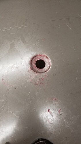

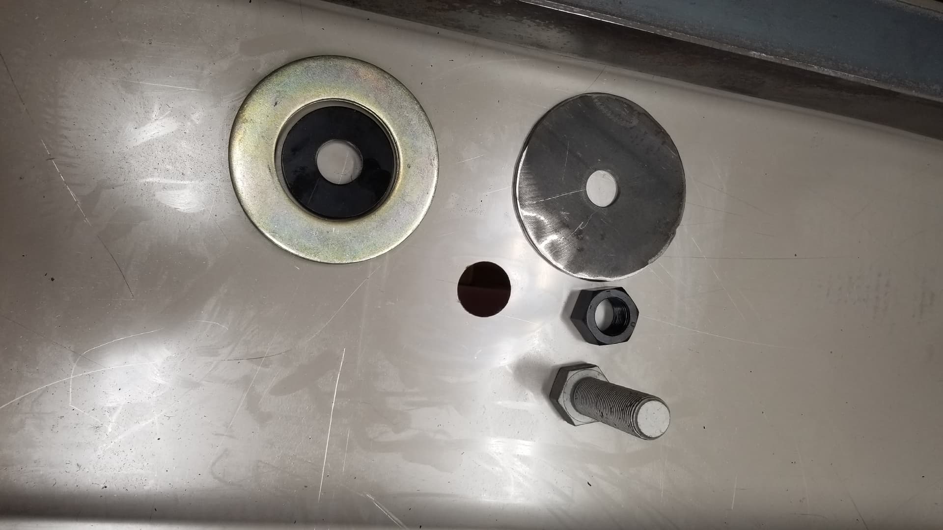

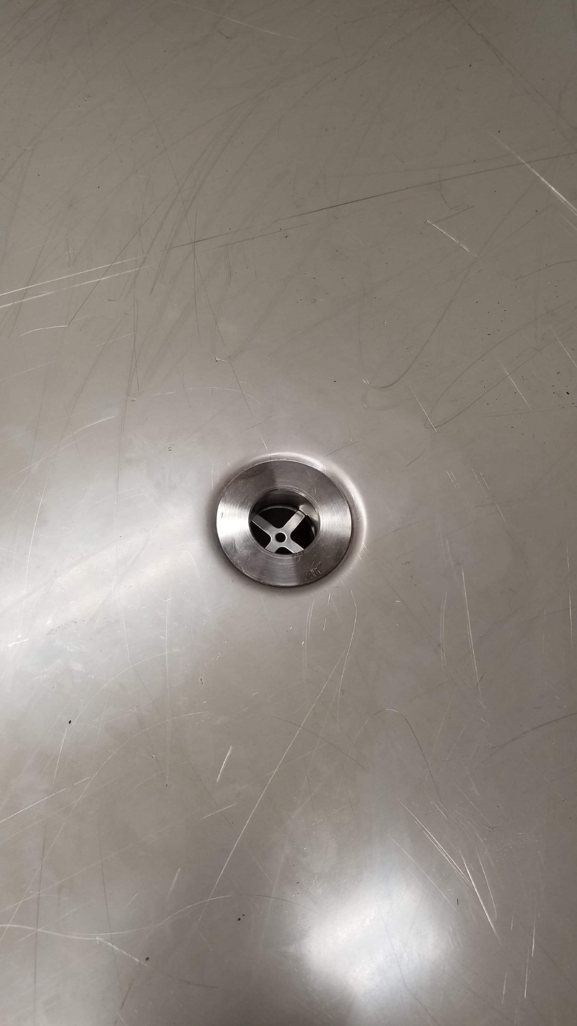

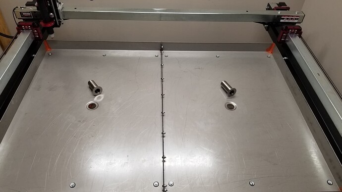

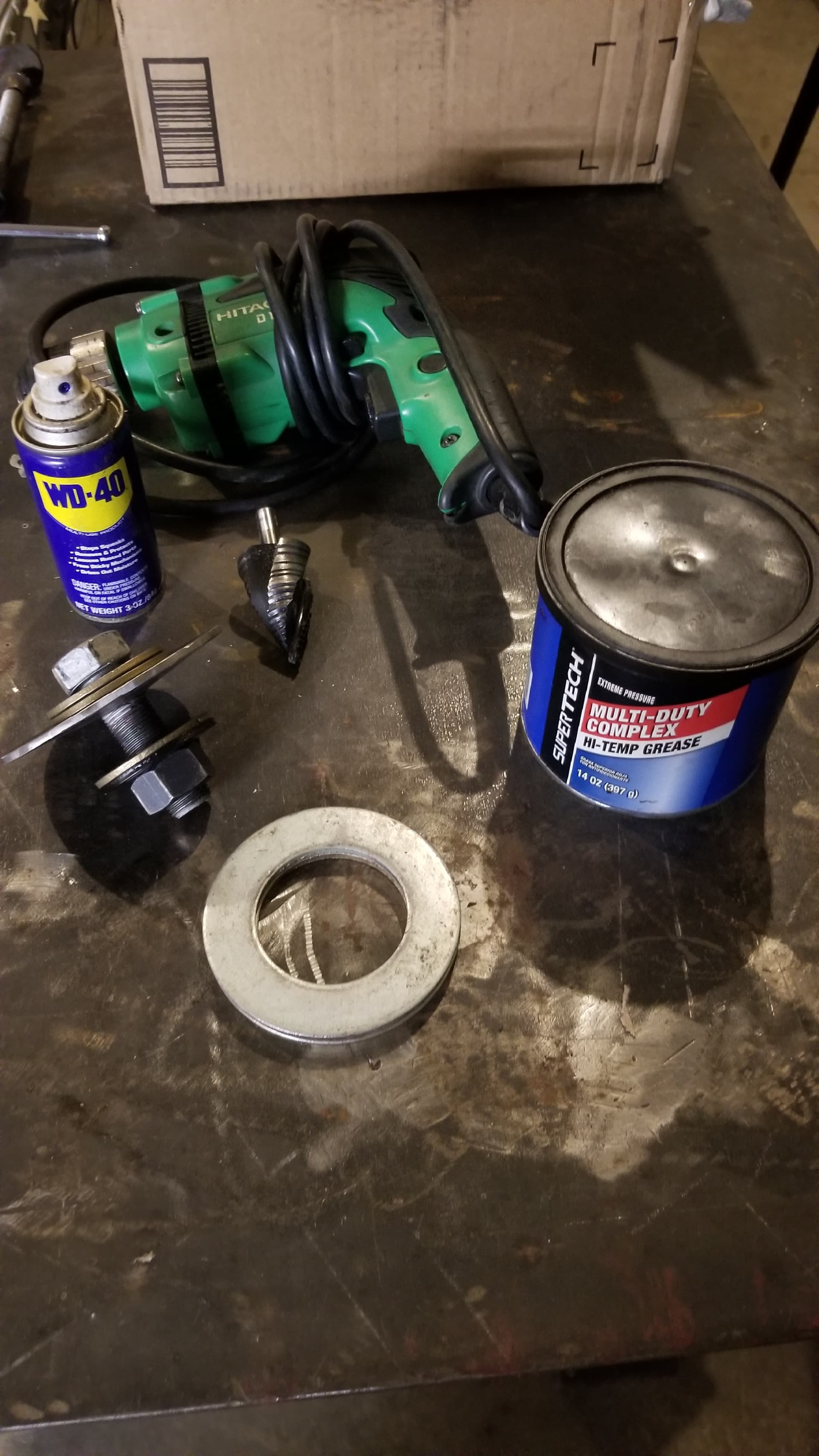

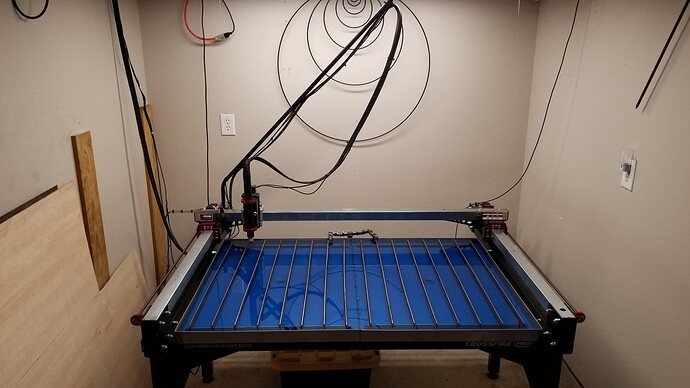

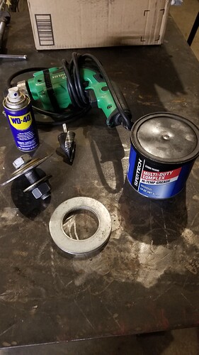

Slow going getting this thing together due to lack of time/opportunity, but pushing forward none the less. I have been reading threads as I go and really liking those recessed drains, so I decided to have a take. I wish that I had a lathe or patience to request and await the travelling die set, but I don’t, so I did some of my stone age engineering. Worked pretty good IMO, but could use a washer the size of the hole in there to make it dummy proof. Good thing I wasn’t already too deep in brew consumption when I did this… :joy:

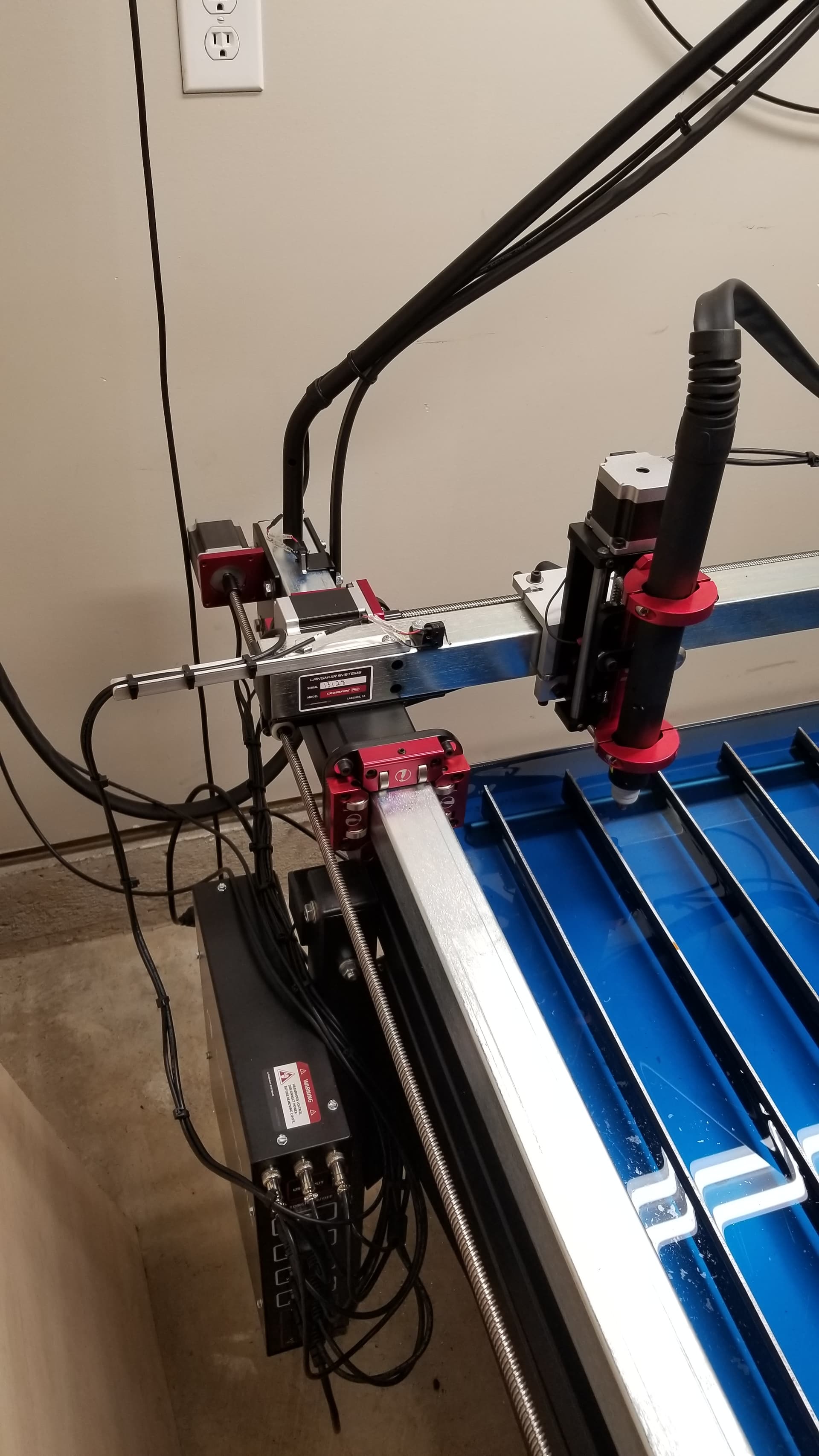

Admittedly, I burnt one plasma CNC connector up trying to solder in my four control wires. Got pins 4/6 in like a charm, but the torch fire pins (1/2) should have been soldered first IMO, thus I lost feel/viz and burned plastic, despite looking at it through magnification AND with reading glasses on (getting old sucks) :joy:… Got two more adaptors in the mail yesterday. Fingers crossed that I’ll be returning one by weekends closure! :joy:
Still slow going here between waiting on parts and analysis paralysis, but we making headway nonetheless.
  • I added a little wire guide for the to the gantry, so that the limit and motor wires clear the control box to/fro.
  • I have a pond pump in the bottom of a 27-gal tote/reservoir with the drains plumbed back into rez. Sterlingcool treated water.
  • 50’ish foot of copper with a air/water separator in between, three auto drain’s along the way, leading into a Motorguard desiccant system.
Hopefully this will provide the desired outcome, re dried air. Other than that, chomping at the bit… ready to Git It!!
Hey, great to get it right the first time and looks like your almost there! Once you start cutting you won’t want to quit and make changes.
That looks like kind of a small three sided space there. Have you thought about air mgmt? These systems do kick up quite a bit of dust even with the water tables. Sorry if you already addressed this as I didn’t read the entire thread.
Hi there @Wsidr1, It is a small space indeed. I plan to make a hood to mount into the loft above and tie it to a high CFM extraction fan to suck the bad air outside if that’s what you’re referencing. Otherwise I’m keeping corrigated metal, maybe even an easily cleanable fiber composite in mind as well in case I need to skin the surrounding walls for excess grudge/water it might throw. Short and curly, it came down to the size of my small shop (18x32 with a closet carved out in the back next to the table) and all the other crap that I have crammed in there. At this point, with the costs that I didn’t consider when I purchased the table, I’m trying to play catch-up before trying to take anything else on tbh. That, and not knowing what to expect, I figure that I would fly by the seat of my pants and fill in gaps on the fly… :crossed_fingers::joy: My biggest consideration on the table placement was to keep it out of the way to prevent damage, maintain access to all sides for maintenance, and good ingress for at least a half sheet of steel (this may change/rearrange to full sheet if the need arises and I can be creative enough to swing it). I’m SURE that there will be some other things that I have not yet considered or realized tho. :joy:
