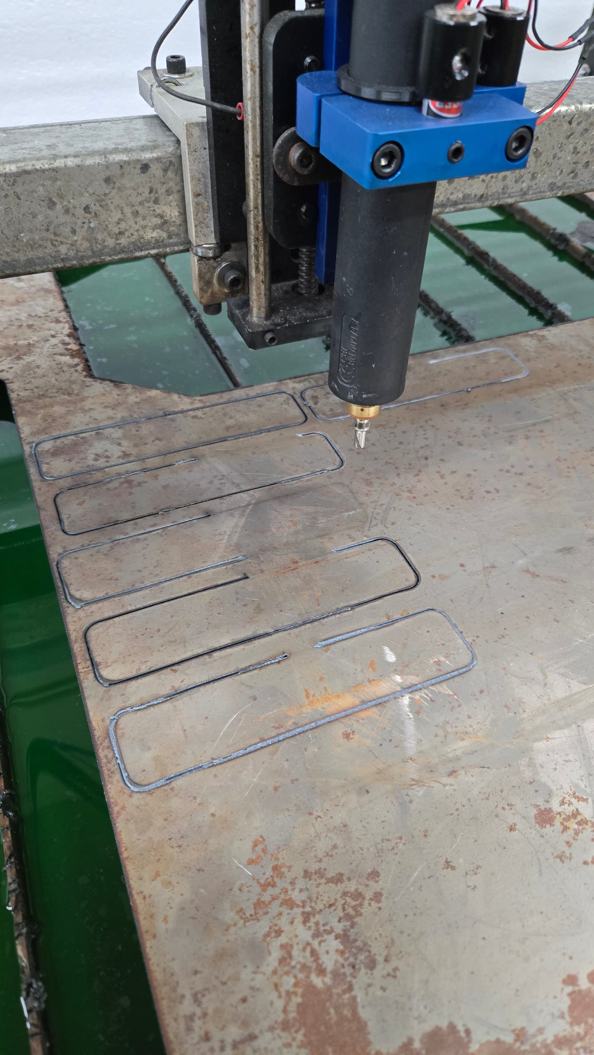

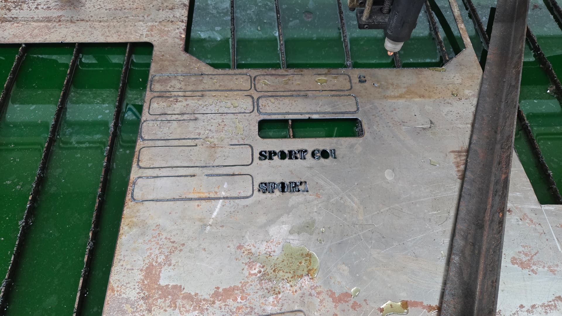

Got an order to cut some finer detail emblems out of 24ga (0.025") thick cold rolled. Ordered new 20a consumables from our local pusher man, but the pierce isn’t kicking off at the start, it delays until like 1/4 (and inconsistently) through the gcode.
Work clamp on my mag holder (behind the gantry in the first picture, but directly on the work), 20a, 60psi, 220ipm (slowed it down to 160 ipm even), .125 pierce height, .5s pierce delay (tried to drop it to -20% to no avail thru firecontrol). I tried to drop the PSI down but the solenoid didn’t seem to like anything below 50 on the everlast by test firing the air through the front panel button. Also, it doesn’t seem to be cutting fully through the material when the arc does kick off.

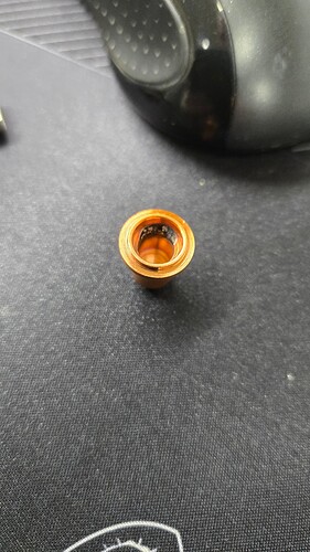

I believe that the swirl around the electrode is water. As you can see in your photo, it is also affecting the tip. The picture of the electrode is slightly out of focus, so I may be full of crap.
No, I am def still getting apparent water contamination at the consumables, but I cannot figure out where it’s coming from. Aside from ripping apart my air system and massively upgrading my desiccant dryer to some 2 qt thing, I don’t think I can go any farther without nearly another $1k in air dehydrating
I get tracks like that on humid days. The high-pressure air expanding out of the tip at a much lower pressure causes fractional distillation. The air around the torch has a high dew point in the summer months.

Pilot arc doesn’t fire. The torch isn’t plasma-ing until it starts on the main cut path. I have to assume either I have too many filters/pressure drop in my air setup, and/or there’s something in the solenoid that’s causing the electrode to not spring back away from the nozzle prior to the cut. It also doesn’t sound loud enough to be getting full flow / pressure.

Got everything back together and hooked up the hand torch, needed to do a cutoff anyways. Fired without hesitation, and PSIs never dropped below 65.
Call Everlast for a new solenoid. They know they have issues. It shouldn’t drop more than 2 or 3 psi.
They had me do a voltage check on the board for the air solenoid. After butt-puckering a diamond with the cover off and 240 mains plugged in, confirmed the board is sending 24.35v DC. They’re sending me a new solenoid.
