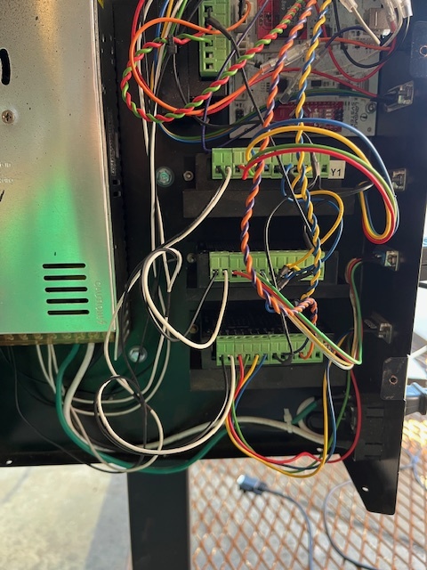

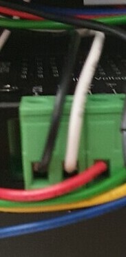

The ground wire on the upper Y driver is on the positive pin.

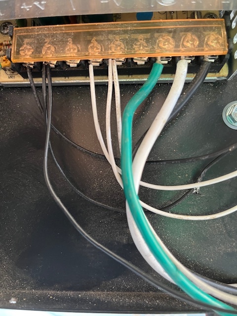

Follow the black and white back to the power supply. Make sure which one is neg and which is positive.

ok todays up date the wite lead in one picture above was in the correct spot , all the dip switches are correct . Changing the y1 motor and the x motor did not change anything. I took the x access rail off made sure all was square . Now I tried to run just Y and all moves good , the problem comes back when I put the X rail back on
I have been posting on the facbook site as that is where I could get the video of what I’m dealing with . Most all the answers I’m getting is square and level , I have measured from corner to corner and within 1/16 , have not checked anthing level it is on a cart with stock feet
after having a dream last night about why the x access moves and gets off parallel to the y. This is a project and was missing some parts , I was out of the tube spacers after the frame assembley so I did not have 4 left to do for X . Maybe that is keeping it from getting tight and allowing it to move ,

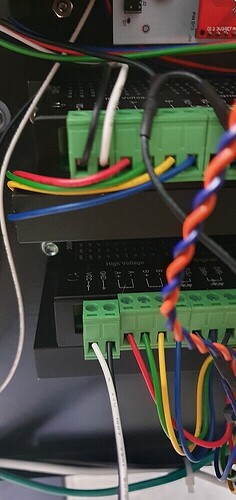

That driver is wired incorrectly. Confirm that the white wire from the VCC terminal of that driver goes to the positive of the power supply, and the GRD terminal ( black wire) of the driver goes to the negative of the power supply.
The picture you took and posted of the 3rd driver from the bottom is wired wrong.

This is the picture you sent me a couple of days ago. They were wrong in it. Something has changed from today’s picture. It is possible that being wired backwards has ruined the driver.
I don’t believe it’s a mechanical issue. It’s an electrical one.
I did not change those power wires , from the start I only changed the 4 color wires to make both Y1 and Y2 look the same. If you think it could be a driver issue it came with 2 spare drivers y1 and y2 marked
