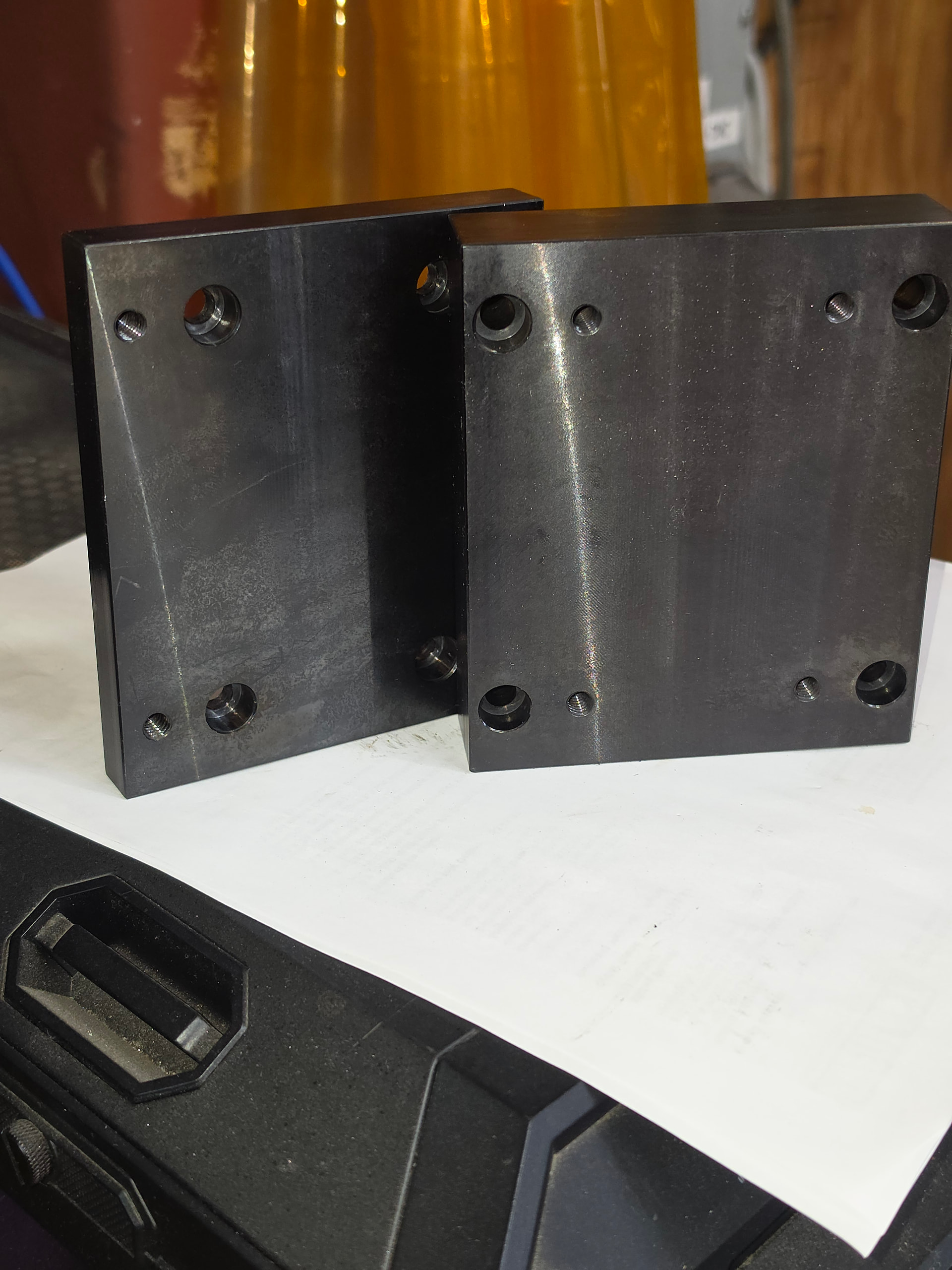

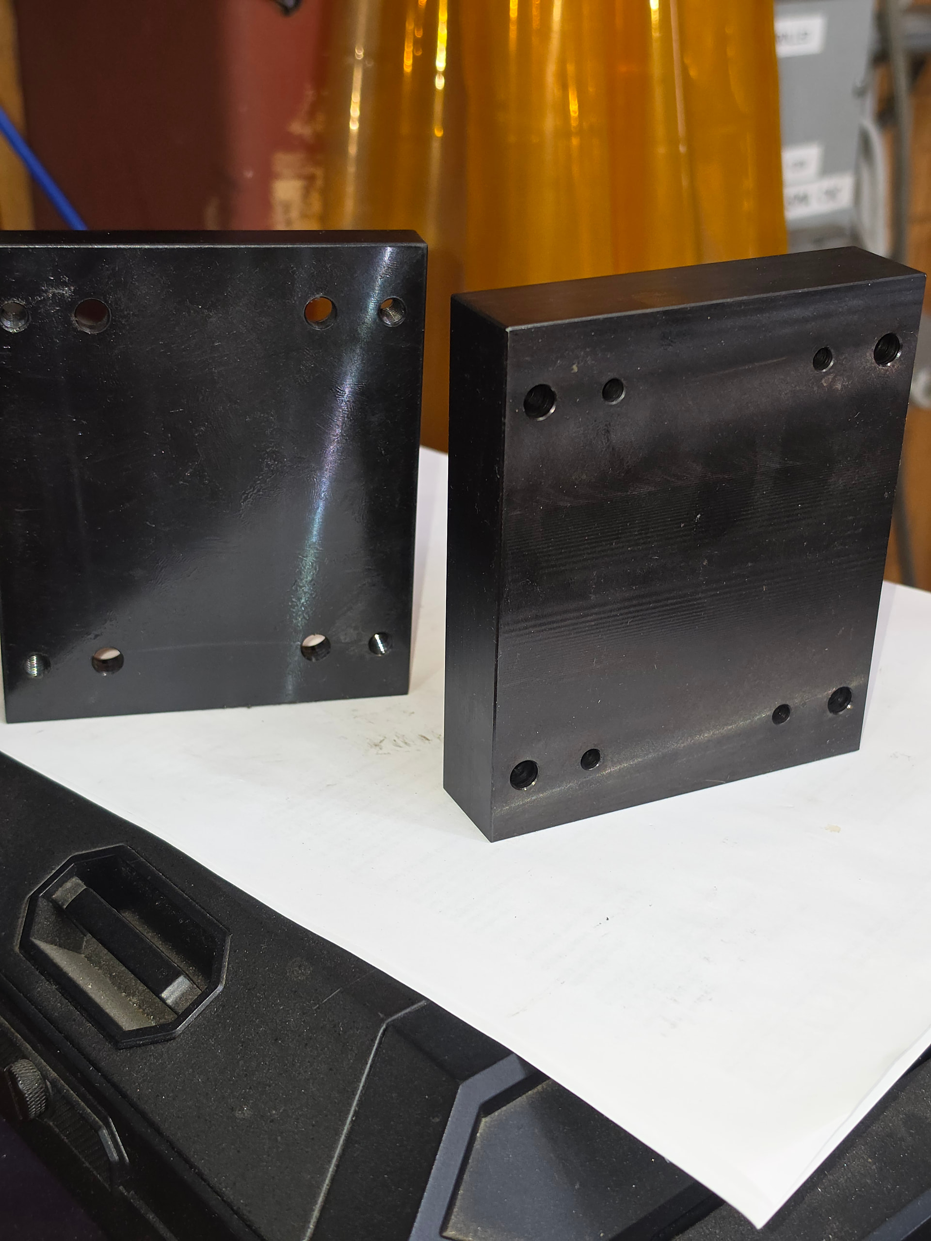

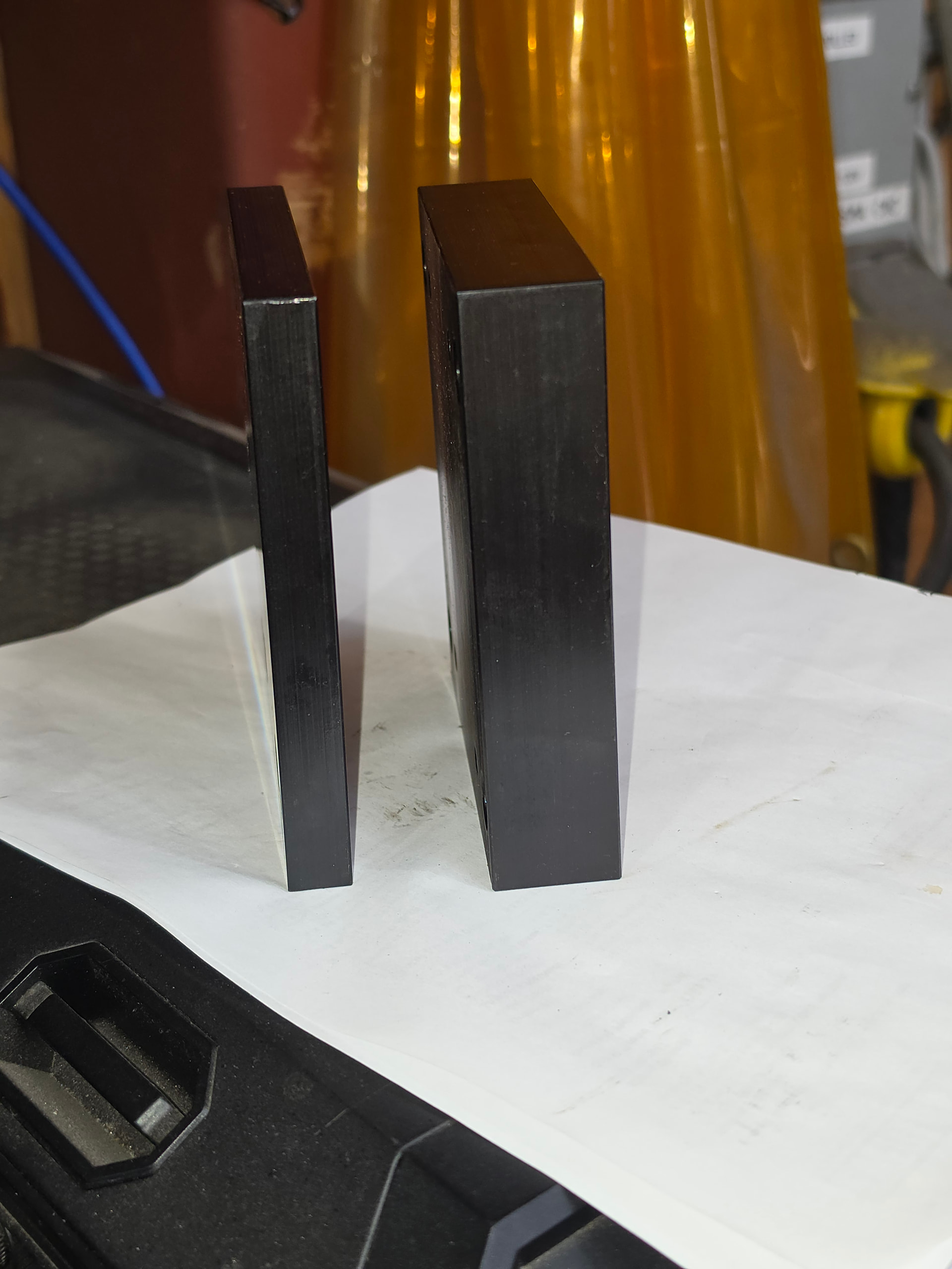

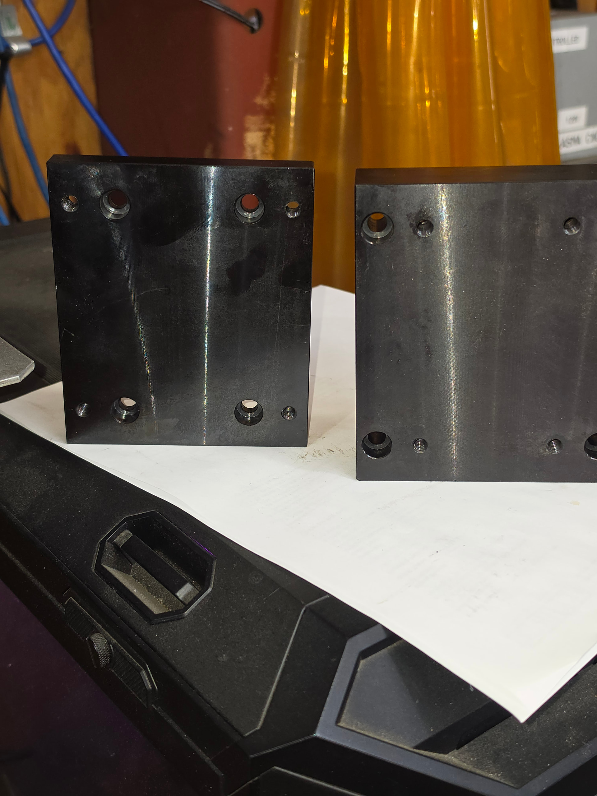

Great addition, I made some a few months ago and would have happily bought them. Are you sure that is 2.5” of increase though? With the included hardware it seems like it might be 1.5” (and visually it looks more like 1.5”). The flange on the Y carriage is 3/8” tall for reference, and the linear rail is a little under 3/4” tall. This is from your product page:
When I put the risers on my machine I raised the gantry up onto wooden blocks. This allowed me to raise the gantry with only half the weight at a time. I also removed the spindle, saving a lot of weight.

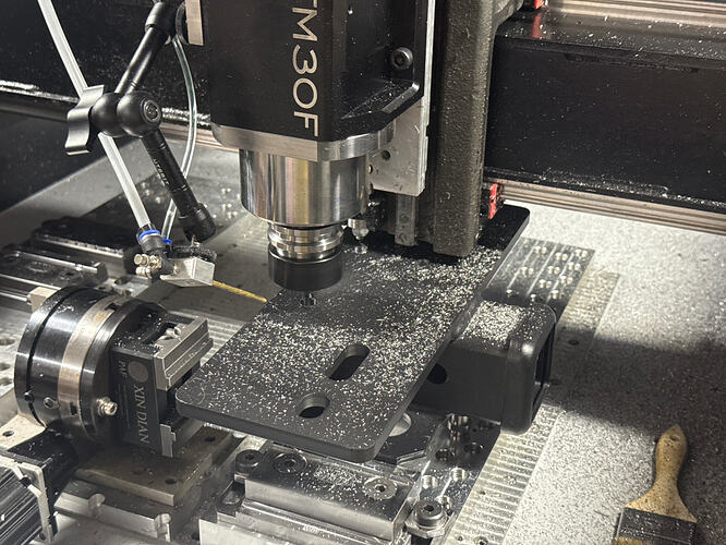

This setup is what finally prompted me to make and install it. I was modifying a trailer hitch and clearance from the top of the hitch to the bottom of the Z rails was really tight. My machine is modified but has the stock gantry.
Hey Alex, What rotor and vise is that in your pic? Do you have a link as well? Thanks in advance.
That is a Sherline 4th axis and a XianDin H54 vise with a mounting plate that fits onto the rotary table.
My machine is pretty highly modified, the 4th axis won’t work unless you’ve replaced CutControl with a different control system. I have other threads on my machine here if you search around.

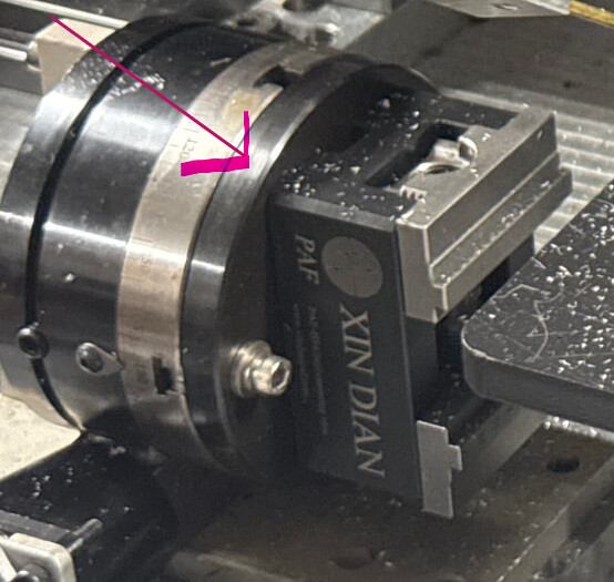

Alex after some thought I like your setup more and more…so one more question…
Where did you get this black plate here?
Let’s move the chatter about my machine to another thread, so that this one can focus on the block announcement.
