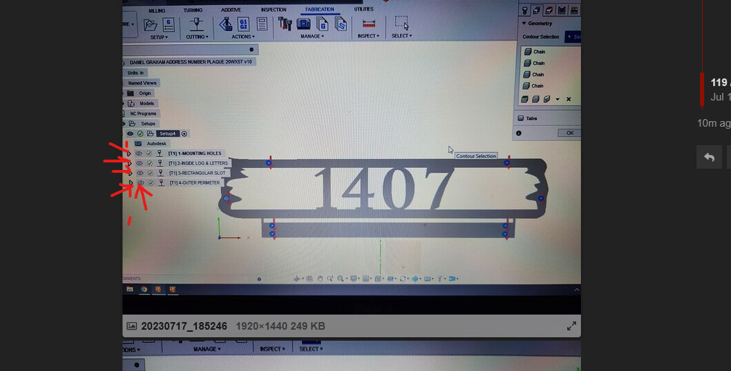

Here you go:
DANIEL GRAHAM ADDRESS NUMBER PLAQUE 20WX5T v12.f3d (583.8 KB)
Try clicking on the eyes and redo toolpath.
Its a very cool design…great work!
Well that didn’t work either…
It’s actually an add-on piece for another sign I already made. Guy decided he wanted the address below it.
Try this one. you’ll have to change your plasma cutter in setup and tool in 2D profile i believe
address 1407.f3d (313.9 KB)
I have to make dinner but i can walk through this in a video i show you a few issues i picked up on after.
Don I appreciate the effort and all but I really need to figure out what is causing this and get it fixed. I’ll check out the file Thank you. Something is causing this, everything I have ever cut in the last 5 years I put .250 inch holes or slots in with no problems at all up until the last week or two… Does ridiculous stuff like this on every design I work on since the last big update

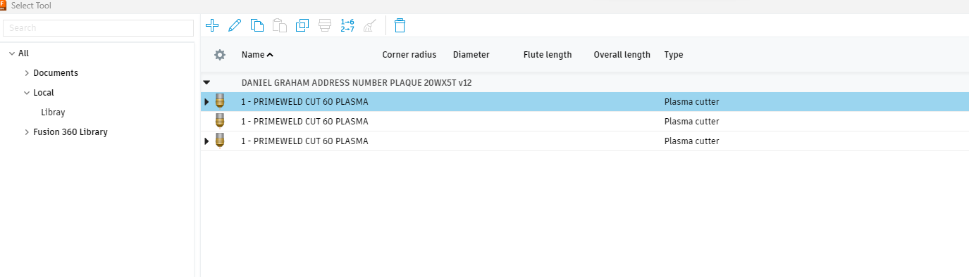

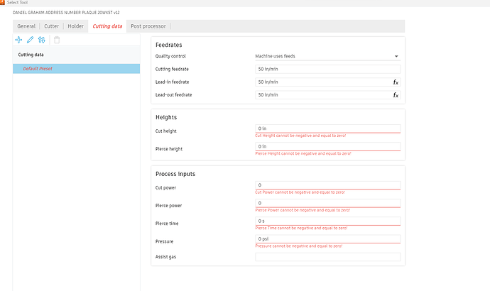

One thing i did see is you have 3 similar cutters but one of them is missing information. Not saying that is your issue but a could other things like your nozzle diameter and kerf width is so different. I’ll have to watch @TinWhisperer video in morning and see what he figures out on this one.
This is how i setup my library so I can just select the steel I plan on cutting and everything is correct for speed and kerf.

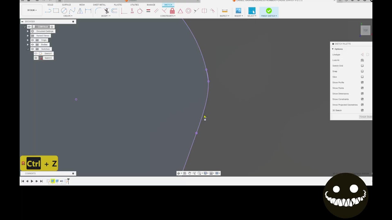

This video shows why so many users hate fusion. Who would think the position of the lead in would cause it not to cut. If your well versed with fusion maybe no big deal if your not this can drive you crazy.
The bad thing is there is no hint of why it wont cut. This video shows even you are perplexed by why it wont work the way you think it should, and you are probably one of the best users on here.
