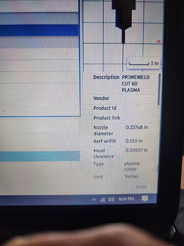

Your kerf size maybe to large for a clear tool path. It could be the Mach 3 processor that’s your problem. I’m truly sorry for all your problems.
Like I said it ran the entire sign for me. My kerf setting was . 057.

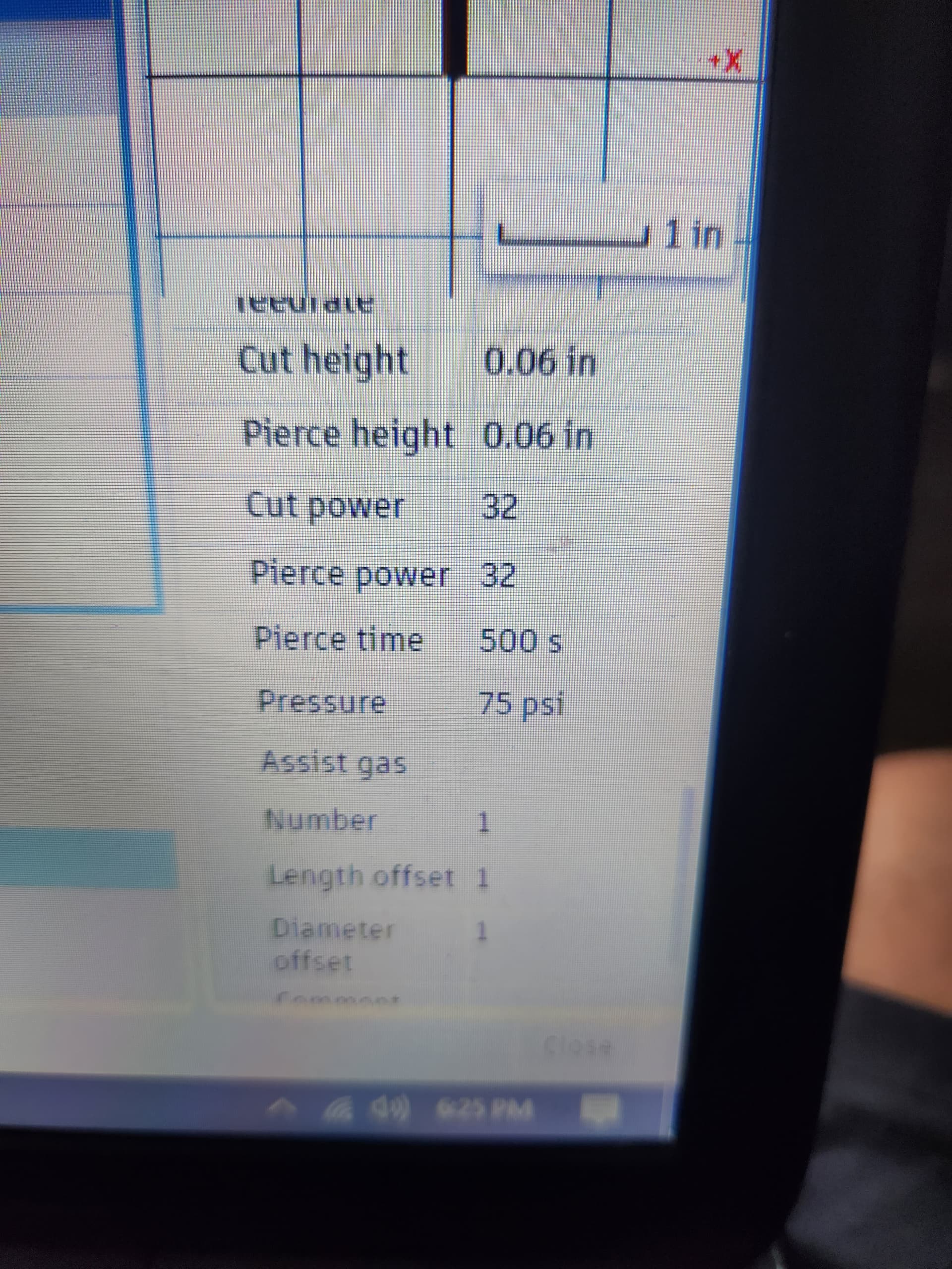

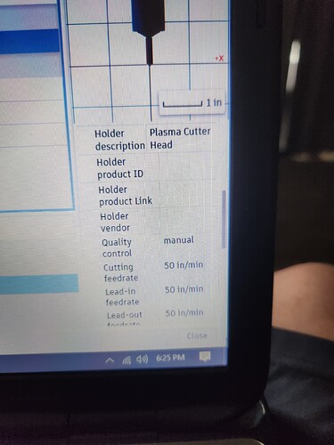

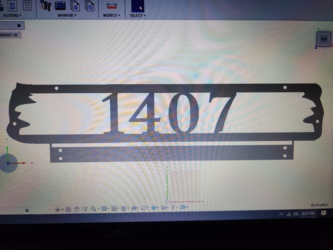

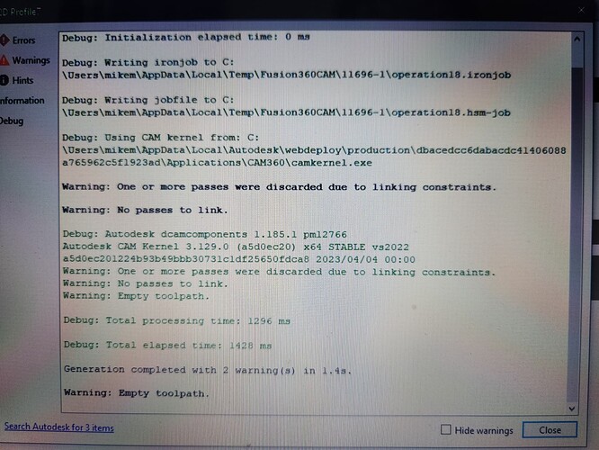

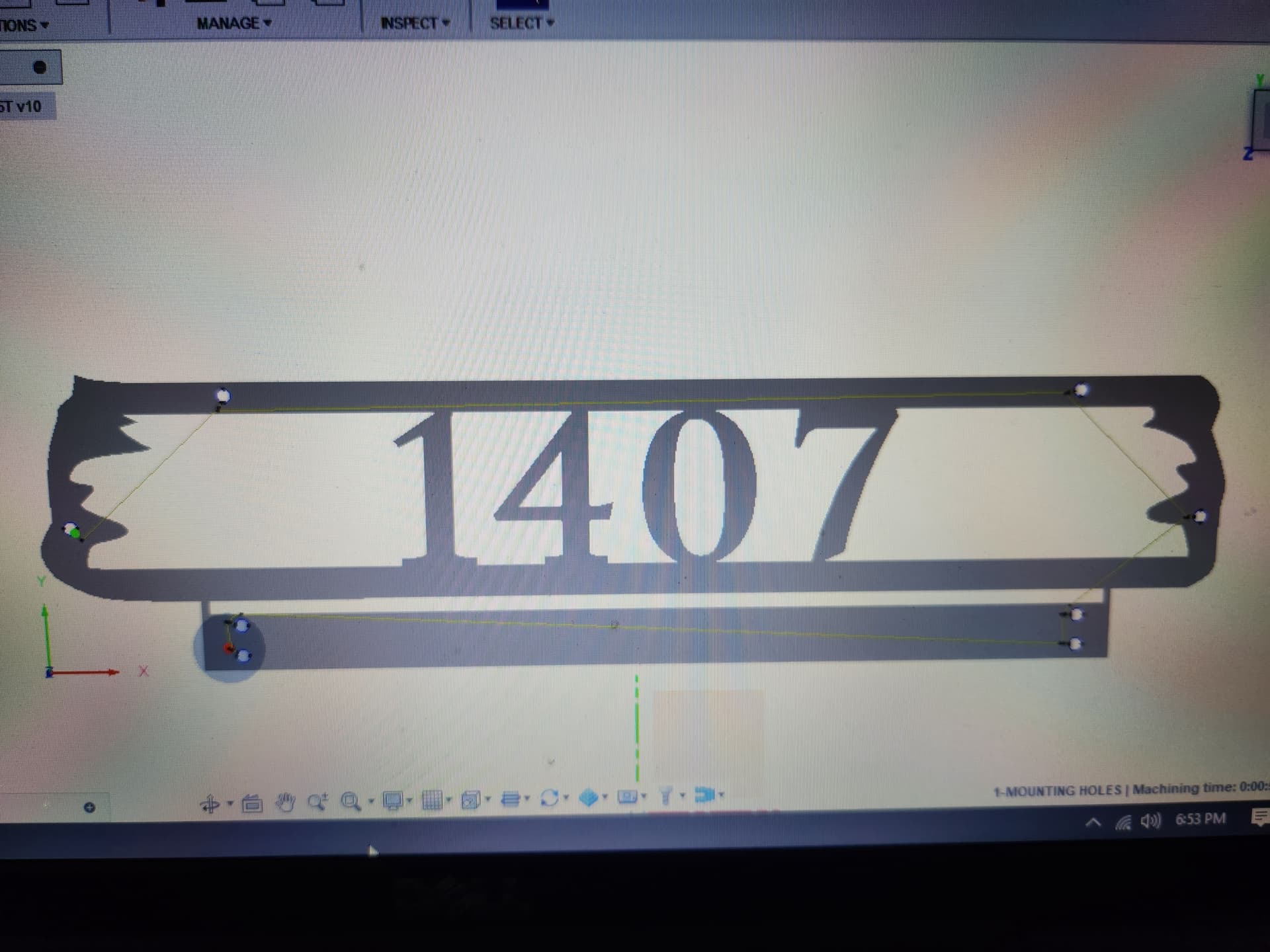

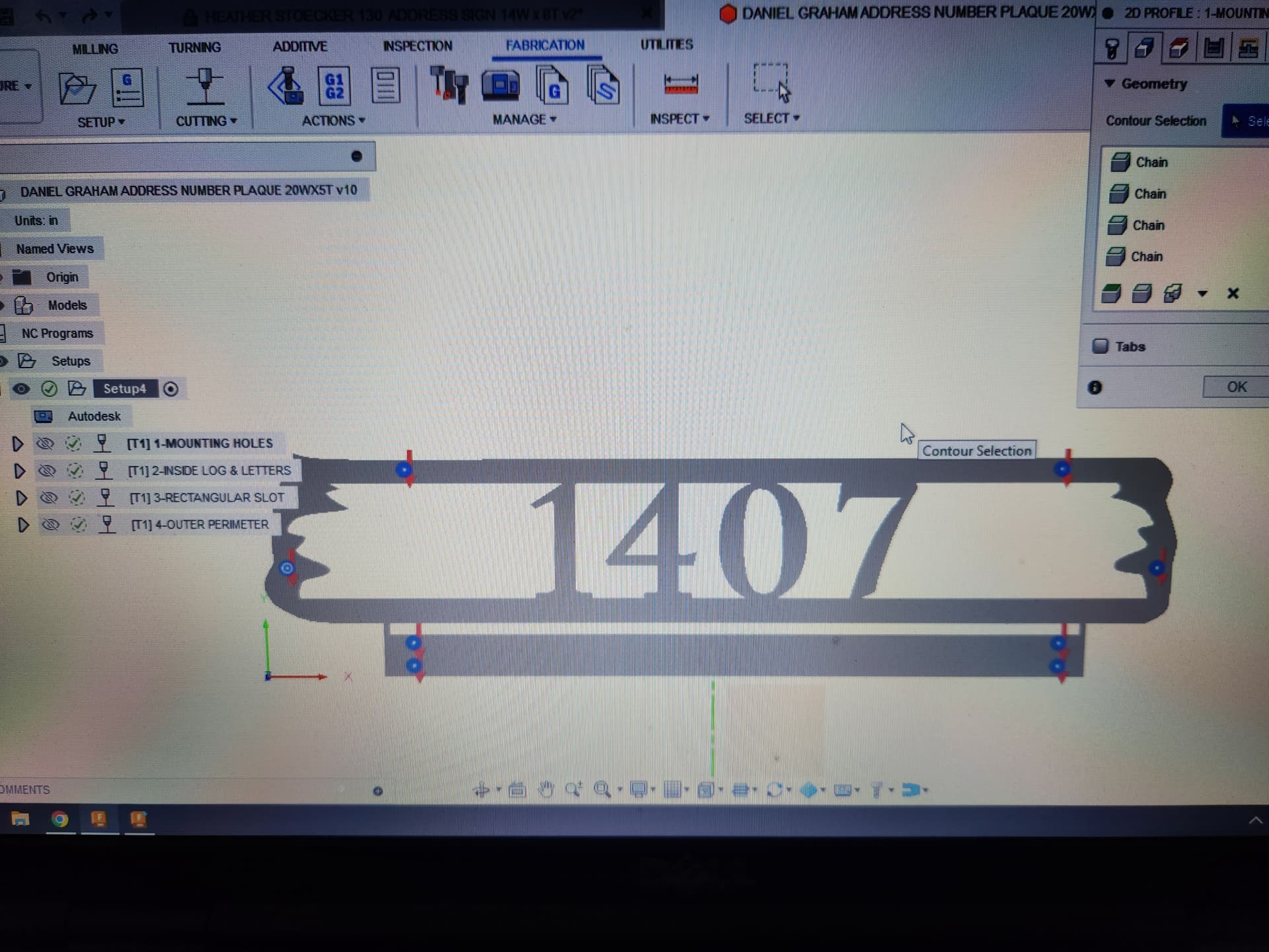

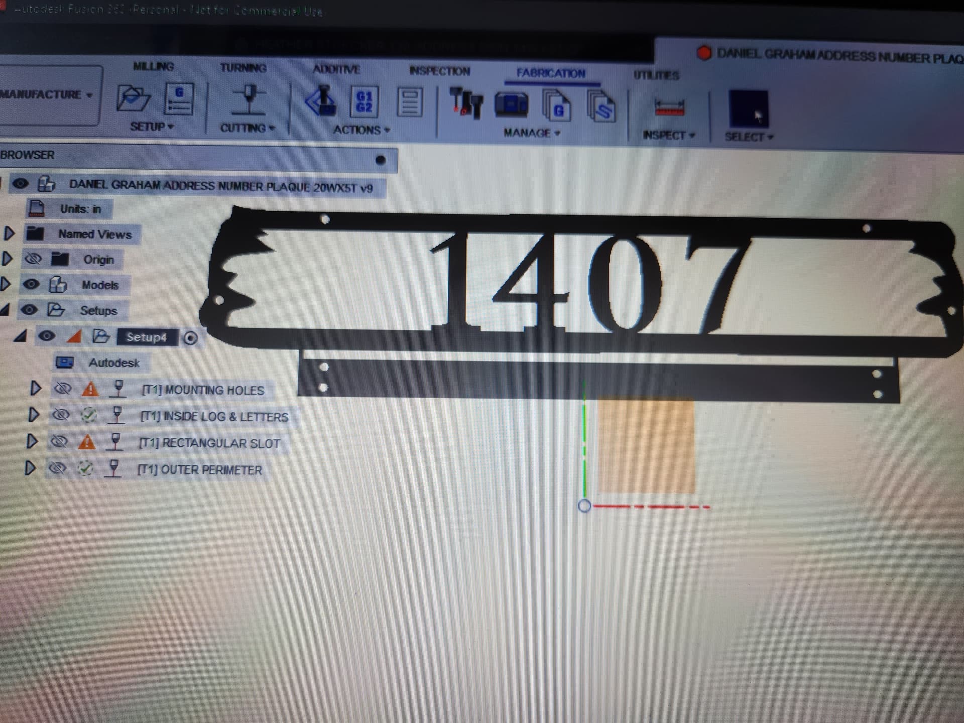

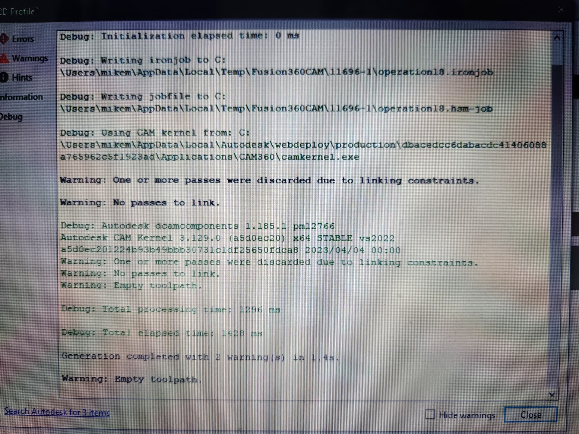

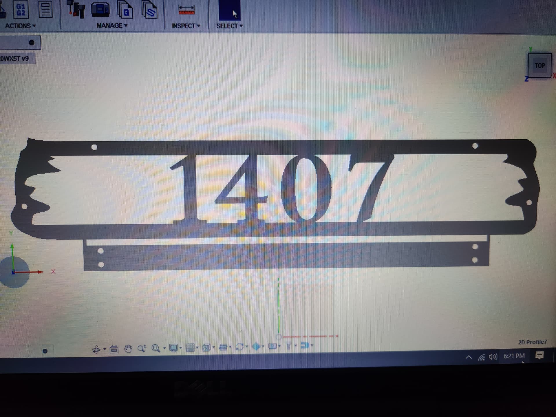

I’m still fighting it too something in there has changed. Here are some of my settings The 1/4-in hole and the long 1/4-in slot in the drawing will not create toolpaths on inside or outside cut with or without lead in and lead out doesn’t matter what I do…
Software will not allow me to create toolpaths for simple things like .250 diameter holes and .250 rectangular slots
see pics below
save your file exactly how it in now and Export an F3D.
Then well have your manufacturing info too as you posted above.
