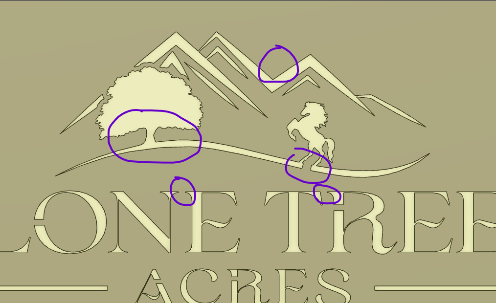

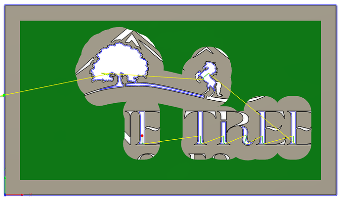

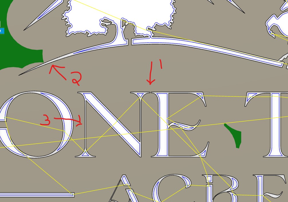

i feel like the answer to my lack of tool path might be to just use my sheetcam but trying fusion 360. complete novice on both platforms. this thread has been amazing and learned a lot but still getting partial path after changing lead ins, using sketch contour and many other tweeks recommended. any other advice for my farm logo?
farm logo v1.f3d (1.2 MB)

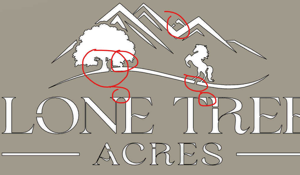

Oh boy…this is going to be a fun one! First off very nice look to the design but not so plasma cut friendly. I’m going to cover a few things quickly and might miss some other important things to know but sure others will chime in with even more experience.
Read entire post because there are a couple critical things to understand about cut paths. Many factors come into play deciding and you have multiple things that complicate this cutting.
Factors
  • how thick is steel going to be? reason this matter is because strength in tabs and area needed between the lines.
  • size of design - design is 10.5" x 6" which is pretty small

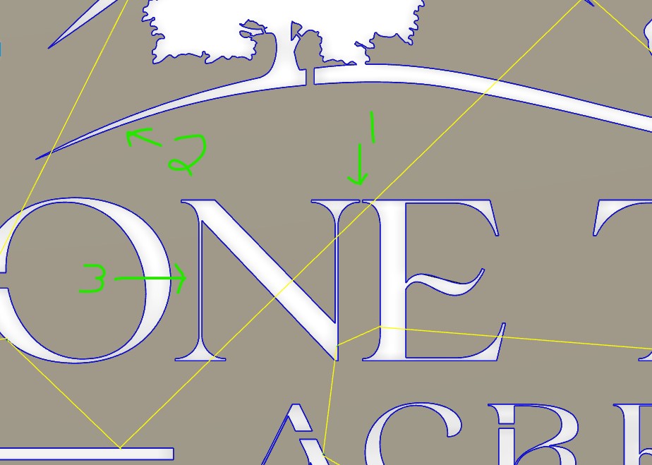

Your design - left compensation -
#1 - try to add spacing when doing letters.
#2 & #3 - you won’t get a cut in this area because it’s too close together.
Your design - center compensation -
#1 - if you cut this on line it will burn to next line
#2 & #3 - you can see this one will cut line as you want
So after reading all of the above I went ahead and did a couple quick changes to design to show you some options and explain my thought process when designing this stuff.
Here is your design in red
Here are couple changes that I did so you can decide if you like them or not. The tree is great example of not needed bridges that might take away from look of your design. Unless you those branches are needed than just do away with them. Same goes for extra triangle for the mountain. All that bridge will do is catch your eye and take away from design. I added a little space between a few of your letters and but still really close due to the overall size of your design. I also modified the “R” a little.
horse design dp.f3d (1.2 MB)
Just because a cut path is generated and shows green don’t mean everything will make it. As you start designing and cutting, you’ll start understanding how close you can cut and limitations for different thickness of steel. Good luck and post your design if you end up cutting.

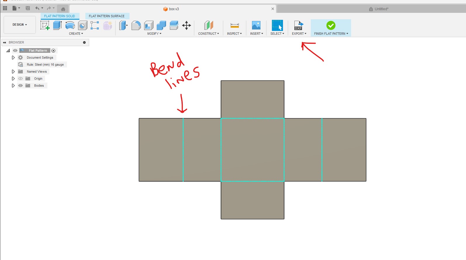

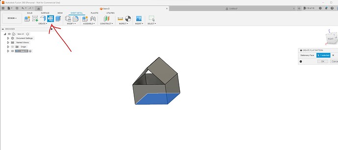

Next month I’ll have 1 year of playing around with fusion and plasma cutting. No training or no help besides @TinWhisperer showing videos. I have never used sheetcam myself, but fusion can be hard at the start but once you figure out basic 2D stuff you can create things in 3d that are really cool in minutes. So, my point of doing this 5 min box in 3D below is so you don’t give up on fusion because the things you can do with it are endless. 1 button and it all lays flat so you can cut it.
box_.f3d (193.6 KB)
box.dxf (6.0 KB)
That seems like the dark arts… :slight_smile: magic for sure and I didn’t even know something like that could be done. Pretty amazing. I’ll keep cracking at it for sure and I have a 3d printer which also makes some fabrication here in 3d also important!

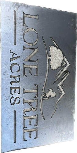

Still have some work on my end to clean it up on the letters but I can see your point now clearly in the cut. I did make it ~10x18 so that helped for sizes. I’m always amazed even small sizes how much detail the XR can make for the tree and horse. I primed it so it was easier to see the details of work to change stuff. Thank you again!
I went back to the original svg file and tried to repeat from scratch what you showed me. I also took the original and blew it up to 50x30 in for the sign size I needed. Turned out pretty darn good for a newbie!
