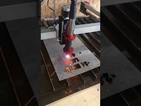

So I’m having a few issues with my Crossfire pro and it doesn’t seem to be cutting correctly and or accurately.
Here is video I filmed cutting out of file as you can see none of it is accurate and it’s not even cutting a standard square it is undershooting along the x-axis in both directions, and some of its movements are just jerky.
Additionally the torch seems to just sometimes go out for no apparent reason whatsoever.

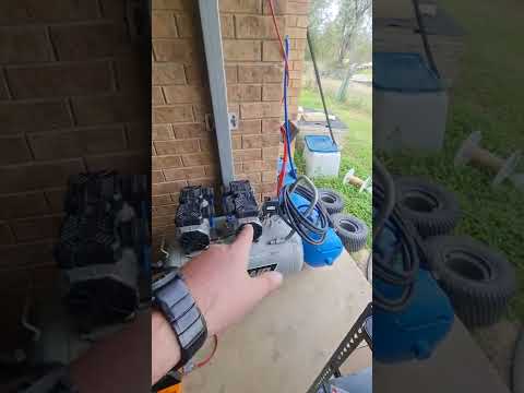

This is also my air setup to provide as much Capacity as possible:
So I have 100l on the compressor itself, and 120l on the blue tank, for 220l of Capacity.
Which seems good enough to maintain the specified 65psi in the manual.
Though 75psi shouldn’t be an issue given where my cut in and out is, as it can drop to 80psi and then hold 80psi from there.

So thanks to everyone here, I got a “successful” cut
I have to slow down slightly to get full cutting depth, as I had to hand torch the last bit.
The THC is still a bit finicky, so I have to learn it’s little eccentricity (what I find interesting is that almost no reviews that I could find even discuss the torch height controller or how to work with it)
But here is the first successful part!
