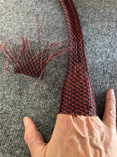

Here is some more info on the CFP build that I continue working. Before I started assembling I thought about cable management from the torch back to the enclosure, which I had planned to remotely locate above the table.
I chose this PET Expandable Braided Sleeving material to use for the cable management:
[Amazon.com]
Once I got the table assembled, I chose to cover from the machine torch back to the control cabinet area, then from the plasma cutter to down below the table. Here is how it turned out:
I used some cloth electrical tape for the z-axis and THC wiring, and also enclosed those in the braided sleeve.
I installed the cable support tube on the right side of the table since that is where the enclosure is. Note that I had to modify the tube with my conduit bender so that is swings under the shelves above the table.
Here is the braiding sleeve at the plasma cutter end.
This material is very expandable.
