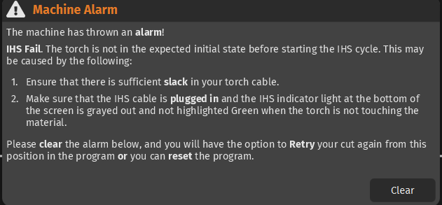

It’s probably the “IHS fail” error because the IHS is not in the expected state at the start of the program.
It’s the same error that people without a Z axis get, when they try to run a program that was made for a machine with a Z axis.

This is the error code I’m keep getting
IMG_1152

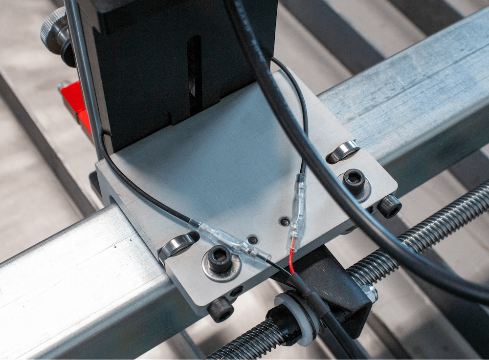

It’s most likely these connections that are not making contact.
It could be a stuck switch or loose screw connecting a wire to the switch, but the most likely problem is those connections pictured above.
Nothing to clean if it’s new.
I’m only placing emphasis here cause like you said, it’s new. But if you’re “cleaning” there is a chance you disconnected something if you weren’t careful.
If you see the above post, you have two wires that plug into your Z axis assembly as part of your IHS.
