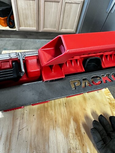

well, damn it wasn’t consumables or settings. It was the Milwaukee logo that was hanging it up.

i removed the logo from the design and it cut perfectly
things i learned from the prototype design:
my bend measurements are off by 0.341in on width, a critical dimension so i will have to fix the design for my cabinet configuration. it should work for others.
also, I need to fix the position of the Milwaukee system holes as the riser bumps need more clearance.
