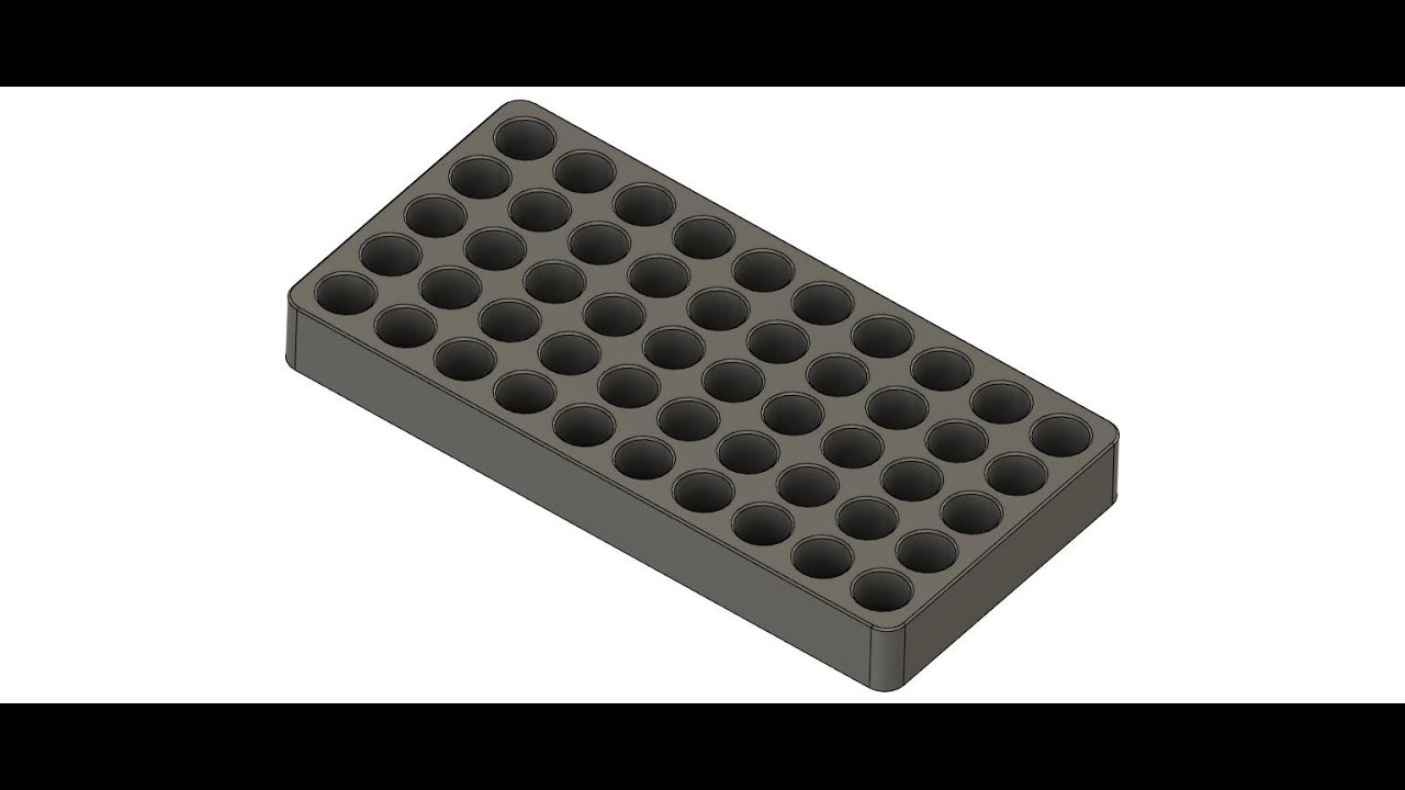

First Project - 338 Reloading Tray
First of all the rough stock was much too large for this project, it is what I had on hand. I cut an 8.5" long piece from a 10’ long 1.25" x 7" aluminum extrusion. The tray is 4" x 8" x 0.85".
I took it easy with shallow passes and narrow width of cuts until I get a feel for the machine. I have done some lathe work, but milling is new to me.
Thanks to @langmuir-mike for his assistance and suggestions on tool parameters settings.
Took video with GoPro riding on spindle head, but most of the video was obscured by chips and coolant on the lens. Threw together some of the best shots, which frankly aren’t that great. See some stills below…
Shell Holding Tray for Reloading Fusion 360 Render
After Adaptive Clearing
After Boring Operation
After Chamfer
Final Product… Didn’t get any stills of bottom side trim and facing

Quick question… are the rectangular marks on the front face of the tray in the final still photo from the vice jaws? Possibly from not clamping tight enough and the part was moving around? Or tightened too tight and imbedding into the surface?
Probably too tight. I had it cinched down pretty good for trimming off excess and decking off a 1/4"
