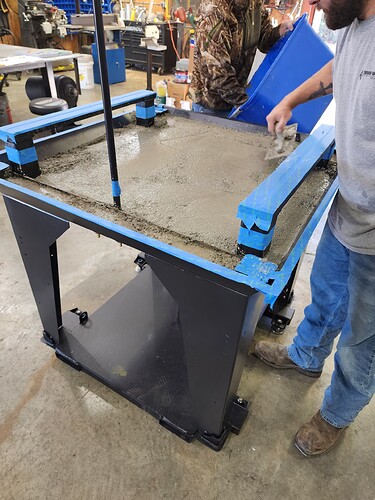

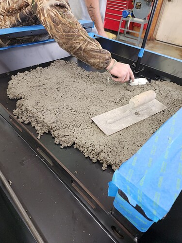

Here are more pre concrete photos.
Concrete is completed. NOW I WAIT AGAIN…

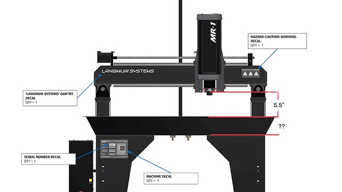

Just wondering if the illustrations are accurate. The table to carriage clearance is listed at 5-1/2” so I had estimated the chip tray depth to be around 5”. So concrete thickness should be close to 4-3/4” before epoxy top coat. I had read other estimates of 6” to 8” for concrete. Am I far off?
4"to 5 " is what mine worked out too.
Z travel is 6.1 or so in lower bolt holes.
Almost 9" in the upper mount holes. The measurement they are showing is to the top lip. Base plates are about 1" below that.
Plates are an inch lower? Looked fairly close to me.
Haven’t seen a video yet on the upper bolt holes. I don’t think it affects carriage clearance though which I think is the bigger problem with the Z height.
I’ll measure it in the morning and give you an update.
