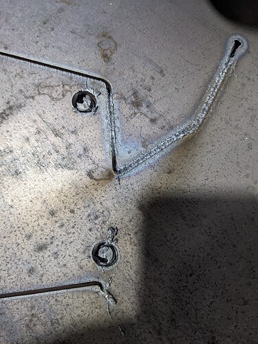

Misfiring razercut 45x(solved)

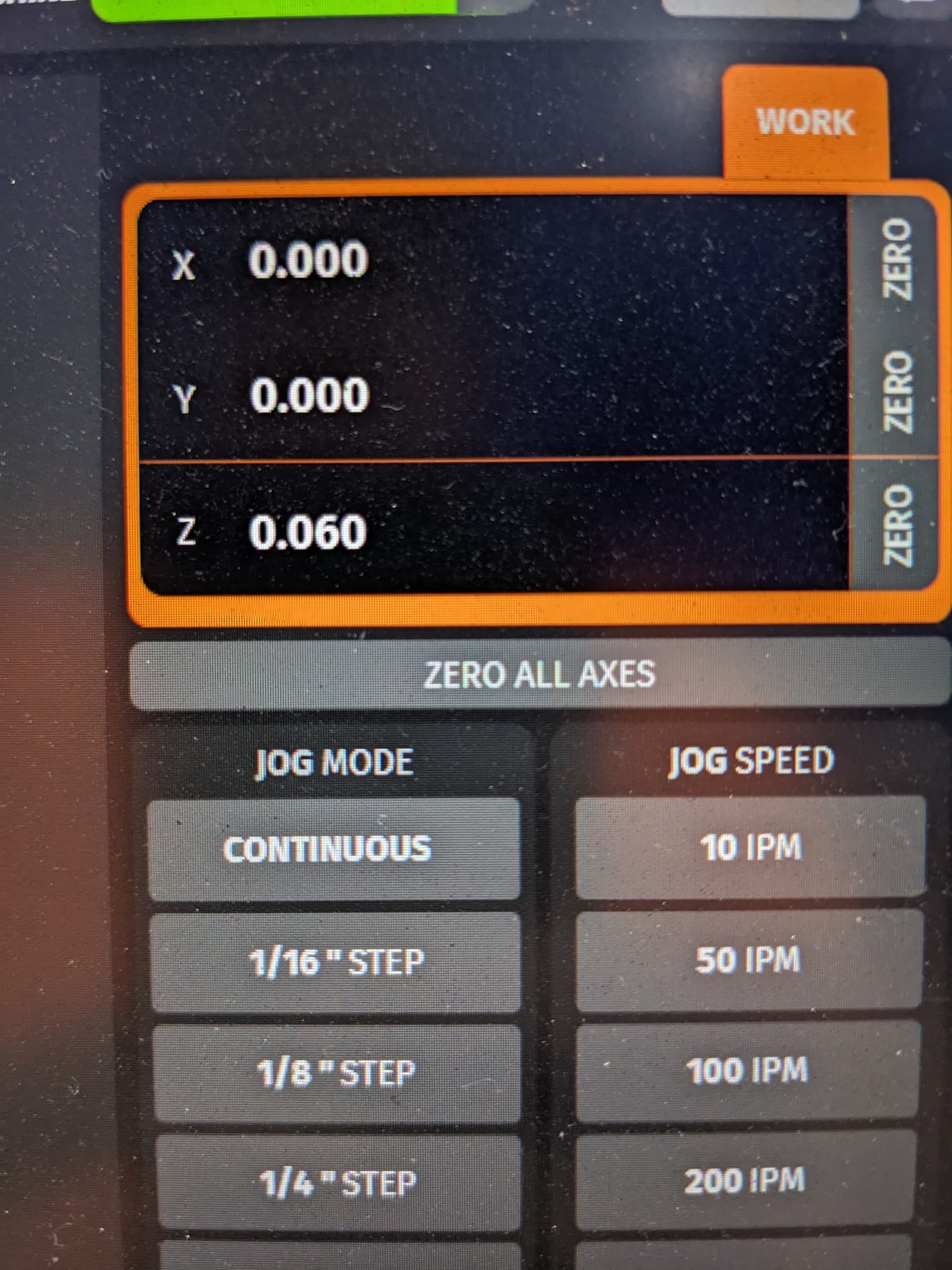

cut height test.tap (224 Bytes) put this file into FireControl. Set fusion for .062 it will stop and you can measure what FireControl thinks is .062.
Example. 062 actually is .10 , then you can subtract the difference and adjust fusion to reflect.

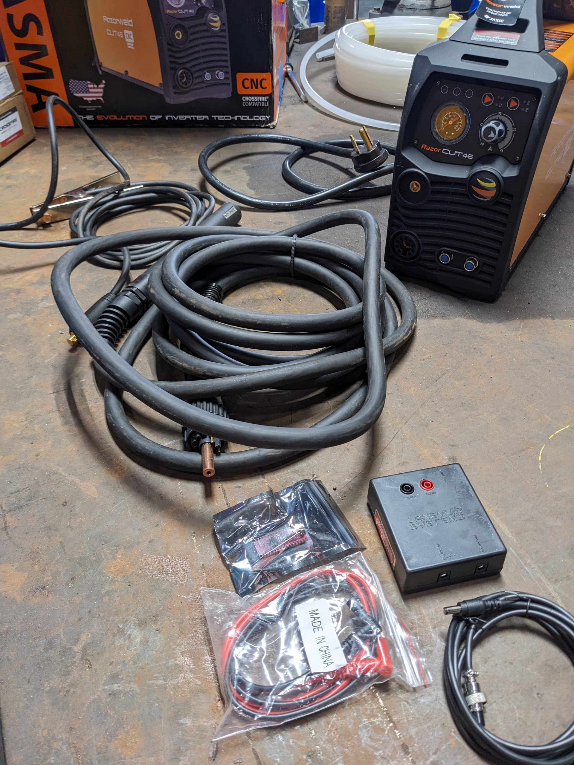

Please send us you consumables pictures. Hopefully they are not Plasmadyne..
I ran the file it came down touched the steel went back up came back down to .060 in fire control but measured.065 . consumable pictures are posted further up
I want to see the ones that are in the torch now.

So at 0.062 setting you are getting an actual cut height of 0.1 then you determine how far you are off by: 0.1 - 0.062 = 0.038 (difference off).
To get that to come out right you would subtract the difference from your setting:
0.062 - 0.038 = 0.024.
Set your cut height in the gcode to 0.024. I am thinking if you put that setting in your cut height, you will be satisfied.
(Don’t ask me why it has changed with your set up. Happened to a number of us.)

Cut good at .024 but misfire at the beginning of a couple of cuts so I assumed the pierce height need to be adjusted too. it seems like this must be an issue with my fusion software

You might need to re-evaluate all of your settings for different thicknesses of metal with respect to cut height, pierce height, pierce delay and cut speed. If you look at your first cut images in this thread, it is classic “torch too high” behavior (topside dross, incomplete cut and severe positive bevel).
