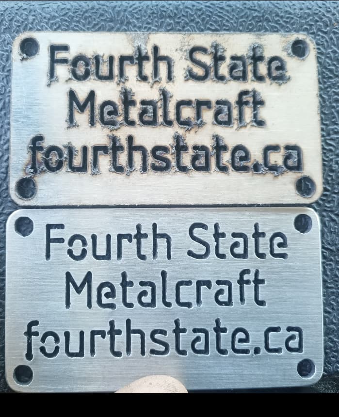

@Tango1966 you could consider a single line font if you want to go smaller.
Here’s an example this is a business card size which is about 2x3.5 in
You’re going to have to do some experimentation but you could achieve a half an inch tall.
Here’s an older video I made on making the cam for single line fonts
Some tweaking could be done to make this cleaner
