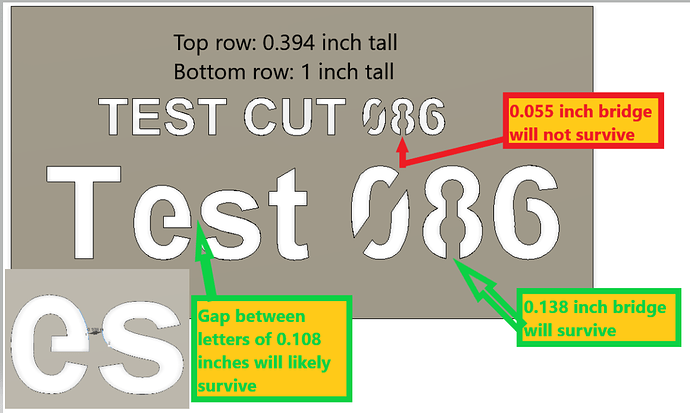

The answer you are looking for is NOT THE SIZE OF THE FONT, but the size of the bridges. Strive to have a minimum of material supporting the the interiors of the letters and in between letters of at least 0.125 inches.

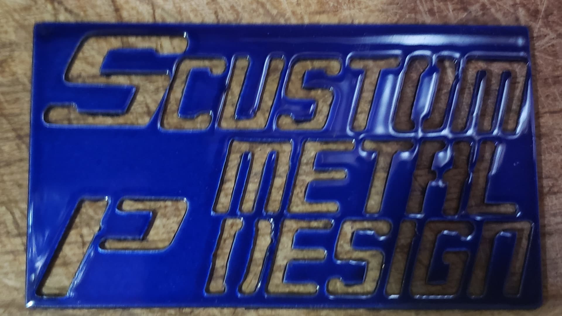

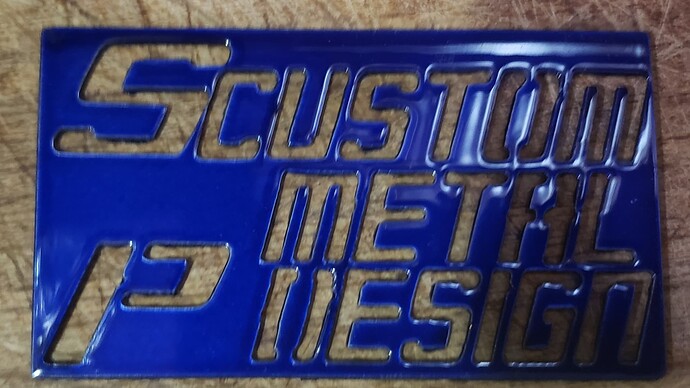

While I haven’t cut letters that small, I have successfully cut business cards with my logo. On 18 gauge, smallest bridge of .0625. The letters were 9/16. 14 gauge I shoot for a .1 inch bridge
Saw this post and had to laugh. .395 is exactly the smallest I could cut consistently. Looks like we found the same size. I did the same experiment and reached the same conclusion.
