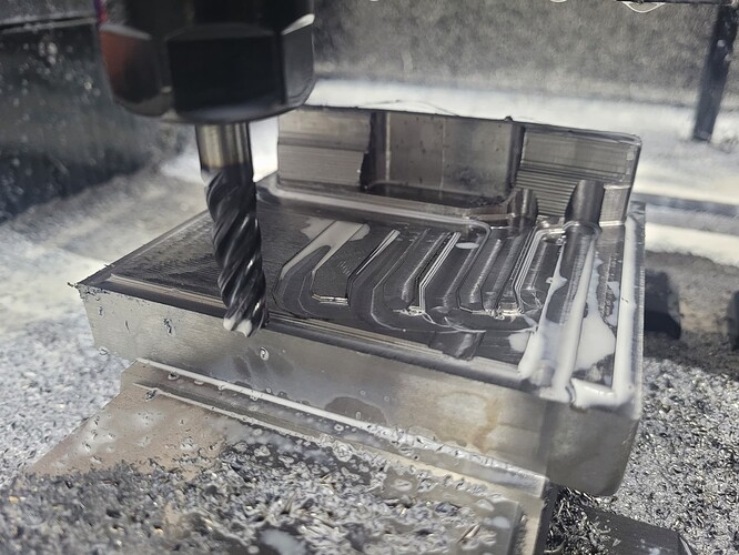

Well I posted on FB because I didnt have my computer, but again, the machine decided to destroy stock and a $40 cutter this weekend. 8.5h into the program and it was running great (13h total estimated time)
I look over to the mill and there is some serious steam coming off, which is odd. Turns out, it decided to lose its X position by about 1/2" for a couple of steps and was taking 1/4" full slotted cuts or more right into my part. I didnt catch it at first due to all the flood coolant blocking the view, but when I paused it to see why it was cooking coolant I saw my part and tool ruined. Checked the zero after I was done and it was shifted ~1.5" off to the left, so the motor is losing position some how. Same thing happened in the y direction on the last part.
At this point Im just pissed off. Its now ruined $80 in cutters, $100+ in material, and at least 20 hours of my time. I have nothing to show but some scrap metal blocks, and have no direction for a solutiuon. And at this point, and not really confident enough in the mill to actually work well enough to justify putting things in it that it wont destroy.

Open to suggestions on what to do to make me not just look at selling this and trying to find a used Tormach or something. I know Ive had a few complaints (leaking seals, terrible door design, lack of canned g code in Cut control) but for the price, if it worked, this would be a killer machine.
It was suggested that I might need to move to the high power drivers. I wonder if this would fix my issue? Annoying to have to spend another $200+ to make the machine work, but if that would do it I would be happy to have a reliable working machine.
Still partially waiting on Langmuir to see if they see something else wrong with things before I spend the money
Hey I just replied to your ticket in our online help system so take a look there when you have a minute. Looking at the forum posts I agree that high powered drivers would definitely help your situation. 25IPM is on the higher side of what we recommend for 4140 so the motors are likely skipping steps.
Thanks for getting back to me, I just replied to your email. For reference to what I asked in the email, I used what the recommendation for feeds and speeds were on your sheet. I just took ~20% off the high end and assumed it was good (25IMP vs 30 and 0.08" depth vs 0.1). Is there a recommendation for what is a “safe” speed and feed to know for future? Just put it in the middle of the range?
Thanks
No problem. Back 20% off of the max feed rate is a good call so the standard drivers must have just been on the edge. If you’re taking the full cut in tougher material then I would start on the low end of the suggested feed and see how it cuts. If everything is going great, then you can start increasing it while the program is running to find that sweet spot.
